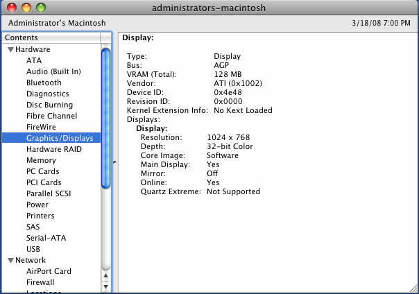

I loaded the lastest Slice AGPgart in my Hackintosh running iAtkos Leo, and it finally see's the :o card as AGP in profiler!!! :D
Now I just need to find a :P driver for the card that wasn't written for PCIe (ATI HD2400 AGP) :wacko:
GREAT WORK SLICE!! = :angel:

And again for JaS and MrRoper I didn't see your attempts to change AGP_Base. If you see black screen then aperture address is not good.
sorry about that, i misunderstood your post. I will try again today with AGPGart.
Regarding graphics driver, at this point i'm not sure exactly which kexts, frameworks, bundles & instructions i need to be using?
should i be following these instructions ?
from post 236
1. remove ATIRadeon9700.kext, ATIRadeon9700GA.plugin
2. install old 10.4.8 ATIRadeon9700.Kext and ATIRadeon9700GA.plugin
3. install callisto, with callisto instructions that come with it
a. follow callisto faq QE/CI for ATIRadeon9700GA.plugin!!!
4. remove ATIRadeon9700GLDriver inside ATIRadeon9700GLDriver.bundle. The path is Contents/MacOS
5. copy ATIRadeonX100GLDriver (version 10.5.1) in the directory where you have delete the ATIRadeon9700GLDriver and rename as ATIRadeon9700GLDriver ( the internal path is the same Contents/MacOS )
6. remove ATINDRV.kext and copy Natit (Natit_ATIauto.kext.zip)
7. set the attribs in new files (meybe it's not important because afer you must repair a permissions)
a. sudo chown -R root:wheel /System/Library/Extensions/file name
b. sudo chmod -R 755 /System/Library/Extensions/file name
8. repair a permissions
9. reboot with -f parameter or delete Extensions.mkext
If there's a better way, kindly point me to it if you would be so kind :(

Very strange propositions and result
For my card the bad thing was that things got very sloppy, lot of tearing (even Mouse locator did not help much, iTunes totally 'teared away'), no cover flow, 90%transparant menu, I didn;t even try to play a movie.
As I know you have Radeon DevID=4e48 that is directly suppoted by ATIRadeon9700*.* so you need no any patch for it. May be use older version but I am not sure.

I can install successfully with OSX XxX_OS_x86_10.4.11_Intel.iso
But no CI/QE
I want to have CI/QE

You have those chipset that I have no experience.
