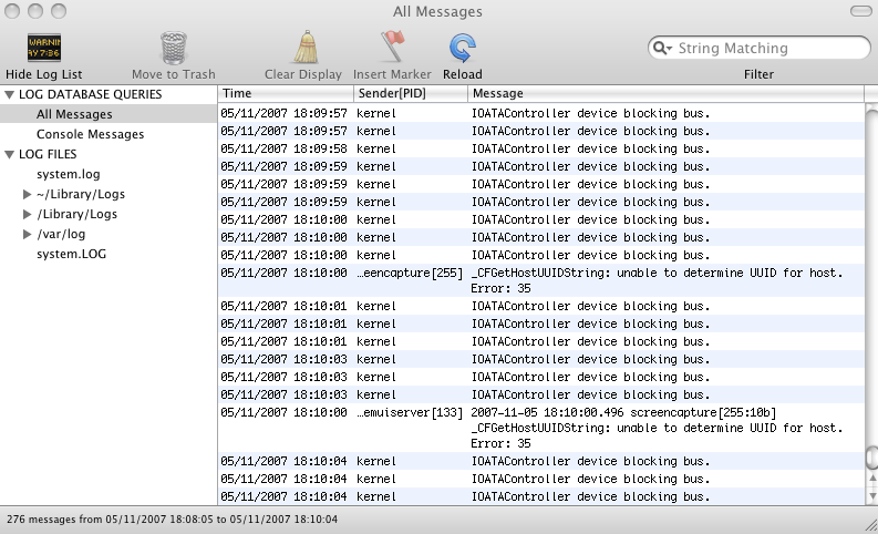

BrazilMAC Posted November 5, 2007 Share Posted November 5, 2007 Hi All, I just ran into a problem and was wondering if others are experimenting it: I have a DVD Drive plugged into the IDE port. There are certain times where if a dvd is in the drive and you try to eject it, it wont do it. From that point on, the hard disk LED wont stop blinking, you will have to manually restart and if you check your system.log, you will see a "IOATAController Device blocking bus". This message will be there to no end, and the hard disk activity wont stop until you restart. See a shot of the log below. Please note that Leopard works fine, you can browse, open apps no problem,but sometimes apps will freeze if you try for example, to use to browse to a folder on the HD from the application. It is just annoying the hell out of me Link to comment https://www.insanelymac.com/forum/topic/68453-asus-p5w-dh-deluxe-thread-for-105x-leo-109x-mavericks/page/3/#findComment-495916 Share on other sites More sharing options...
SquidCombo Posted November 5, 2007 Share Posted November 5, 2007 brazil, by eject you mean ejecting through osx or through the button on the drive? IIRC ejecting through osx is the only way. I'm at work but i'll try it when i got home. I just remembered, I didn't remove the kext cache after installing HDA. Gonna try it later. Link to comment https://www.insanelymac.com/forum/topic/68453-asus-p5w-dh-deluxe-thread-for-105x-leo-109x-mavericks/page/3/#findComment-496300 Share on other sites More sharing options...

BrazilMAC Posted November 6, 2007 Share Posted November 6, 2007 I have ALPE disabled, and I still get the problem when ejecting the DVD from within OSX. To reproduce the problem: I do a couple of ejects. then run Final Cut (or Logic, dreamweaver) and try to eject. Then it wont do, disk activity will start and the system logs is filled with the ATA device message and from now on, only a manual restart will do. System still works, but HD LED light will be light up indicating activity Link to comment https://www.insanelymac.com/forum/topic/68453-asus-p5w-dh-deluxe-thread-for-105x-leo-109x-mavericks/page/3/#findComment-497069 Share on other sites More sharing options...

BrazilMAC Posted November 7, 2007 Share Posted November 7, 2007 The issue with the DVD drive eject and ATA blcking device message has been solved. It seems odd, but replacing AppleHDA solved the problem. My system was actually using AppleAzalia.kext Removing that and replacing the AppleHDA solved the issue. Really odd... Link to comment https://www.insanelymac.com/forum/topic/68453-asus-p5w-dh-deluxe-thread-for-105x-leo-109x-mavericks/page/3/#findComment-498292 Share on other sites More sharing options...
