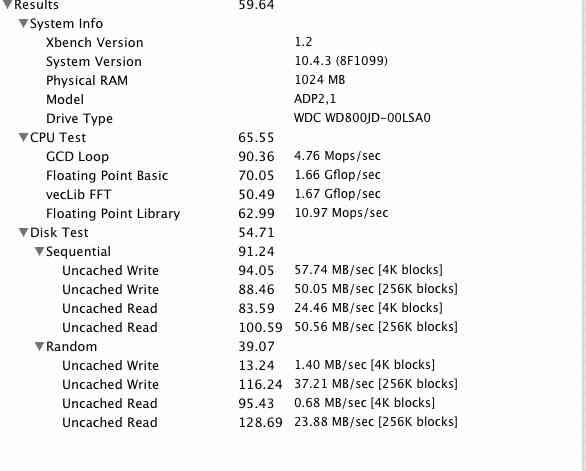

mutahir Posted December 6, 2005 Share Posted December 6, 2005 Hi All, Attached is my xbench disk test, i hope they are good as i am confused on whether i have to do this tweaking or not Just now after reading i am thinking i might be OK Regards to all of you and best of luck with hard work! Mutahir Link to comment https://www.insanelymac.com/forum/topic/517-howto-speed-up-hard-disk-access/page/4/#findComment-34459 Share on other sites More sharing options...
Mactel4SSE2 Posted February 21, 2006 Share Posted February 21, 2006 Sequential 91.67 Uncached Write 100.76 61.86 MB/sec [4K blocks] Uncached Write 92.37 52.26 MB/sec [256K blocks] Uncached Read 76.77 22.47 MB/sec [4K blocks] Uncached Read 101.45 50.99 MB/sec [256K blocks] Random 34.86 Uncached Write 12.00 1.27 MB/sec [4K blocks] Uncached Write 72.87 23.33 MB/sec [256K blocks] Uncached Read 97.20 0.69 MB/sec [4K blocks] Uncached Read 134.43 24.94 MB/sec [256K blocks] some tests it blew, some tests it blew away... what a world... After patching btw... didn't test before, but pc runs faster for sure Link to comment https://www.insanelymac.com/forum/topic/517-howto-speed-up-hard-disk-access/page/4/#findComment-59344 Share on other sites More sharing options...
