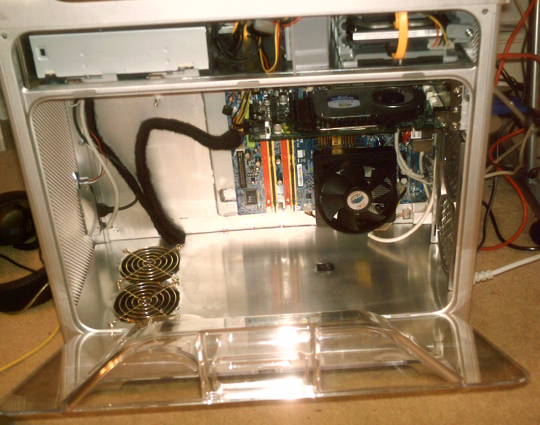

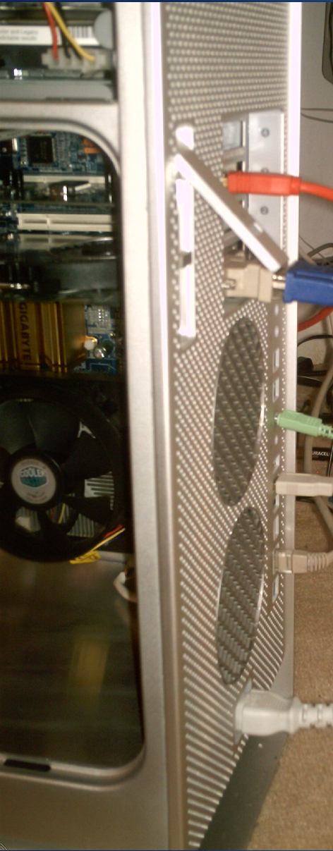

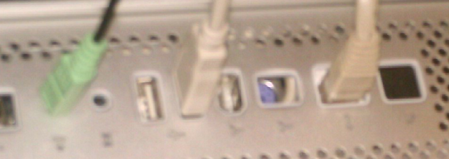

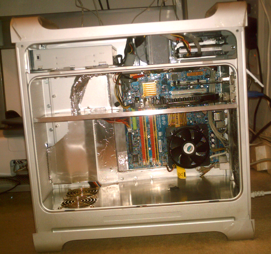

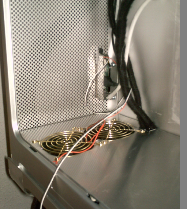

shaanky98 Posted August 30, 2007 Share Posted August 30, 2007 I have managed to do a G5 case mod with its original back if you want pics I will uload them soon. 1 Link to comment https://www.insanelymac.com/forum/topic/4525-discussion-fit-a-pc-in-a-g5-powermac-enclosure/page/8/#findComment-438795 Share on other sites More sharing options...
Kaspers Posted August 30, 2007 Share Posted August 30, 2007 Yeah pics Link to comment https://www.insanelymac.com/forum/topic/4525-discussion-fit-a-pc-in-a-g5-powermac-enclosure/page/8/#findComment-438839 Share on other sites More sharing options...
shaanky98 Posted August 31, 2007 Share Posted August 31, 2007 Yeah pics Here we are if you want step by step. I am doing it and will post it soon. 1 Link to comment https://www.insanelymac.com/forum/topic/4525-discussion-fit-a-pc-in-a-g5-powermac-enclosure/page/8/#findComment-439139 Share on other sites More sharing options...
Kaspers Posted August 31, 2007 Share Posted August 31, 2007 Nice job! Link to comment https://www.insanelymac.com/forum/topic/4525-discussion-fit-a-pc-in-a-g5-powermac-enclosure/page/8/#findComment-439372 Share on other sites More sharing options...
