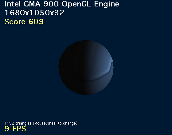

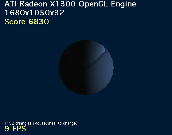

consolation Posted March 10, 2007 Share Posted March 10, 2007 (edited) IIRC the reason the 950 benches higher is that it lacks hardware T&L. So when an instruction arrives it just ignores it, whereas a 7300 (which is of comparable speed) has to process the instruction and apply the transform. That makes it slower, but, it allows the card to provide a better image or a more immersive environment. That's why if you do a time demo in say Halo old cards often score higher; you get more frames per second -but it's more frames of {censored}. X-Bench, the abortion that it is, is too dumb to detect that. I find a huge performance advantage when using a 7600 or X1600 over a 950 when using aperture, not to mention that CIV & Quake look spiffy Note that these are not particularly high end cards. A 7600GT (a much better card then the gs or x1600) can be had for ~$100 US - your hacky will fly with one. IMHO, you need a 7300gt/7600gs to see the full benefit of core image and be able to keep the frame rate up. Edited March 10, 2007 by consolation Link to comment Share on other sites More sharing options...
DiaboliK Posted March 10, 2007 Author Share Posted March 10, 2007 (edited) i'd like to jump in on the 950 bashing for a second. i for one like the 950 i'm running a 2.13dual2 processor with 2gigs of ram and the video works great. i have yet to see any problems with it. if there is a card that works better under say $200 i would buy it but i'm not sure there is one at this time. DiaboliK, do you think there is a better card i could go with. i think you even said that my bench test faired better then yours in the video. i would however like to go to dual monitor and didn't know if i should go with the add2 route or complete dual card route. btw:mad props for DiaboliK, my machine rocks thanks to him. first, to everyone, id stick with consolation's reccomendations. i have all of the cards he said and they all work wonderfully. (nvidia's are far better than the ati's, and have extended mode dual screens ) and to tell you from switching from the gma900 to the x1300pro 256mb pcie in my intel 915gux machine. its a whole heck of alot better. you are better off getting off the onboard graphics, and upgrading. I never use onboard most of the time. Heres some proof: Before: After: -DiaboliK Edited March 10, 2007 by DiaboliK Link to comment Share on other sites More sharing options...
