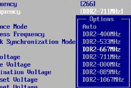

YoMuS Posted July 26, 2007 Share Posted July 26, 2007 Hi! Could I plug a pair of crucial ballistix pc-6400 800 MHz ram in the p5ld2-vm ?? In the specs it says only 533 and 667 memories. THank you! Will I realise an improvement in speed or stability?? (With my 2gb of kingston 667 ram, my system freezes sometimes) Link to comment Share on other sites More sharing options...
Dr. Hurt Posted July 26, 2007 Share Posted July 26, 2007 Hi! Could I plug a pair of crucial ballistix pc-6400 800 MHz ram in the p5ld2-vm ?? In the specs it says only 533 and 667 memories. THank you! Will I realise an improvement in speed or stability?? (With my 2gb of kingston 667 ram, my system freezes sometimes) Well, DDR2-667 is the standard memory for this chipset and so this board. If you plug-in a DDR2-800, it will be automatically set to run at 667 MHz by the BIOS. You can however manually set the RAM speed to 800 MHz in BIOS. Just make sure you check that the RAM timings and voltage are set correctly (and possibly raise the PCIe frequency to 118MHz). Using pc2-6400 RAM will make the system and applications start faster, but you probably won't really feel it. If your system freezes (due to ram), then check the RAM voltage and timings. Correct me if I'm wrong. Link to comment Share on other sites More sharing options...
YoMuS Posted July 26, 2007 Share Posted July 26, 2007 Well, DDR2-667 is the standard memory for this chipset and so this board. If you plug-in a DDR2-800, it will be automatically set to run at 667 MHz by the BIOS. You can however manually set the RAM speed to 800 MHz in BIOS. Just make sure you check that the RAM timings and voltage are set correctly (and possibly raise the PCIe frequency to 118MHz). Using pc2-6400 RAM will make the system and applications start faster, but you probably won't really feel it. If your system freezes (due to ram), then check the RAM voltage and timings. Correct me if I'm wrong. Hi! I have set the SPD to configure automatically the memory setting, anyway, I'll try to put them manually following the manufacturer specs. If this solves the problem I won't buy another RAM. Thank you, your info has been really interesting! Edit: I know it's the RAM because if I let only one memory stick, i have no problems at all, but if I put both of them (dual channel), it freezes anytime instead, mostly when i download something, (transmission usually), and I've just changed the hard disk so... Thanks again! Link to comment Share on other sites More sharing options...
velayo Posted July 26, 2007 Share Posted July 26, 2007 Hi! I have set the SPD to configure automatically the memory setting, anyway, I'll try to put them manually following the manufacturer specs. If this solves the problem I won't buy another RAM. Thank you, your info has been really interesting! Edit: I know it's the RAM because if I let only one memory stick, i have no problems at all, but if I put both of them (dual channel), it freezes anytime instead, mostly when i download something, (transmission usually), and I've just changed the hard disk so... Thanks again! That's a tell tale sign of ram. I had similar problems, mainly everything I downloaded was corrupted and i finally changed my ram for newer kingston ram and the problem was gone. Link to comment Share on other sites More sharing options...
