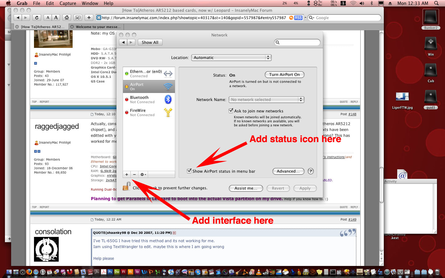

raggedjagged Posted December 30, 2007 Share Posted December 30, 2007 It uses the AR5212 chipset, havn't tried the 10.4.8, but it should work with 10.5's kext right? I'd like it to, hehe. Addeed the interface? I gotta check how to do that.. Link to comment https://www.insanelymac.com/forum/topic/40317-how-toatheros-ar5212-based-cards-now-w-leopard/page/6/#findComment-557909 Share on other sites More sharing options...
shaanky98 Posted December 30, 2007 Share Posted December 30, 2007 I've TL-650G I have tried this method and its not working for me. Iam using TextWrangler to edit. maybe this is where I am going wrong Help please Note: my OS =10.5.1 Link to comment https://www.insanelymac.com/forum/topic/40317-how-toatheros-ar5212-based-cards-now-w-leopard/page/6/#findComment-557923 Share on other sites More sharing options...
raggedjagged Posted December 30, 2007 Share Posted December 30, 2007 Actually, consolation, I have to mention that I actually have 2 wireless cards in the computer, one is this Netgear WPN311 (Atheros AR5212 chipset), and another Linksys WMP54G (RT2500 which is also not working)..however, in your guide you said that after the kexts have been editted with your device id, the Airport icon should be shown in the menu bar, but I do not even see that...what am I doing wrong? This has worked for me in 10.4.8 I think, but not anymore, please help! Link to comment https://www.insanelymac.com/forum/topic/40317-how-toatheros-ar5212-based-cards-now-w-leopard/page/6/#findComment-557973 Share on other sites More sharing options...
consolation Posted December 30, 2007 Author Share Posted December 30, 2007 I've TL-650G I have tried this method and its not working for me.Iam using TextWrangler to edit. maybe this is where I am going wrongHelp pleaseNote: my OS =10.5.1 Avoid text editors, they can mangle plists badly. I prefer to use nano in terminal, simply type sudo nano , drag your plist into the terminal and hit return. However, you'll need to be VERY CAREFUL about retaining the formatting and tabs. It's easier to use plist editor that comes with the developer tools on the install dvd. However, with it, you'll need to work on a copy and then move it into the extensions folder. Attached is my kext, it should work for you as long as your device id is 168c,13 Delete the current kext before moving this one into the extensions folder.Then: Start up terminal and type cd / sudo chown -R root:wheel /System/Library/Extensions/ sudo chmod -R 755 /System/Library/Extensions/ sudo rm /System/Library/Extensions.mkext Shutdown and restart, you airport should be detected. Go to system preferences/network, make sure you can see your ap, if not click the + button under the list to add it. Follow the instructions in 1st post to connect to secure networks. good luck I get a lot of messages asking where to add missing interfaces and icons. Go to Apple menu ->preferences ->network, then select the airport or add it. Screeny attached... IO80211Family.kext.zip Link to comment https://www.insanelymac.com/forum/topic/40317-how-toatheros-ar5212-based-cards-now-w-leopard/page/6/#findComment-557987 Share on other sites More sharing options...
raggedjagged Posted December 30, 2007 Share Posted December 30, 2007 Consolation, I re-read and followed the instructions 3 times now, but I still don't see Airport anywhere, not in the System Profile, not in the menubar and not in the Network preferences window when I add an interface... how do I fix this? I noticed that in my system profile, my LAN connection is called "en1" is that a problem? Should it not be "en0"? Link to comment https://www.insanelymac.com/forum/topic/40317-how-toatheros-ar5212-based-cards-now-w-leopard/page/6/#findComment-558023 Share on other sites More sharing options...
