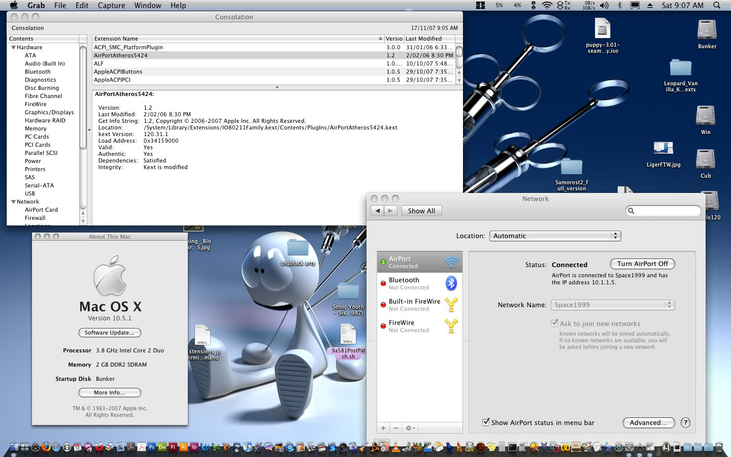

consolation Posted November 16, 2007 Author Share Posted November 16, 2007 Doesn't add any Atheros kext. No, but it has a new Apple80211.framework, however, no change for me. .8 kexts works fine as long as I go through network prefs and not the icon. Well... one thing has changed, instead of hanging my system reboots - I guess it's an improvement of sorts, saves me having to push the button Chipxsd's method of connecting through the assistant in prefs works fine for me, meh... I'll call it a win for now. Pointless screenshot included for you edification. P.S. I just realised, my airport icon's status indicator is working now. Link to comment https://www.insanelymac.com/forum/topic/40317-how-toatheros-ar5212-based-cards-now-w-leopard/page/4/#findComment-508605 Share on other sites More sharing options...
consolation Posted November 16, 2007 Author Share Posted November 16, 2007 I guess AirPortAtheros.kext is very buggy, no wonder many people have have problems with it.It is important that you install the whole extension, not just the Atheros one, otherwise you will see that message tellin you of unresolved dependencies.Not so much buggy as designed to work with Apple's hw & EFI. Have you tried the 10.4.8 update kext?Thanks ... that fixed it ... sort ofBy editing the 10.5 kexts as above I got wireless (including WPA2) working on Leopard.using 10.4.8 kext eliminates the lockups, use assistant in prefs to connect Link to comment https://www.insanelymac.com/forum/topic/40317-how-toatheros-ar5212-based-cards-now-w-leopard/page/4/#findComment-508649 Share on other sites More sharing options...
