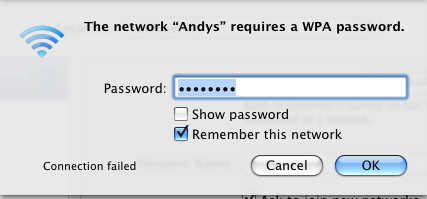

nickytl Posted November 19, 2007 Share Posted November 19, 2007 Just to confirm that deleting all the device IDs except for mine worked as suggested. I have the WG311t v3 working now in leopard and connecting to WPA network. I installed leopard from the flat image using hatchery. then installed 10.5.1 update and toh kernel. rebooted wireless was detected but Connecting to WPA was causing a complete system freeze. I removed all device IDs except for the correct one 168c,13 in the atheros plist Now works perfectly. incidently in about this mac in tiger and leopard it shows as so: Wireless Card Type: AirPort Extreme (0x168C, 0x5A00) I checked in windows and got ven168C DEV0013 Thanks for the pointers. Link to comment https://www.insanelymac.com/forum/topic/40317-how-toatheros-ar5212-based-cards-now-w-leopard/page/5/#findComment-510853 Share on other sites More sharing options...

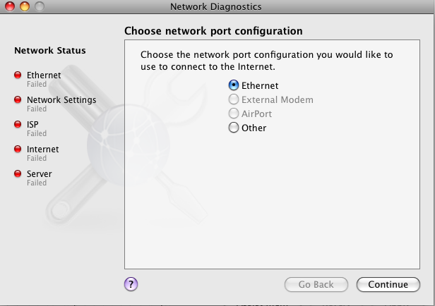

stelriah Posted November 21, 2007 Share Posted November 21, 2007 I used the attached kexts without editing them and my card works now. But I can only connect using the Assist Me>Diagnostics in system preferences. Link to comment https://www.insanelymac.com/forum/topic/40317-how-toatheros-ar5212-based-cards-now-w-leopard/page/5/#findComment-513289 Share on other sites More sharing options...

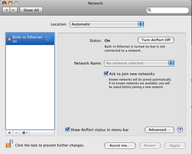

hotmonkeayc Posted November 22, 2007 Share Posted November 22, 2007 I've got a weird issue. I can't install Leopard as a fresh install (long story) so I install Tiger (macdotnub) and then upgrade to Leopard. When I boot up, I notice that I don't have a /Library/Preferences/SystemConfiguration/NetworkInterfaces.plist file. Is this common? Is there a fix to this? I am using a WG311T Wireless PCI card. It always worked fine in Tiger, just not Leopard. Can someone post their NetworkInterfaces.plist file or something? Link to comment https://www.insanelymac.com/forum/topic/40317-how-toatheros-ar5212-based-cards-now-w-leopard/page/5/#findComment-514461 Share on other sites More sharing options...
prototype_sx Posted November 22, 2007 Share Posted November 22, 2007 Can you connect? Link to comment https://www.insanelymac.com/forum/topic/40317-how-toatheros-ar5212-based-cards-now-w-leopard/page/5/#findComment-514491 Share on other sites More sharing options...
hotmonkeayc Posted November 22, 2007 Share Posted November 22, 2007 No actually, the only thing that is showing up is Network is "Ethernet", and it's showing up as "Not Connected". It should only be seeing the Wireless PCI card as I have disabled the onboard LAN adapter. Isn't it weird that I don't have a NetworkInterfaces.plist file? Link to comment https://www.insanelymac.com/forum/topic/40317-how-toatheros-ar5212-based-cards-now-w-leopard/page/5/#findComment-514500 Share on other sites More sharing options...
hotmonkeayc Posted November 22, 2007 Share Posted November 22, 2007 Ok, so I'm completely baffled, maybe someone can help me before I pull my hair out. I've got a Dell E520 and a Netgear WG311T PCI Card. I've never had a problem with the Airport thing in Tiger (v10.4.10 macdotnub). After I upgrade to Leopard I'm getting problems. I've tried the original IO80211Family.kext & IOPCCardFamily.kext, BugsBunny's and Chipxsd's (original Leopard ones)... here's what I'm running into: When using both BugsBunny's and Chipxsd's kexts and setting my NetworkInterfaces.plist to en1 I am getting the following: Built in Ethernet is showing "Not Connected" Airport is showing "Off" I cannot turn "On" airport When I try to use assist->diag->airport->use airport, it just searches and never finds anything Now, when using both BugsBunny's and Chipxsd's kexts and setting my NetworkInterfaces.plist to en0 I am getting the following (this is where it gets weird): Built In Ethernet is showing "On" (see picture) Airport is missing I have an option to "Turn Airport Off", eventhough it's not there When I search for a network they show up (see pictures) When I try to connect to my WPA Network, I get "Error in connection" If I try to use "Assist->Diag->" I don't have an option for airport, just ethernet... and it doesn't work Now, I KNOW I'M GETTING CLOSE because I can at least see my networks. However, I can't connect. CAN ANYONE SUGGEST ANYTHING? PLEASE HELP! It's 1:30am, time for bed. Link to comment https://www.insanelymac.com/forum/topic/40317-how-toatheros-ar5212-based-cards-now-w-leopard/page/5/#findComment-514618 Share on other sites More sharing options...

hotmonkeayc Posted November 22, 2007 Share Posted November 22, 2007 Had exactly the same problem. I found that en0 was also found in the preferences.plist - changed the two incidences of it in here to en1 and connected on reboot without a problem. This is possibly the problem with the having to go thought the network assistant thing everytime too. Hope it help some folks I'm using the 1.5 kexts DUDE!!! This worked (somewhat)! Basically I changed both instances of en0 to en1 in preferences.plist and made sure my NetworkInterfaces.plist has en1. Now I can connect, but ONLY using the Assistant, which is quite annoying, but still better than nothing...and when doing so, I still get the empty airport icon in the system bar that says "Airport: Not configured". I also still get the "Connection Failed" if I try to just connect without the Assistant. Did you change anything else in preferences.plist? Does anyone have any ideas as to why this would happen to me and not to azaraphale? It seems like we have the same config. Thanks again!! Link to comment https://www.insanelymac.com/forum/topic/40317-how-toatheros-ar5212-based-cards-now-w-leopard/page/5/#findComment-514975 Share on other sites More sharing options...
