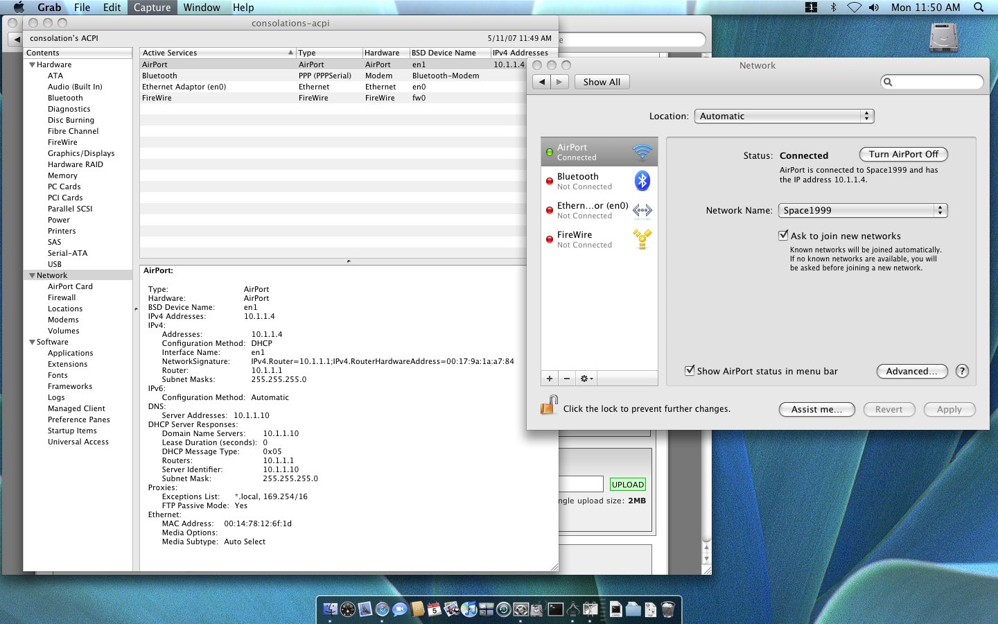

chipxsd Posted November 4, 2007 Share Posted November 4, 2007 I don't know if others found out a way to connect to a secured wireless connection with the Tiger kext? ... but I think I have found a solution: You have to use the 'Assist me' -> 'Diagnostics', to connect to your secured connection, it worked fine for me. I took the liberty to include screenshots in this post, so you can see how I did it... This image show my computer connected to an unsecured wifi connection (apparently my neighbor's access point, not mine) This is the network I want to join (that's my AP with WPA/PSK enabled) If I try to join this network, it doesn't work (Connection failed, though the password is right) I had to use the System Preferences -> Network -> Assist me... -> Diagnostics -> AirPort -> ... to get me connected to my access point Here you see me connected to my secured wifi connection Link to comment https://www.insanelymac.com/forum/topic/40317-how-toatheros-ar5212-based-cards-now-w-leopard/page/3/#findComment-494824 Share on other sites More sharing options...
consolation Posted November 4, 2007 Author Share Posted November 4, 2007 chipxsd that's a work of bloody genius, but, can you confirm that you are running the leo kext? I can get this to work, but only if I use the 10.4.8 kext. Oh, and my task bar icon doesn't work. If I try to use the leo kernel I get a hanged system. Notice the bar icon on the sceenshot. Anyhow, I'll update the first post to reflect this method when I have a moment. screenie: Link to comment https://www.insanelymac.com/forum/topic/40317-how-toatheros-ar5212-based-cards-now-w-leopard/page/3/#findComment-494869 Share on other sites More sharing options...
chipxsd Posted November 4, 2007 Share Posted November 4, 2007 Sorry to disappoint you, but as I said, I'm using Tigers kext. The only thing I did with the kernel extensions was, I disabled the 10.5's IO80211Family.kext by renaming it's directory name from .kext to something else (.kext.disabled), and copied the 10.4.8's kext into the /extensions directory. drwxr-xr-x 3 root wheel 102 Oct 12 03:50 GeForceGA.plugindrwxr-xr-x 3 root wheel 102 Oct 12 03:51 GeForceVADriver.bundle drwxr-xr-x 3 root wheel 102 Oct 10 06:48 I2CGPIO.kext drwxr-xr-x 3 root wheel 102 Sep 29 07:05 ICAClassicNotSeizeDriver.kext drwxr-xr-x 3 root wheel 102 Sep 29 07:11 ICAFWKodakProDriver.kext drwxr-xr-x 3 root wheel 102 Aug 9 2006 IO80211Family-Tiger.kext - this is the 10.4.8 kext drwxr-xr-x 3 root wheel 102 Oct 10 06:48 IO80211Family.kext.disabled - this is the 10.5 kext drwxr-xr-x 3 root wheel 102 Oct 10 06:48 IOACPIFamily.kext drwxr-xr-x 3 root wheel 102 Oct 10 06:45 IOADBFamily.kext drwxr-xr-x 3 root wheel 102 Oct 3 20:42 IOAHCIFamily.kext drwxr-xr-x 3 root wheel 102 Oct 3 20:42 IOATAFamily.kext But I think this has got nothing to do with the success of 10.4.8 kext connecting to secured wifi connections. ps: and one problem still remains, it doesn't connect automatically when you boot in to the system ps2: how did you get your system profiler to work? Mine crashes immediately when I run it. And if I run it in shell (system_profiler), it gives me a 'Floating point exception' Link to comment https://www.insanelymac.com/forum/topic/40317-how-toatheros-ar5212-based-cards-now-w-leopard/page/3/#findComment-494885 Share on other sites More sharing options...
