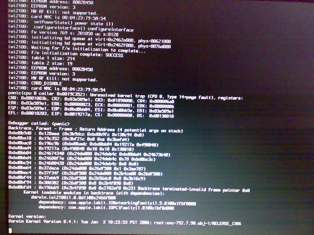

ttorok Posted April 29, 2007 Share Posted April 29, 2007 iwi2100 latest version: panic. Link to comment https://www.insanelymac.com/forum/topic/36976-intel-wireless-driver/page/79/#findComment-355571 Share on other sites More sharing options...
jalavoui Posted April 29, 2007 Author Share Posted April 29, 2007 iwi2100 rev fixed last panic bug iwi3945 rev more code fixing i'm unable to commit to svn - so here are the files i don't have a clue on the iwi3945 bug mensioned above - i hope someone finds the solution i've tested the apple update for 10.4.9 (SecUpd2007-004Univ.dmg) i recommend it to all iwi users iwi2100.dmg iwi3945.dmg Link to comment https://www.insanelymac.com/forum/topic/36976-intel-wireless-driver/page/79/#findComment-355696 Share on other sites More sharing options...

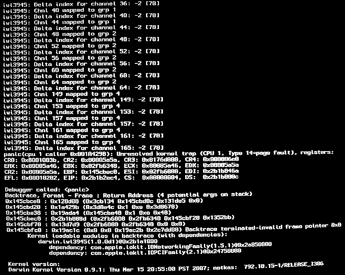

jalavoui Posted April 30, 2007 Author Share Posted April 30, 2007 logs from latest iwi3945 why do you have en3 as the iwi interface? do you have 4 network interfaces? iwi3945 for last bug, maybe this will help for vendor/id switch (pci_id) { case 0x42221005: /* 0x4222 0x8086 0x1005 is BG SKU */ case 0x42221034: /* 0x4222 0x8086 0x1034 is BG SKU */ case 0x42271014: /* 0x4227 0x8086 0x1014 is BG SKU */ case 0x42221044: /* 0x4222 0x8086 0x1044 is BG SKU */ svn is still bogus, so here are the new versions if you get panic at boot, post the picture so i can try to fix it iwi2100.dmg iwi3945.dmg Link to comment https://www.insanelymac.com/forum/topic/36976-intel-wireless-driver/page/79/#findComment-356178 Share on other sites More sharing options...

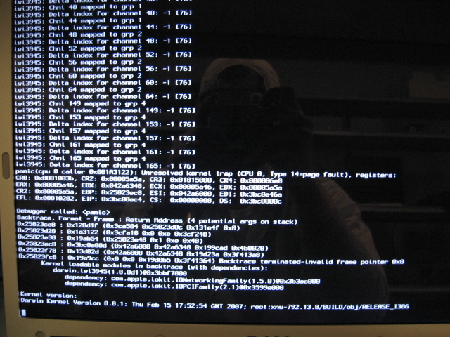

LordNite Posted April 30, 2007 Share Posted April 30, 2007 my screens of panic osxscreens.zip Link to comment https://www.insanelymac.com/forum/topic/36976-intel-wireless-driver/page/79/#findComment-356213 Share on other sites More sharing options...
Airfly Posted April 30, 2007 Share Posted April 30, 2007 last rev of iwi3945. cause panic. i took the photo use -s and kextload iwi3945.kext. Link to comment https://www.insanelymac.com/forum/topic/36976-intel-wireless-driver/page/79/#findComment-356234 Share on other sites More sharing options...
cmanbrown Posted April 30, 2007 Share Posted April 30, 2007 why do you have en3 as the iwi interface? do you have 4 network interfaces? iwi3945 for last bug, maybe this will help for vendor/id switch (pci_id) { case 0x42221005: /* 0x4222 0x8086 0x1005 is BG SKU */ case 0x42221034: /* 0x4222 0x8086 0x1034 is BG SKU */ case 0x42271014: /* 0x4227 0x8086 0x1014 is BG SKU */ case 0x42221044: /* 0x4222 0x8086 0x1044 is BG SKU */ svn is still bogus, so here are the new versions if you get panic at boot, post the picture so i can try to fix it Screen shot of panic from latest version: Link to comment https://www.insanelymac.com/forum/topic/36976-intel-wireless-driver/page/79/#findComment-356237 Share on other sites More sharing options...
