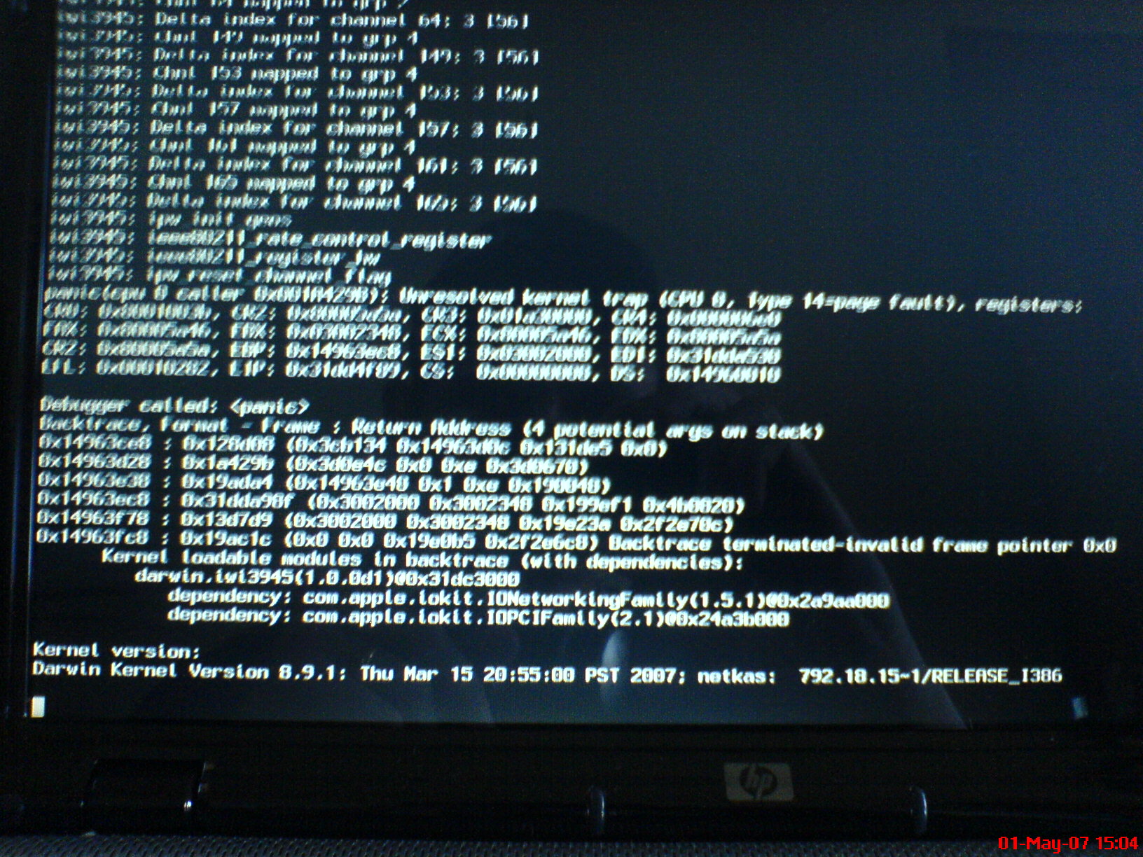

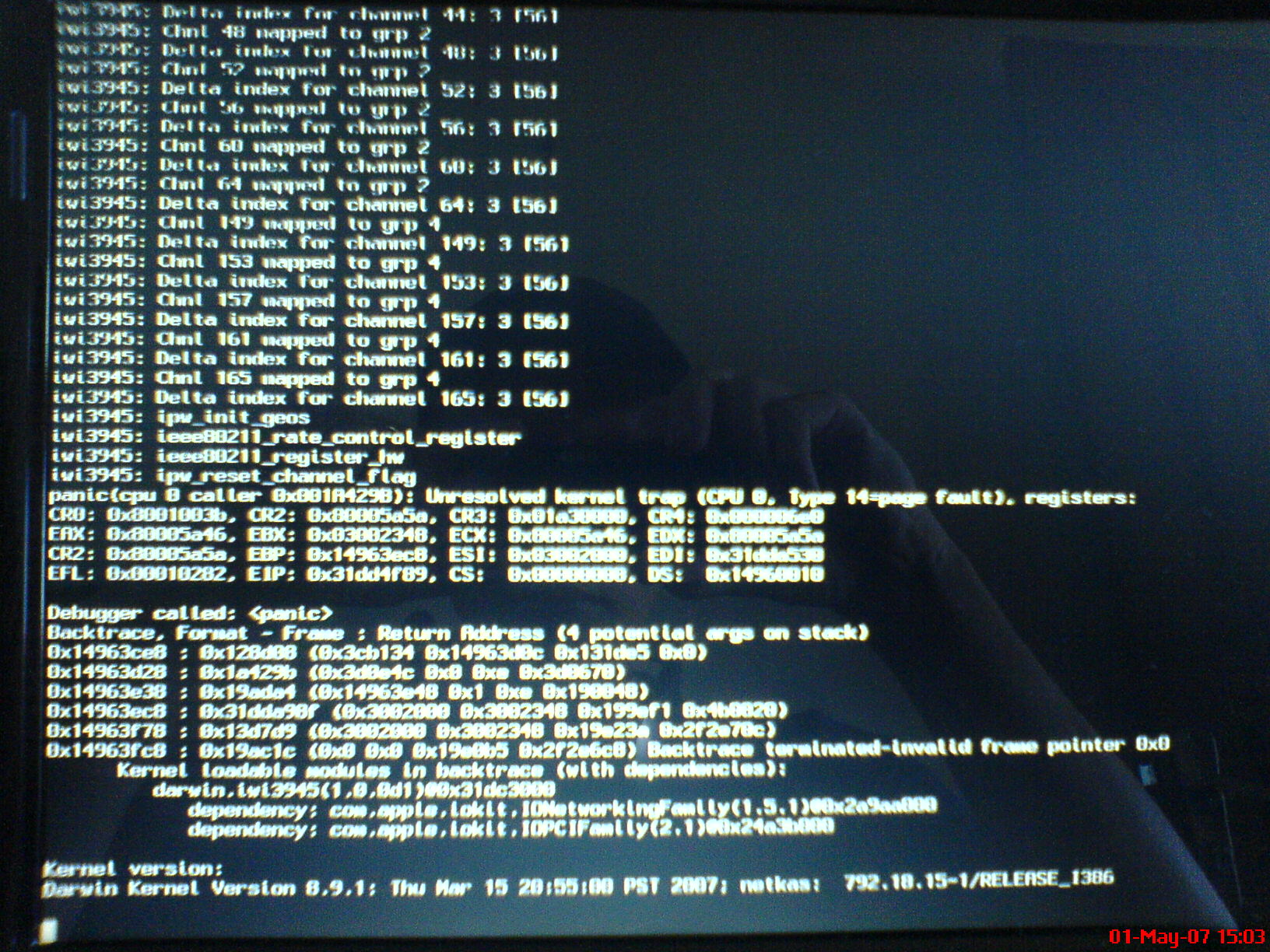

ipw_bg_alive_Start() test - this can panic
I'm going to tackle that function tonight. Unfortunately, all I can do during the day is keep up with the forum and think of things to do. I probably won't have anything to release tonight but we'll see.

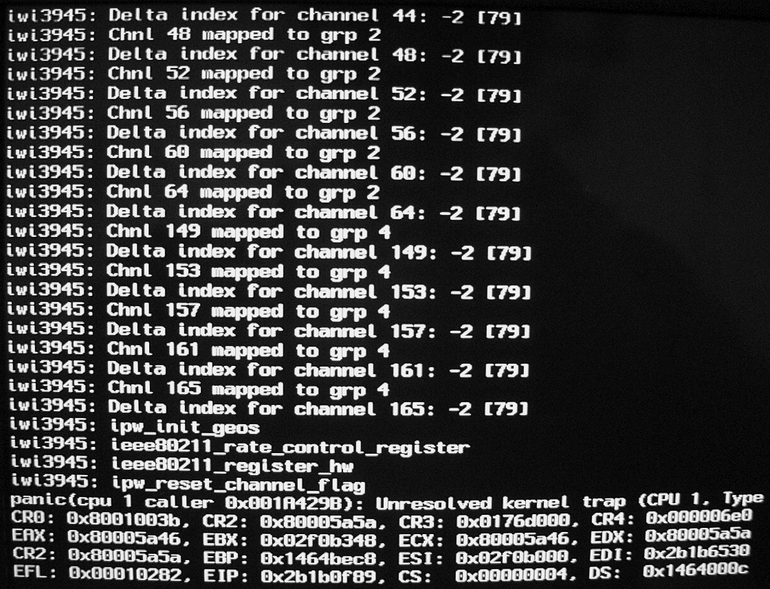

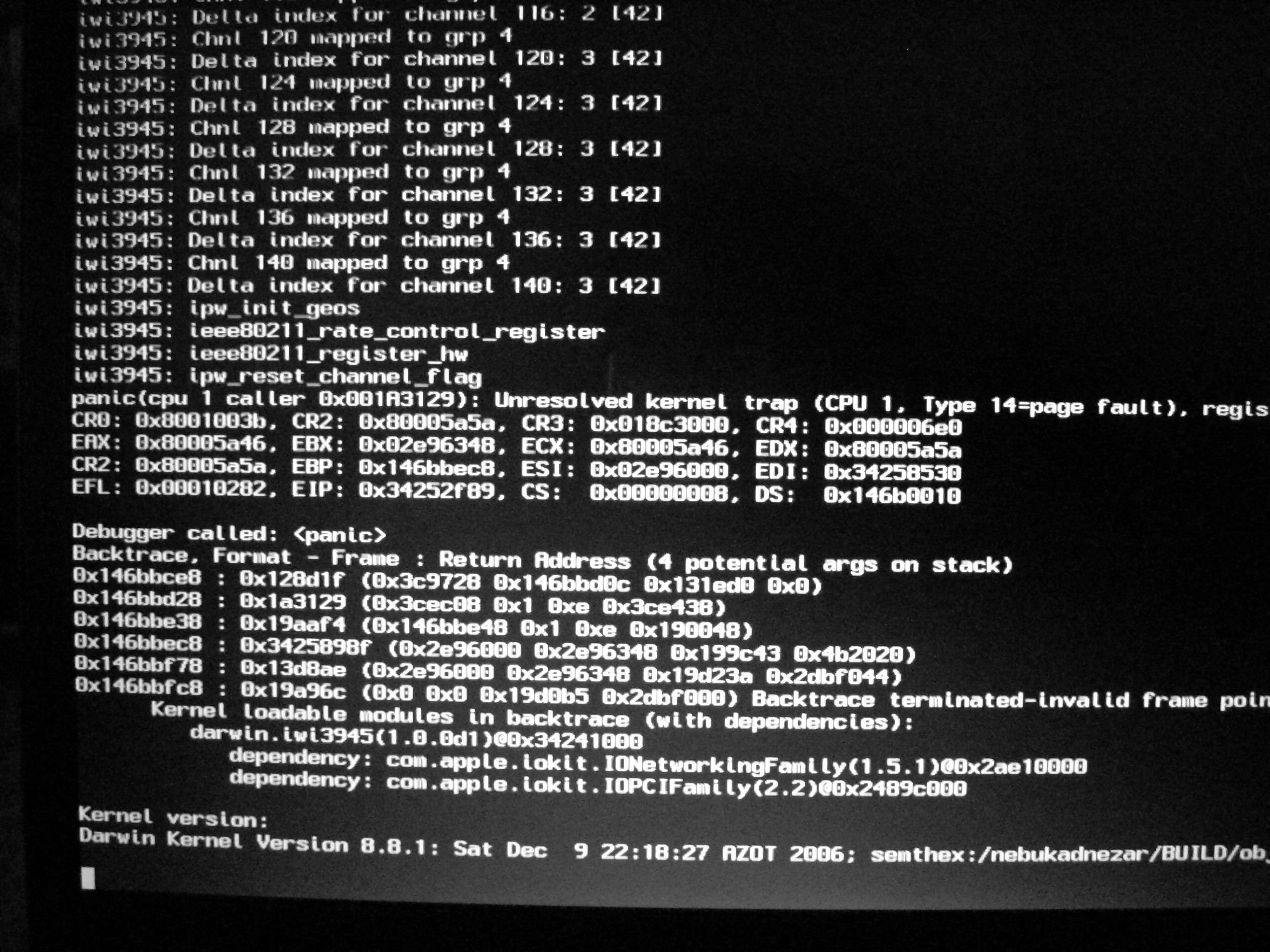

Jalavoui, I made a check on my notebook, it crashed when run to list_for_each_entry(hw_mode, &local->modes_list, list) in ipw_reset_channel_flag()
Airfly,
i've wrote missing functions for this - can you check it?
