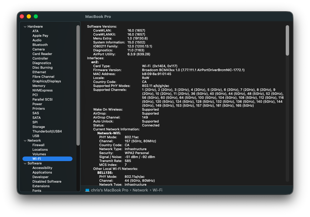

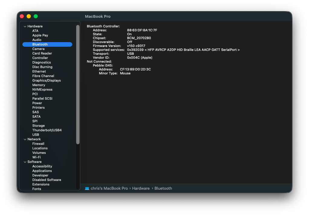

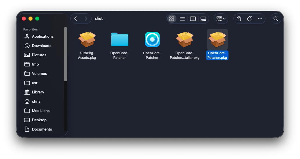

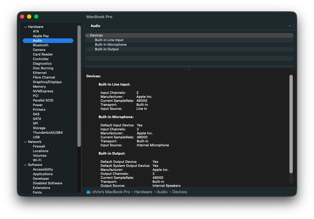

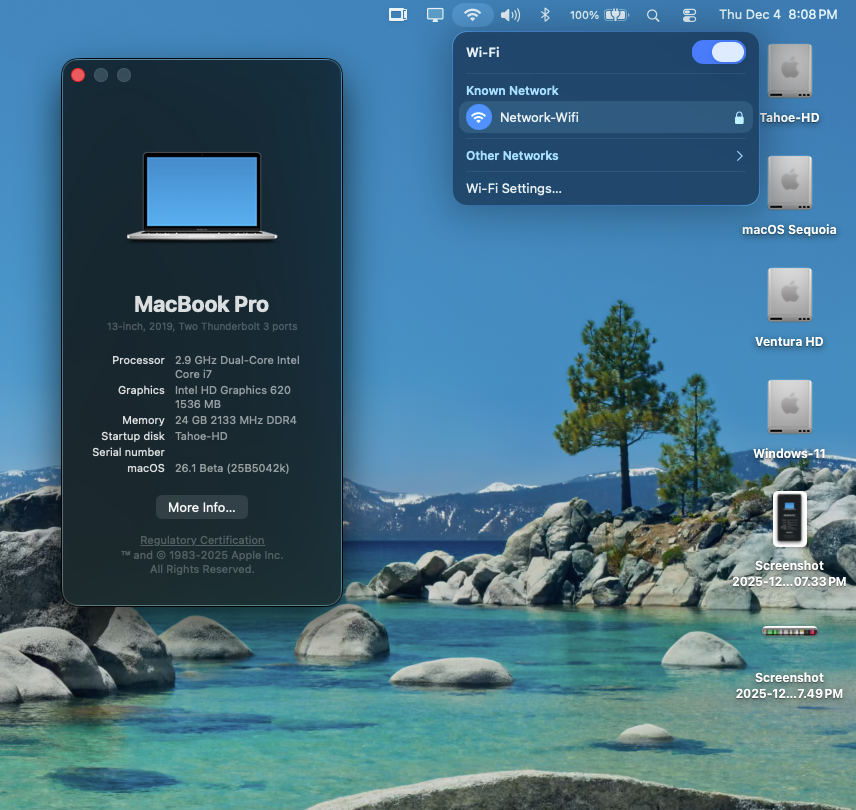

I have fork this project for testing, then Building OpenCore-Patcher.pkg from CLI
It Work on HP Elitebook 840 G4 with a BCM94360NG Wi-Fi and Bluetooth Card
Big Thanks to Hoang Hong Quan lzhoang2801
Testing and working on macos Tahoe 26.1 Beta (25B5042k)
Edited by chris1111
  • Like 4
  • Thanks 3

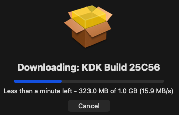

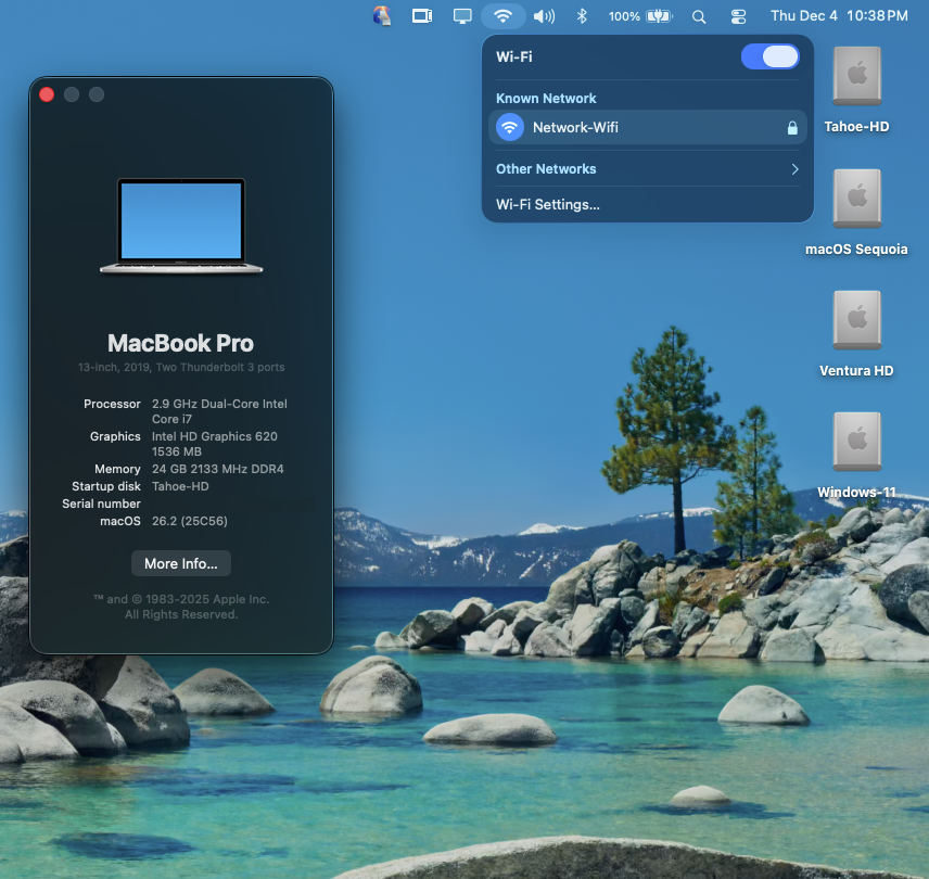

I'm using Intel Wi-Fi on my HackBookPro6,2, so it only needs audio patches.  I created an experimental Tahoe 26.2 RC1 volume and applied AppleHDA post-install patch with lzhoang2801's Experimental Patcher.  Since I only applied audio patches, my config is as follows:
  • csr-active-config = <03080000>
  • AMFIPass.kext 1.4.1 (No need for boot-arg amfi=0x80, since I'm not applying Wi-Fi patches)
  • Open Core 1.0.6
  • Tahoe 26.2 (25C56)
  • Multi-booting with grub: Windows 11, Ubuntu 24.04, macOS Monterey, Sequoia, Tahoe - with grub, SIP settings are different for each macOS depending on my testing needs (e.g. SIP fully enabled for Sequoia, but partially disabled for Tahoe / patches)
Detected need for Audio Patching
Spoiler
Download KDK
Spoiler
Thank you KGP-iMacPro for renaming this thread and inserting warnings to avoid confusion with the official OCLP.  Thank you lzhoang2801 for your effort and for modifying the labeling and adding a warning to your GitHub repo to make it clear that this is not OCLP from the original Devs.
Spoiler

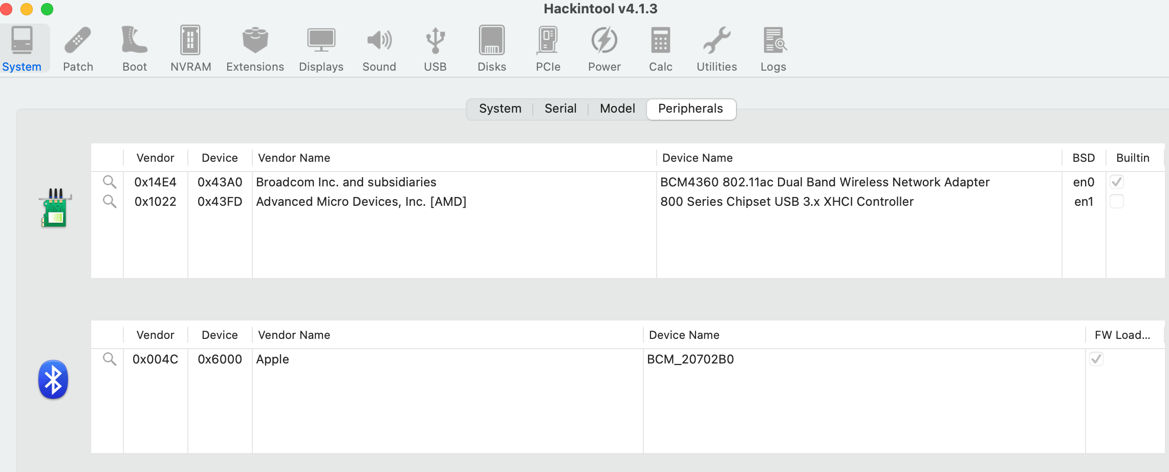

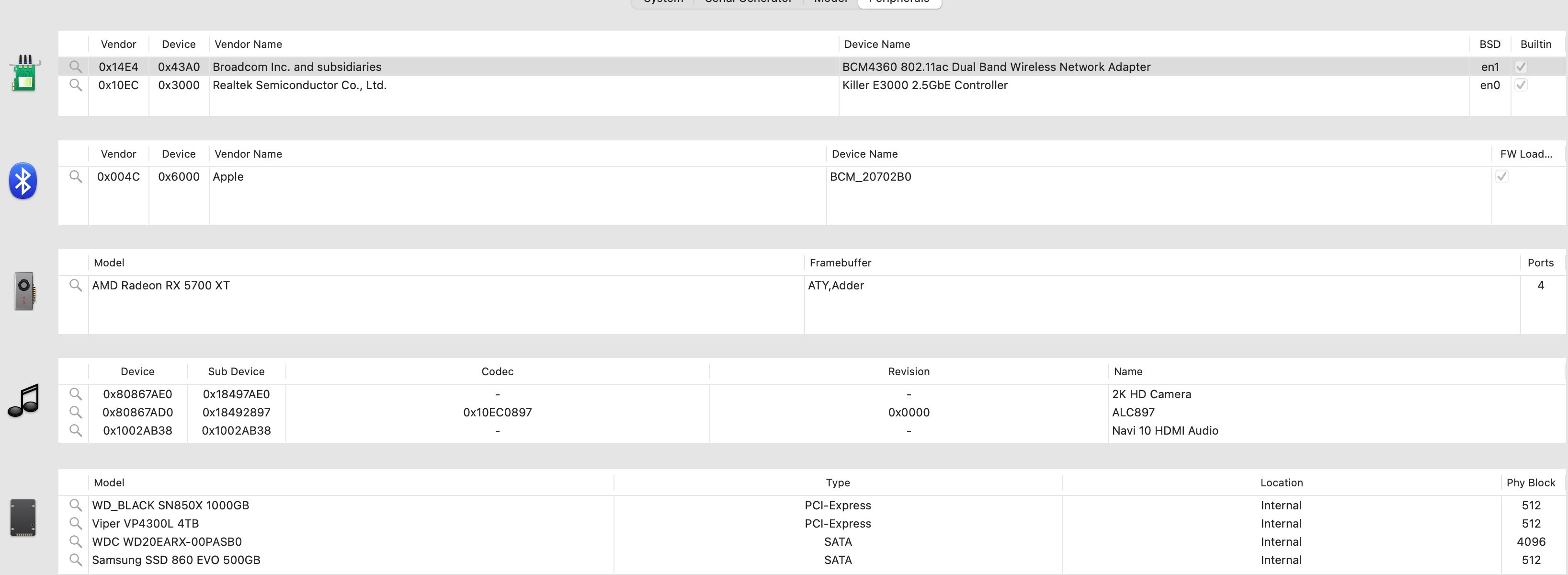

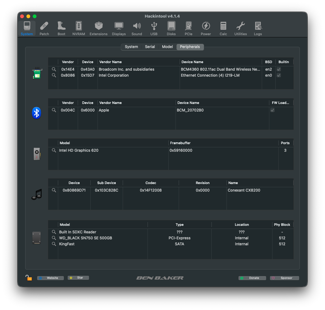

2 hours ago, MakAsrock said:
Unfortunately, on Mac OS Tahoe, my BCM4360 802.11ac Dual Band Wireless Network Adapter (0x14E40x43A0 Broadcom Inc.) did not work.
it is weird i have the same of yours card ( it seems)
and it works well
I had to modify a kernel patches useful for AMD system
Edited by fabiosun
Add images
If you want, you can upload your EFI-Folder, thus we can have a look to it and likely help if there is some issue. 😉

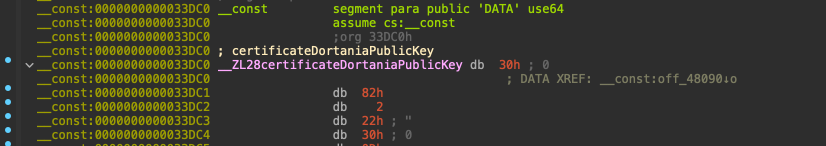

Maybe it's not AMFIPass that is invalid, just because AMFIPass does not include all self-signed binary documents in the exemption list?
It seems that it just intercepts the AMFIGetLocalSigningPublicKey method and uses the public key corresponding to the self-signed certificate to pass the AMFI verification.
But AMFIPass is only built-in with the public key of Dortania Software Signing.
This is a very interesting Lilu plug-in... I especially want to learn how it bypasses AMFI. I don't know if @dhinakg will open source his code, haha.
Edited by laobamac_yyds

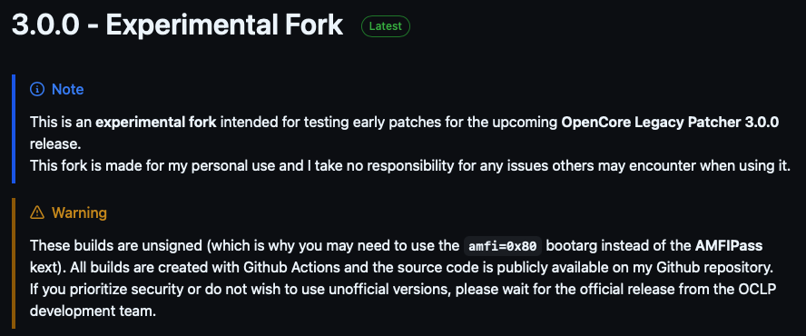

Moreover Izhoang2801 clearly states now in his repository: These builds are unsigned (which is why you may need to use the amfi=0x80 bootarg instead of the AMFIPasskext).
Edited by KGP-iMacPro
i am referring to this
if it is working in my rig...could work also in all rigs :)
36 minutes ago, MakAsrock said:
All current EFI folders are in my profile repository on GitHub. Wi-Fi doesn't work because this fork isn't from Dortania at all. I used the OCLP 3.0.0 nightly build from here. By the way, if anyone needs it, hurry up to download (It does not require amfi=0x80 boot-arg).
what is the exact model wifi card brand you have?
