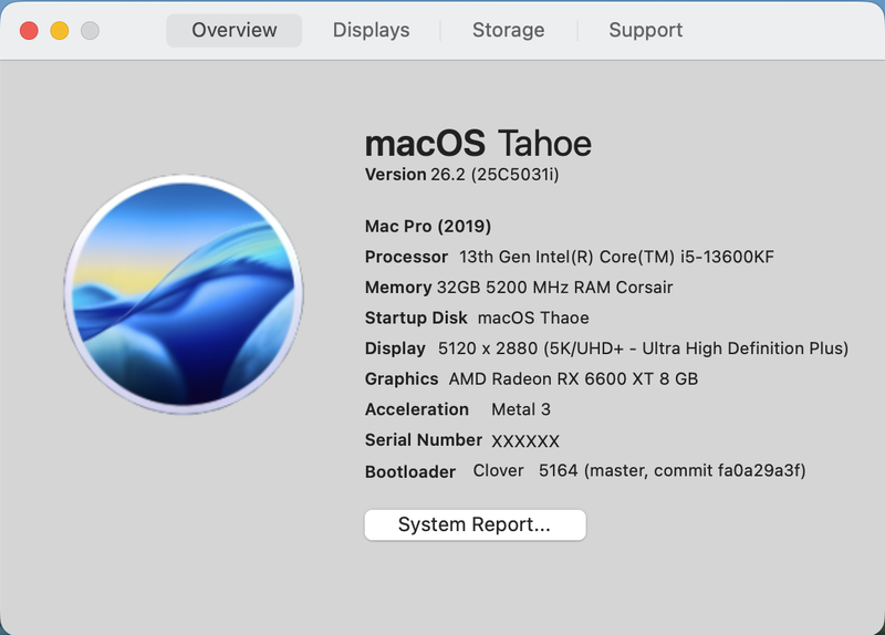

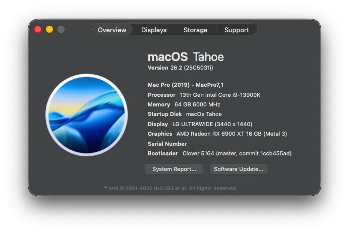

Max.1974 Posted November 7, 2025 Share Posted November 7, 2025 NootRX smooth update and Clover 5164 8 Link to comment https://www.insanelymac.com/forum/topic/361923-pre-release-macos-tahoe-262/page/2/#findComment-2843353 Share on other sites More sharing options...

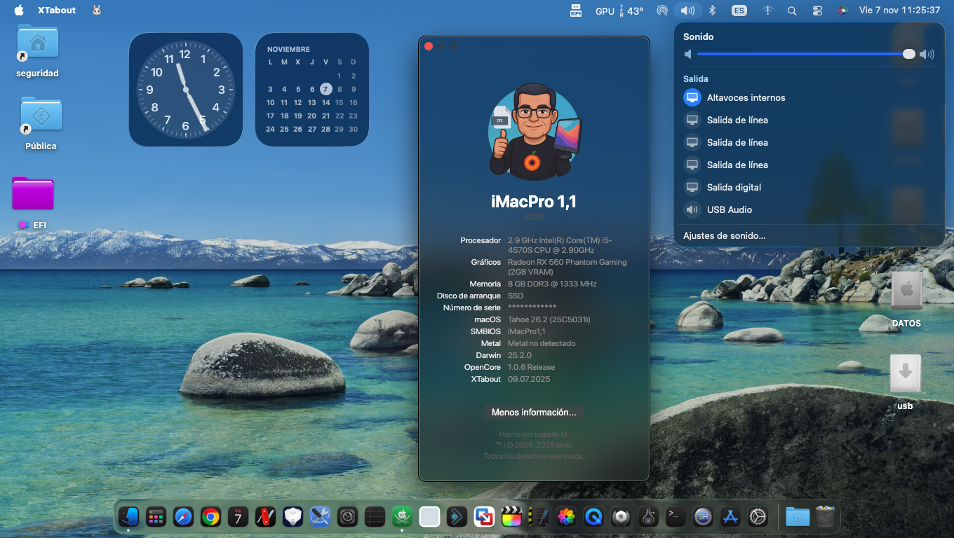

kaoskinkae Posted November 7, 2025 Share Posted November 7, 2025 perfect en OLD: with AppleHDA and (WhateverGreen-1.7.1d7 + + +) 3 Link to comment https://www.insanelymac.com/forum/topic/361923-pre-release-macos-tahoe-262/page/2/#findComment-2843358 Share on other sites More sharing options...

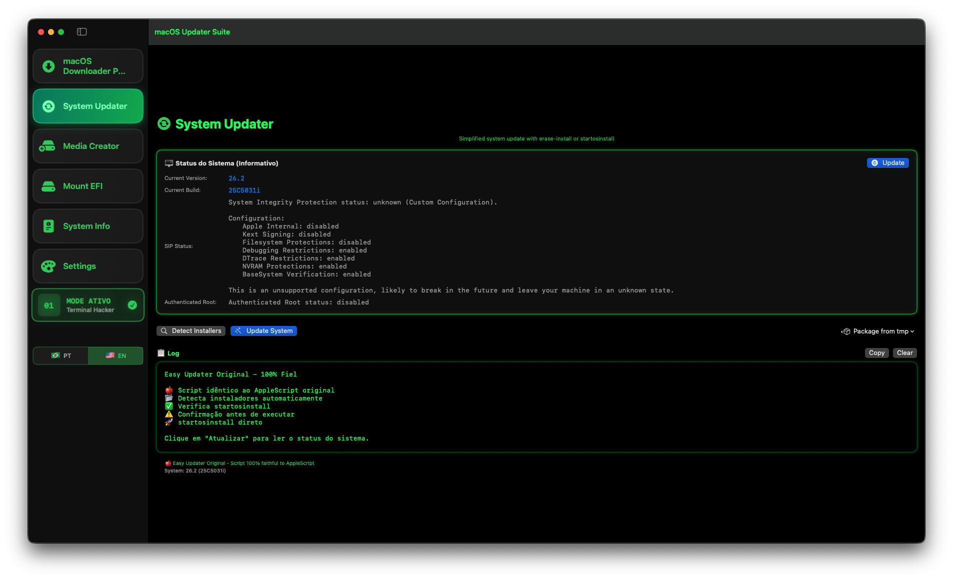

Max.1974 Posted November 9, 2025 Share Posted November 9, 2025 Update smooth again macOs Updater Suite 8 Link to comment https://www.insanelymac.com/forum/topic/361923-pre-release-macos-tahoe-262/page/2/#findComment-2843439 Share on other sites More sharing options...

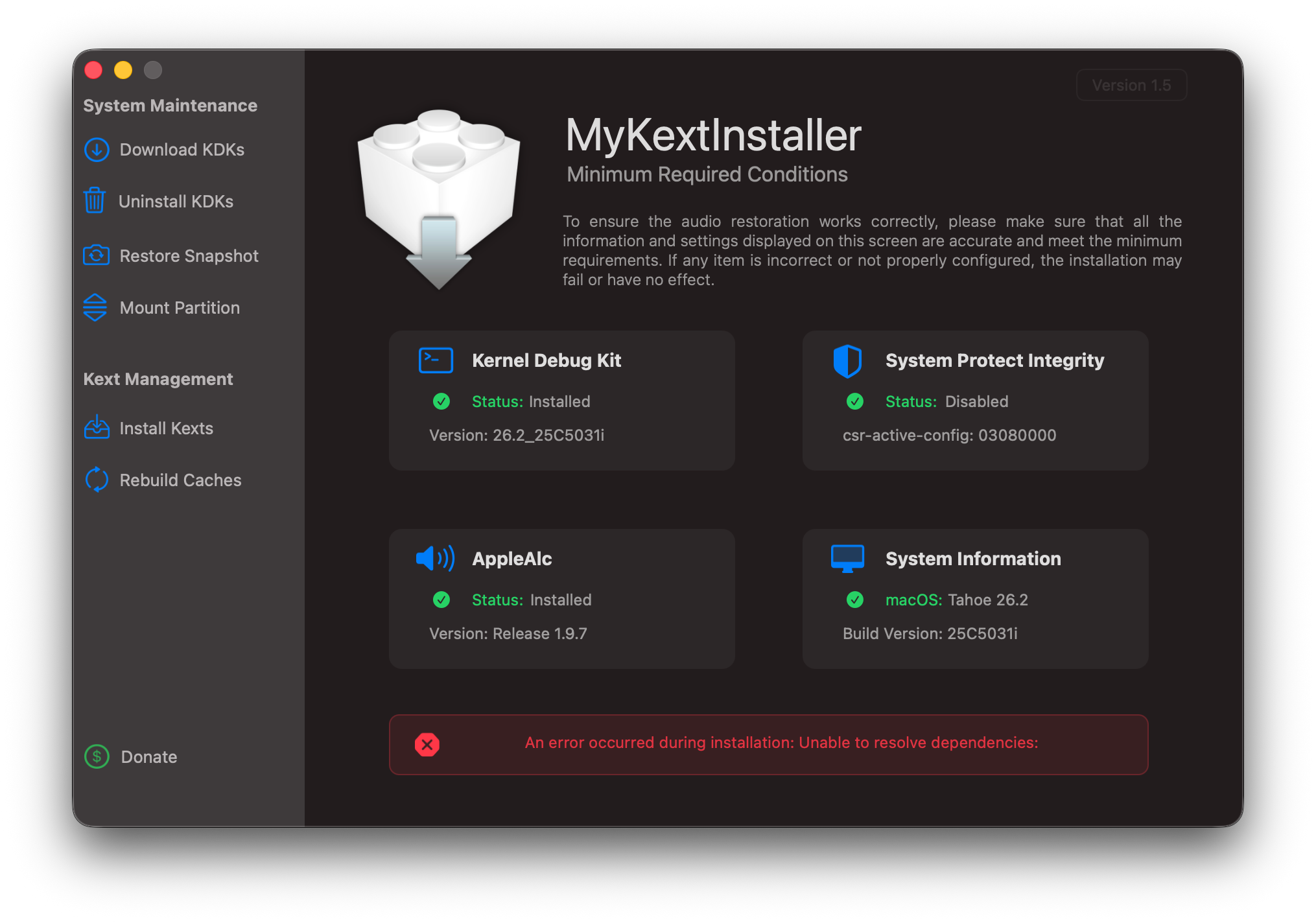

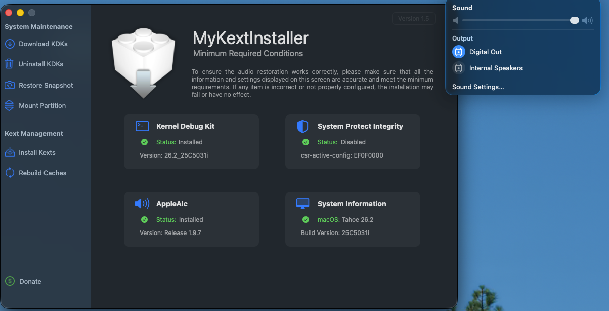

Fory360 Posted November 10, 2025 Share Posted November 10, 2025 I executed the recommended commands, but the installation still throws an error. Regards. sudo rm -f /Library/LaunchDaemons/com.mirone.MyKextInstaller.Helper.plist sudo rm -f /Library/PrivilegedHelperTools/com.mirone.MyKextInstaller.Helper 1 Link to comment https://www.insanelymac.com/forum/topic/361923-pre-release-macos-tahoe-262/page/2/#findComment-2843469 Share on other sites More sharing options...
kaoskinkae Posted November 10, 2025 Share Posted November 10, 2025 1 hour ago, Fory360 said: Ejecuté los comandos recomendados, pero la instalación sigue dando un error. Saludos. sudo rm -f /Library/LaunchDaemons/com.mirone.MyKextInstaller.Helper.plist sudo rm -f /Library/PrivilegedHelperTools/com.mirone.MyKextInstaller.Helper I had the same problem as you; the command didn't work, but completely uninstalling it with an application like "AppeClean" and then downloading and installing it from the creator's website did. 1 Link to comment https://www.insanelymac.com/forum/topic/361923-pre-release-macos-tahoe-262/page/2/#findComment-2843474 Share on other sites More sharing options...

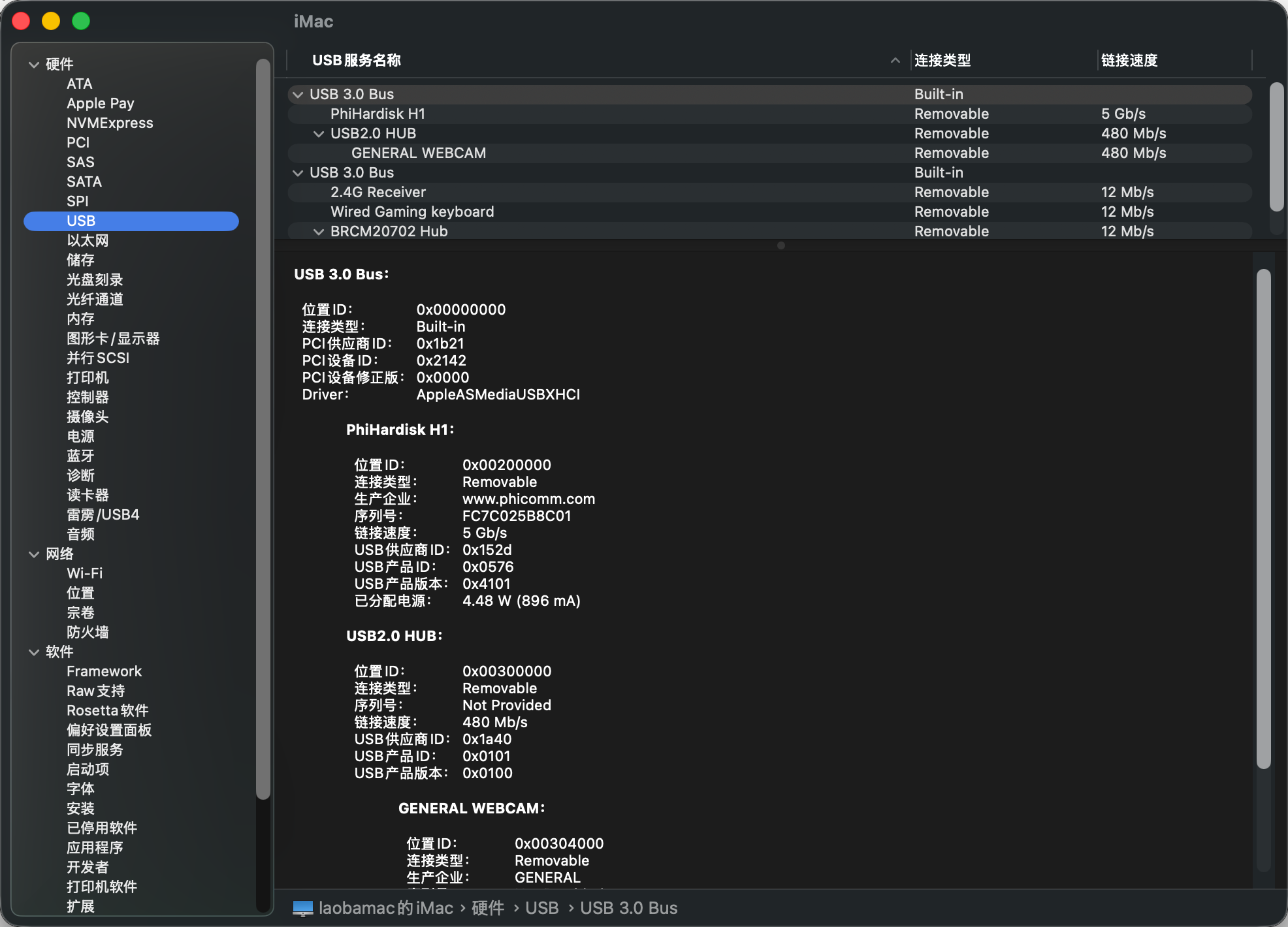

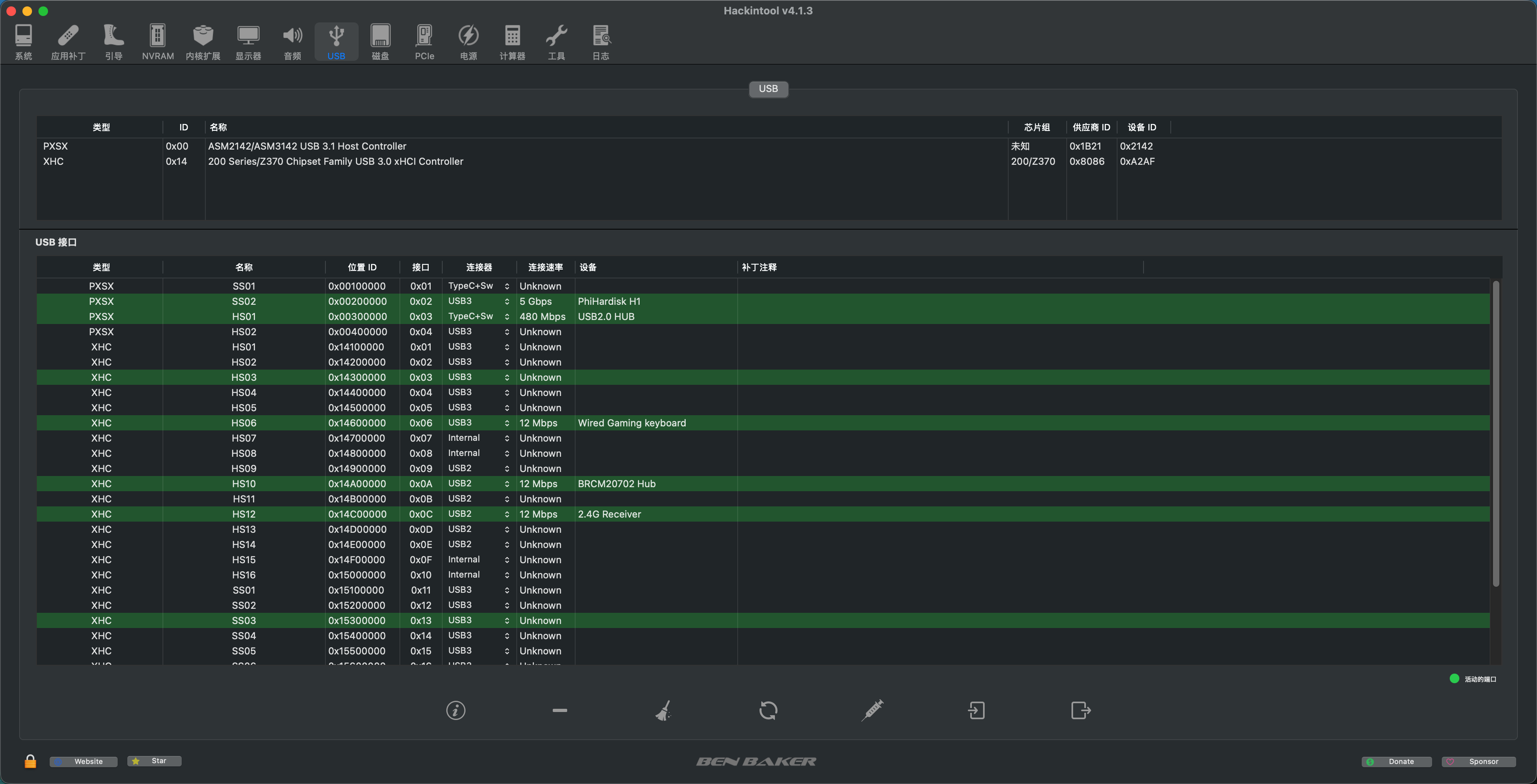

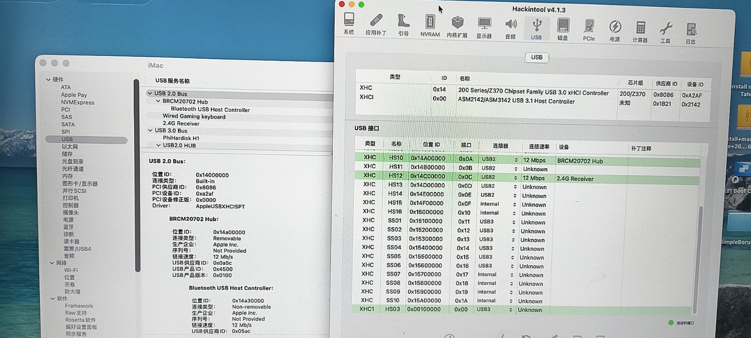

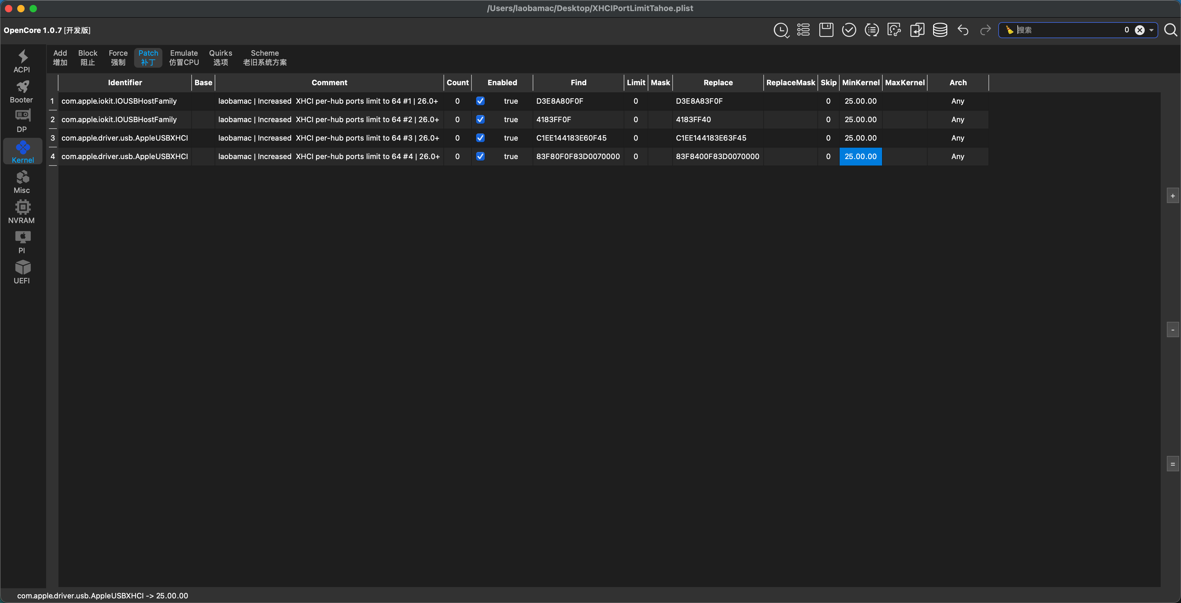

laobamac_yyds Posted November 10, 2025 Share Posted November 10, 2025 Successfully completed the crack of the limit on the number of XHCI controller 15 ports for macOS Tahoe. Please disable Kernel -> Quirks -> XHCIPortLimit and load the patch I made. After successful patching: Spoiler Patch preview: Spoiler Patch file download: XHCIPortLimitTahoe.plist Notes: ①If you have installed the old USB environment extension of OCLP-Mod, please use Kernel -> Quirks -> XHCIPortLimit directly and do not use this patch. ②Be sure to disable Kernel -> Quirks -> XHCIPortLimit with this patch ③Maybe this patch will be merged into OpenCore in the future? But so far, there is none. This is the patch I made for BootKC of 26.2B1 using IDA decompilation. 10 5 Link to comment https://www.insanelymac.com/forum/topic/361923-pre-release-macos-tahoe-262/page/2/#findComment-2843476 Share on other sites More sharing options...

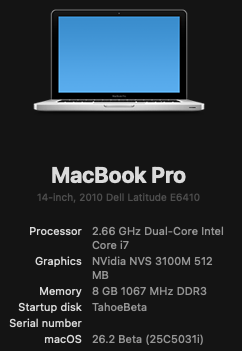

Alpha22 Posted November 10, 2025 Share Posted November 10, 2025 (edited) Update macOS Thaoe 26.2 Edited November 10, 2025 by Alpha22 5 Link to comment https://www.insanelymac.com/forum/topic/361923-pre-release-macos-tahoe-262/page/2/#findComment-2843480 Share on other sites More sharing options...
laobamac_yyds Posted November 10, 2025 Share Posted November 10, 2025 (edited) 27 minutes ago, eSaF said: Hi Bro what exactly is the advantage over the 15 port limit apart from having more ports at our disposal? As I see it the 15 limit works quit well as Apple intended. Forgive me if I'm missing something here as why you deemed the increased limit important or necessary. Cheers. To be honest, I don't think this has any advantages because a single controller with 15 ports is already sufficient for me to use. But what's annoying is that many machines lose their USB 3.0 Bus after upgrading to macOS Tahoe and all recognize it as 2.0. After investigating for a long time, it was found that SS and HS were identified as two port bits, because XHCI is backward compatible with EHCI. This results in only the HS* port being injected into these machines But when the 15 port restriction was lifted and SS* successfully recognized again, the 3.0 speed returned to normal. You can compare this picture with above 'after successfully patching' and see that the USB 2.0 Bus has been incorrectly identified. Edited November 10, 2025 by laobamac_yyds 7 1 Link to comment https://www.insanelymac.com/forum/topic/361923-pre-release-macos-tahoe-262/page/2/#findComment-2843483 Share on other sites More sharing options...
Max.1974 Posted November 10, 2025 Share Posted November 10, 2025 3 horas atrás, laobamac_yyds disse: Para ser honesto, não acho que isso tenha nenhuma vantagem porque um único controlador com 15 portas já é suficiente para eu usar. Mas o que é irritante é que muitas máquinas perdem seu barramento USB 3.0 após a atualização para o macOS Tahoe e todas o reconhecem como 2.0. Depois de investigar por um longo tempo, descobriu-se que SS e HS foram identificados como dois bits de porta, porque o XHCI é compatível com o EHCI. Isso resulta em apenas a porta HS* sendo injetada nessas máquinas. Mas quando a restrição de 15 portas foi levantada e a SS* foi reconhecida com sucesso novamente, a velocidade de 3,0 voltou ao normal. Você pode comparar esta imagem com a 'após o patch bem-sucedido' acima e ver que o barramento USB 2.0 foi identificado incorretamente. Thank you 1 Link to comment https://www.insanelymac.com/forum/topic/361923-pre-release-macos-tahoe-262/page/2/#findComment-2843493 Share on other sites More sharing options...
Pc Bacabal Posted November 10, 2025 Share Posted November 10, 2025 4 hours ago, laobamac_yyds said: To be honest, I don't think this has any advantages because a single controller with 15 ports is already sufficient for me to use. But what's annoying is that many machines lose their USB 3.0 Bus after upgrading to macOS Tahoe and all recognize it as 2.0. After investigating for a long time, it was found that SS and HS were identified as two port bits, because XHCI is backward compatible with EHCI. This results in only the HS* port being injected into these machines But when the 15 port restriction was lifted and SS* successfully recognized again, the 3.0 speed returned to normal. You can compare this picture with above 'after successfully patching' and see that the USB 2.0 Bus has been incorrectly identified. Thanks! Link to comment https://www.insanelymac.com/forum/topic/361923-pre-release-macos-tahoe-262/page/2/#findComment-2843495 Share on other sites More sharing options...

Fory360 Posted November 10, 2025 Share Posted November 10, 2025 8 hours ago, kaoskinkae said: I had the same problem as you; the command didn't work, but completely uninstalling it with an application like "AppeClean" and then downloading and installing it from the creator's website did. I followed your instructions, but the error persists. I tried using MyKextsInstaller 1.4 — the process completes, but after restarting, I have no audio. I’ll wait for version 1.6. On the last attempt with v1.5, it gave me this error. An error occurred during installation: Unable to resolve dependencies: 'com.apple.driver.AppleTopCaseHIDEventDriver' names a dependency on 'com.apple.iokit.IOHIDFamily', which was not found. Link to comment https://www.insanelymac.com/forum/topic/361923-pre-release-macos-tahoe-262/page/2/#findComment-2843499 Share on other sites More sharing options...
deeveedee Posted November 10, 2025 Share Posted November 10, 2025 @Fory360 This thread is dedicated to MyKextInstaller and is the best place for you to ask your questions. You may also want to look at this thread which discusses OCLP-Mod, an alternative to MyKextInstaller. Link to comment https://www.insanelymac.com/forum/topic/361923-pre-release-macos-tahoe-262/page/2/#findComment-2843500 Share on other sites More sharing options...
