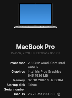

deeveedee Posted November 13, 2025 Share Posted November 13, 2025 (edited) The updates are getting easier. I first tried the update with BluetoolFixup.kext enabled, but it broke the incremental update, so I disabled BluetoolFixup.kext and the incremental OTA update proceeded without issues. Incremental Update Spoiler Specs HP Elitebook 850 G7 (i7-10610u) Open Core 1.0.6, SIP csr-active-config = <01000000> VoodooHDA.kext 3.0.3 Edited November 13, 2025 by deeveedee 6 Link to comment https://www.insanelymac.com/forum/topic/361923-pre-release-macos-tahoe-262/page/3/#findComment-2843612 Share on other sites More sharing options...

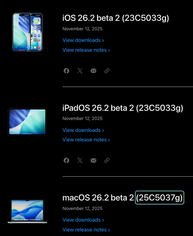

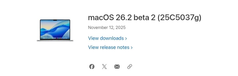

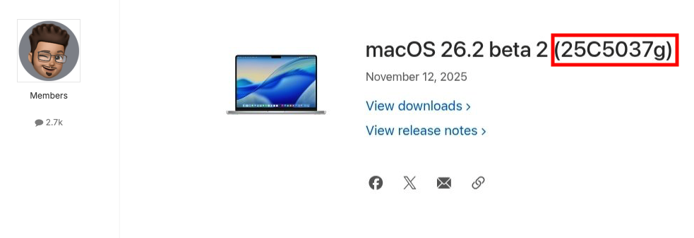

Oyecomova Posted November 13, 2025 Share Posted November 13, 2025 1 hour ago, eSaF said: Hide contents 26.2 (Build 25C5037j) vs OS 26.2 beta 2 (25C5037g).. ???? 3 Link to comment https://www.insanelymac.com/forum/topic/361923-pre-release-macos-tahoe-262/page/3/#findComment-2843613 Share on other sites More sharing options...
deeveedee Posted November 13, 2025 Share Posted November 13, 2025 (edited) 6 minutes ago, Oyecomova said: 26.2 (Build 25C5037j) vs OS 26.2 beta 2 (25C5037g).. ???? this says that the build version for developers is 25C5037j which is consistent with the posts. Note that I have seen articles referencing 25C5037g, but that's not what my hack is showing. Edited November 13, 2025 by deeveedee 2 Link to comment https://www.insanelymac.com/forum/topic/361923-pre-release-macos-tahoe-262/page/3/#findComment-2843614 Share on other sites More sharing options...
Anto65 Posted November 13, 2025 Author Share Posted November 13, 2025 https://developer.apple.com/news/releases/ Spoiler About this Mac , show Beta 26.2 (25C5037j) 🤔 😅 6 Link to comment https://www.insanelymac.com/forum/topic/361923-pre-release-macos-tahoe-262/page/3/#findComment-2843617 Share on other sites More sharing options...

deeveedee Posted November 13, 2025 Share Posted November 13, 2025 (edited) 7 hours ago, eSaF said: This is the latest Tahoe Beta Release!!! I don't know why your '???' post was warranted. Because @Anto65 's initial post indicates 25C5037g It was a simple, accurate observation. Nothing more. I don't know why the multiple exclamation marks and fiery anger were warranted. EDIT: Articles like this and this and others also indicate 25C5037g. There was clearly some confusion about the build number. No need to get upset about it. Edited November 13, 2025 by deeveedee 3 Link to comment https://www.insanelymac.com/forum/topic/361923-pre-release-macos-tahoe-262/page/3/#findComment-2843636 Share on other sites More sharing options...

BALDY_MAN Posted November 13, 2025 Share Posted November 13, 2025 im not reciving the 26.Beta 2 (25C5037g) in automatic updates only got Beta 26.2 (25C5037j) ? Link to comment https://www.insanelymac.com/forum/topic/361923-pre-release-macos-tahoe-262/page/3/#findComment-2843641 Share on other sites More sharing options...

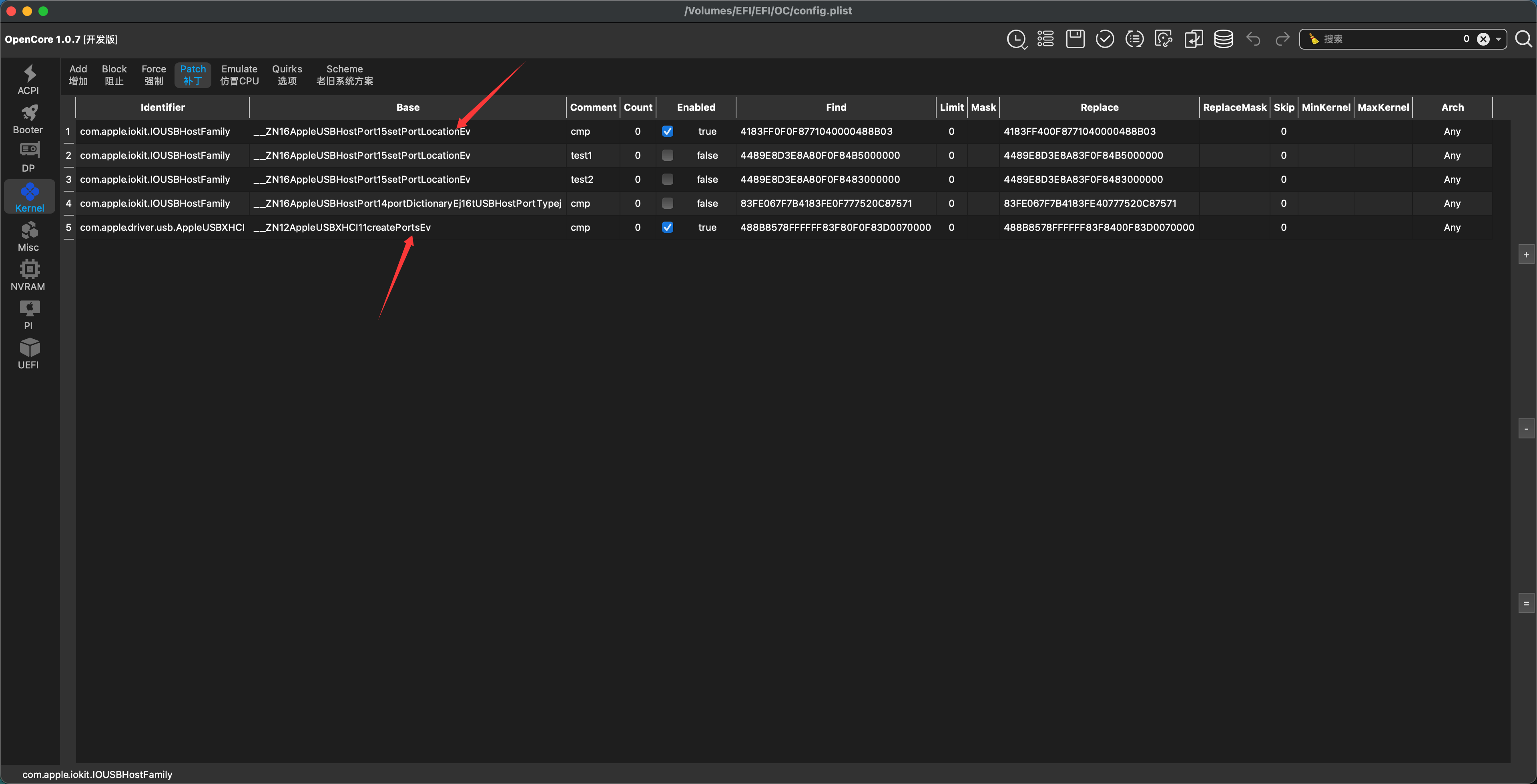

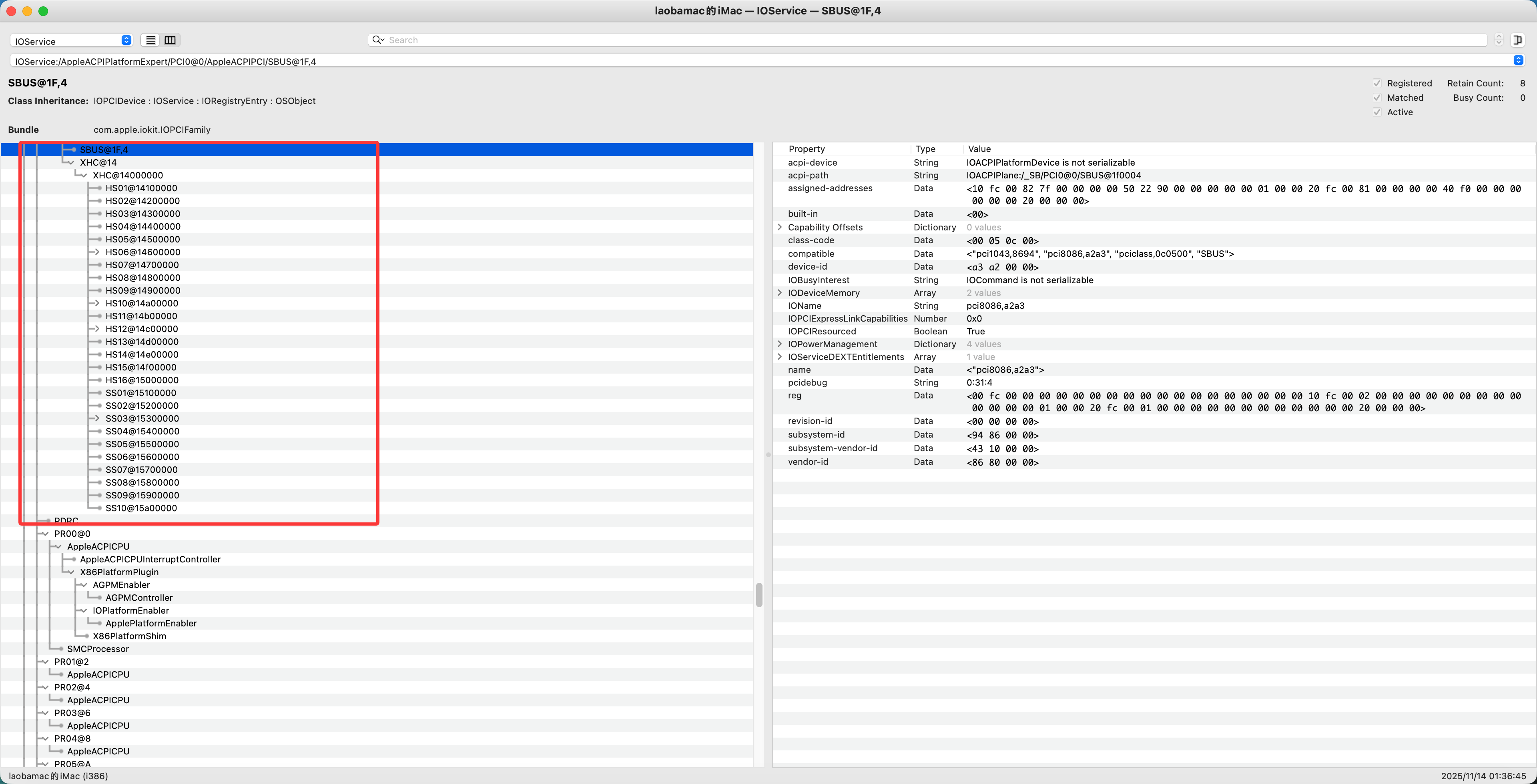

laobamac_yyds Posted November 13, 2025 Share Posted November 13, 2025 (edited) It seems that only need two patch of __ZN16AppleUSBHostPort15setPortLocationEv and __ZN12AppleUSBXHCI11createPortsEv to break through the limit on the number of USB ports. I don't know if this will improve the problem of USB2.0 failure caused by some motherboards after breaking through the limit on the number of USB ports? IOReg Screenshot : Spoiler Edited November 13, 2025 by laobamac_yyds 6 Link to comment https://www.insanelymac.com/forum/topic/361923-pre-release-macos-tahoe-262/page/3/#findComment-2843643 Share on other sites More sharing options...

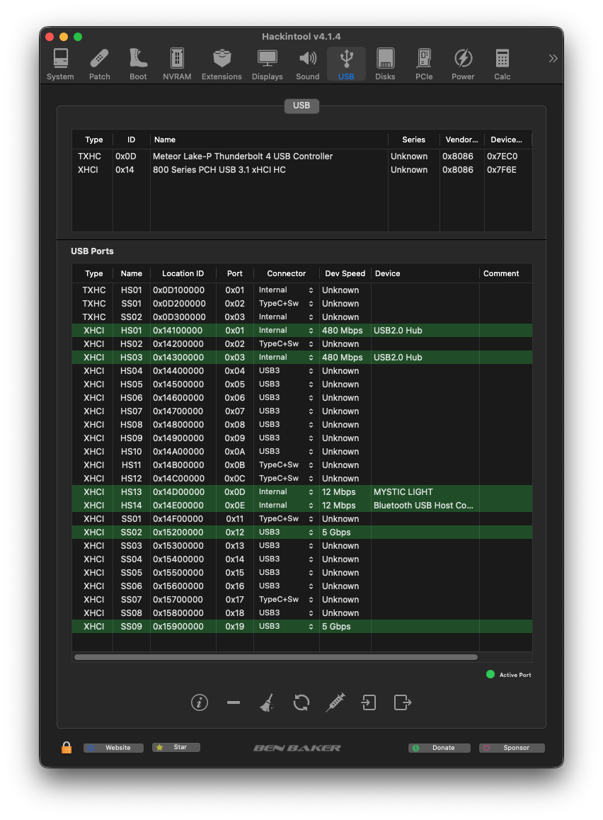

MaLd0n Posted November 13, 2025 Share Posted November 13, 2025 1 hour ago, laobamac_yyds said: It seems that only need two patch of __ZN16AppleUSBHostPort15setPortLocationEv and __ZN12AppleUSBXHCI11createPortsEv to break through the limit on the number of USB ports. Send me these patches. I can test it in my z890 and z790. 2 Link to comment https://www.insanelymac.com/forum/topic/361923-pre-release-macos-tahoe-262/page/3/#findComment-2843646 Share on other sites More sharing options...
laobamac_yyds Posted November 13, 2025 Share Posted November 13, 2025 3 minutes ago, MaLd0n said: Send me these patches. I can test it in my z890 and z790. here The two patches needed have been checked. XHCIPortLimitTahoe.plist I'll read your reply when I get back from school tomorrow night. It's 3:00 a.m. in China now. I'm going to have a rest first. Bye~ 10 Link to comment https://www.insanelymac.com/forum/topic/361923-pre-release-macos-tahoe-262/page/3/#findComment-2843648 Share on other sites More sharing options...
MaLd0n Posted November 13, 2025 Share Posted November 13, 2025 46 minutes ago, laobamac_yyds said: Bye~ USB2 and USB3 working 9 1 Link to comment https://www.insanelymac.com/forum/topic/361923-pre-release-macos-tahoe-262/page/3/#findComment-2843649 Share on other sites More sharing options...
