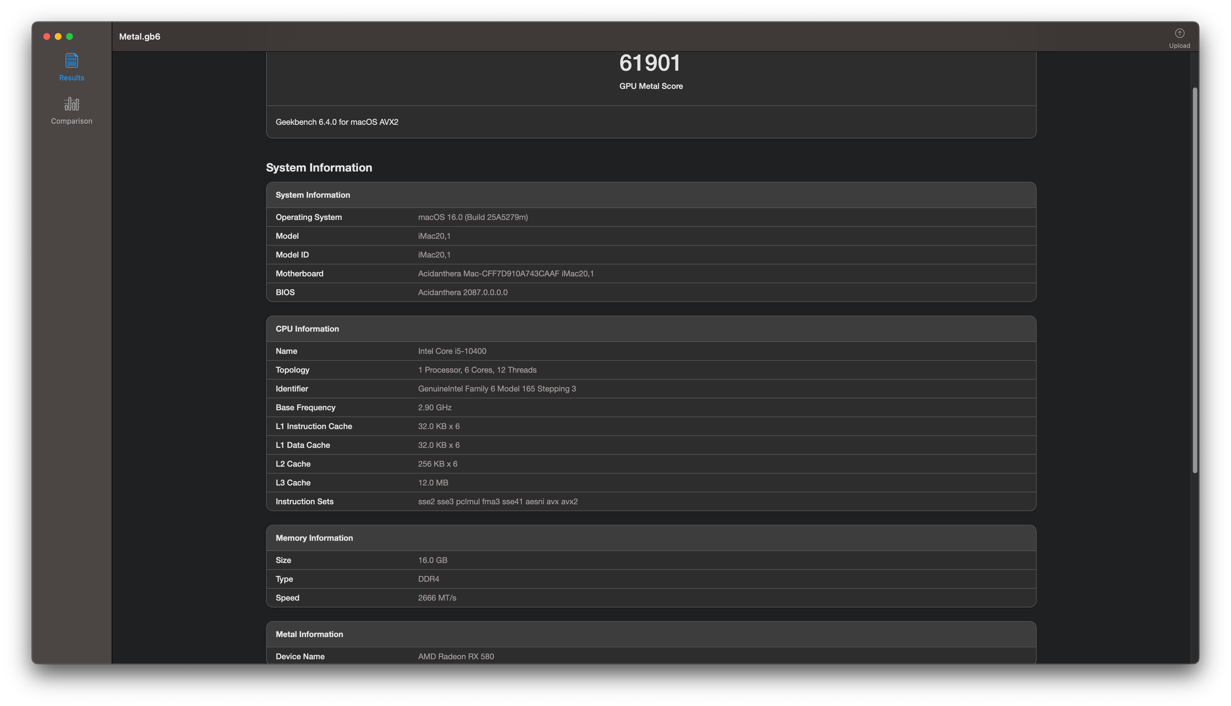

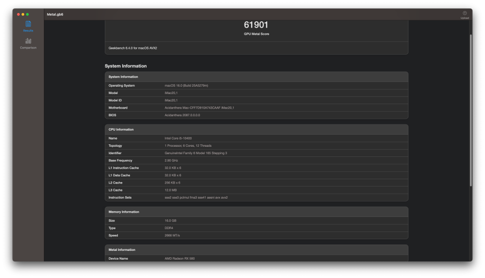

Alexey Boronenkov Posted June 20, 2025 Share Posted June 20, 2025 (edited) Металл.gb6 RX 500 POLARIS MACOS 26.plist Edited June 20, 2025 by Alexey Boronenkov 1 Link to comment https://www.insanelymac.com/forum/topic/359277-hp-elitedesk-800-g4-g5-mini-with-rx560x-dgpu-hackintosh/page/14/#findComment-2834273 Share on other sites More sharing options...
