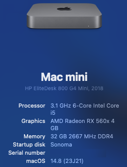

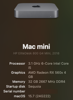

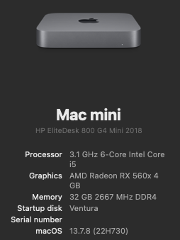

deeveedee Posted September 17, 2025 Author Share Posted September 17, 2025 (edited) Upgraded Ventura, Sonoma and Sequoia with the same OC EFI attached to Post #1. Ventura 13.7.8 Spoiler Sonoma 14.8 Spoiler Sequoia 15.7 Spoiler Edited September 18, 2025 by deeveedee Added Ventura 13.7.8 1 Link to comment https://www.insanelymac.com/forum/topic/359277-hp-elitedesk-800-g4-g5-mini-with-rx560x-dgpu-hackintosh/page/16/#findComment-2840766 Share on other sites More sharing options...

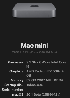

deeveedee Posted September 22, 2025 Author Share Posted September 22, 2025 (edited) Easy upgrade to Tahoe 26.1 Beta 1. No change in upgrade procedure from previous Tahoe upgrades. All good. EDIT: As observed with some previous Tahoe Beta updates, I needed to reboot multiple times after updating to Tahoe 26.1 Beta 1 in order to restore GeekBench 6 synthetic metal benchmark to ~24K. Immediately after the update, GB6 synthetic metal benchmark was closer to 18K. Edited September 25, 2025 by deeveedee 2 Link to comment https://www.insanelymac.com/forum/topic/359277-hp-elitedesk-800-g4-g5-mini-with-rx560x-dgpu-hackintosh/page/16/#findComment-2841174 Share on other sites More sharing options...

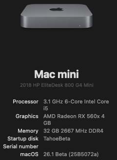

deeveedee Posted October 15, 2025 Author Share Posted October 15, 2025 (edited) Smooth upgrade from Tahoe 26.1 Beta 2 -> Beta 3. All appears fine. I did notice a drop in GB6 Metal Benchmark, but I've seen this before with Betas. I've also seen synthetic Metal benchmark performance increase with successive boot cycles after a macOS update, so maybe this will improve. I'm incredible impressed with this hack. Still very pleased with VoodooHDA.kext 3.0.2 for sound (which I haven't touched since Tahoe 26.0 Beta 2) with csr-active-config = <01000000>. GeekBench 6 Metal (Tahoe 26.1 Beta 3) Spoiler Edited October 15, 2025 by deeveedee 1 Link to comment https://www.insanelymac.com/forum/topic/359277-hp-elitedesk-800-g4-g5-mini-with-rx560x-dgpu-hackintosh/page/16/#findComment-2842242 Share on other sites More sharing options...

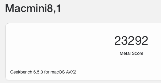

deeveedee Posted October 22, 2025 Author Share Posted October 22, 2025 (edited) Easy upgrade from Tahoe 26.1 Beta 3 -> Beta 4. As with Beta 3, GB6 Metal benchmarks achieve full potential (~24K) after multiple reboots. About This Hack: Tahoe 26.1 Beta 4 Spoiler EDIT: I am now using VoodooHDA.kext 3.0.3 from here. Edited October 22, 2025 by deeveedee 1 Link to comment https://www.insanelymac.com/forum/topic/359277-hp-elitedesk-800-g4-g5-mini-with-rx560x-dgpu-hackintosh/page/16/#findComment-2842614 Share on other sites More sharing options...

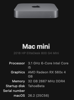

deeveedee Posted November 17, 2025 Author Share Posted November 17, 2025 (edited) macOS Tahoe updates on this hack are still going smoothly. Upgrade from Tahoe 26.2 Beta 1 -> Beta 2 was easy. I'm still using Acidanthera's WhateverGreen.kext 1.7.0, so I need boot-arg -wegnoegpu to perform the upgrade. I won't be changing my version of WEG until a new version is released by Acidanthera (just my personal preference). My complete upgrade process is as follows: Temporarily disable BluetoolFixup.kext and add boot-arg -wegnoegpu (I have a USB thumbdrive with the modified config.plist so that I don't need to touch the EFI on my SSD). Adding boot-arg -wegnoegpu disables dGPU output, but my iGPU-connected displays remain active. Boot with the modified EFI and apply the macOS update Restore BluetoolFixup.kext, remove boot-arg -wegnoegpu (in my case, boot with the SSD EFI) and reboot Since I'm using VoodooHDA.kext for Tahoe audio, I don't need to touch SIP or apply any post-install patches after the update. SIP stays at csr-active-config = <01000000> and VoodooHDA.kext 3.0.3 remains installed in /Library/Extensions Also, since VoodooHDA.kext is installed in Tahoe's /Library/Extensions and AppleALC.kext is injected by Open Core, macOS versions prior to Tahoe continue to use AppleHDA with the same EFI. The only change that affects previous versions of macOS is that SIP is relaxed with csr-active-config = <01000000>. I'm disapointed that Dortania documentation continues to includes statements about bad VoodooHDA sound quality. That is simply not true. EDIT: Same for Tahoe 26.2 Beta 2 -> Beta 3 as mentioned here. Edited November 17, 2025 by deeveedee 1 Link to comment https://www.insanelymac.com/forum/topic/359277-hp-elitedesk-800-g4-g5-mini-with-rx560x-dgpu-hackintosh/page/16/#findComment-2843784 Share on other sites More sharing options...

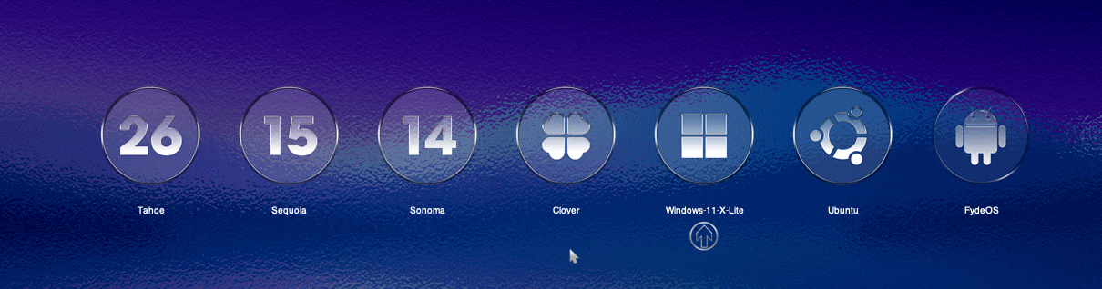

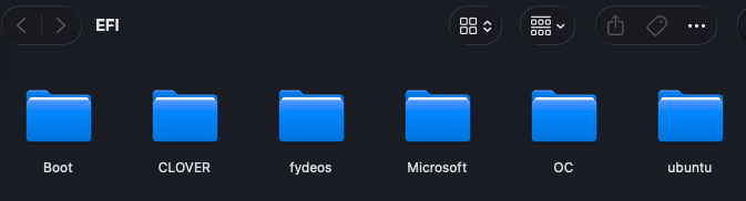

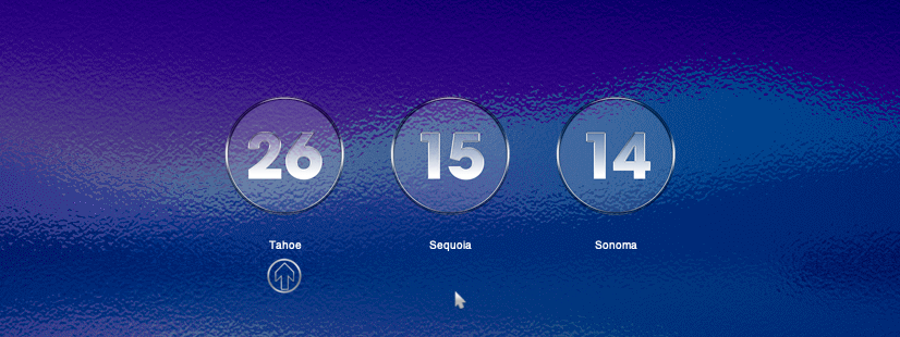

deeveedee Posted November 26, 2025 Author Share Posted November 26, 2025 I have tested two methods of booting macOS, Windows and Ubuntu on the same SSD. The methods and my test results are as follows: Grub: This method is working well for me. I am able to select Ubuntu, Windows and macOS from a single grub menu. I have installed multiple versions of macOS, so when I select macOS from the Grub menu, I'm presented with the Open Core boot menu. If I allow the OC menu selection to timeout, my preferred version of macOS boots. Add EFI partition: This method did not work for me. I created the 2nd EFI partition as instructed, but my PC's BIOS/UEFI did not detect the new UEFI boot option for macOS. I tested on an HP Elitebook 850 G7 laptop which has Windows 11, Ubuntu 24.0.4 and Open Core 1.0.6 / macOS with a single APFS Container. I would like to figure out why the "Add EFI" method did not work, so if anyone else tests, please share your test experience. Thank you. 1 1 Link to comment https://www.insanelymac.com/forum/topic/359277-hp-elitedesk-800-g4-g5-mini-with-rx560x-dgpu-hackintosh/page/16/#findComment-2844206 Share on other sites More sharing options...
Matgen84 Posted November 26, 2025 Share Posted November 26, 2025 (edited) Hi @deeveedee Add EFI partition will be, perhaps, working if you use system-boot instead of grub. In this case, the computer have a multiboot from Linux menu. Few month ago, I try this solution to test several (five) linux distributions. Unfortunately, in your case, Ubuntu do not using systems-boot by default. But you can install it: the process in French sorry There is also some explanation (I prefer this) in English on Archwiki: EFI structure explanation and here for dual boot, could be multi boot. Have a nice day. Edited November 26, 2025 by Matgen84 Link to comment https://www.insanelymac.com/forum/topic/359277-hp-elitedesk-800-g4-g5-mini-with-rx560x-dgpu-hackintosh/page/16/#findComment-2844208 Share on other sites More sharing options...
deeveedee Posted November 26, 2025 Author Share Posted November 26, 2025 @Matgen84 I'm sorry that my post made you sad. I will review your recommendations. 1 Link to comment https://www.insanelymac.com/forum/topic/359277-hp-elitedesk-800-g4-g5-mini-with-rx560x-dgpu-hackintosh/page/16/#findComment-2844212 Share on other sites More sharing options...

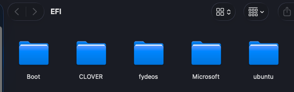

Anto65 Posted November 26, 2025 Share Posted November 26, 2025 (edited) I'll let OC handle everything Assuming I've prepared the partitions for the various OSes with their respective installation USBs, and copied my working OC EFI to a bootable USB, I empty the EFI (OC) folder on the disk. I begin by installing Windows in its dedicated partition , Windows will place its boot files (Boot and Microsoft) in the only available EFI partition on the disk. I proceed with installing Ubuntu, which will also place the boot files in the same EFI, overwriting the Windows Boot folder. In my case, I continue installing FydeOS, and its boot files will end up with those of Windows and Ubuntu, once again overwriting the Boot folder from Ubuntu In the end in the EFI I will have like this ... ( I also added Clover ) Ok, now I Boot from OC USB and restore the Boot folder and OC folder ( previously saved ) Ok OC Boot now from the NVME ( you may need to Reset / Clean Nvram ) but with scanpolicy set to 0 at boot I only see this (OSX S) and nothing else I add Custom ENTRIES , After find the Path of my Nvme via Shell ( and set scanpolicy to 2687747 ) in my case PciRoot(0x0)/Pci(0x1B,0x4)/Pci(0x0,0x0)/NVMe(0x1,D2-A8-9C-46-8B-44-1B-00)/HD(1,GPT,F9185C75-7F79-40BA-B1D7-3089D8043532,0x28,0x64000) and that will be the same path, for all the other Bootloaders (since the Boot files are together in the same folder / disk) So I'm going to add for example the call for WINDOWS in Misc->Entries PciRoot(0x0)/Pci(0x1B,0x4)/Pci(0x0,0x0)/NVMe(0x1,D2-A8-9C-46-8B-44-1B-00)/HD(1,GPT,F9185C75-7F79-40BA-B1D7-3089D8043532,0x28,0x64000)/\EFI\Microsoft\Boot\bootmgfw.efi ( Windows ) PciRoot(0x0)/Pci(0x1B,0x4)/Pci(0x0,0x0)/NVMe(0x1,D2-A8-9C-46-8B-44-1B-00)/HD(1,GPT,F9185C75-7F79-40BA-B1D7-3089D8043532,0x28,0x64000)/\EFI\CLOVER\CLOVERX64.efi ( Clover ) PciRoot(0x0)/Pci(0x1B,0x4)/Pci(0x0,0x0)/NVMe(0x1,D2-A8-9C-46-8B-44-1B-00)/HD(1,GPT,F9185C75-7F79-40BA-B1D7-3089D8043532,0x28,0x64000)/\EFI\ubuntu\grubx64.efi ( Ubuntu ) PciRoot(0x0)/Pci(0x1B,0x4)/Pci(0x0,0x0)/NVMe(0x1,D2-A8-9C-46-8B-44-1B-00)/HD(1,GPT,F9185C75-7F79-40BA-B1D7-3089D8043532,0x28,0x64000)/\EFI\fydeos\bootx64.efi ( Fydeos ) After saving and rebooting this is the result ... every os can be booted from OC, no drivers needed for Linux Edited November 26, 2025 by Anto65 2 1 Link to comment https://www.insanelymac.com/forum/topic/359277-hp-elitedesk-800-g4-g5-mini-with-rx560x-dgpu-hackintosh/page/16/#findComment-2844215 Share on other sites More sharing options...
Anto65 Posted November 26, 2025 Share Posted November 26, 2025 @deeveedee Here's https://www.insanelymac.com/forum/topic/361492-efi-mounter/page/11/#findComment-2841956 another example with a second EFI same disk ... both working 2 Link to comment https://www.insanelymac.com/forum/topic/359277-hp-elitedesk-800-g4-g5-mini-with-rx560x-dgpu-hackintosh/page/16/#findComment-2844220 Share on other sites More sharing options...
deeveedee Posted November 26, 2025 Author Share Posted November 26, 2025 @Anto65 I'll try it. Thank you. Link to comment https://www.insanelymac.com/forum/topic/359277-hp-elitedesk-800-g4-g5-mini-with-rx560x-dgpu-hackintosh/page/16/#findComment-2844221 Share on other sites More sharing options...
