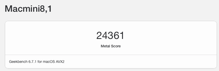

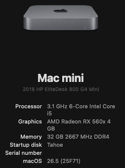

deeveedee Posted May 18 Author Share Posted May 18 (edited) My production baseline for this hack is as follows and is working perfectly for me Open Core 1.0.7 based on the EFI attached to Post #1 macOS Tahoe 26.5 (25F71) VoodooHDA.kext 3.3.4 Pre-release as documented here for audio with SIP csr-active-config = <01000000> No Wi-Fi (wired Ethernet only) No root patches (for my production hacks, I don't want a broken APFS Seal and I want SIP as restrictive as possible). Setting csr-active-config = <01000000> in Open Core config.plist allows untrusted kexts in /Libraray/Extensions (required for VoodooHDA.kext) which is no different than the untrusted kexts that we're injecting with Open Core, so I'm perfectly ok with this. No new untrusted kexts can be installed in /Library/Extensions without relaxing SIP csr-active-config to <03000000>. EDIT: With this configuration, I apply incremental macOS updates just as though this were a real Mac (no root patches to revert/re-install). I am not using Wi-Fi on this hack which simplifies my solution. If I had to use Wi-Fi on this hack (fortunately I do not), I would use itlwm/Heliport. EDIT2: GB6 Metal Benchmarks are still outstanding Spoiler Edited May 30 by deeveedee 4 Link to comment https://www.insanelymac.com/forum/topic/359277-hp-elitedesk-800-g4-g5-mini-with-rx560x-dgpu-hackintosh/page/18/#findComment-2850452 Share on other sites More sharing options...
