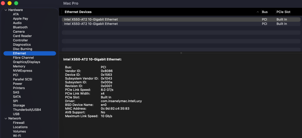

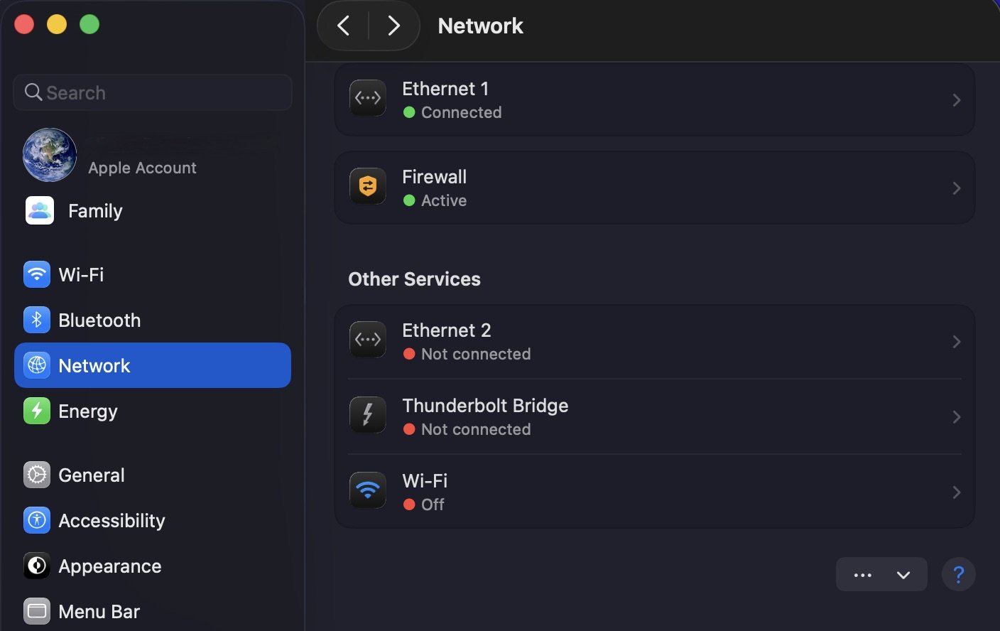

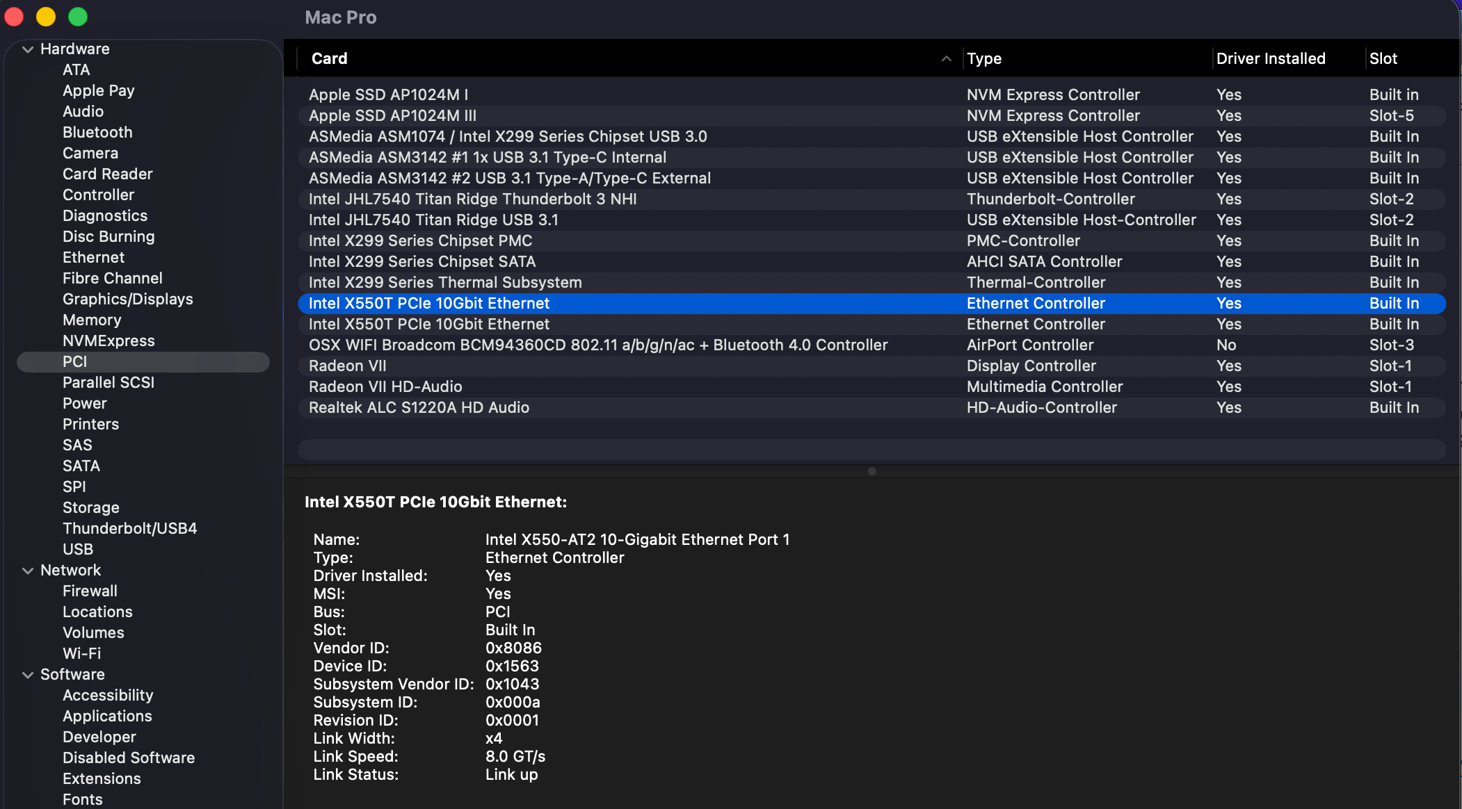

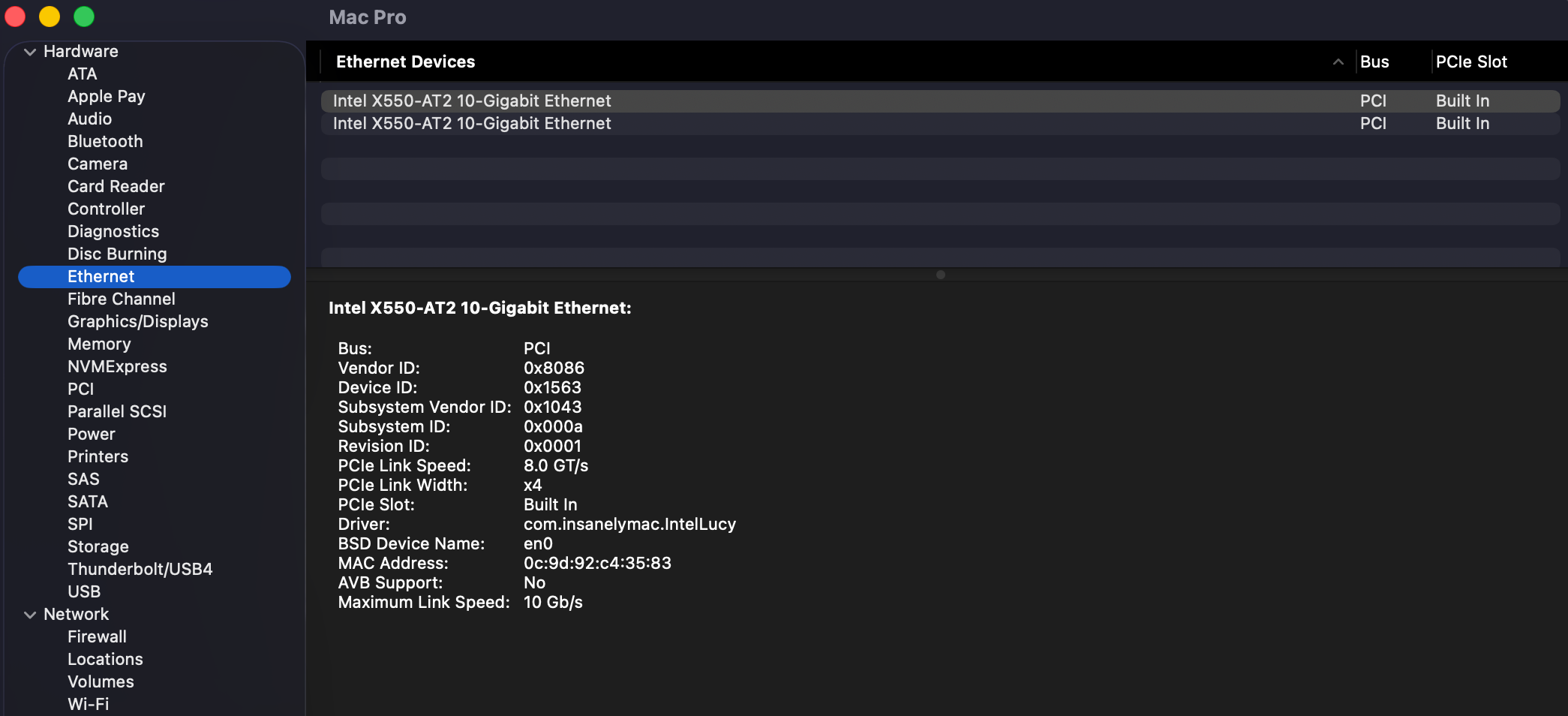

kgp Posted June 19, 2025 Share Posted June 19, 2025 (edited) Following issue: In 2018 I applied an Ubuntu EEPROM modding to the onboard Intel X550-AT2 NICs of my ASUS WS X299 Sage 10G. Since then, I was successfully using the SmallTreeIntel8259x.kext even up to Sequoia. Now under Tahoe, driver and NICs are still properly implemented with fully working LAN and Internet, but I face from time to time KPs caused by the SmallTreeIntel8259x.kext: Quote Panic (system crashes) log: Source: Size: Last Modified: Recent Contents: /Library/Logs/DiagnosticReports/.contents.panic 6 KB (5.944 bytes) {"files_to_attach":["VLibraryV/LogsV/DiagnosticReports/Kernel-2025-06-19-091328.panic"],"component_id":"609969" "log_path":"V LibraryV/Logs/DiagnosticReports\/Kernel-2025-06-19-091328.panic" "panic_string": "panic(cpu 8 caller Oxffffff80092cOeda): Kernel trap at Oxffffff800d13df24, type = 14=page fault, registers: \nCRO: 0x0000000080010033, CR2: Oxfffff8bd6b50007, CR3: 0x000000201ce0d01e, CR4: 0x00000000003626e0\nRAX: 0xffffff8bd6b4ff00, RBX: 0x0000000000000800, RCX: 0xffffa69151m340,RD:Oxffffa9151b28|nRSP: Oxffffffa69151b240, RBP: Oxffffffa69151b2a0, RSI: Oxffffff8bd6b4fe00, RDI: Oxffffff8bd6b4fe00\nR8: 0x0000001f76397000, R9: Oxfffffeabb63972c0, R10: 0x0000000040000840, R11: Oxffffffa69151b614\nR12: Oxfffffff8bd6b4fff0, R13: Oxffffff8bd6b4fe00, R14: Oxfffffff9a471adfb8, R15: Oxffffff9a471ac000\nRFL: 0x0000000000010246, RIP: Oxffffff800d13df24, CS: 0x0000000000000008, SS: 0x0000000000000010\nFault CR2: 0xfffffff8bd6b50007, Error code: 0x0000000000000000, Fault CPU: 0x8, PL: 0, VF: 10\n\nPanicked task Oxffffff8be1bed9a8: 7 threads: pid 236: mDNSResponder\nBacktrace (CPU 8), panicked thread: Oxffffff8bdfd53b30, Frame: Return Address\nOxffffffa69151aae0 : Oxffffff80091576a1 mach_kernel : _handle_debugger_trap + 0x4e1\nOxffffffa69151ab30 : Oxffffff80092d1666 mach_kernel : _kdp_i386_trap + 0x126\n0xffffffa69151ab70 : 0xffffff80092c087c mach_kernel :_kernel_trap + 0x75c\n0xffffffa69151ac30 : Oxfffffff80090eb971 mach_kernel : _return_from_trap + Oxc1\nOxfffffffa69151ac50 : Oxfffffff8009157997 mach_kernel : _DebuggerTrapWithState + 0x67\n0xffffffa69151ad50 : Oxffffff8009156ff5 mach_kernel : _panic_trap_to_debugger + 0x1e5\n0xffffffa69151adcO : 0xffffff80099834bd mach_kernel : _panic + 0x81\n0xffffffa69151aeb0 : 0xffffff80092cOeda mach_kernel : _sync_iss_to_iks + 0x3fa\nOxffffffa69151b070: Oxffffff80092c0a89 mach_kernel : _kernel_trap + 0x969\nOxffffffa69151b130: Oxffffff80090eb971 mach_kernel : _return_from_trap + 0xc1\nOxffffffa69151b150 : Oxffffff800d13df24 com.SmallTree.driver.SmallTreentel8259×:_ZN19SmallTreelnte|8259x8tsoSetupEP6__mbufP6desc_uPj + 0x82\n0xffffffa69151b2aO: Oxffffff800d13eea7 com.SmallTree.driver.SmallTreelntel8259x: 2N19SmalTreeIntel8259x12outputPacketEP6mbufPv+0x517n0xtfffffa69151b5a0: 0xtfffff800b425666 com.apple.iokit.IONetworkingFamily:ZN18I0BasicOutputQueue6outputEP11I0MbufQueuePj + 0x6c\n0xffffffa69151b5e0 : Oxffffff800b4253c8 com.apple.iokit.IONetworkingFamily:ZN18I0BasicOutputQueue7dequeueEv + 0x88\n0xffffffa69151b640 : Oxffffff800b4255c2 com.apple.iokit.IONetworkingFamily:ZN1810BasicOutputQueue7enqueueEP6_mbufPv + mach_kernel :_ip_output_list + 0x3386\n0xffffffa69151bb50 : Oxffffff8009572011 mach_kernel : _udp_log_drop_pcb + 0x2321\nOxffffffa69151bccO: Oxffffff80096f666d mach_kernel : _sosend + 0xa6d\nOxffffffa69151bde0 : 0xffffff80097075be mach_kernel :_sendto_nocancel + 0x45e\n0xffffffa69151bedO : 0xffffff8009707276 mach_kernel : _sendto_nocancel+ mach_kernel : _hnd|_unix_scall64 + 0x16\n Kernel Extensions in backtrace:\n com.apple.iokit.IONetworkingFamily(3.4) [3927A1C1-FAF2-3622-A5AD-E60D64F4FC66]@0xffffff800b413000->0xffffff800b428fff\n com.SmallTree.driver.SmallTreelntel8259x(3.8.6)IEAFD7A7F-28C6-3B0E-A839-5B92970C4D5E@0xfffff1800d12d000- >0xffffff800d162fff\n dependency: com.apple.iokit.IONetworkingFamily(3.4) [3927A1C1-FAF2-3622-A5AD- E60D64F4FC66]@0xffffff800b413000->0xffffff800b428fff\n dependency: com.apple.iokit.IOPCIFamily(2.9) [7060841B-6B9B-3F68-8C38-EF9E8802659E]@0xffffff800b6c3000->0xffffff800b715fff\n\nProcess name corresponding to current thread (Oxffffff8bdfd53b30): mDNSResponder\nBoot args: -v - lilubetaall darkwake=0 keepsyms=1 debug=0x100 agdpmod=pikera -amfipassbeta restrict=1 revpatch=pci,sbvmm -rtcfxex \n\nMac OS version:\n25A5279m\n\nKernel version:\nDarwin Kernel Version 25.0.0: Fri May 30 19:24:43 PDT 2025; root:xnu-12377.0.81.0.3~308VRELEASE_X86_64\nKernel UUID: 69DBC63A-F3F1-301A- AFFF-860781B66656\nroots installed: O\nKernelCache slide: 0x0000000008e00000\nKernelCache base: Oxffffff8009000000\nKernel slide: 0x0000000008ee8000\nKernel text base: 0xffffff80090e8000\n_HIB text base: Oxffffff8008f00000\nSystem model name: MacPro7,1 (Mac-27AD2F918AE68F61)\nSystem shutdown begun: NO\nPanic diags file available: YES (0x0)\nHibernation exit count: 0\n\nSystem uptime in nanoseconds: 75723779291\nLast Sleep: base_tsc base_nano\n Uptime : 0x00000011a17d2fdd n Sleep : 0x0000000000000000 0x0000000000000000 0x0000000000000000\n Wake : 0x0000000000000000x00000a86c3aefe60 0x0000000000000000\nCompressor Info: 0% of compressed pages limit (OK) and 0% of segments limit (OK) with 0 swapfiles and OK swap space nZone info:\n Zone map: Oxffffff80add98000 - OxffffffaOadd98000\n VM : Oxffffff80add98000 - Oxffffff857aa64000\n. RO : Oxffffff857aa64000- GEN2 : Oxffffff90adda0000 - 0xffffff957aa6c000\n . GEN3 : 0xffffff957aa6c000 - 0xffffff9a47738000\n . DATA : Oxffffff9a47738000 - Oxffffffabadd98000 n Metadata: Oxffffffa660fc8000 - Oxffffffa680fc8000 n Bitmaps : Oxffffffa680fc8000- Oxffffffa690fc8000\n Extra : 0 - 0\n\nProbabilistic GZAlloc Report:\n Zone : mbuf\n Address: 0xffffff8bd6b50007n Element: [0xffffff8bd6b4fe00, Oxffffff8bd6b50000) of size 512\n Submap : GENO [0xffffff8714408000; 0xffffff8be10d4000)\n Kind : out-of- bounds (high confidence)\n Access : 8 byte(s) past\n Metadata: zid:31 inl:0cl:0xb 0x0000 0x00000000 0x00000000 I therefore tried to change to IntelLucy.kext version 1.1.1. With the latter kext driver and NICs are also properly implemented, but the LAN at both NICs is disabled and there is no internet. I disabled VT-d in BIOS and enabled the DisableIoMapper quirk without any success. Further ideas solving the situation? Edited June 19, 2025 by KGP-iMacPro 1 Link to comment https://www.insanelymac.com/forum/topic/361162-pre-release-macos-tahoe/page/41/#findComment-2834257 Share on other sites More sharing options...

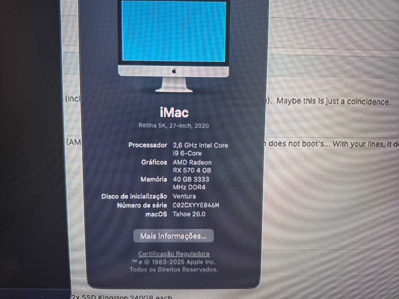

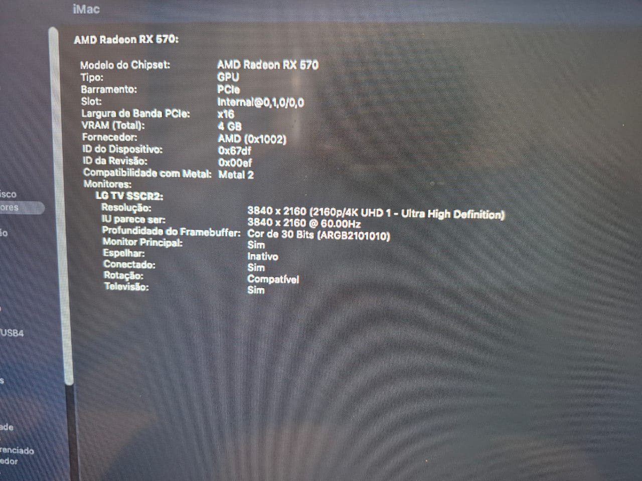

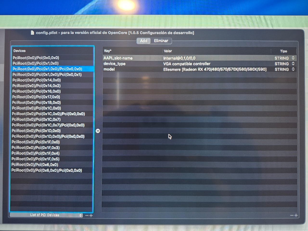

fernando.c.neves Posted June 19, 2025 Share Posted June 19, 2025 4 minutes ago, verdazil said: You can easily check if this is true. Write in this line GeForce RTX 5090 to make sure that this does not affect the system boot or the operation of the video card. Well I did what you told me, The system still boots up, not showing as GeForce RTX 5090, but still shows as AMD Radeon RX 570. If I let the system with defalt model string, it does not boots the system, I guess if I change the value for anything besides Ellismare, it show my correct name adapter and doing this it's boots like a charm. 1 Link to comment https://www.insanelymac.com/forum/topic/361162-pre-release-macos-tahoe/page/41/#findComment-2834258 Share on other sites More sharing options...
verdazil Posted June 19, 2025 Share Posted June 19, 2025 1 minute ago, fernando.c.neves said: Well I did what you told me, The system still boots up, not showing as GeForce RTX 5090, but still shows as AMD Radeon RX 570. If I let the system with defalt model string, it does not boots the system, I guess if I change the value for anything besides Ellismare, it show my correct name adapter and doing this it's boots like a charm. Once again, no. In this line, you can write a fairy tale about Snow White and the Seven Dwarfs, everything will work as it did before. 3 1 Link to comment https://www.insanelymac.com/forum/topic/361162-pre-release-macos-tahoe/page/41/#findComment-2834259 Share on other sites More sharing options...
deeveedee Posted June 19, 2025 Share Posted June 19, 2025 (edited) 20 minutes ago, fernando.c.neves said: I had this model string Original from OpenCore Configurator (1.0.5) with this string Ellesmere [Radeon RX 470/480/570/570X/580/580X/590], after change this to AMD Radeon RX 570x it worked like a charm, but the system shows up as AMD Radeon 570 (not the X version). The other values does not make a difference in my Hack turns on with video acceleration or not. Did you know why this cosmetic made my system to boot up? You're using the exact RX 560x DeviceProperties that I determined to work with the EliteDesk 800 G4 Mini (including the PP overrides and CFG_FB_LIMIT override). Maybe this is just a coincidence. I'm going to go out on a limb, but my guess is that the cosmetic change had nothing to do with it. Edited June 19, 2025 by deeveedee 3 Link to comment https://www.insanelymac.com/forum/topic/361162-pre-release-macos-tahoe/page/41/#findComment-2834260 Share on other sites More sharing options...

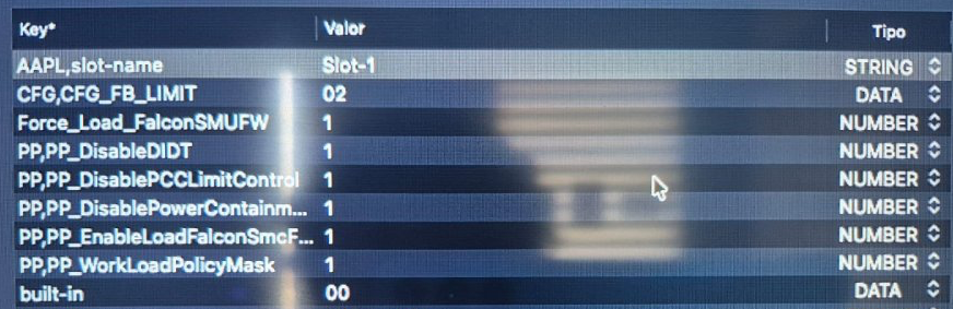

fernando.c.neves Posted June 19, 2025 Share Posted June 19, 2025 (edited) 9 minutes ago, deeveedee said: You're using the exact RX 560x DeviceProperties that I determined to work with the EliteDesk 800 G4 Mini (including the PP overrides and CFG_FB_LIMIT override). Maybe this is just a coincidence. I'm going to go out on a limb, but my guess is that the cosmetic change had nothing to do with it. No I'm not using this as you posted early those lines in DeviceProperties. My System is using only model line (AMD Radeon RX 570x). Letting Ellismere [... my system does not boot's... With your lines, it does change the values in System Info, but do not make a change in Finder issue or Safari... They still do not opens and get's me to an Black Screen again. By the way, did you system get's black screen when you click Safari or Finder? Regards, Fernando. Edited June 19, 2025 by fernando.c.neves Link to comment https://www.insanelymac.com/forum/topic/361162-pre-release-macos-tahoe/page/41/#findComment-2834261 Share on other sites More sharing options...
deeveedee Posted June 19, 2025 Share Posted June 19, 2025 2 minutes ago, fernando.c.neves said: No I'm not using this as you posted early those lines in DeviceProperties. My System is using only model line (AMD Radeon RX 570x). Letting Ellismere [... my system does not boot's... With your lines, it does change the values in System Info, but do not make a change in Finder issue or Safari... They still do not opens and get's me to an Black Screen again. By the way, did you system get's black screen when you click Safari or Finder? Regards, Fernando. Maybe I'm misreading your posted DeviceProperties Spoiler CFG,CFG_FB_LIMIT=2 is not a common DeviceProperty, since for virtually all installations, WEG handles this automatically. If those aren't your DeviceProperties, please accept my apology. I have no black screens. Link to comment https://www.insanelymac.com/forum/topic/361162-pre-release-macos-tahoe/page/41/#findComment-2834262 Share on other sites More sharing options...
Stefanalmare Posted June 19, 2025 Share Posted June 19, 2025 40 minutes ago, KGP-iMacPro said: Following issue: In 2018 I applied an Ubuntu EEPROM modding to the onboard Intel X550-AT2 NICs of my ASUS WS X299 Sage 10G. Since then, I was successfully using the SmallTreeIntel8259x.kext even up to Sequoia. Now under Tahoe, driver and NICs are still properly implemented with fully working LAN and Internet, but I face from time to time KPs caused by the SmallTreeIntel8259x.kext: I therefore tried to change to IntelLucy.kext version 1.1.1. With the latter kext driver and NICs are also properly implemented, but the LAN at both NICs is disabled and there is no internet. I disabled VT-d in BIOS and enabled the DisableIoMapper quirk without any success. Further ideas solving the situation? Try DMAR mod. 1 Link to comment https://www.insanelymac.com/forum/topic/361162-pre-release-macos-tahoe/page/41/#findComment-2834263 Share on other sites More sharing options...

fernando.c.neves Posted June 19, 2025 Share Posted June 19, 2025 33 minutes ago, deeveedee said: Maybe I'm misreading your posted DeviceProperties Reveal hidden contents CFG,CFG_FB_LIMIT=2 is not a common DeviceProperty, since for virtually all installations, WEG handles this automatically. If those aren't your DeviceProperties, please accept my apology. I have no black screens. No worries, but in deed, messing with values does not make a change in how system boots up. Now with any value (String) in model, only gets AMD Radeon RX 570 in System info. I change a lot of configurations and now I had a System that's has acceleration, but still get's Black Screen If I do click in Finder or Safari. I will try to chage BIOS and other things to discover what made my System to Work. Appologies for these (DeviceProperties) indeed has nothing to do with (model) string. Best regards, Fernando. 3 Link to comment https://www.insanelymac.com/forum/topic/361162-pre-release-macos-tahoe/page/41/#findComment-2834265 Share on other sites More sharing options...
deeveedee Posted June 19, 2025 Share Posted June 19, 2025 (edited) 7 minutes ago, fernando.c.neves said: No worries, but in deed, messing with values does not make a change in how system boots up. Now with any value (String) in model, only gets AMD Radeon RX 570 in System info. I change a lot of configurations and now I had a System that's has acceleration, but still get's Black Screen If I do click in Finder or Safari. I will try to chage BIOS and other things to discover what made my System to Work. Appologies for these (DeviceProperties) indeed has nothing to do with (model) string. Best regards, Fernando. You have more patience than I do... I'm waiting for the next Tahoe Beta or an update to WhateverGreen.kext (not sure which will fix it). Until then, I have Polaris enabled and 'working' as long as I don't use a headless iGPU as described here. It works very well, driving multiple displays with Metal acceleration by the dGPU. EDIT: If there is not going to be a change to Tahoe, I have a theory about how it might be fixed here, but I don't know how to apply the required kernel patch without a modification of WhateverGreen.kext. Edited June 19, 2025 by deeveedee 2 Link to comment https://www.insanelymac.com/forum/topic/361162-pre-release-macos-tahoe/page/41/#findComment-2834266 Share on other sites More sharing options...

kgp Posted June 19, 2025 Share Posted June 19, 2025 1 hour ago, Stefanalmare said: Try DMAR mod. Thanks for the quick answer, man! Could you please explain a bit more about the DMAR mod and how it can be applied, or provide any link that refers to? Or did I miss something here during the individual posts, where it would be explained already? Anyway, you posted on page 43: "DMAR solution doesn't work.", thus I don't know if it is really worth to further investigate this alternative option. Furthermore, as both Lan and Internet work with the SmallTreeIntel8259x.kext under Tahoe (I just face from time to time KPs with this driver, that's why I tried to use IntelLucy.kext at all at last instance), my issue with no Lan nor Internet with IntelLucy.kext seems rather to be related with the kext and Tahoe than hardware, VT-d, DisableIoMapper quirk or DMAR. Well, maybe anybody else also might have further suggestions or ideas. 👍 1 Link to comment https://www.insanelymac.com/forum/topic/361162-pre-release-macos-tahoe/page/41/#findComment-2834268 Share on other sites More sharing options...

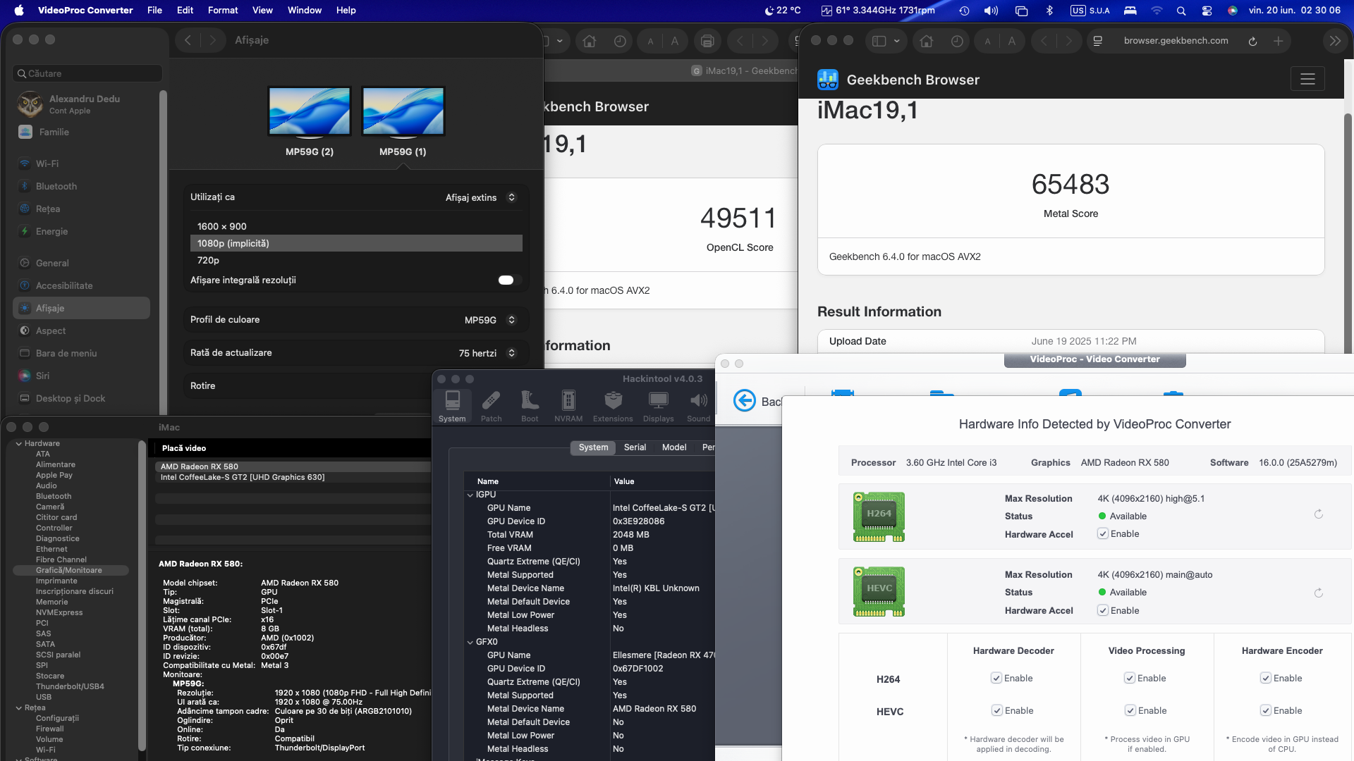

Stefanalmare Posted June 19, 2025 Share Posted June 19, 2025 (edited) On 6/15/2025 at 5:53 AM, deeveedee said: @iaihc If your RX460 is unstable in Tahoe, then I wouldn't declare victory. The configuration I described is rock-solid. I posted to give everyone else hope that there will be a solution for those (everyone else, I believe) who have a headless iGPU framebuffer (only using their dGPU display ports). I have implemented an unconventional configuration where both my iGPU and dGPU heads are enabled (in DeviceProperties). At the very least, this should offer clues to those who are attempting to implement a fix. EDIT: In my current configuration, I have two displays connected to the two iGPU display ports on my hack and no displays connected to the dGPU display port. The two displays work flawlessly and so far, I've had no issues in Tahoe with my RX 560x enabled. As shown here, the dGPU provides metal acceleration on the iGPU ports. I know there are use cases where the dGPU display ports are required, but this is progress and a clear indicator that Polaris is "supported" in Tahoe. Hey @deeveedee! I was literally cracking my head trying to use a Polaris into a laptop with Intel IGPU driving the main display and multiple displays trough RX 480m connectors, but at the same time with GPU acceleration. I have tried all: vbios, SMBIOS, whatevergreen patches, kexts from older oses....... And you come with this properties and you nail it. Thank you! In the attach you can see Tahoe with Intel IGPU main and RX 580, both running a display. OpenCL and Metal trough RX 580. Full acceleration!! I don't have with me the laptop (Dell Precision M6800 with RX 480m) to test this settings, but I have a good feeling that you gave me the solution. 🤗 Spoiler Edited June 20, 2025 by Stefanalmare 2 Link to comment https://www.insanelymac.com/forum/topic/361162-pre-release-macos-tahoe/page/41/#findComment-2834269 Share on other sites More sharing options...
Stefanalmare Posted June 19, 2025 Share Posted June 19, 2025 2 hours ago, KGP-iMacPro said: Thanks for the quick answer, man! Could you please explain a bit more about the DMAR mod and how it can be applied, or provide any link that refers to? Or did I miss something here during the individual posts, where it would be explained already? Anyway, you posted on page 43: "DMAR solution doesn't work.", thus I don't know if it is really worth to further investigate this alternative option. Furthermore, as both Lan and Internet work with the SmallTreeIntel8259x.kext under Tahoe (I just face from time to time KPs with this driver, that's why I tried to use IntelLucy.kext at all at last instance), my issue with no Lan nor Internet with IntelLucy.kext seems rather to be related with the kext and Tahoe than hardware, VT-d, DisableIoMapper quirk or DMAR. Well, maybe anybody else also might have further suggestions or ideas. 👍 https://www.insanelymac.com/forum/topic/357954-vt-d-problems-in-macos/ 1 Link to comment https://www.insanelymac.com/forum/topic/361162-pre-release-macos-tahoe/page/41/#findComment-2834270 Share on other sites More sharing options...

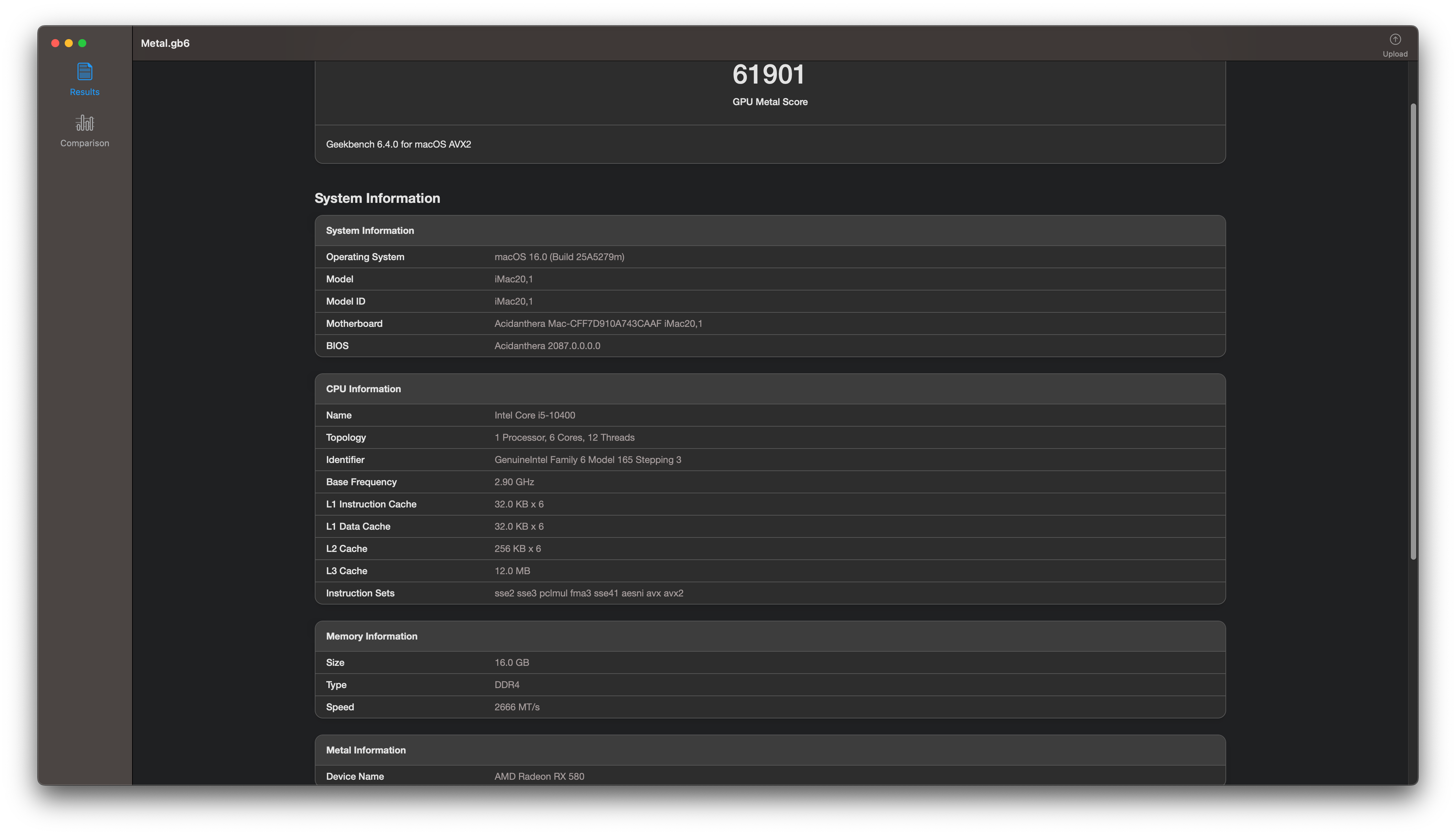

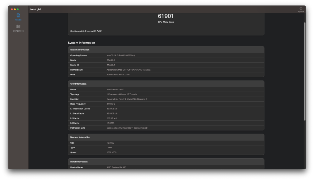

Alexey Boronenkov Posted June 20, 2025 Share Posted June 20, 2025 (edited) RX 500 POLARIS MACOS 26.plist Metal.gb6 Edited June 20, 2025 by Alexey Boronenkov 1 Link to comment https://www.insanelymac.com/forum/topic/361162-pre-release-macos-tahoe/page/41/#findComment-2834274 Share on other sites More sharing options...

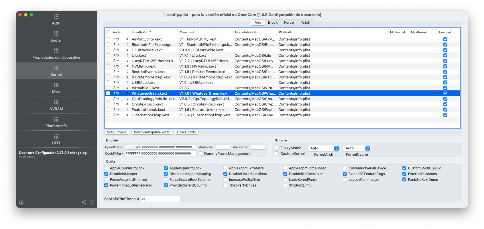

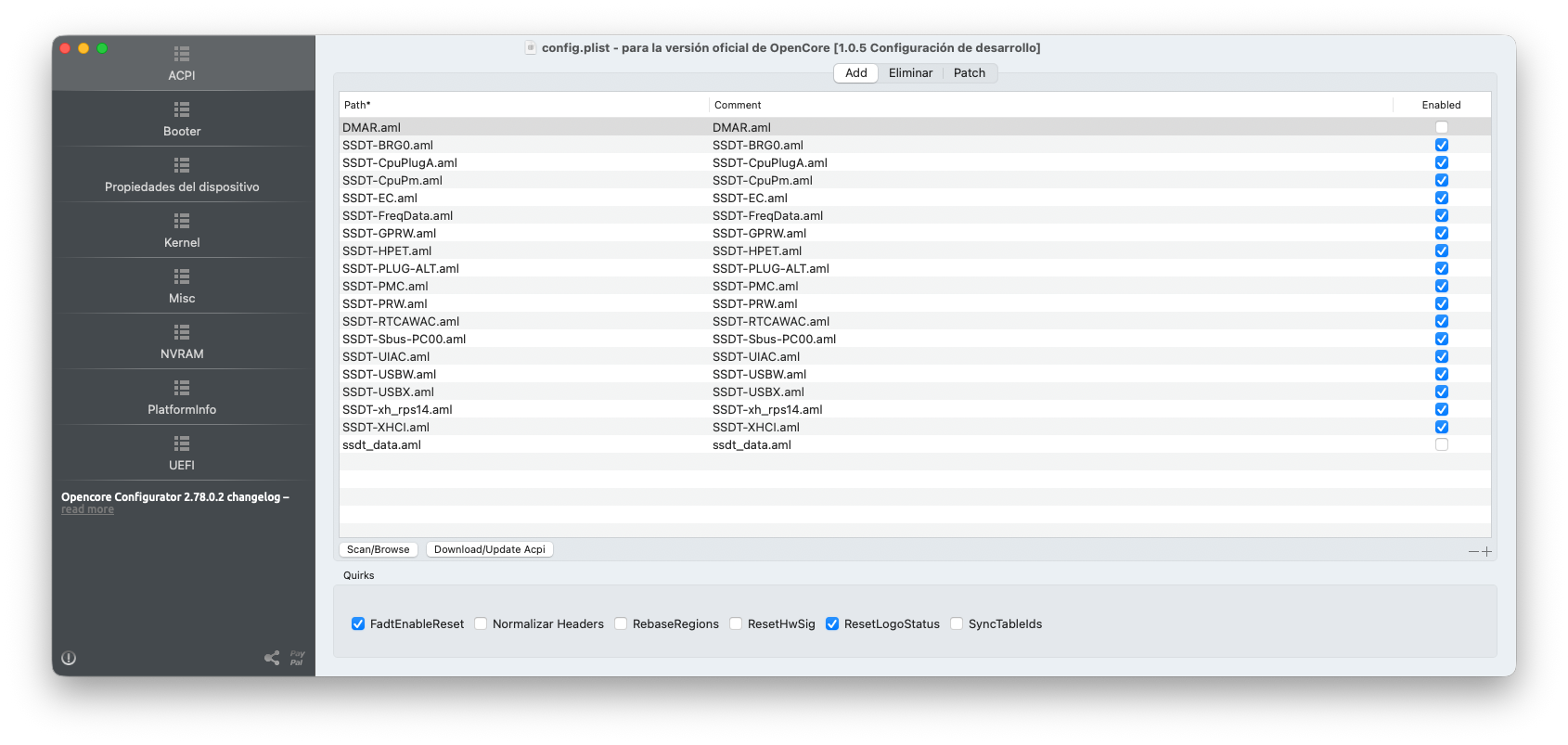

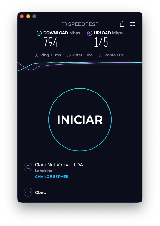

kgp Posted June 20, 2025 Share Posted June 20, 2025 (edited) 5 hours ago, Stefanalmare said: https://www.insanelymac.com/forum/topic/357954-vt-d-problems-in-macos/ I have to revalidate my previous conclusions. With VT-d in BIOS enabled and DisableIoMapper kernel quirk enabled, Lan and Internet now also work with IntelLucy.kext and the driver seems to be much more stable under Tahoe than the SmallTreeIntel8259x.kext. All KPs are gone. I just had to manually enable once en0 in the system settings, now my onboard Intel X550-AT2 NICs automatically connect to LAN and Internet after each boot or wake. 👍 No need to mod the DMAR in any case. BTW.. With DisableIoMapper kernel quirk disabled, my system even won't boot under Tahoe. Edited June 20, 2025 by KGP-iMacPro 3 1 Link to comment https://www.insanelymac.com/forum/topic/361162-pre-release-macos-tahoe/page/41/#findComment-2834279 Share on other sites More sharing options...

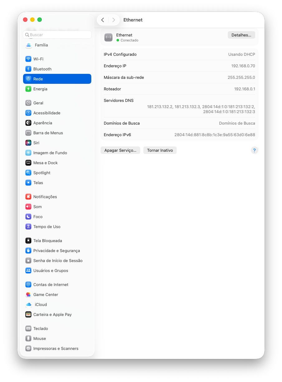

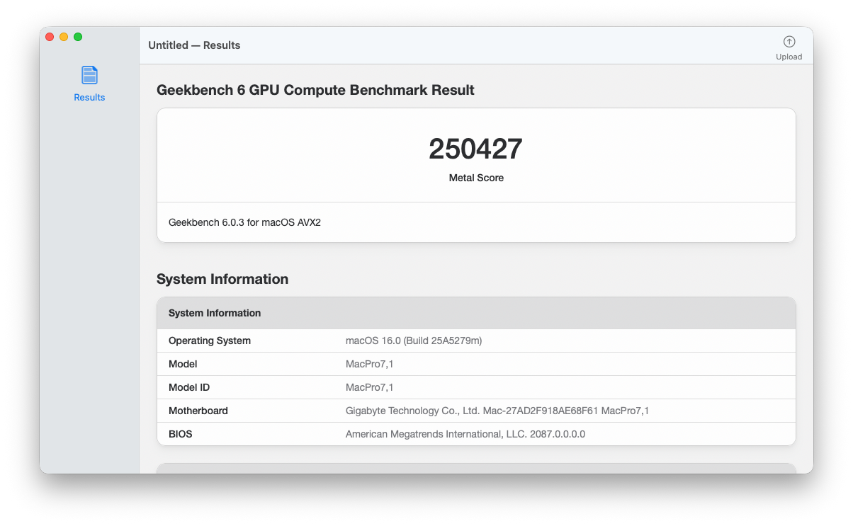

Max.1974 Posted June 20, 2025 Share Posted June 20, 2025 (edited) Hi Guys 😃 Thanks to everyone for the new Dortania kexts and the golden tip from my Brazilian compatriot @fernando.c.neves about the new updated kexts. I finally got the Tahoe working on the Gigabyte Z790 board, Elite AX with the RX 6900 XT, working Ethernet, native Broadcom Bluetooth, USBs and thanks to the new Opencores that came out of Action a few days ago by the Opencore team. God bless the Hackintoshers, intelligent and helpful people. Thanks to each one of you here we managed it once again. I didn't test starting the installation from the pendrive but I installed it with the command I told you about. It installed perfectly and then with the new updates we can use agdpmod=pikera and WEG. Very happy!! Thanks all of you! Edited June 20, 2025 by Max.1974 10 Link to comment https://www.insanelymac.com/forum/topic/361162-pre-release-macos-tahoe/page/41/#findComment-2834280 Share on other sites More sharing options...

surfinchina Posted June 20, 2025 Share Posted June 20, 2025 22 minutes ago, Max.1974 said: Hi Guys 😃 Thanks to everyone for the new Dortania kexts Thanks all of you! Hi Max good work! I got it working on my Asus Z690 (1225 ethernet) but no ethernet. Is there any specific thing you did to get network? I don't have wi-fi either but that's the broadcom card, pretty sure nobody's got that working without OCLP. Everything else seems fine. 1 1 Link to comment https://www.insanelymac.com/forum/topic/361162-pre-release-macos-tahoe/page/41/#findComment-2834283 Share on other sites More sharing options...
Max.1974 Posted June 20, 2025 Share Posted June 20, 2025 (edited) 57 minutes ago, D-an-W said: How new are those WEG updates as I had to disable to install too (we have similar hardware and not at home right now to test)? The new kexts updated by Dortania here: https://dortania.github.io/builds/?product=DebugEnhancer&viewall=true My EFI EFI-GA-Z790-Elite.AX-Tahoe.zip But I run command to install from Sequoia that finalize all installer and them it run automatic and deleted your old system installed and formalize Tahoe with Recovery and all. I will test run from installer on pendrive or partition from "scratch" but this command is from "scratch" too Here the command take care with: Don't forget run installer beta from Applications after install pkg downloaded sudo /Applications/Install\ macOS\ Beta.app/Contents/Resources/startosinstall --eraseinstall --volume /Volumes/tahoe --newvolumename "tahoe” --agreetolicense --nointeraction --passprompt Disable DMAR.aml and enable DisableIomapper and DisableIoMapperMapping 38 minutes ago, surfinchina said: Hi Max good work! I got it working on my Asus Z690 (1225 ethernet) but no ethernet. Is there any specific thing you did to get network? I don't have wi-fi either but that's the broadcom card, pretty sure nobody's got that working without OCLP. Everything else seems fine. @surfinchina Hi my friend, I think you need update from Dortania the new kexts and disable DMAR.aml and enable DisableIomapper and DisableIoMapperMapping Edited June 20, 2025 by Max.1974 3 1 Link to comment https://www.insanelymac.com/forum/topic/361162-pre-release-macos-tahoe/page/41/#findComment-2834284 Share on other sites More sharing options...

Max.1974 Posted June 20, 2025 Share Posted June 20, 2025 (edited) Thanks for you help @fernando.c.neves !! Hi guys, im using this Opencore version 1.0.5, from action: sha256:cff143750590414f5b3de56ccdc263c0341c3e937961423d8274af69b1648eaf macOS XCODE5 Artifacts.zip https://github.com/acidanthera/OpenCorePkg/actions/runs/15654265981 Thanks to @Andrey1970 and all team! Edited June 20, 2025 by Max.1974 3 Link to comment https://www.insanelymac.com/forum/topic/361162-pre-release-macos-tahoe/page/41/#findComment-2834286 Share on other sites More sharing options...
surfinchina Posted June 20, 2025 Share Posted June 20, 2025 22 minutes ago, Max.1974 said: @surfinchina Hi my friend, I think you need update from Dortania the new kexts and disable DMAR.aml and enable DisableIomapper and DisableIoMapperMapping Thanks my friend! That got the internet working but now Tahoe freezes after about 10 seconds lol. Steps forward and steps backward 😅 1 2 Link to comment https://www.insanelymac.com/forum/topic/361162-pre-release-macos-tahoe/page/41/#findComment-2834287 Share on other sites More sharing options...
