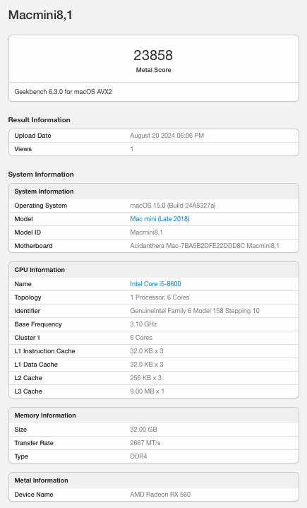

deeveedee Posted August 20, 2024 Author Share Posted August 20, 2024 (edited) After upgrading from Sequoia Beta 6 -> Beta 7, I observed the best GB6 Metal benchmark that I have observed on this hack: Spoiler About this hack Spoiler Edited August 20, 2024 by deeveedee 2 Link to comment https://www.insanelymac.com/forum/topic/359277-hp-elitedesk-800-g4-g5-mini-with-rx560x-dgpu-hackintosh/page/9/#findComment-2824289 Share on other sites More sharing options...

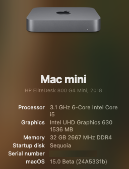

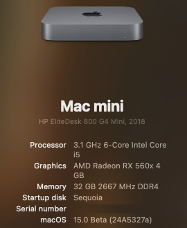

deeveedee Posted August 29, 2024 Author Share Posted August 29, 2024 (edited) Upgrade from Sequoia Beta 7 -> Beta 8 proceeded without issues. Interesting but not surprising result: I used a single display during my Sequoia upgrade. With a single display connected to a UHD630 DP port (no display connected to the RX 560x DP port), About This Mac shows the Graphics as UHD630. With the EFI attached to Post #1, as long as a display is connected to the RX 560x DP port (in single and multi-display configurations), About This Mac shows the Graphics as RX 560x. Edited August 29, 2024 by deeveedee 2 Link to comment https://www.insanelymac.com/forum/topic/359277-hp-elitedesk-800-g4-g5-mini-with-rx560x-dgpu-hackintosh/page/9/#findComment-2824517 Share on other sites More sharing options...

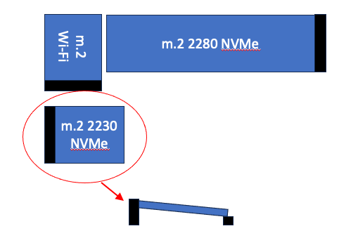

deeveedee Posted August 29, 2024 Author Share Posted August 29, 2024 Does anyone have an M-keyed m.2 2230 NVMe card to test in the second (higher) M.2 slot? I don't have a 2230 card to test, but it appears to me that the shorter 2230 m.2 card may fit in the second m.2 port when our RX 560x is installed. The card will need to "bend" down toward the motherboard (as shown in the diagram below) to clear the RX 560x card, but even when bent down, the m.2 2230 card will maintain full electrical connectivity with the m.2 slot. If the 2230 NVMe card does work in the second m.2 slot, we would just need to figure out a way to secure the card (should be easy). Possible use of m.2 2230 NVMe SSD in second m.2 slot Spoiler 3 Link to comment https://www.insanelymac.com/forum/topic/359277-hp-elitedesk-800-g4-g5-mini-with-rx560x-dgpu-hackintosh/page/9/#findComment-2824521 Share on other sites More sharing options...
ird Posted August 30, 2024 Share Posted August 30, 2024 (edited) 3 hours ago, deeveedee said: Does anyone have an M-keyed m.2 2230 NVMe card to test in the second (higher) M.2 slot? I don't have a 2230 card to test, but it appears to me that the shorter 2230 m.2 card may fit in the second m.2 port when our RX 560x is installed. The card will need to "bend" down toward the motherboard (as shown in the diagram below) to clear the RX 560x card, but even when bent down, the m.2 2230 card will maintain full electrical connectivity with the m.2 slot. If the 2230 NVMe card does work in the second m.2 slot, we would just need to figure out a way to secure the card (should be easy). Possible use of m.2 2230 NVMe SSD in second m.2 slot Reveal hidden contents I have tried and unfortunately it doesn't fit. Even if it would some fit (I didn't have the courage to force it in), we'd need to insulate the top of the nvme as the underside of the GPU mounting plate is metal and can short bits out on the nvme. EDIT1: If you notice, there is a large indent underneath the dgpu on the backplate for the connector but not where the slot starts. I believe other than hacking the backplate there is no other way. Haven't tried that yet, though. Edited August 30, 2024 by ird 1 Link to comment https://www.insanelymac.com/forum/topic/359277-hp-elitedesk-800-g4-g5-mini-with-rx560x-dgpu-hackintosh/page/9/#findComment-2824530 Share on other sites More sharing options...
deeveedee Posted August 30, 2024 Author Share Posted August 30, 2024 @ird Thank you for testing. I'm not saving this Mini for anything else, so I'm tempted to buy a 2230 NVMe card and modify the dGPU backplate. 3 Link to comment https://www.insanelymac.com/forum/topic/359277-hp-elitedesk-800-g4-g5-mini-with-rx560x-dgpu-hackintosh/page/9/#findComment-2824537 Share on other sites More sharing options...

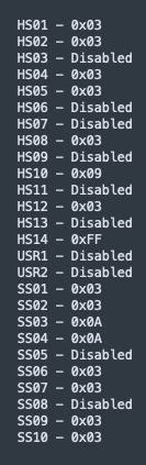

datafeedexpert Posted August 30, 2024 Share Posted August 30, 2024 (edited) @deeveedee @ird Has anyone of you tried modifying original usb SSDT Tables to map USBPORTs for this machine?, As i tried many times but don't have success to Map USBs using original USB-SSDT Fetched by Clover boot screen F4 Function. Here i am attaching my works if some one can help to map USBs in original SSDT, I already have a SSDT mapped USB Tables but that are the custom Methods, I want to learn Adding Methods in Original tables. SSDT-4-HP_XHC_P.aml --> Extracted using Xiasl by @ic005k (Original Untouched SSDT) SSDT-4.aml --> Extracted using Clover r5156 F4 Function (Original Untouched SSDT) SSDT-USB-Edited.aml --> tried my self using @dreamwhite Guide (Not Success) SSDT-USB-Alternative --> Tried My self Using @AppleBreak Guide (Not Success) The screenshot have USB types 0x03- USB 2/3 | 0x09-USB Type C With Switch | 0x0A- USB Type C , @cankiulascmnfye Can you please check my work in these SSDT's so i can find where i am mistaken? SSDT-4-HP_XHC_P.aml SSDT-4.aml SSDT-USB-Alternative.aml SSDT-USB-Edited.aml Edited August 30, 2024 by datafeedexpert Spel checks 1 Link to comment https://www.insanelymac.com/forum/topic/359277-hp-elitedesk-800-g4-g5-mini-with-rx560x-dgpu-hackintosh/page/9/#findComment-2824541 Share on other sites More sharing options...
deeveedee Posted August 30, 2024 Author Share Posted August 30, 2024 @datafeedexpert I don't understand your question. Are you saying that you do not want to use USBPorts.kext? If not, why? Link to comment https://www.insanelymac.com/forum/topic/359277-hp-elitedesk-800-g4-g5-mini-with-rx560x-dgpu-hackintosh/page/9/#findComment-2824543 Share on other sites More sharing options...
datafeedexpert Posted August 30, 2024 Share Posted August 30, 2024 5 hours ago, deeveedee said: @datafeedexpert I don't understand your question. Are you saying that you do not want to use USBPorts.kext? If not, why? I Just want to Learn Modifying original USB Tables. The advantage of using ACPI USB port mapping method. 1 - Kextless 2- USB ports are defined at the ACPI level and is unlikely to break because of future macOS updates 3 - Will work on any SMBIOS 4 - Does not affect other types of operating systems Link to comment https://www.insanelymac.com/forum/topic/359277-hp-elitedesk-800-g4-g5-mini-with-rx560x-dgpu-hackintosh/page/9/#findComment-2824547 Share on other sites More sharing options...
deeveedee Posted August 30, 2024 Author Share Posted August 30, 2024 (edited) 39 minutes ago, datafeedexpert said: I Just want to Learn Modifying original USB Tables. The advantage of using ACPI USB port mapping method. 1 - Kextless 2- USB ports are defined at the ACPI level and is unlikely to break because of future macOS updates 3 - Will work on any SMBIOS 4 - Does not affect other types of operating systems Lerning is a legitimate reason - I encourage it. #3 and #4 are also true for USBPorts.kext (with a minor change for #3). #2 is unlikely to be a concern (even if there is a future version of macoS for Intel. I'm not trying to dismiss your opinion - just want to make sure I understand why you are doing it. EDIT: Regarding #1, USBPorts.kext is a codeless kext. If you are able, I'd like to understand your perception of the risks and/or disadvantages of using a codeless kext vs. patching ACPI. Over time, I have become very skeptical of the "vanilla" hack argument. Edited August 30, 2024 by deeveedee Link to comment https://www.insanelymac.com/forum/topic/359277-hp-elitedesk-800-g4-g5-mini-with-rx560x-dgpu-hackintosh/page/9/#findComment-2824548 Share on other sites More sharing options...
cankiulascmnfye Posted August 30, 2024 Share Posted August 30, 2024 8 hours ago, datafeedexpert said: @deeveedee @ird Has anyone of you tried modifying original usb SSDT Tables to map USBPORTs for this machine?, As i tried many times but don't have success to Map USBs using original USB-SSDT Fetched by Clover boot screen F4 Function. Here i am attaching my works if some one can help to map USBs in original SSDT, I already have a SSDT mapped USB Tables but that are the custom Methods, I want to learn Adding Methods in Original tables. SSDT-4-HP_XHC_P.aml --> Extracted using Xiasl by @ic005k (Original Untouched SSDT) SSDT-4.aml --> Extracted using Clover r5156 F4 Function (Original Untouched SSDT) SSDT-USB-Edited.aml --> tried my self using @dreamwhite Guide (Not Success) SSDT-USB-Alternative --> Tried My self Using @AppleBreak Guide (Not Success) The screenshot have USB types 0x03- USB 2/3 | 0x09-USB Type C With Switch | 0x0A- USB Type C , @cankiulascmnfye Can you please check my work in these SSDT's so i can find where i am mistaken? SSDT-4-HP_XHC_P.aml 3.28 kB · 0 downloads SSDT-4.aml 3.28 kB · 0 downloads SSDT-USB-Alternative.aml 4.2 kB · 0 downloads SSDT-USB-Edited.aml 3.5 kB · 0 downloads I wrote a pretty extensive guide about to do this about 3 years ago: https://github.com/5T33Z0/OC-Little-Translated/tree/main/03_USB_Fixes/ACPI_Mapping_USB_Ports The bottom line is: if you can't get it to work, start over, or find somebbody who does it for you or use a USB port mapping kext. 2 Link to comment https://www.insanelymac.com/forum/topic/359277-hp-elitedesk-800-g4-g5-mini-with-rx560x-dgpu-hackintosh/page/9/#findComment-2824549 Share on other sites More sharing options...
ird Posted August 31, 2024 Share Posted August 31, 2024 9 hours ago, datafeedexpert said: I Just want to Learn Modifying original USB Tables. The advantage of using ACPI USB port mapping method. 1 - Kextless 2- USB ports are defined at the ACPI level and is unlikely to break because of future macOS updates 3 - Will work on any SMBIOS 4 - Does not affect other types of operating systems This is a great way to experiment and learn. I haven't done it myself but will certainly keep an eye on the progress you make. I concur with @deeveedee regarding the other point she made - while this is a great learning exercise, I don't think you should expect any performance/vanilla advantage as these tables as well as the codeless kext are loaded pretty much similarly before macOS. The universal SMBIOS sure seems like a genuine advantage though in case you are SMBIOS-hopping quite a bit. Link to comment https://www.insanelymac.com/forum/topic/359277-hp-elitedesk-800-g4-g5-mini-with-rx560x-dgpu-hackintosh/page/9/#findComment-2824555 Share on other sites More sharing options...
deeveedee Posted September 1, 2024 Author Share Posted September 1, 2024 (edited) I would purchase a m.2 2230 NVMe SSD to test in the second m.2 slot if someone else can suggest a fully tested 2230 card that works with macOS. I have a couple of physical configuration ideas, but won't propose them until I test the physical configurations myself. I see the WD SN740 and KIOXIA BG5 (Apple uses Xioxia brand NVMe in some genuine Macs). The 256GB modules are inexpensive and suitable for testing (if they are fully compatible with macOS). Any recommendations (only fully tested options) would be greatly appreciated. Thank you. EDIT: another option might be creative use of the SATA port (using a mini SATA drive without a SATA drive caddy). Edited September 1, 2024 by deeveedee Link to comment https://www.insanelymac.com/forum/topic/359277-hp-elitedesk-800-g4-g5-mini-with-rx560x-dgpu-hackintosh/page/9/#findComment-2824635 Share on other sites More sharing options...
ird Posted September 1, 2024 Share Posted September 1, 2024 2 hours ago, deeveedee said: I would purchase a m.2 2230 NVMe SSD to test in the second m.2 slot if someone else can suggest a fully tested 2230 card that works with macOS. I have a couple of physical configuration ideas, but won't propose them until I test the physical configurations myself. I see the WD SN740 and KIOXIA BG5 (Apple uses Xioxia brand NVMe in some genuine Macs). The 256GB modules are inexpensive and suitable for testing (if they are fully compatible with macOS). Any recommendations (only fully tested options) would be greatly appreciated. Thank you. EDIT: another option might be creative use of the SATA port (using a mini SATA drive without a SATA drive caddy). I've tested this Dell OEM nvme: Amazon.com: Toshiba(Kioxia) 256GB PCIe NVMe 2230 SSD (KBG40ZNS256G) (OEM), 30mm : Electronics I can't say I've tested this extensively but this works. 1 1 Link to comment https://www.insanelymac.com/forum/topic/359277-hp-elitedesk-800-g4-g5-mini-with-rx560x-dgpu-hackintosh/page/9/#findComment-2824640 Share on other sites More sharing options...
