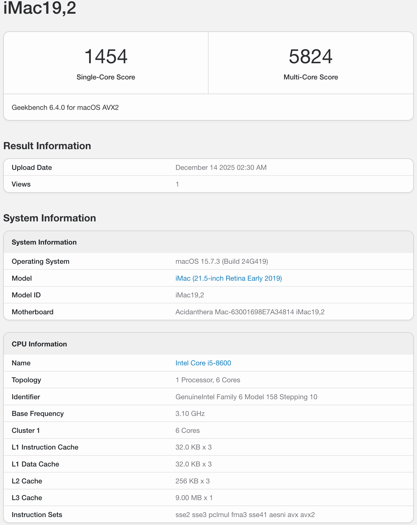

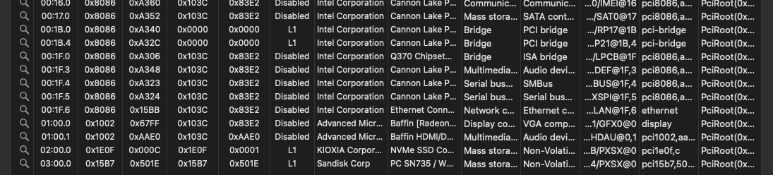

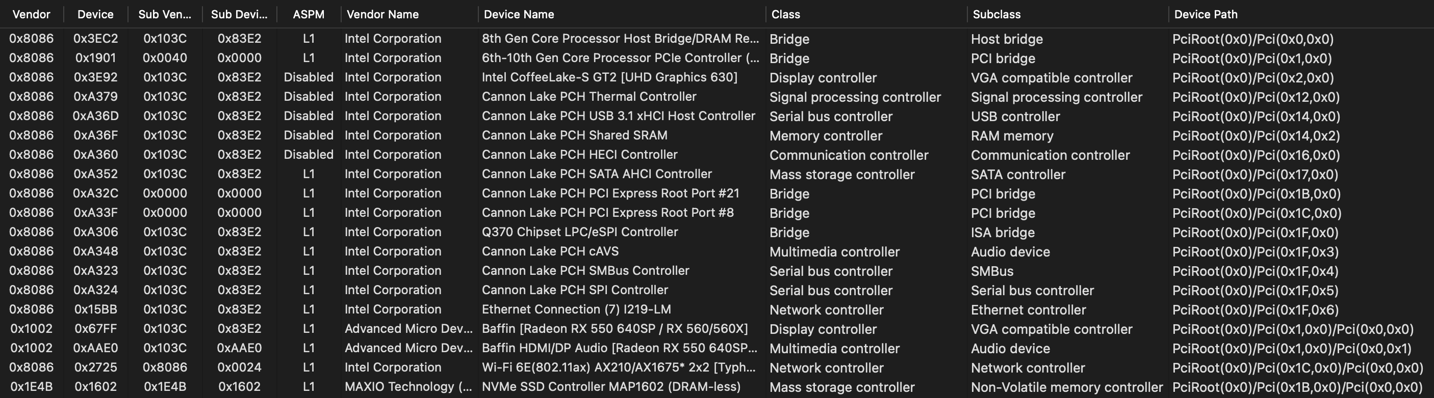

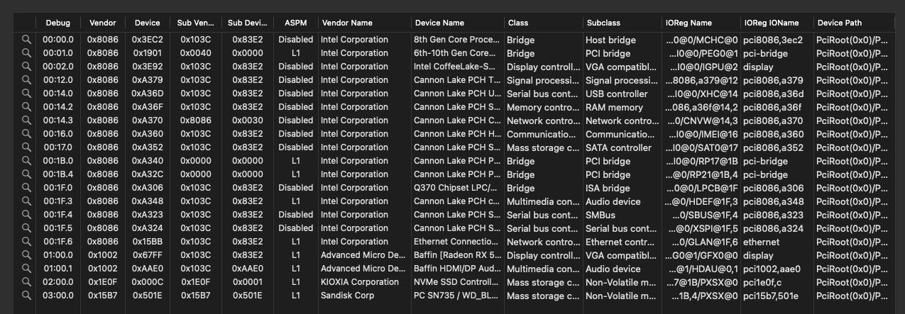

deeveedee Posted December 14, 2025 Author Share Posted December 14, 2025 (edited) 14 hours ago, ird said: So, inspired by you I went a bit wild and enabled default ASPM for both PCIe bridges 0x0 and 0x1 root nodes (and by association to all attached end points). I'm going to test a bit if this causes instability in the next 2 days before I'm away for the rest of this year. Basic testing, I found no differences in CPU, GPU geekbench 6 scores. My dGPU scores were a bit low to start with before this change (I never got the opportunity to debug it). I'll report back if I see any issues enabling L1 ASPM. Reveal hidden contents Edit: Sorry, I didn't realize this is the non-dGPU thread! I'll leave the dGPU Geekbench 6 scores as-is in the post anyway. The rest of PCIe devices are common between the two configs. @ird Replying here in response to your post in the other thread (no worries). I am also seeing reduced GeekBench 6 dGPU benchmarks after upgrading to macOS Tahoe 26.2. My metal benchmark is consistently ~19K (down from ~24K) after repeated reboots. pci-aspm-default setting for the dGPU doesn't seem to affect the benchmark as you have observed. After examining the pci-aspm-default properties for real Macs, I am currently adding the property for NVMe SSDs, HDEF (HDAS), Ethernet, HDAU, dGPU. Spoiler EDIT: @ird I installed macOS 26.1 in an additional APFS volume so that I can A/B performance testing between 26.1 and 26.2 (booting both with the same EFI). In repeated tests, macOS 26.1 consistently produces GB6 Metal Benchmarks = 23K-24K while macOS 26.2 consistently produces GB6 Metal Benchmarks = ~19K. Edited December 14, 2025 by deeveedee 1 Link to comment https://www.insanelymac.com/forum/topic/359277-hp-elitedesk-800-g4-g5-mini-with-rx560x-dgpu-hackintosh/page/17/#findComment-2844980 Share on other sites More sharing options...

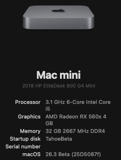

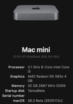

deeveedee Posted December 17, 2025 Author Share Posted December 17, 2025 (edited) Very easy update to Tahoe 26.3 Beta (25D5087f). Prior to update, I disabled BluetoolFixup.kext (for incremental update) and added boot-arg -wegnoegpu (required because I'm still using Acidanthera's WhateverGreen.kext 1.7.0). After update, I re-enabled BluetoolFixup.kext and deleted -wegnoegpu boot-arg. After rebooting a few times, GeekBench6 Metal benchmark is still around 19K vs. the 24K observed with macOS Tahoe 26.1. EDIT: If someone is interested and has time, it might help us to compare the IORegistries for macOS 26.1 and 26.2 / 3 to see if there are device property differences for the dGPU. Edited December 17, 2025 by deeveedee 1 Link to comment https://www.insanelymac.com/forum/topic/359277-hp-elitedesk-800-g4-g5-mini-with-rx560x-dgpu-hackintosh/page/17/#findComment-2845118 Share on other sites More sharing options...

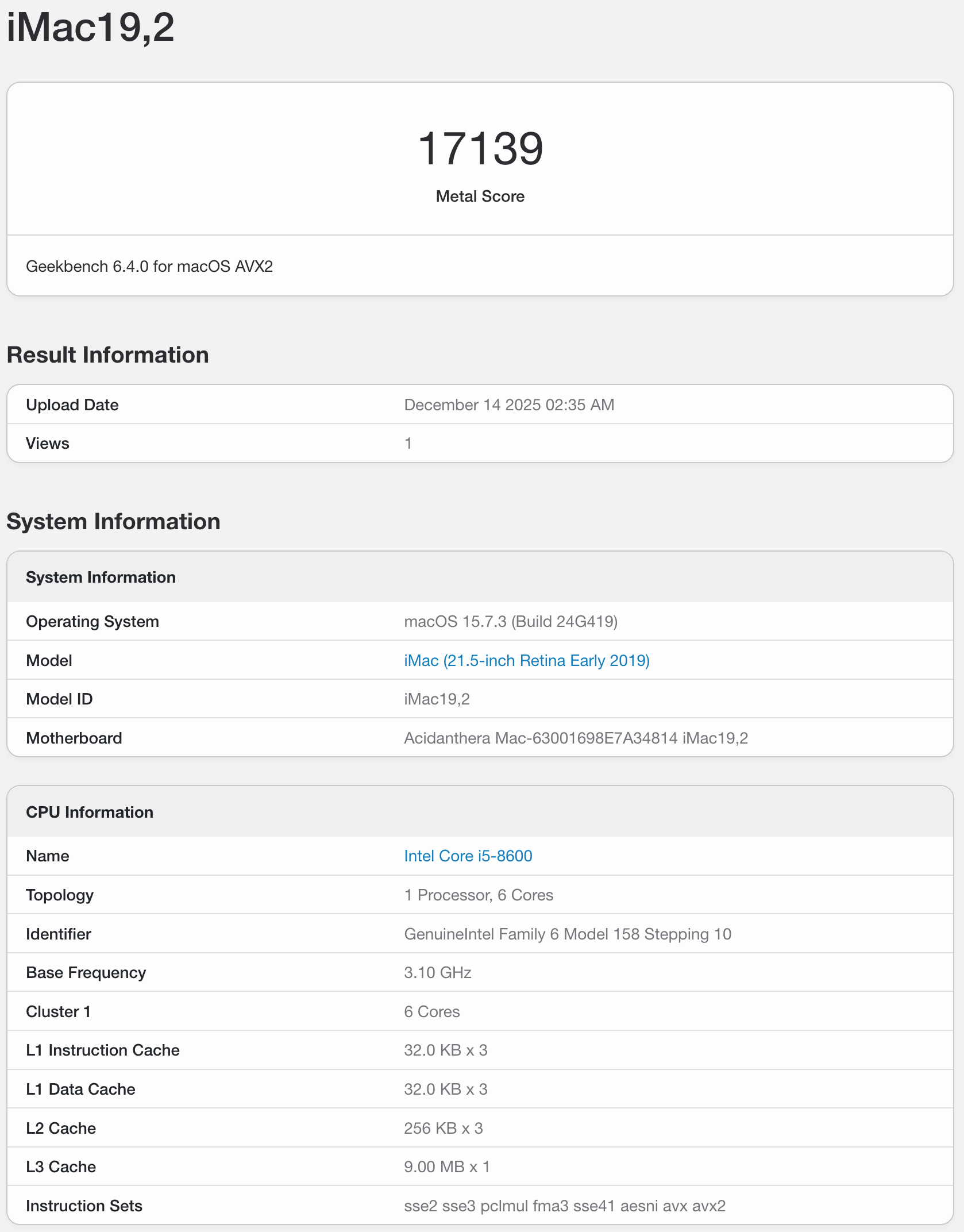

ird Posted December 31, 2025 Share Posted December 31, 2025 On 12/14/2025 at 5:59 AM, deeveedee said: @ird Replying here in response to your post in the other thread (no worries). I am also seeing reduced GeekBench 6 dGPU benchmarks after upgrading to macOS Tahoe 26.2. My metal benchmark is consistently ~19K (down from ~24K) after repeated reboots. pci-aspm-default setting for the dGPU doesn't seem to affect the benchmark as you have observed. After examining the pci-aspm-default properties for real Macs, I am currently adding the property for NVMe SSDs, HDEF (HDAS), Ethernet, HDAU, dGPU. Reveal hidden contents EDIT: @ird I installed macOS 26.1 in an additional APFS volume so that I can A/B performance testing between 26.1 and 26.2 (booting both with the same EFI). In repeated tests, macOS 26.1 consistently produces GB6 Metal Benchmarks = 23K-24K while macOS 26.2 consistently produces GB6 Metal Benchmarks = ~19K. Interesting, I'm still on Sequoia 15.7.3 and I'm seeing lower dGPU GB6 scores, this has been the case for quite some time now. I wonder if it has to do with iMac19,2 vs MacMini8,1 SMBIOS differences. Link to comment https://www.insanelymac.com/forum/topic/359277-hp-elitedesk-800-g4-g5-mini-with-rx560x-dgpu-hackintosh/page/17/#findComment-2845619 Share on other sites More sharing options...

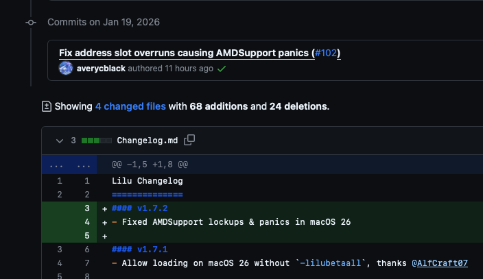

deeveedee Posted January 14 Author Share Posted January 14 (edited) A fix to Lilu.kext is coming which will address the Radeon dGPU install issues that we have been experiencing in Tahoe. With this Lilu fix, there are no changes needed for WhateverGreen.kext. After this Lilu change is released and the new Lilu.kext is included in our EFIs, there will be no need for boot-arg -wegnoegpu when updating Tahoe. Thank you @Avery B !!! Edited January 14 by deeveedee 3 Link to comment https://www.insanelymac.com/forum/topic/359277-hp-elitedesk-800-g4-g5-mini-with-rx560x-dgpu-hackintosh/page/17/#findComment-2846416 Share on other sites More sharing options...

deeveedee Posted January 19 Author Share Posted January 19 The Lilu fix that resolves problems when upgrading Tahoe with our dGPU is now available in a Lilu artifact and will be officially available in Lilu.kext 1.7.2. 2 Link to comment https://www.insanelymac.com/forum/topic/359277-hp-elitedesk-800-g4-g5-mini-with-rx560x-dgpu-hackintosh/page/17/#findComment-2846659 Share on other sites More sharing options...
deeveedee Posted January 29 Author Share Posted January 29 (edited) The new Lilu.kext 1.7.2 works perfectly. I upgraded my EFI with Lilu.kext 1.7.2 Beta prior to upgrading from Tahoe 26.3 Beta 2 -> Beta 3. The upgrade proceded without issues and without needing boot-arg -wegnoegpu. macOS upgrades are back to "normal" with the new Lilu.kext. Well done Avery B! Note that I still needed to temporarily disable BluetoolFixup.kext to allow the incremental update. EDIT: Note that after the upgrade from Tahoe 26.3 Beta 2 -> Beta3, there are graphics artifacts around some cursors. This is a known issue with Tahoe 26.3 Beta 3 and affects systems with dGPUs and/or iGPUs. Edited January 29 by deeveedee 2 Link to comment https://www.insanelymac.com/forum/topic/359277-hp-elitedesk-800-g4-g5-mini-with-rx560x-dgpu-hackintosh/page/17/#findComment-2846956 Share on other sites More sharing options...

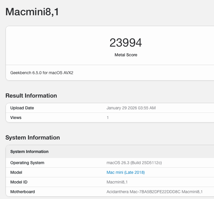

deeveedee Posted January 29 Author Share Posted January 29 Tahoe 26.3 Beta 3 has fixed the reduced Polaris GeekBench 6 Metal performance that I was seeing with previous versions of Tahoe 26.3. Metal performance as measured by GeekBench 6 is back to ~24K. Spoiler 2 Link to comment https://www.insanelymac.com/forum/topic/359277-hp-elitedesk-800-g4-g5-mini-with-rx560x-dgpu-hackintosh/page/17/#findComment-2846957 Share on other sites More sharing options...

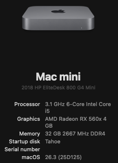

deeveedee Posted February 5 Author Share Posted February 5 Tahoe 26.3 (25D122) fixes the cursor artifacts while preserving the excellent GB6 Metal benchmark performance. Flawless update. More details here. 2 Link to comment https://www.insanelymac.com/forum/topic/359277-hp-elitedesk-800-g4-g5-mini-with-rx560x-dgpu-hackintosh/page/17/#findComment-2847130 Share on other sites More sharing options...

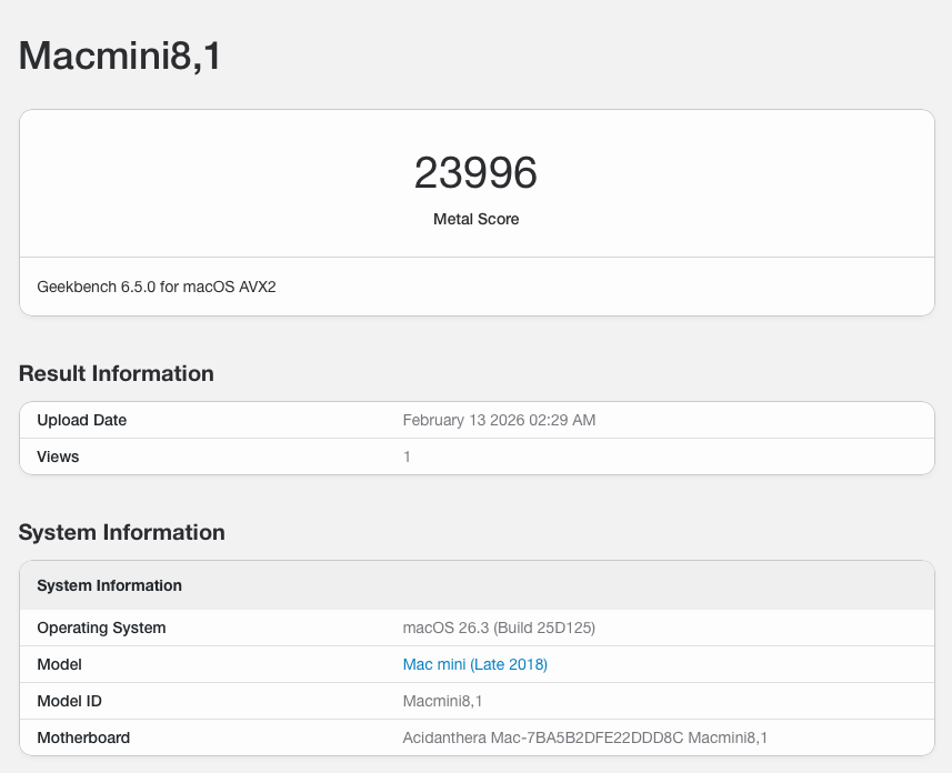

deeveedee Posted February 13 Author Share Posted February 13 Updated to Tahoe 26.3 (25D125) Release. No issues. GB6 Metal benchmarks continue to be excellent. This has become a perfect little hack for running macOS Tahoe. I'm still using VoodooHDA.kext 3.0.3 for audio and no Wi-Fi, so this hack needs no root patches (SIP csr-active-config = <01000000> for VoodooHDA.kext). About This Hack Spoiler GeekBench 6 Metal Spoiler 2 Link to comment https://www.insanelymac.com/forum/topic/359277-hp-elitedesk-800-g4-g5-mini-with-rx560x-dgpu-hackintosh/page/17/#findComment-2847347 Share on other sites More sharing options...
ird Posted February 15 Share Posted February 15 On 2/12/2026 at 6:36 PM, deeveedee said: Updated to Tahoe 26.3 (25D125) Release. No issues. GB6 Metal benchmarks continue to be excellent. This has become a perfect little hack for running macOS Tahoe. I'm still using VoodooHDA.kext 3.0.3 for audio and no Wi-Fi, so this hack needs no root patches (SIP csr-active-config = <01000000> for VoodooHDA.kext). About This Hack Reveal hidden contents GeekBench 6 Metal Reveal hidden contents This machine is equally good on previous version (I guess that's true by association :)). Just upgraded to BIOS 02.33.00 Rev.A and Sequoia 15.7.4 and everything works just great. After a long time, I've stopped tinkering with my computers and starting to "just use it" 1 Link to comment https://www.insanelymac.com/forum/topic/359277-hp-elitedesk-800-g4-g5-mini-with-rx560x-dgpu-hackintosh/page/17/#findComment-2847431 Share on other sites More sharing options...

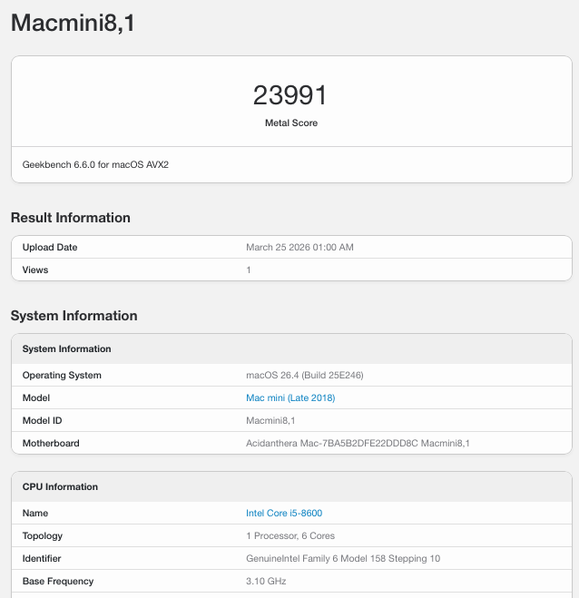

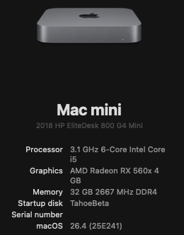

deeveedee Posted March 25 Author Share Posted March 25 (edited) I upgraded this hack to macOS Tahoe Release 26.4 (25E246). GeekBench 6 Metal benchmarks remain consistent with the best synthetic benchmarks that I've seen on this little hack. Spoiler EDIT: Unfortunately for real MacMini 8,1 owners, OCLP Devs are still struggling with the T2 chip. Tahoe patching for the real MacMini 8,1 is significantly delayed (maybe permanently?). This HackMini has turned out to be a way better investment than a real MacMini 8,1. Very happy to still be running the latest macOS on Intel. Edited March 25 by deeveedee 1 1 Link to comment https://www.insanelymac.com/forum/topic/359277-hp-elitedesk-800-g4-g5-mini-with-rx560x-dgpu-hackintosh/page/17/#findComment-2848408 Share on other sites More sharing options...

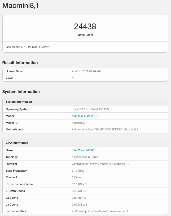

deeveedee Posted April 14 Author Share Posted April 14 (edited) I performed a clean installation of macOS Tahoe 26.4.1 in a new test volume. Much to my pleasant surprise, GeekBench 6 Metal benchmarks are among the best I've observed on this little hack! Spoiler Maybe the incremental installs had retained garbage from my previous experiments with the RX 560x. I don't know for sure, but I'll take it! Edited April 14 by deeveedee 1 Link to comment https://www.insanelymac.com/forum/topic/359277-hp-elitedesk-800-g4-g5-mini-with-rx560x-dgpu-hackintosh/page/17/#findComment-2849114 Share on other sites More sharing options...
