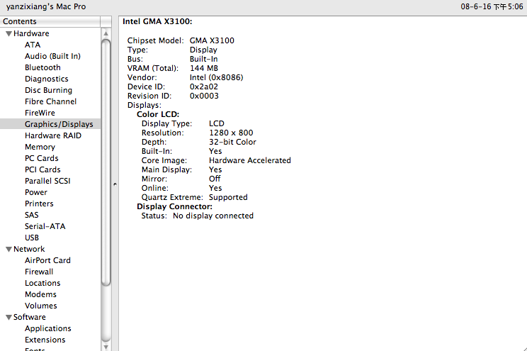

yanzixiang Posted June 16, 2008 Share Posted June 16, 2008 it is :Pworking prefectly working here, but ,i don't know why, every time i must reboot two times before i can get the card working for me! need help; http://forum.netkas.org/index.php/topic,224.0.html Link to comment https://www.insanelymac.com/forum/topic/35881-gma-x3000/#findComment-785386 Share on other sites More sharing options...
