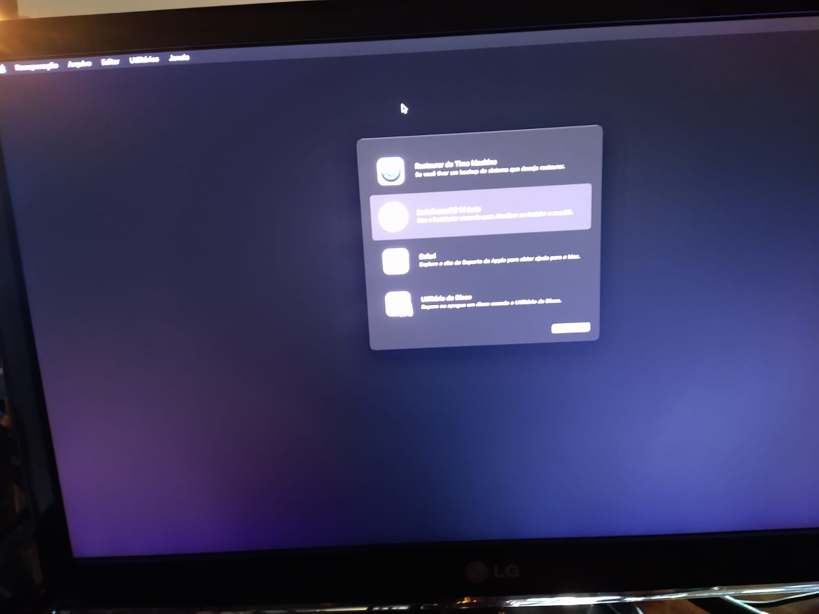

hello, anyone heave an idea what I'm doing wrong? I have all kexts up to date as I said before I did installer like in this topic OC 0.9.3. I was able install I mean first stage on smbios iMac20,1 then on second stage of installation I'm getting KP. I think I've tried everything but maybe I've missed something. can someone have a look on my refi please and tell me what's wrong? thank you for any help.
SonomaEFI.zip
I am using iMac20,2 on my 10th gen comet lake and I didn't had to change a single thing for installing Sonoma. So it's possible a config issue. Use the debug version of OpenCore and generate a bootlog

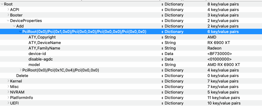

3 hours ago, The Tech said:
O RX 6900XT requer este Kext? Se sim, onde está a fonte desse kext?
For my desktop only used SSDT and DeviceProperties to RX6900XT
Boot args: -lilubeta -alcbeta -revbeta -wegbeta shikigva=40 alcid=12 watchdog=0 agdpmod=pikera npci=0x2000 keepsyms=1 (for sonoma)
SSDT-BRG0.aml.zip

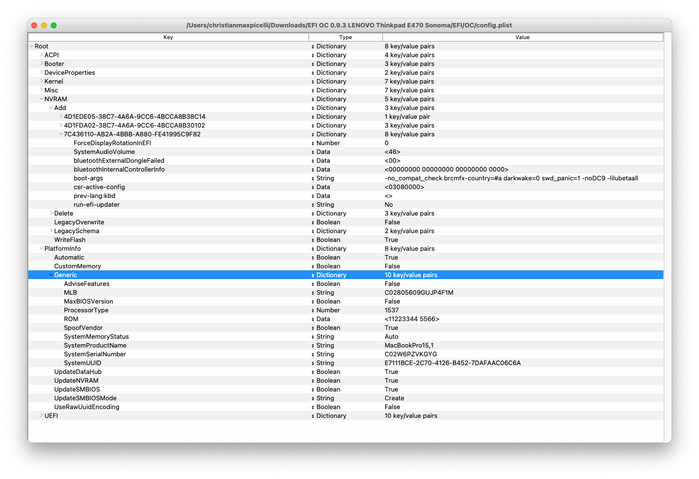

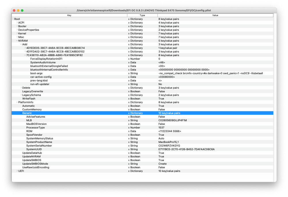

I suggest you use MacBookPro15,1
And based on my boot-args in this EFI
https://osxlatitude.com/forums/topic/19378-lenovo-thinkpad-e470-efi-opencore-093-sonoma-14-beta/?_fromLogin=1
Just look your intel UHD and change your own DDST or SSDT and serial SMBIOS.
Change Kexts what you need. Try this first.
My boot-args
-no_compat_check brcmfx-country=#a darkwake=0 swd_panic=1 -noDC9 -lilubetaall
824908019_EFIOC0.9.3LENOVOThinkpadE470Sonoma.zip
Edited by Max.1974

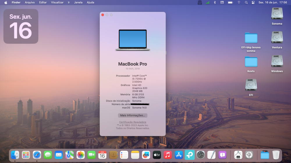

On 6/18/2023 at 12:56 PM, Cyberdevs said:
This one works amazingly well, Drop Copy can't handle large files but local send is pretty amazing. In case we can't get the WiFi to work in Sonoma this one can replace AirDrop!
Awesome my friend, im try used LocalSend but no success
On 6/18/2023 at 10:24 AM, AlfredoM said:
For the AirDrop problems, there is an alternative that is not quite as convenient, but it also works well for people who absolutely need it.
It's called Drop Copy
Thanks Alfredo I will try use it!!

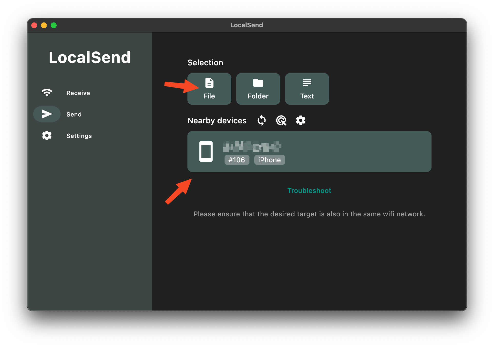

You need to have it installed on the devices that you want to transfer files between them, then add a file to transfer then select the destination as shown in the list.
Select Send on the computer you want to send the file from and you'll see the list of nearby devices that can receive the file
Spoiler
  • Like 3
  • Thanks 1
