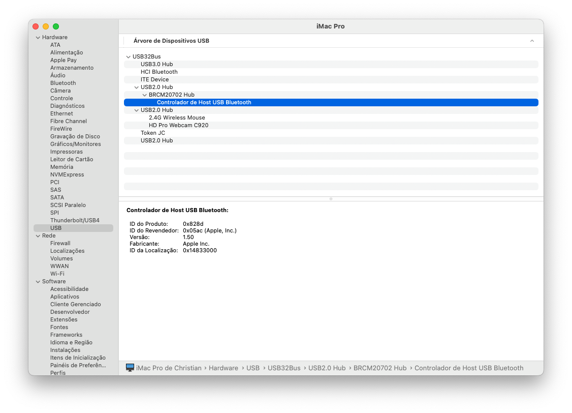

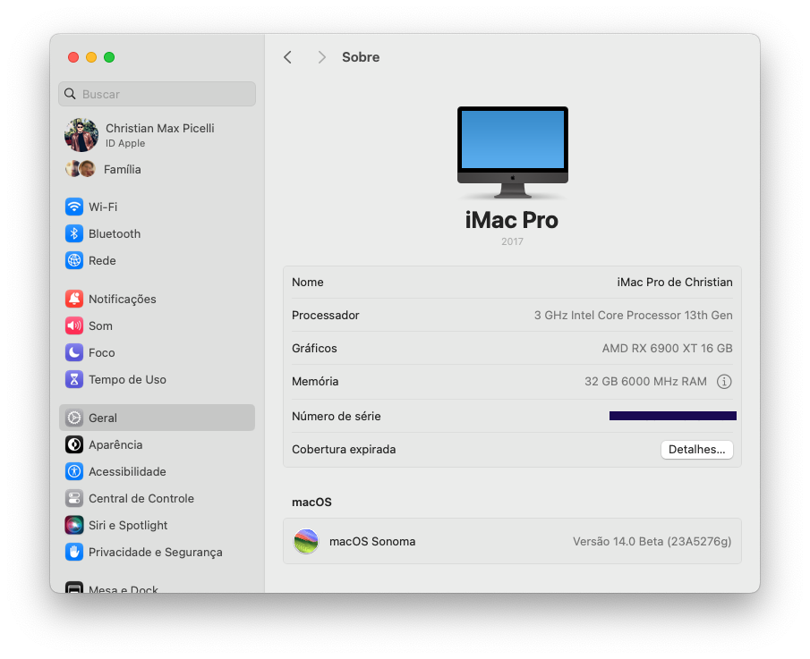

For some unknown reason to me, as soon as I change the SMBios, I loose Bluetooth and usb completely so cannot use Sonoma, have to revert to my normal EFI
To me works fine intel BT and Broadcom with different EFI
Maybe you can try repair permissions or ResetNvram

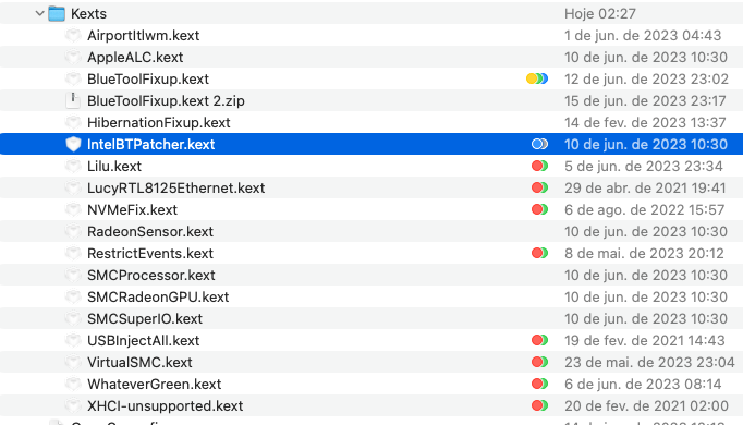

If you are using intel BT maybe you could try delete  this two kexts on EFI,  IntelBluetoothInjector.kext -  IntelBluetoothFirmware.kext,  and left only IntelBTPatcher.kext, works to me. image.png.44cbf1752c0c8f94de85f5a5142722a4.png
I use Fenvi T919 so I don't use Intel kexts or any kexts for bluetooth

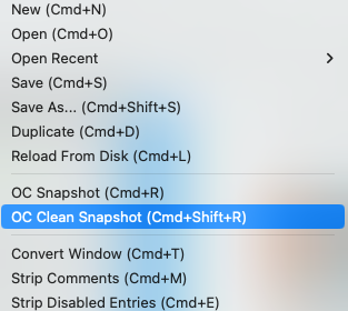

And don't forget use ProperTree to OC Clean Snapshot and save it before reboot.
I use OC Configurator, don't use Proper Tree as I cannot get it to load in Ventura or Sonoma for me, used to work in Monterey

It's so simple, you need install Python 3.9.9 only but OC Configurator is fine too.
Im use normally in all Sonoma Ventura etc...

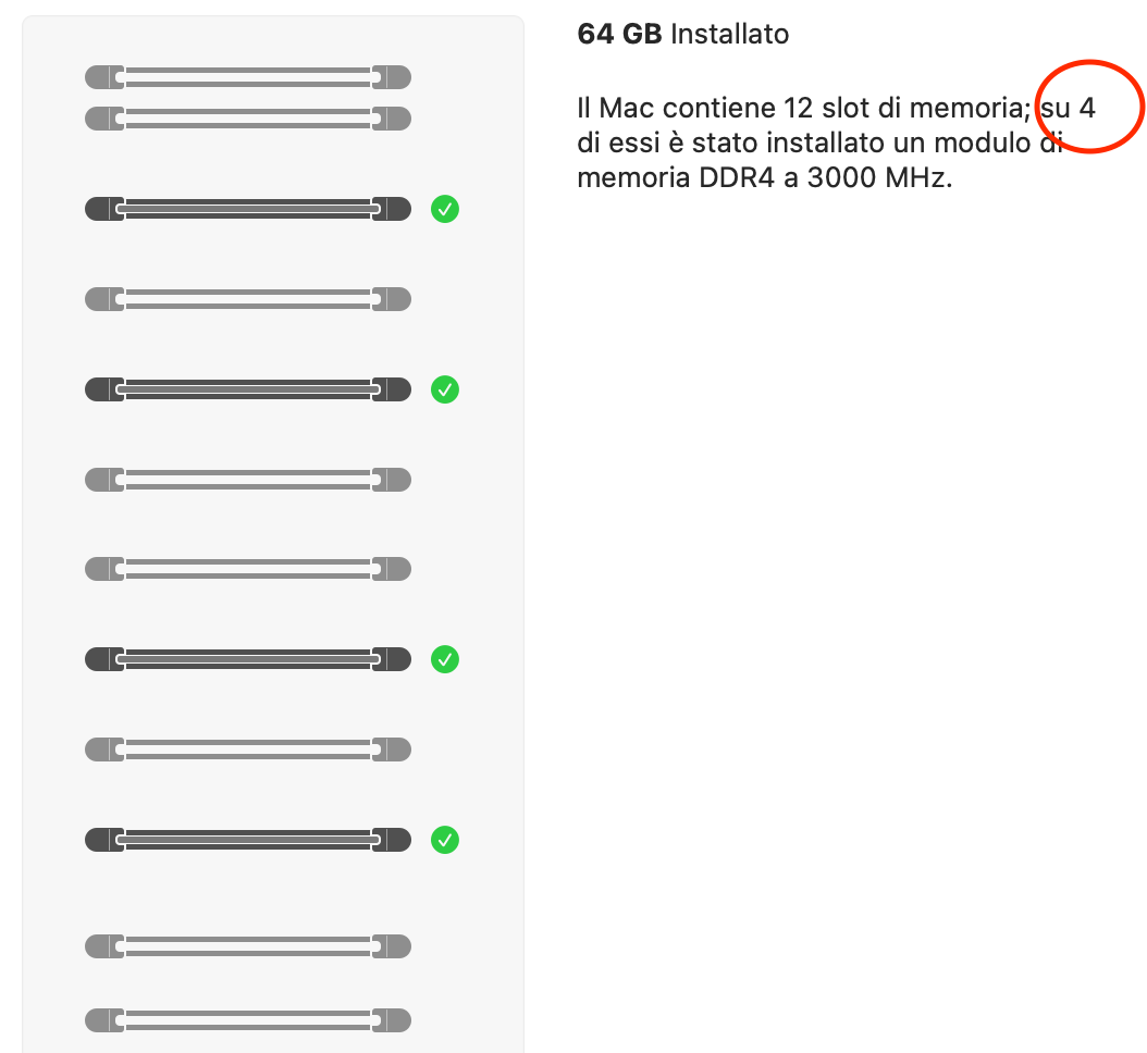

BTW... on MacPro7,1 smbios WITHOUT RestrictedEvent.kext and with properly configured custom memory field, the mismatch of number of used slot, seem to be solved.

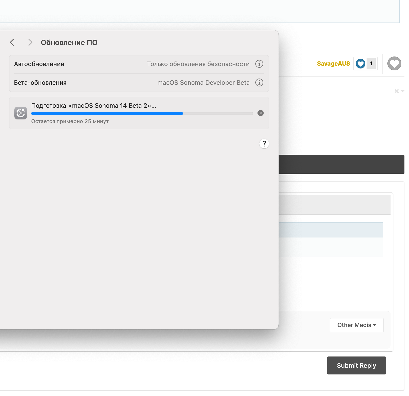

10 hours ago, eSaF said:
I don't think that can be the reason because my machine is registered.
  Reveal hidden contents
Did you log onto your developer account on this machine as well? Without login, no upates. Another possibility is that they roll it out for certain models first. And make sure to enable SIP because you won't get notified if flags like AllowUnauthenticatedRoot are set. Otherwise you need to add RestrictEvents.ext and add boot-org sbvmm (or the equivalent NVRAM Parameter)
Edited by cankiulascmnfye

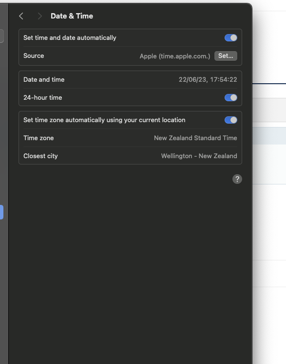

11 minutes ago, SavageAUS said:
I tried that and still stuck Cupertino.
Maybe because I have no wifi?
Sent from my iPhone using Tapatalk
Only LAN here, no wifi on z390, and time and zone are correct...maybe yours wanna be a Apple son and wanna live in Cup 🤣🤣🤣
