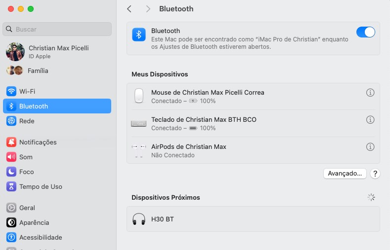

8 hours ago, surenmunoo said:
Anyone else notice that Handoff is working from iPad, iPhone or MacBook to Hackintosh Sonoma? My wifi is not working but it seems that Safari, messages etc from these devices show up.
Yea mine was working from installation, strange even though no wifi, maybe something to do with B/Tooth connection??!!
11 hours ago, iGPU said:
I applied your kexts and exclusion and got the following: a similar IORE (I'm also loading the AirportBrcmFixup kexts as shown at bottom):
Looks promising, I have a feeling the solution is not far away.
  • Like 4
Expected behavior since most Handoff functions operate over BT. AirPlay, AirDrop and other Continuity features will require Wi-Fi.
  • Thanks 1

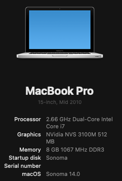

Sonoma beta1 can boot my very old P6TSE hackintoshs without GPU acceleration yet.
USB WiFi and ALC-888 audio are working.
Waiting for newer OCLP to patch my AMD legacy GCN !

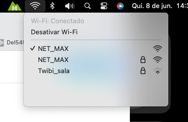

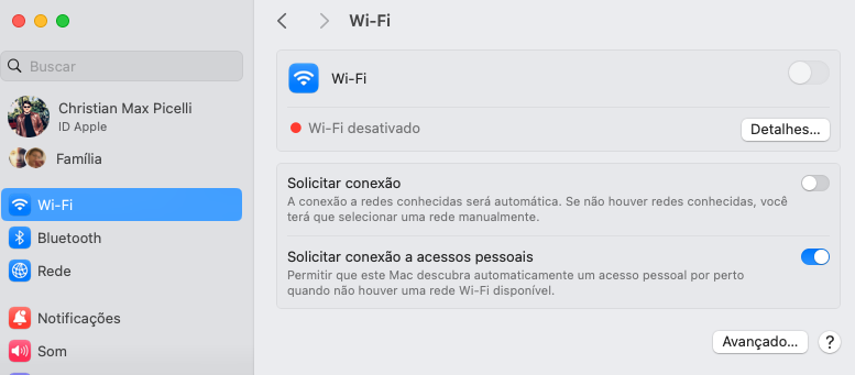

  • Thanks 1
You have two WIFI Icons showing!!!! The one is crossed out is not working so the second is the USB WIFI??!!
What USB Dongle is that?

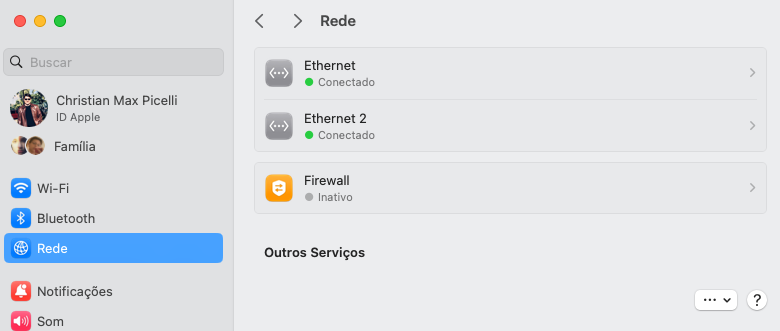

@Max.1974 - Sorry if I am missing something here but is the screenshot in your last post from your Sonoma install also is it from your Hackintosh?
The reason I ask I see you have WIFI working, if it is from your Hack how did you achieve what is eluding the rest of us or am I clutching at straws here.
Thanks for any explanation one way or another. :thumbsup_anim:
  • Like 3
  • Thanks 1
There are reports about RealTek, Intel and Atheros WiFi adapters working in Sonoma. It's gonna be one of those adapters.
  • Like 4
  • Thanks 2
3 minutes ago, miliuco said:
@eSaF@PoMpIs
Dear friend, @Max.1974 has Intel wifi if I'm not wrong.
EDIT: I'am late, just reading your last post after publishing mine.
Thanks a lot my dear friend.

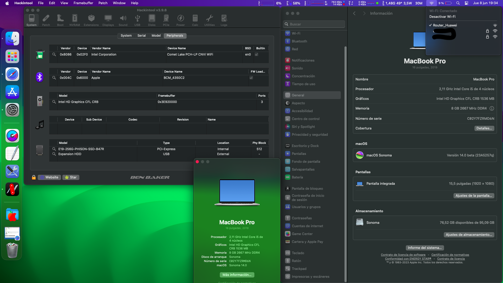

@eSaF my friend, I have Z790 Aorus that have intel wifi and bluetooth onboard. But for Hackintosh completely working Airdrop need Fenvi Broadcom T-1919 or another compatible.
Im install yesterday, and I ask a friend my how put to work intel wireless. Is this project here: https://github.com/OpenIntelWireless/itlwm Open Intel Wireless. I need use certificate digital media from Safesign, so im need use dual boot with our "old" and good Ventura. Just for fun im install wireless intel kext and works like a charm. You need kext and HeliPort app. Just like that. I never will be create an illusion from hack : ) ahahahah!!
All the best @miliuco and @eSaF
Thanks all!! Keep going!!!
