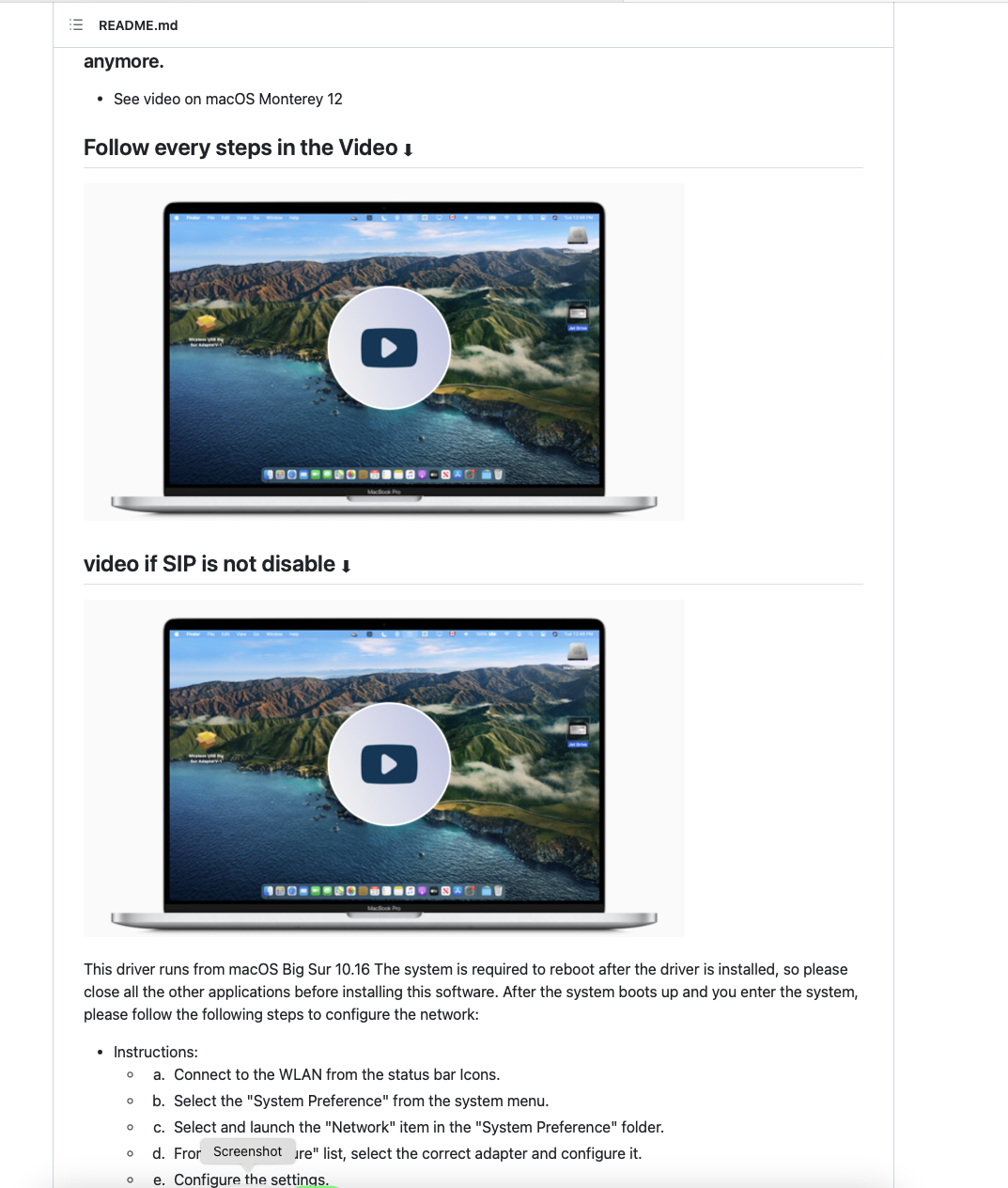

5 hours ago, Slice said:
I tried TL-WN725N which is USB WiFi Realtek based. It works in macOS but the provided driver is not compatible with Sonoma, sorry...
I happen to have two BrosTrend 1200 USB WiFi adapters (802.11ac). They use a Realtek chip and work well with @chris1111's driver:
Couple of notes:
  • SIP needs to be disabled; I use csr-active-config = FF0F0000
  • The driver does not connect to my network via WPA3-SAE, but works fine via WPA2-PSK
I've installed Sonoma (clean or fresh) on both of these systems without any instability so far:
  • Gigabyte Z390 Designare with Intel i5-9600K
    • iMac19,1
    • Radeon RX 580
  • Asus X670E Gene with AMD Ryzen 7 7700X
    • MacPro7,1
    • Radeon RX 6800
In both cases, latest builds of these kexts were downloaded from the Dortania builds page:
  • Lilu
  • WhateverGreen
  • AppleALC / AppleALCU
  • RestrictEvents
On AMD:
  • AM5 platform needs latest AMD-OSX kernel patches that were merged today
  • NVMeFix.kext may need to be disabled
With these updated kexts, no special boot arguments are needed.
Broadcom WiFi, as we know, does not work because of the removal of 80211FamilyLegacy.kext

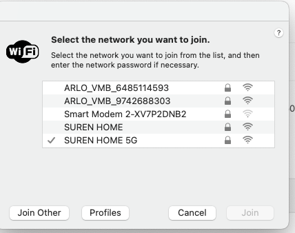

20 hours ago, eSaF said:
You have two WIFI Icons showing!!!! The one is crossed out is not working so the second is the USB WIFI??!!
What USB Dongle is that?
ASUS USB AC-68
  • Thanks 1
