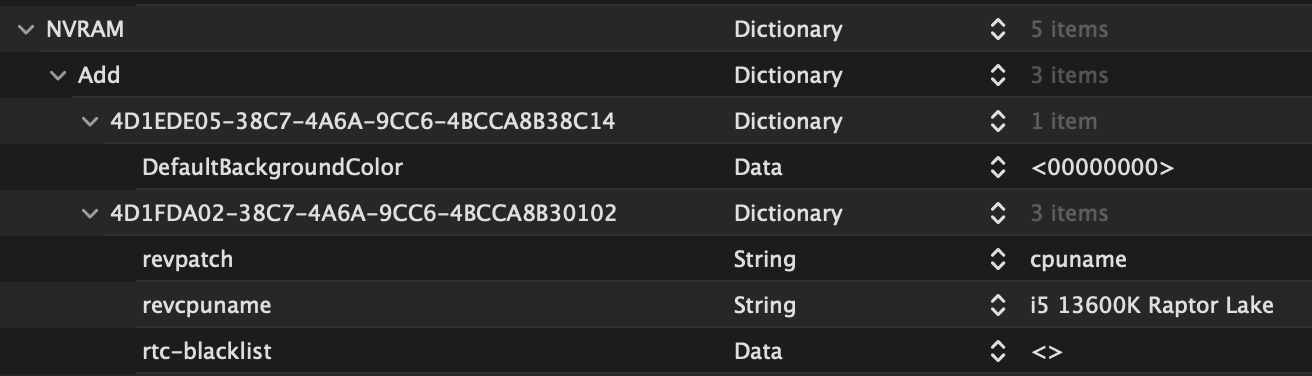

miliuco Posted June 7, 2023 Share Posted June 7, 2023 (edited) 3 hours ago, PoMpIs said: @miliuco Not even with -revbeta does RestrictEvents work fine for me... there is no way to show the 13600k. 🤷♂️ It works fine on the memory and PCI slots, but on the CPU it doesn't Try this in boot args (RestrictEvents 1.1.2 last commit fc446c5): Quote revpatch=cpuname revcpuname="i5 13600K Raptor Lake" Another way of adding those parameters is in NVRAM: Edited June 7, 2023 by miliuco 4 1 Link to comment https://www.insanelymac.com/forum/topic/356881-pre-release-macos-sonoma/page/9/#findComment-2805867 Share on other sites More sharing options...

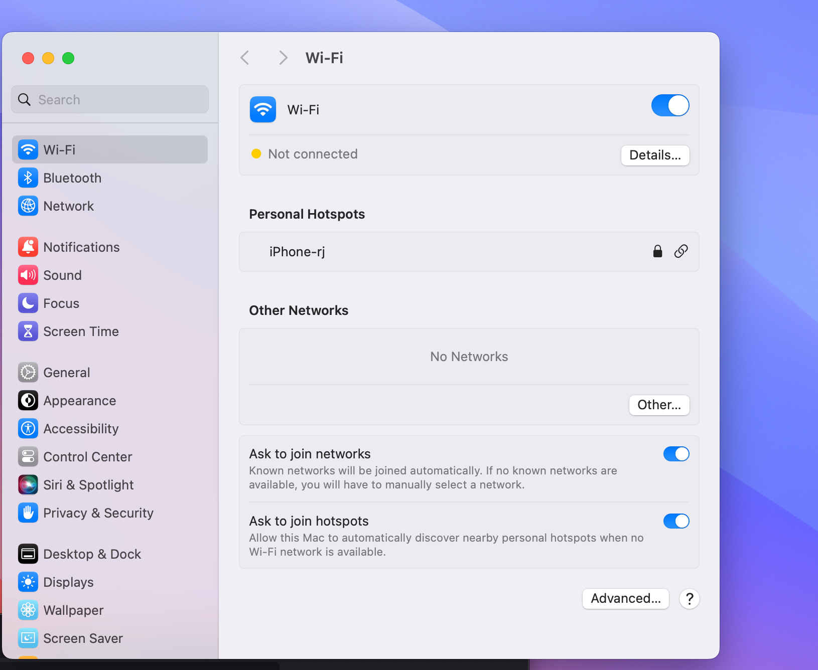

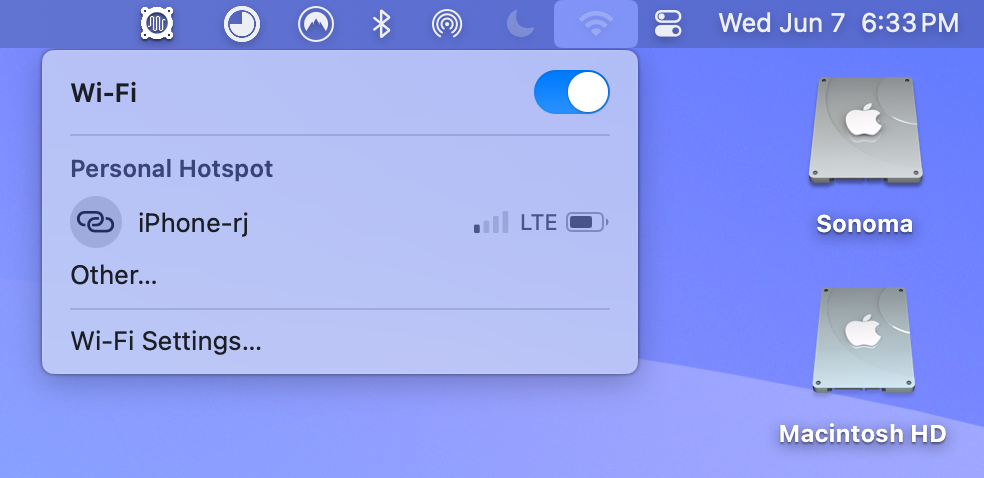

surenmunoo Posted June 8, 2023 Share Posted June 8, 2023 Anyone else notice that Handoff is working from iPad, iPhone or MacBook to Hackintosh Sonoma? My wifi is not working but it seems that Safari, messages etc from these devices show up. 2 Link to comment https://www.insanelymac.com/forum/topic/356881-pre-release-macos-sonoma/page/9/#findComment-2805874 Share on other sites More sharing options...
aben Posted June 8, 2023 Share Posted June 8, 2023 13 minutes ago, surenmunoo said: Anyone else notice that Handoff is working from iPad, iPhone or MacBook to Hackintosh Sonoma? My wifi is not working but it seems that Safari, messages etc from these devices show up. Expected behavior since most Handoff functions operate over BT. AirPlay, AirDrop and other Continuity features will require Wi-Fi. 1 1 Link to comment https://www.insanelymac.com/forum/topic/356881-pre-release-macos-sonoma/page/9/#findComment-2805877 Share on other sites More sharing options...

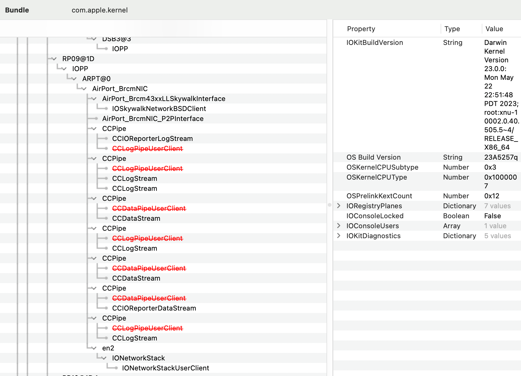

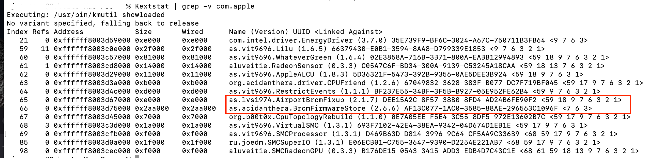

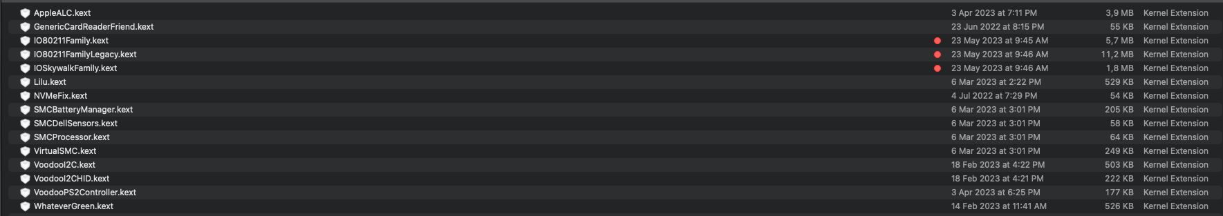

dreamwhite Posted June 8, 2023 Share Posted June 8, 2023 Some updates on my journey that started with 3 hours of sleep more or less (thx to 600mg of caffeine intake). Here's what I'm actually """studying""" on: Before doing these stupid analysis, I ran `kmutil showloaded > OS_CODENAME.txt` both on my stable Ventura 13.4 and macOS Sonoma 14 Beta 1. You can find the txt in the attachments. Let's start with IO80211LegacyFamily kext, which is missing from macOS Sonoma. Let's look at the Info.plist which contains the OSBundleLibraries (basically a list of dependencies): IO80211LegacyFamily has the following OSBundleLibraries: ... <key>OSBundleLibraries</key> <dict> <key>com.apple.driver.AppleMobileFileIntegrity</key> <string>1.0.1</string> <key>com.apple.driver.corecapture</key> <string>1.0.0</string> <key>com.apple.iokit.CoreAnalyticsFamily</key> <string>1.0</string> <key>com.apple.iokit.IONetworkingFamily</key> <string>3.0</string> <key>com.apple.iokit.IOSkywalkFamily</key> <string>1.0</string> <key>com.apple.kec.corecrypto</key> <string>1.0</string> <key>com.apple.kpi.bsd</key> <string>15.0.0</string> <key>com.apple.kpi.iokit</key> <string>15.0.0</string> <key>com.apple.kpi.libkern</key> <string>15.0.0</string> <key>com.apple.kpi.mach</key> <string>15.0.0</string> <key>com.apple.kpi.private</key> <string>15.0.0</string> <key>com.apple.kpi.unsupported</key> <string>15.0.0</string> </dict> ... Trying to inject IO80211FamilyLegacy alone raises an error since IOSkywalkFamily cannot be patched (vtable stuff, I don't know, I don't work for Apple nor acidanthera yet) I tried replacing pretty every networking related kext without any success (probably need root-patching but I want to use vanilla options if possible). Below a few things I noticed between Sonoma and Ventura (paired Sonoma-Ventura) < 54 11 0xffffff800249a000 0x16ff4 0x16ff4 com.apple.iokit.IONetworkingFamily (3.4) 3595A42C-1185-344D-AA32-FB2073E2407D <9 8 7 6 3 1> > 51 11 0xffffff8002c30000 0x16ff4 0x16ff4 com.apple.iokit.IONetworkingFamily (3.4) F349EF33-2C2B-32F4-BE0F-284D3A56E2DF <9 8 7 6 3 1> < 56 5 0xffffff8003f8c000 0xce000 0xce000 com.apple.iokit.IOSkywalkFamily (1.0) 035A9AD9-6CDE-362F-8DEC-B664BC6431EC <55 54 9 8 7 6 3 1> > 53 5 0xffffff8002f7d000 0x2d000 0x2d000 com.apple.iokit.IOSkywalkFamily (1.0) 035A9AD9-6CDE-362F-8DEC-B664BC6431EC <52 51 9 8 7 6 3 1> < 55 2 0xffffff80026f3000 0x5000 0x5000 com.apple.driver.mDNSOffloadUserClient (1.0.1b8) A660606B-5FC6-35F4-9B2F-B7007A9C4F03 <54 8 6 3 1> > 52 2 0xffffff8002e8a000 0x5000 0x5000 com.apple.driver.mDNSOffloadUserClient (1.0.1b8) BA6FE987-65DB-34CE-AAA0-CEBB09C55B21 <51 8 6 3 1> Next tests I'll do will probably replace IO80211Family from OpenCore, hoping at least it boots and no issue so far pops up. Will keep updated if anything changes sonoma_kmutil.txt ventura_kmutil.txt 6 6 Link to comment https://www.insanelymac.com/forum/topic/356881-pre-release-macos-sonoma/page/9/#findComment-2805888 Share on other sites More sharing options...

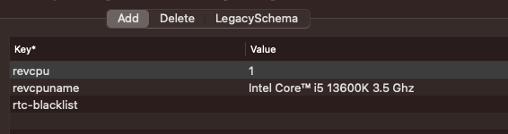

PoMpIs Posted June 8, 2023 Share Posted June 8, 2023 12 hours ago, Cyberdevs said: @PoMpIs Set the processor type to 0 and that might fix the CPU issue. Correct, in "0" I already had it. It is the same EFI that I use in Ventura which does show the CPU well 🤷♂️ 10 hours ago, miliuco said: Try this in boot args (RestrictEvents 1.1.2 last commit fc446c5): Another way of adding those parameters is in NVRAM: I have it like this: Which is working perfectly in Ventura... Anyway, at night I'll keep trying... It's just that I use that computer very little and when I use it it's usually in Windows Link to comment https://www.insanelymac.com/forum/topic/356881-pre-release-macos-sonoma/page/9/#findComment-2805890 Share on other sites More sharing options...
dreamwhite Posted June 8, 2023 Share Posted June 8, 2023 53 minutes ago, dreamwhite said: Some updates on my journey that started with 3 hours of sleep more or less (thx to 600mg of caffeine intake). Here's what I'm actually """studying""" on: Before doing these stupid analysis, I ran `kmutil showloaded > OS_CODENAME.txt` both on my stable Ventura 13.4 and macOS Sonoma 14 Beta 1. You can find the txt in the attachments. Let's start with IO80211LegacyFamily kext, which is missing from macOS Sonoma. Let's look at the Info.plist which contains the OSBundleLibraries (basically a list of dependencies): IO80211LegacyFamily has the following OSBundleLibraries: ... <key>OSBundleLibraries</key> <dict> <key>com.apple.driver.AppleMobileFileIntegrity</key> <string>1.0.1</string> <key>com.apple.driver.corecapture</key> <string>1.0.0</string> <key>com.apple.iokit.CoreAnalyticsFamily</key> <string>1.0</string> <key>com.apple.iokit.IONetworkingFamily</key> <string>3.0</string> <key>com.apple.iokit.IOSkywalkFamily</key> <string>1.0</string> <key>com.apple.kec.corecrypto</key> <string>1.0</string> <key>com.apple.kpi.bsd</key> <string>15.0.0</string> <key>com.apple.kpi.iokit</key> <string>15.0.0</string> <key>com.apple.kpi.libkern</key> <string>15.0.0</string> <key>com.apple.kpi.mach</key> <string>15.0.0</string> <key>com.apple.kpi.private</key> <string>15.0.0</string> <key>com.apple.kpi.unsupported</key> <string>15.0.0</string> </dict> ... Trying to inject IO80211FamilyLegacy alone raises an error since IOSkywalkFamily cannot be patched (vtable stuff, I don't know, I don't work for Apple nor acidanthera yet) I tried replacing pretty every networking related kext without any success (probably need root-patching but I want to use vanilla options if possible). Below a few things I noticed between Sonoma and Ventura (paired Sonoma-Ventura) < 54 11 0xffffff800249a000 0x16ff4 0x16ff4 com.apple.iokit.IONetworkingFamily (3.4) 3595A42C-1185-344D-AA32-FB2073E2407D <9 8 7 6 3 1> > 51 11 0xffffff8002c30000 0x16ff4 0x16ff4 com.apple.iokit.IONetworkingFamily (3.4) F349EF33-2C2B-32F4-BE0F-284D3A56E2DF <9 8 7 6 3 1> < 56 5 0xffffff8003f8c000 0xce000 0xce000 com.apple.iokit.IOSkywalkFamily (1.0) 035A9AD9-6CDE-362F-8DEC-B664BC6431EC <55 54 9 8 7 6 3 1> > 53 5 0xffffff8002f7d000 0x2d000 0x2d000 com.apple.iokit.IOSkywalkFamily (1.0) 035A9AD9-6CDE-362F-8DEC-B664BC6431EC <52 51 9 8 7 6 3 1> < 55 2 0xffffff80026f3000 0x5000 0x5000 com.apple.driver.mDNSOffloadUserClient (1.0.1b8) A660606B-5FC6-35F4-9B2F-B7007A9C4F03 <54 8 6 3 1> > 52 2 0xffffff8002e8a000 0x5000 0x5000 com.apple.driver.mDNSOffloadUserClient (1.0.1b8) BA6FE987-65DB-34CE-AAA0-CEBB09C55B21 <51 8 6 3 1> Next tests I'll do will probably replace IO80211Family from OpenCore, hoping at least it boots and no issue so far pops up. Will keep updated if anything changes sonoma_kmutil.txt 26.47 kB · 1 download ventura_kmutil.txt 27.03 kB · 2 downloads Tested IO80211Family injection through OpenCore (after using Exclude strategy for both IOSkywalkFamily and IO80211Family): 06:533 00:191 OCAK: Patching invalid size 2DFF8 with 1425000 for com.apple.iokit.IOSkywalkFamily 06:541 00:007 OCAK: Excluding com.apple.iokit.IOSkywalkFamily - VirtualBase FFFFFF80027E7000, MaxSize 3F000 06:548 00:007 OCAK: Found kext com.apple.iokit.IOSkywalkFamily (9AD15018) from link 9AD15020 to drop 06:554 00:005 OCAK: Erasing com.apple.iokit.IOSkywalkFamily from prelinked kext under dict index 3, plist 9B529E18, plist index 167 06:560 00:006 OC: Prelinked blocker (Exclude) result 0 for com.apple.iokit.IOSkywalkFamily (Block IOSkywalkFamily kext) - Success 06:570 00:010 OCAK: Patching invalid size 26AFF8 with 1C2C000 for com.apple.iokit.IO80211Family 06:576 00:005 OCAK: Excluding com.apple.iokit.IO80211Family - VirtualBase FFFFFF8001FE0000, MaxSize 2AA000 06:583 00:007 OCAK: Found kext com.apple.iokit.IO80211Family (9B528018) from link 9B528020 to drop 06:589 00:005 OCAK: Erasing com.apple.iokit.IO80211Family from prelinked kext under dict index 4, plist 9B5F2F18, plist index 122 06:595 00:006 OC: Prelinked blocker (Exclude) result 1 for com.apple.iokit.IO80211Family (Block IO80211Family kext) - Success ... 07:694 00:012 OCAK: Patching invalid size 5000 with 151C000 for com.apple.driver.mDNSOffloadUserClient 07:706 00:011 OCAK: Patching invalid size 16FF4 with 1775000 for com.apple.iokit.IONetworkingFamily 07:925 00:219 OCAK: Local relocs 7087 on FFFFFF8003F8D000 07:993 00:067 OC: Prelinked injection IOSkywalkFamily.kext () - Success 08:000 00:006 OC: Prelinked injection IOSkywalkFamily.kext v1.0 08:010 00:009 OCAK: Patching invalid size 36FF1 with 21D0000 for com.apple.driver.AppleMobileFileIntegrity 08:021 00:010 OCAK: Patching invalid size 9FF7 with 1DFA000 for com.apple.iokit.CoreAnalyticsFamily 08:041 00:019 OCAK: Patching invalid size 7AFD0 with CA8000 for com.apple.kec.corecrypto 08:051 00:010 OCAK: Patching invalid size 9FFA with 1D1E000 for com.apple.kext.CoreTrust 08:058 00:007 OCAK: Patching invalid size 1FFF2 with 2314000 for com.apple.security.AppleImage4 08:079 00:021 OCAK: Patching invalid size 22FF5 with CD9000 for com.apple.driver.corecapture 08:551 00:471 OCAK: Local relocs 8897 on FFFFFF800405B000 08:622 00:070 OC: Prelinked injection IO80211FamilyLegacy.kext () - Success 08:630 00:008 OC: Prelinked injection IO80211FamilyLegacy.kext v1200.12.2b1 08:834 00:204 OCAK: Local relocs 6983 on FFFFFF8004265000 08:881 00:046 OC: Prelinked injection IO80211FamilyLegacy.kext\Contents\PlugIns\AirPortBrcmNIC.kext () - Success 08:886 00:005 OC: Prelinked injection IO80211FamilyLegacy.kext\Contents\PlugIns\AirPortBrcmNIC.kext v1400.1.1 08:907 00:021 OCAK: Local relocs 305 on FFFFFF8004B08000 08:915 00:007 OC: Prelinked injection IO80211FamilyLegacy.kext\Contents\PlugIns\IO80211NetBooter.kext () - Success 08:921 00:005 OC: Prelinked injection IO80211FamilyLegacy.kext\Contents\PlugIns\IO80211NetBooter.kext v1200.12.2b1 09:549 00:628 OCAK: Local relocs 11498 on FFFFFF8004B18000 09:635 00:086 OC: Prelinked injection IO80211Family.kext () - Success 09:643 00:007 OC: Prelinked injection IO80211Family.kext v1200.13.0 09:649 00:005 OC: Prelink size 80408576 kext offset 61927424 reserved 18481152 09:655 00:006 OCAK: KC TEXT is 65536 bytes with 62032 Mach-O headers need 1456 10:174 00:518 OC: Prelinked status - Success ... These are the kext I'm using (NVMeFix not loaded): This is the kext order I'm using: <dict> <key>Arch</key> <string>x86_64</string> <key>BundlePath</key> <string>IOSkywalkFamily.kext</string> <key>Comment</key> <string></string> <key>Enabled</key> <true/> <key>ExecutablePath</key> <string>Contents/MacOS/IOSkywalkFamily</string> <key>MaxKernel</key> <string></string> <key>MinKernel</key> <string></string> <key>PlistPath</key> <string>Contents/Info.plist</string> </dict> <dict> <key>Arch</key> <string>x86_64</string> <key>BundlePath</key> <string>IO80211FamilyLegacy.kext</string> <key>Comment</key> <string></string> <key>Enabled</key> <true/> <key>ExecutablePath</key> <string>Contents/MacOS/IO80211FamilyLegacy</string> <key>MaxKernel</key> <string></string> <key>MinKernel</key> <string></string> <key>PlistPath</key> <string>Contents/Info.plist</string> </dict> <dict> <key>Arch</key> <string>x86_64</string> <key>BundlePath</key> <string>IO80211FamilyLegacy.kext/Contents/PlugIns/AirPortBrcmNIC.kext</string> <key>Comment</key> <string></string> <key>Enabled</key> <true/> <key>ExecutablePath</key> <string>Contents/MacOS/AirPortBrcmNIC</string> <key>MaxKernel</key> <string></string> <key>MinKernel</key> <string></string> <key>PlistPath</key> <string>Contents/Info.plist</string> </dict> <dict> <key>Arch</key> <string>x86_64</string> <key>BundlePath</key> <string>IO80211FamilyLegacy.kext/Contents/PlugIns/IO80211NetBooter.kext</string> <key>Comment</key> <string></string> <key>Enabled</key> <true/> <key>ExecutablePath</key> <string>Contents/MacOS/IO80211NetBooter</string> <key>MaxKernel</key> <string></string> <key>MinKernel</key> <string></string> <key>PlistPath</key> <string>Contents/Info.plist</string> </dict> <dict> <key>Arch</key> <string>x86_64</string> <key>BundlePath</key> <string>IO80211Family.kext</string> <key>Comment</key> <string></string> <key>Enabled</key> <true/> <key>ExecutablePath</key> <string>Contents/MacOS/IO80211Family</string> <key>MaxKernel</key> <string></string> <key>MinKernel</key> <string></string> <key>PlistPath</key> <string>Contents/Info.plist</string> </dict> IO80211Family depends on: <key>OSBundleLibraries</key> <dict> <key>com.apple.driver.AppleMobileFileIntegrity</key> <string>1.0.1</string> <key>com.apple.driver.corecapture</key> <string>1.0.0</string> <key>com.apple.iokit.CoreAnalyticsFamily</key> <string>1.0</string> <key>com.apple.iokit.IONetworkingFamily</key> <string>3.0</string> <key>com.apple.iokit.IOSkywalkFamily</key> <string>1.0</string> <key>com.apple.kec.corecrypto</key> <string>1.0</string> <key>com.apple.kpi.bsd</key> <string>15.0.0</string> <key>com.apple.kpi.iokit</key> <string>15.0.0</string> <key>com.apple.kpi.libkern</key> <string>15.0.0</string> <key>com.apple.kpi.mach</key> <string>15.0.0</string> <key>com.apple.kpi.private</key> <string>15.0.0</string> <key>com.apple.kpi.unsupported</key> <string>15.0.0</string> </dict> This means that IOSkywalkFamily and IONetworkingFamily must be loaded BEFORE IO80211Family. The same applies more or less to IO80211FamilyLegacy. AirportBrcmNIC instead, depends on: <key>OSBundleLibraries</key> <dict> <key>com.apple.driver.corecapture</key> <string>1.0.0</string> <key>com.apple.driver.mDNSOffloadUserClient</key> <string>1.0.0d7</string> <key>com.apple.iokit.IO80211FamilyLegacy</key> <string>600.0</string> <key>com.apple.iokit.IONetworkingFamily</key> <string>3.1</string> <key>com.apple.iokit.IOPCIFamily</key> <string>2.8</string> <key>com.apple.iokit.IOSkywalkFamily</key> <string>1.0</string> <key>com.apple.kpi.bsd</key> <string>13.0.0</string> <key>com.apple.kpi.iokit</key> <string>13.0.0</string> <key>com.apple.kpi.libkern</key> <string>13.0.0</string> <key>com.apple.kpi.mach</key> <string>13.0.0</string> <key>com.apple.kpi.private</key> <string>14.0.0</string> <key>com.apple.kpi.unsupported</key> <string>13.0.0</string> </dict> This means that before AirportBrcmNIC, IOSkywalkFamily, IONetworkingFamily, IO80211FamilyLegacy and mDNSOffloadUserClient must be injected. IO80211NetBooter instead depends on: <key>OSBundleLibraries</key> <dict> <key>com.apple.iokit.IO80211FamilyLegacy</key> <string>1200.12.2b1</string> <key>com.apple.iokit.IONetworkingFamily</key> <string>3.0</string> <key>com.apple.kpi.bsd</key> <string>15.0.0</string> <key>com.apple.kpi.iokit</key> <string>15.0.0</string> <key>com.apple.kpi.libkern</key> <string>15.0.0</string> <key>com.apple.kpi.mach</key> <string>15.0.0</string> <key>com.apple.kpi.unsupported</key> <string>15.0.0</string> </dict> therefore, IO80211FamilyLegacy and IONetworkingFamily come before it. Finally, IOSkywalkFamily depends on: <key>OSBundleLibraries</key> <dict> <key>com.apple.driver.mDNSOffloadUserClient</key> <string>1.0.0d6</string> <key>com.apple.iokit.IONetworkingFamily</key> <string>3.2</string> <key>com.apple.kpi.bsd</key> <string>15.0.0</string> <key>com.apple.kpi.iokit</key> <string>15.0.0</string> <key>com.apple.kpi.libkern</key> <string>15.0.0</string> <key>com.apple.kpi.mach</key> <string>15.0.0</string> <key>com.apple.kpi.private</key> <string>15.0.0</string> <key>com.apple.kpi.unsupported</key> <string>15.0.0</string> </dict> therefore mDNSOffloadUserClient and IONetworkingFamily come before it. kmutil analysis IONetworkingFamily kext seems to be the same both in Ventura and Sonoma Beta 1 except for the UUID (don't know if this plays a role here or not) < 54 11 0xffffff800249a000 0x16ff4 0x16ff4 com.apple.iokit.IONetworkingFamily (3.4) 3595A42C-1185-344D-AA32-FB2073E2407D <9 8 7 6 3 1> > 51 11 0xffffff8002c30000 0x16ff4 0x16ff4 com.apple.iokit.IONetworkingFamily (3.4) F349EF33-2C2B-32F4-BE0F-284D3A56E2DF <9 8 7 6 3 1> mDNSOffloadUserClient also seems to be the same except for the UUID: < 55 2 0xffffff80026f3000 0x5000 0x5000 com.apple.driver.mDNSOffloadUserClient (1.0.1b8) A660606B-5FC6-35F4-9B2F-B7007A9C4F03 <54 8 6 3 1> > 52 2 0xffffff8002e8a000 0x5000 0x5000 com.apple.driver.mDNSOffloadUserClient (1.0.1b8) BA6FE987-65DB-34CE-AAA0-CEBB09C55B21 <51 8 6 3 1> IO80211Family idem: < 89 1 0xffffff800405a000 0x20a000 0x20a000 com.apple.iokit.IO80211FamilyLegacy (1200.12.2b1) 4C07538B-62EB-3D6D-AEF9-93BCDCF45FAB <88 56 54 27 24 10 9 8 7 6 3 1> > 89 1 0xffffff80020d0000 0x146ffd 0x146ffd com.apple.iokit.IO80211FamilyLegacy (1200.12.2b1) 5969C2D2-CF58-3D6E-A372-EB8E49BF3049 <88 53 51 31 27 10 9 8 7 6 3 1> What I cannot find is IO80211Family which even on Ventura doesn't seem to load. Currently I'm tired so I think I should get some rest (despite actually on really heavy caffeine intake) but I hope this info can be used to sorting out things from me (when I get well soon, or anyone else, don't care much). Cheers ❤️ 5 3 Link to comment https://www.insanelymac.com/forum/topic/356881-pre-release-macos-sonoma/page/9/#findComment-2805891 Share on other sites More sharing options...
dreamwhite Posted June 8, 2023 Share Posted June 8, 2023 Tried the last things but without root-patching this won't be even possible... As far as I've seen, Wi-Fi stack on macOS is more likely a combination of KEXTs (possibly also DEXTs) and Frameworks (KernelCollections and /System/Library/PrivateFrameworks) and without a proper root-patching (as OCLP does) it will never work... I abandon the ship of "fixing IO80211FamilyLegacy supported Wi-Fi cards" as I don't see any light out of the tunnel. Still glad to have learned something about KDK and OpenCore Kernel/Block mechanism 6 4 Link to comment https://www.insanelymac.com/forum/topic/356881-pre-release-macos-sonoma/page/9/#findComment-2805893 Share on other sites More sharing options...

miliuco Posted June 8, 2023 Share Posted June 8, 2023 (edited) @PoMpIs revcpu to enable (1 non Intel or disable, 0 Intel default) CPU brand string patching. revpatch is to enable patching, revpatch=cpuname for custom CPU name in System Information. revcpuname=value is for custom CPU name (max 48 characters, 20 or less recommended). So, revcpu=1 before revpatch=cpuname and revcpuname="i5 13600K Raptor Lake". Forgotten revcpu in my previous post. Note that RestrictEvents is also needed when enabling E-cores due to large core count and makes showing the proper CPU name possible. Edited June 8, 2023 by miliuco 3 Link to comment https://www.insanelymac.com/forum/topic/356881-pre-release-macos-sonoma/page/9/#findComment-2805896 Share on other sites More sharing options...

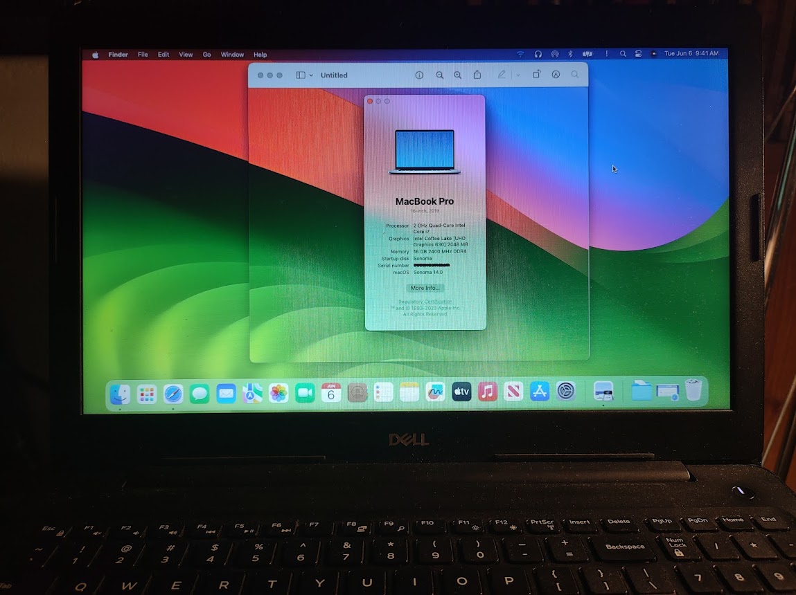

bobbee12 Posted June 8, 2023 Share Posted June 8, 2023 Works on a DELL LATITUDE 3590 i7 🙂 4 Link to comment https://www.insanelymac.com/forum/topic/356881-pre-release-macos-sonoma/page/9/#findComment-2805909 Share on other sites More sharing options...

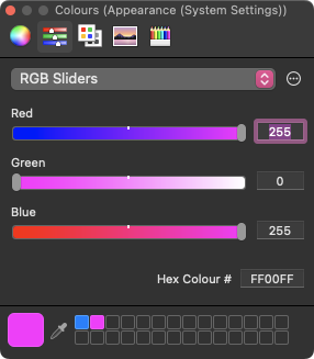

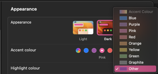

draylax Posted June 8, 2023 Share Posted June 8, 2023 Did Apple fix the Appearance Highlight colour in system settings to display the actual colour selected rather than some other shade? Highlight Colour Other: Change to RGB 255,0,255 Result on Ventura highlight looks nothing like the chosen colour Appearance Selected below see highlight also the radio button: 3 Link to comment https://www.insanelymac.com/forum/topic/356881-pre-release-macos-sonoma/page/9/#findComment-2805910 Share on other sites More sharing options...
