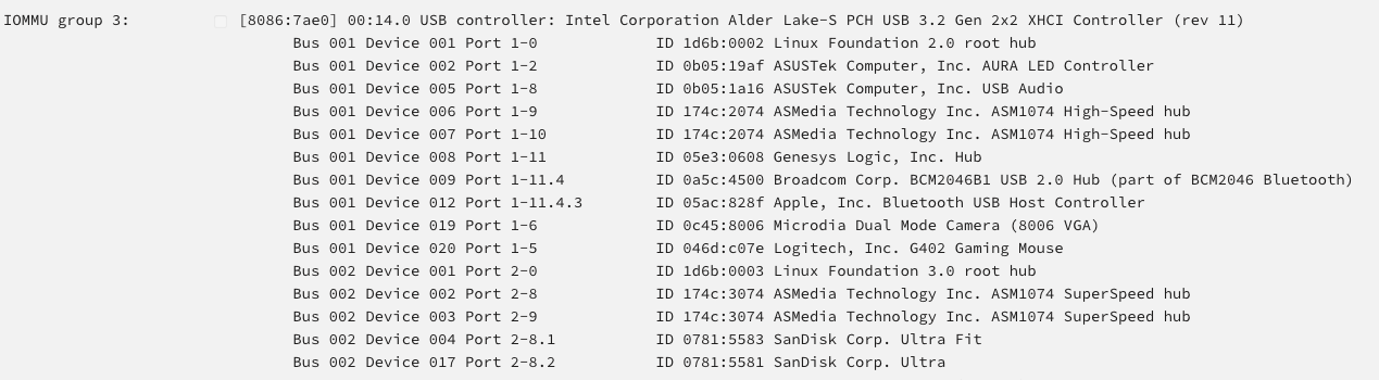

PoMpIs Posted August 15, 2022 Share Posted August 15, 2022 (edited) Hi @Pavo I have some doubts in hackinabox I have studied your hackinabox tutorial a bit: https://github.com/Pavo-IM/Hackinabox I have had unraid for years, and thanks to your tutorial I have managed to have monterey 12.5 functional and install beta 5 of ventura... passing the GPU to the VM, works great... but in ventura the USBs don't work for me......none Is it necessary to have a USB pci controller and pass it to the VM?? My motherboard has all USBs in the same group In moneterey I manually pass the mouse, keyboard and bluetooth and they work (USB2.0 no hot plug), but in Ventura they don't... I get to the welcome screen to configure and I can't... I can only do it through VNC because for that I don't need to assign USBs It is that monterey works very well, if ventura works like this virtualized, it would be wonderful. Yesterday I had a windows virtual machine running for games while installing ventura, it's nice and fun.. 😄 I have several GPUs, I assign one to MacOS and one to windows and I have both systems running at the same time. Thanks 🙇♂️ Edited August 15, 2022 by PoMpIs Link to comment https://www.insanelymac.com/forum/topic/351969-pre-release-macos-ventura/page/95/#findComment-2791473 Share on other sites More sharing options...
Pavo Posted August 15, 2022 Share Posted August 15, 2022 32 minutes ago, PoMpIs said: Hi @Pavo I have some doubts in hackinabox I have studied your hackinabox tutorial a bit: https://github.com/Pavo-IM/Hackinabox I have had unraid for years, and thanks to your tutorial I have managed to have monterey 12.5 functional and install beta 5 of ventura... passing the GPU to the VM, works great... but in ventura the USBs don't work for me......none Is it necessary to have a USB pci controller and pass it to the VM?? My motherboard has all USBs in the same group In moneterey I manually pass the mouse, keyboard and bluetooth and they work (USB2.0 no hot plug), but in Ventura they don't... I get to the welcome screen to configure and I can't... I can only do it through VNC because for that I don't need to assign USBs It is that monterey works very well, if ventura works like this virtualized, it would be wonderful. Yesterday I had a windows virtual machine running for games while installing ventura, it's nice and fun.. 😄 I have several GPUs, I assign one to MacOS and one to windows and I have both systems running at the same time. Thanks 🙇♂️ I have always passed through USB controllers. Never had any luck with passing through only ports myself. If all your USB Controllers are in one IOMMU group there isn’t much you can do unless you can update your AGESA (which only comes in BIOs updates) which might break them up into individual groups. 1 Link to comment https://www.insanelymac.com/forum/topic/351969-pre-release-macos-ventura/page/95/#findComment-2791477 Share on other sites More sharing options...
PoMpIs Posted August 15, 2022 Share Posted August 15, 2022 (edited) 19 minutes ago, Pavo said: I have always passed through USB controllers. Never had any luck with passing through only ports myself. If all your USB Controllers are in one IOMMU group there isn’t much you can do unless you can update your AGESA (which only comes in BIOs updates) which might break them up into individual groups. It already seemed to me that you had to pass a USB controller to the VM... 😄 Well, at least in monterey it works, I just passed these devices manually and everything is fine, even the apple trackpad works perfectly via bluetooth... The motherboard bios is updated to the latest version. I'm using the Asus B660F Gaming, it's not a very good board for virtualizing because the USBs are all in the same group... but if I put a PCIe USB controller on it I wouldn't have any problems, and the board's USBs in the VMs Windows and Linux work perfectly, so I still do it and port the entire unraid system that until now I had as a NAS with an older computer Thank you very much Edited August 15, 2022 by PoMpIs Link to comment https://www.insanelymac.com/forum/topic/351969-pre-release-macos-ventura/page/95/#findComment-2791479 Share on other sites More sharing options...

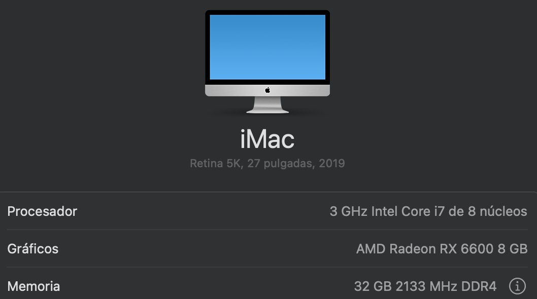

miliuco Posted August 15, 2022 Share Posted August 15, 2022 (edited) Good afternoon. Most users who set MacPro7,1 with Ventura have the info icon next to the RAM in General >> Information, regardless of whether they use Memory Events (memory slots are displayed as they are) or CustomMemory (memory slots look like on a Mac Pro but there are usually errors in the number of occupied and free slots). But I have seen the same info icon on Ventura 5 with iMac19,1 SMBIOS. No RestrictEvents or CustomMemory, of course. Maybe this has to do with the beta version and not the MacPro7,1 model? Maybe we thought that the icon indicates a malfunction of RestrictEvents or a memory misconfiguration warning and in fact it is not so. Does anyone else have that icon WITHOUT MacPro7,1? Spoiler Edited August 15, 2022 by miliuco 1 1 Link to comment https://www.insanelymac.com/forum/topic/351969-pre-release-macos-ventura/page/95/#findComment-2791481 Share on other sites More sharing options...

Slice Posted August 16, 2022 Share Posted August 16, 2022 12 hours ago, miliuco said: Good afternoon. Most users who set MacPro7,1 with Ventura have the info icon next to the RAM in General >> Information, regardless of whether they use Memory Events (memory slots are displayed as they are) or CustomMemory (memory slots look like on a Mac Pro but there are usually errors in the number of occupied and free slots). But I have seen the same info icon on Ventura 5 with iMac19,1 SMBIOS. No RestrictEvents or CustomMemory, of course. Maybe this has to do with the beta version and not the MacPro7,1 model? Maybe we thought that the icon indicates a malfunction of RestrictEvents or a memory misconfiguration warning and in fact it is not so. Does anyone else have that icon WITHOUT MacPro7,1? Reveal hidden contents AFAIK it is <key>PlatformFeature</key> <string>0x02</string> in SMBIOS section in Clover config. Don't know about OC. 5 Link to comment https://www.insanelymac.com/forum/topic/351969-pre-release-macos-ventura/page/95/#findComment-2791491 Share on other sites More sharing options...
D3v1L Posted August 16, 2022 Share Posted August 16, 2022 9 hours ago, eSaF said: I have the icon on my rig as well, it'd be interesting to know if it also appears on real Macs as well (if the query is not already answered). Reveal hidden contents absolutely yes. "i" appears and "mismatch" slot occupied appears too... it's Ventura bug, not hackintosh bug. 4 Link to comment https://www.insanelymac.com/forum/topic/351969-pre-release-macos-ventura/page/95/#findComment-2791495 Share on other sites More sharing options...
Avery B Posted August 16, 2022 Share Posted August 16, 2022 (edited) 15 hours ago, miliuco said: Good afternoon. Most users who set MacPro7,1 with Ventura have the info icon next to the RAM in General >> Information, regardless of whether they use Memory Events (memory slots are displayed as they are) or CustomMemory (memory slots look like on a Mac Pro but there are usually errors in the number of occupied and free slots). But I have seen the same info icon on Ventura 5 with iMac19,1 SMBIOS. No RestrictEvents or CustomMemory, of course. Maybe this has to do with the beta version and not the MacPro7,1 model? Maybe we thought that the icon indicates a malfunction of RestrictEvents or a memory misconfiguration warning and in fact it is not so. Does anyone else have that icon WITHOUT MacPro7,1? Hide contents If it is indeed based on the Firmware Features values (based on @Sliceccomment), then the equivalent in OC should be PlatformInfo->Generic->SystemMemoryStatus. The bit controlled by this setting signals whether the memory is soldered or not. I don't see the menu and I use MacBookPro15,1 on my X1 Extreme so the idea is plausible. Edited August 16, 2022 by 1Revenger1 4 Link to comment https://www.insanelymac.com/forum/topic/351969-pre-release-macos-ventura/page/95/#findComment-2791500 Share on other sites More sharing options...

miliuco Posted August 16, 2022 Share Posted August 16, 2022 (edited) @1Revenger1 It strikes me that, after reading your post, I have tried the options available for SystemMemoryStatus and I have seen that Upgradable (more suitable option in MacPro) keeps the info icon (as Auto does) but Soldered (less suitable option) removes it, probably because it also removes part of the information about the RAM. This with MP7,1 + RestrictEvents. iMac 19,1 (without RestrictEvents) behaves the same, Upgradable (Auto also) keeps the icon and Soldered remove it. EDIT: memory info in System Profiler is okey. Edited August 16, 2022 by miliuco 4 Link to comment https://www.insanelymac.com/forum/topic/351969-pre-release-macos-ventura/page/95/#findComment-2791509 Share on other sites More sharing options...
D3v1L Posted August 16, 2022 Share Posted August 16, 2022 btw ...the "i", is ok to appear...'couse with this, you "see" what kind of memory you have, in what slot etc... btw, if you set "soldered", you don't need to see anything...'couse for MacOS, your RAM is not upgradable so...why see how many free slot do you have? is not your problem! xD LoL this is only for MacPro (of course) 'couse is the only that give you possibility to upgrade ram yourself... 1 Link to comment https://www.insanelymac.com/forum/topic/351969-pre-release-macos-ventura/page/95/#findComment-2791511 Share on other sites More sharing options...
miliuco Posted August 16, 2022 Share Posted August 16, 2022 (edited) @D3v1L You're right but don't forget that memory info in System Profiler is always available. Upgradable and Soldered are attempts to learn more about this matter. Really Auto is the best choice for SystemMemoryStatus despite of the info icon. Of course with Soldered I have expandable memory = no in memory tab of System Profiler. Edited August 16, 2022 by miliuco 3 Link to comment https://www.insanelymac.com/forum/topic/351969-pre-release-macos-ventura/page/95/#findComment-2791512 Share on other sites More sharing options...
D3v1L Posted August 16, 2022 Share Posted August 16, 2022 Just now, miliuco said: @D3v1L You're right but don't forget that memory info in System Profiler is always available. yes of course! 🙂 2 Link to comment https://www.insanelymac.com/forum/topic/351969-pre-release-macos-ventura/page/95/#findComment-2791513 Share on other sites More sharing options...

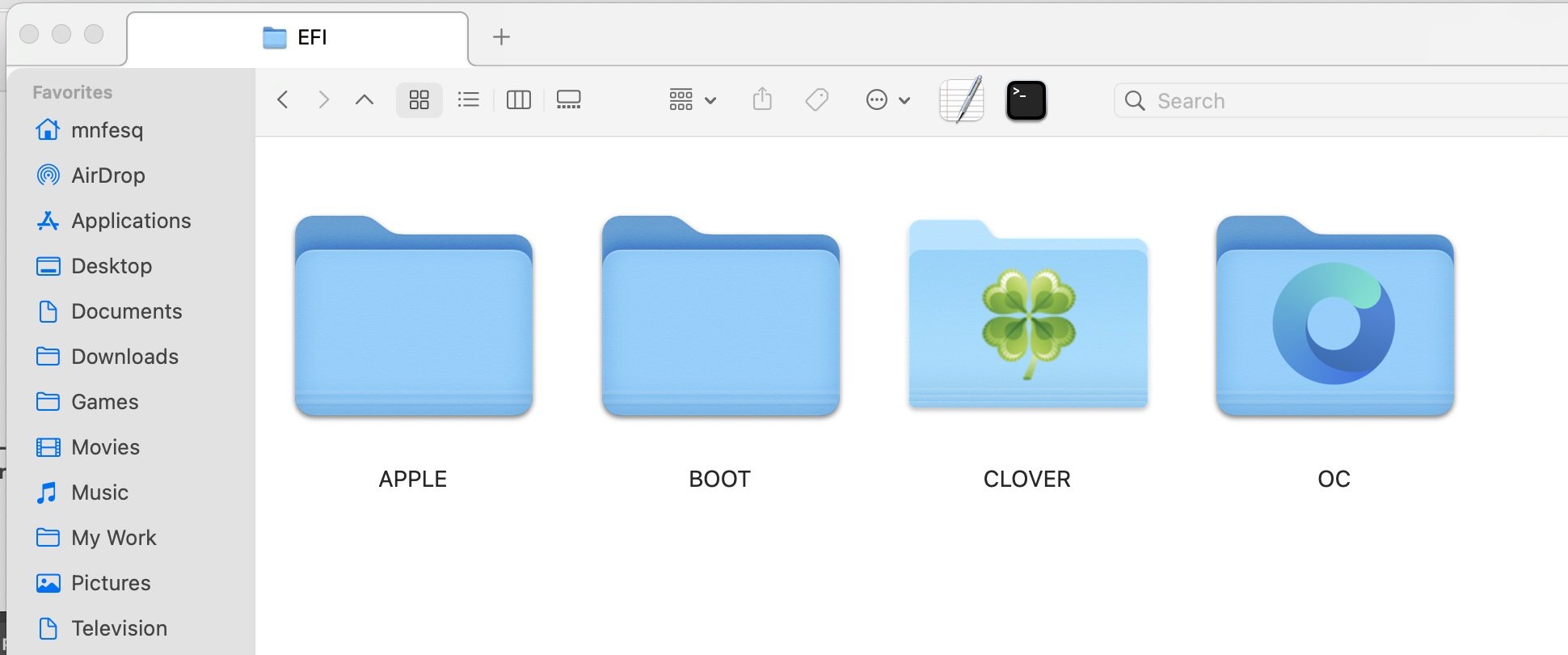

mnfesq Posted August 16, 2022 Share Posted August 16, 2022 5 hours ago, D3v1L said: uhm wanna try to convert my oc in Clover... for now 4 on 4 KP LoL ahahha btw the long hard road out of hell ahahah xD Why have just OC or Clover when you can have both and use BootLoaderChooser that comes with Clover? Spoiler 3 Link to comment https://www.insanelymac.com/forum/topic/351969-pre-release-macos-ventura/page/95/#findComment-2791514 Share on other sites More sharing options...
