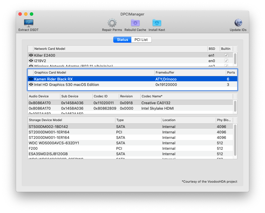

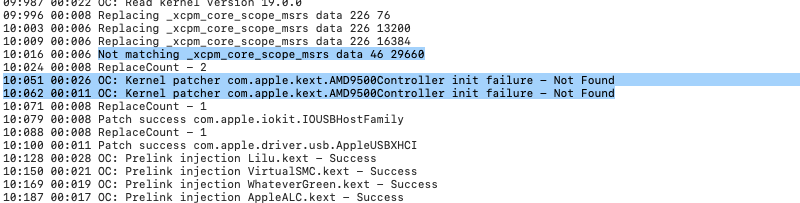

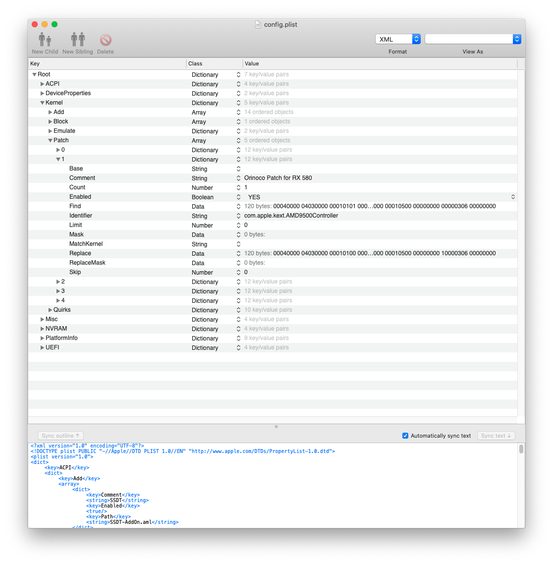

Andres ZeroCross Posted July 12, 2019 Share Posted July 12, 2019 (edited) 1 hour ago, PMheart said: That can be taken into account WITH LOWEST PRIORITY. May i ask something? There is log about init failur kernel patcher to com.apple.kextAMD9500Controller.kext. I have set binary patch for AMD9500Controller.kext. I have used Orinoco FB Name. Why is it fail?? But, binary is succesfull patched. I can use dual monitor with Orinoco and no Reddish Screen image (if i don't patch binary, the monitor screen be reddish and can't use dual monitor). So is this about another thing?? Edited July 12, 2019 by Andres ZeroCross Link to comment https://www.insanelymac.com/forum/topic/350754-opencore-general-discussion/page/36/#findComment-2681122 Share on other sites More sharing options...
PMheart Posted July 12, 2019 Share Posted July 12, 2019 2 hours ago, Andres ZeroCross said: May i ask something? There is log about init failur kernel patcher to com.apple.kextAMD9500Controller.kext. I have set binary patch for AMD9500Controller.kext. I have used Orinoco FB Name. Why is it fail?? But, binary is succesfull patched. I can use dual monitor with Orinoco and no Reddish Screen image (if i don't patch binary, the monitor screen be reddish and can't use dual monitor). So is this about another thing?? Maybe you applied it as a "kernel patch"? I don't know much either to be honest, it's not me who wrote this code. The reason why you managed to patch it anyway is that a "kernel patch" applies to the whole kernel cache, which contains your AMD9500Controller. CORRECT ME IF WRONG! Link to comment https://www.insanelymac.com/forum/topic/350754-opencore-general-discussion/page/36/#findComment-2681127 Share on other sites More sharing options...
Andres ZeroCross Posted July 12, 2019 Share Posted July 12, 2019 (edited) 4 minutes ago, PMheart said: Maybe you applied it as a "kernel patch"? I don't know much either to be honest, it's not me who wrote this code. The reason why you managed to patch it anyway is that a "kernel patch" applies to the whole kernel cache, which contains your AMD9500Controller. CORRECT ME IF WRONG! Yes but why the log said "init failure"?? In fact, binary patch is succesful I am using Orinoco FB name, Edited July 12, 2019 by Andres ZeroCross Link to comment https://www.insanelymac.com/forum/topic/350754-opencore-general-discussion/page/36/#findComment-2681128 Share on other sites More sharing options...
PMheart Posted July 12, 2019 Share Posted July 12, 2019 14 minutes ago, Andres ZeroCross said: Yes but why the log said "init failure"?? In fact, binary patch is succesful I am using Orinoco FB name, Hmm, that looks weird as you seem to be applying the patch correctly... Better to ask developers instead. Link to comment https://www.insanelymac.com/forum/topic/350754-opencore-general-discussion/page/36/#findComment-2681129 Share on other sites More sharing options...
Andres ZeroCross Posted July 12, 2019 Share Posted July 12, 2019 15 minutes ago, PMheart said: Hmm, that looks weird as you seem to be applying the patch correctly... Better to ask developers instead. The issue is only in the log. Patch is succesfull anyway,, i can use 2 monitor and no reddish screen with Orinoco. Just curious about the log Link to comment https://www.insanelymac.com/forum/topic/350754-opencore-general-discussion/page/36/#findComment-2681131 Share on other sites More sharing options...
vit9696 Posted July 12, 2019 Share Posted July 12, 2019 4 hours ago, Andres ZeroCross said: May i ask something? There is log about init failur kernel patcher to com.apple.kextAMD9500Controller.kext. I have set binary patch for AMD9500Controller.kext. I have used Orinoco FB Name. Why is it fail?? But, binary is succesfull patched. I can use dual monitor with Orinoco and no Reddish Screen image (if i don't patch binary, the monitor screen be reddish and can't use dual monitor). So is this about another thing?? I added successful patch init to the log in d0504e6. Please redo the log, send it here, and also attach your config. I am quite unwilling to investigate it thoroughly if it works, but let me look at least. 1 Link to comment https://www.insanelymac.com/forum/topic/350754-opencore-general-discussion/page/36/#findComment-2681132 Share on other sites More sharing options...

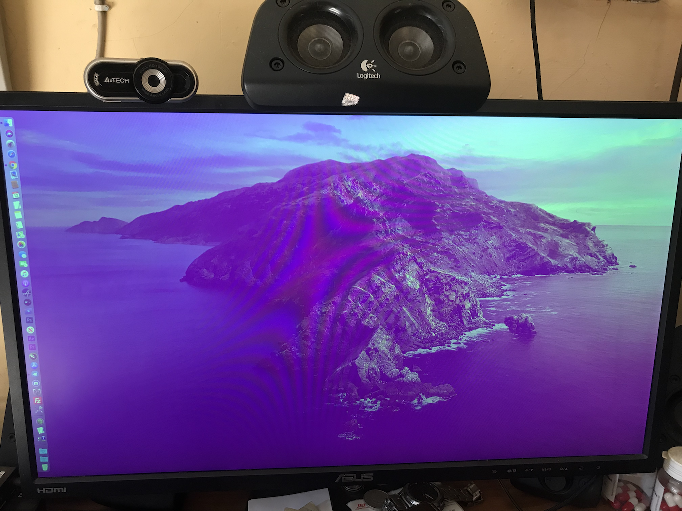

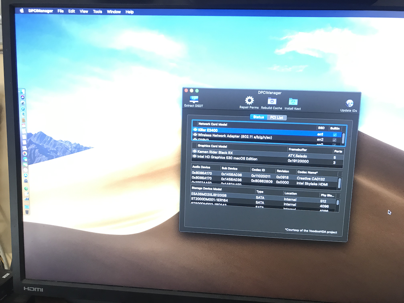

Andres ZeroCross Posted July 12, 2019 Share Posted July 12, 2019 1 hour ago, vit9696 said: I added successful patch init to the log in d0504e6. Please redo the log, send it here, and also attach your config. I am quite unwilling to investigate it thoroughly if it works, but let me look at least. It's look i have give some wrong information before,, so i re-write the conditions of issue. Conditions : 1. I have 2 patch for Orinoco and Salado Framebuffer in config.plist Issue : 1. With or Without enable patch while using Orinoco Framebuffer, i still can get normal screen and dual screen capability in Mojave and Catalina DP 3 (actually because Orinoco have 2 HDMI Connector as default so i will not get reddish image) 2. Without enable Patch (Enable = No) while using Salado Framebuffer, i will get Reddish image and unable dual screen in Mojave and Catalina 3. With Enable Patch (Enable = Yes) while using Salado Framebuffer, i will get normal screen and dual screen capability in Mojave, but not in Catalina. Init Failure in Catalina. Note : I don't set match kernel anyway, and the binary of Find still can be founded in AMD9500Controller.kext of Catalina. If Salado or Orinoco didn't use this binary again in Catalina then i thought Patching still successfull because binary still there (but not in log) I attach config.plist, Picture of reddish image (Salado Framebuffer in Catalina), Picture of normal Screen (Salado Framebuffer in Mojave) and log when boot to catalina. Anyways sorry for bad english, Thanks very much opencore.log config.plist Link to comment https://www.insanelymac.com/forum/topic/350754-opencore-general-discussion/page/36/#findComment-2681144 Share on other sites More sharing options...
vandroiy2012 Posted July 12, 2019 Share Posted July 12, 2019 @Andres ZeroCross Why are you using named framebuffer? It's nonsense. Radeon cards in hackintosh must use default "automated" RadeonFramebuffer. With help of WhateverGreen. I also have RX 580 cards in several my PC's and i don't have any problems with reddish image or two monitor configurations. Read WhateverGreen FAQ. There are a lot of info why you shouldn't use named framebuffer at all!!! You create problems by yourself mostly 1 Link to comment https://www.insanelymac.com/forum/topic/350754-opencore-general-discussion/page/36/#findComment-2681148 Share on other sites More sharing options...
Andres ZeroCross Posted July 12, 2019 Share Posted July 12, 2019 (edited) 5 minutes ago, vandroiy2012 said: @Andres ZeroCross Why are you using named framebuffer? It's nonsense. Radeon cards in hackintosh must use default "automated" RadeonFramebuffer. With help of WhateverGreen. I also have RX 580 cards in several my PC's and i don't have any problems with reddish image or two monitor configurations. Read WhateverGreen FAQ. There are a lot of info why you shouldn't use named framebuffer at all!!! You create problems by yourself mostly Yes, you're right. SOmetimes i like to try the "old way" method The problem is about binary / kernel patch in Catalina Because AFAIK, this method still useful for Radeon R7 250/250X to set custom port with certain FB Name. Edited July 12, 2019 by Andres ZeroCross Link to comment https://www.insanelymac.com/forum/topic/350754-opencore-general-discussion/page/36/#findComment-2681149 Share on other sites More sharing options...

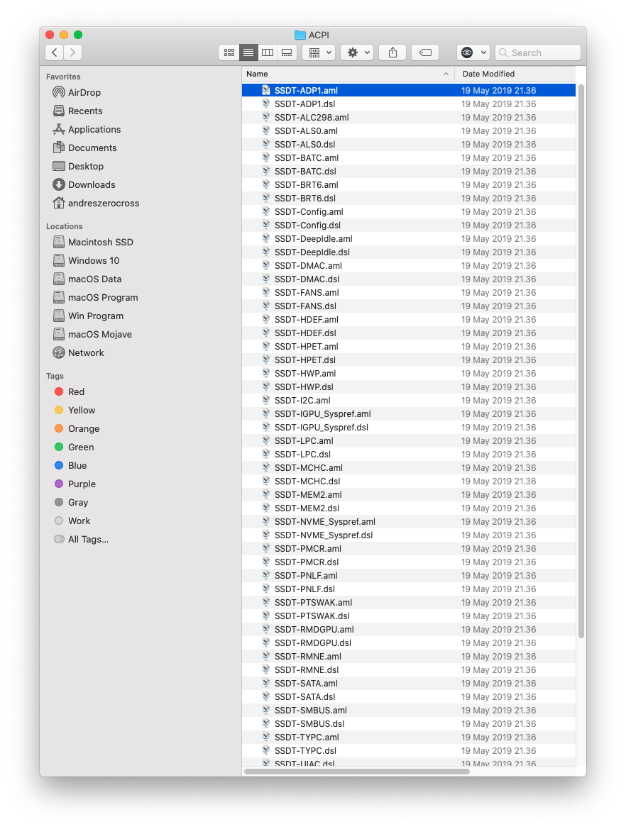

Andres ZeroCross Posted July 12, 2019 Share Posted July 12, 2019 3 minutes ago, nytr0 said: 7 days of working trying to get XHC working so i can use my mouse,usb ports, or bluetooth in 0.0.4 to no avail. It was working fine in the previous version, now it won't even load the ports in ioreg on my laptop. If the layout of Opencore hasn't changed , this should work, but it hasn't. All XHC is working here with lates commit 0.0.4 What's your problem with current 0.0.4 Opencore? Link to comment https://www.insanelymac.com/forum/topic/350754-opencore-general-discussion/page/36/#findComment-2681162 Share on other sites More sharing options...
mhaeuser Posted July 12, 2019 Share Posted July 12, 2019 @nytr0 Probably you missed the removal of the "Custom" ACPI folder and your tables do not load. 1 Link to comment https://www.insanelymac.com/forum/topic/350754-opencore-general-discussion/page/36/#findComment-2681163 Share on other sites More sharing options...
onemanOSX Posted July 12, 2019 Share Posted July 12, 2019 19 minutes ago, nytr0 said: 7 days of working trying to get XHC working so i can use my mouse,usb ports, or bluetooth in 0.0.4 to no avail. It was working fine in the previous version, now it won't even load the ports in ioreg, yet loads them in hackintools on my laptop. If the layout of Opencore hasn't changed , this should work, why hasn't it? what changed? how can this be fixed? Reading your posts recently intrigued me to download v0.0.4. Happy to report I experienced no issues with XHC for both of my laptop and desktop (nor issues with BRCM bluetooth). Link to comment https://www.insanelymac.com/forum/topic/350754-opencore-general-discussion/page/36/#findComment-2681164 Share on other sites More sharing options...
Andres ZeroCross Posted July 12, 2019 Share Posted July 12, 2019 (edited) 10 minutes ago, nytr0 said: I removed Custom ACPI at the beginning of 0.0.3. XHC just will not work. All my kexts are updated. Here is my config (minus kexts for size). theConfig.zip What???? you should joint all this SSDT into single SSDT. It will need time to read each SSDT and check compatible from one to another one SSDT. Another thing is, i don't see any EC device in your configurations. Are you sure your embedded control device is ECDV?? not EC0?? Because i just see you have renamed EC0 to EC. I am pretty sure with your current configuration you will get more trouble in windows or other OS when boot with OpenCore Bootloader Edited July 12, 2019 by Andres ZeroCross 1 Link to comment https://www.insanelymac.com/forum/topic/350754-opencore-general-discussion/page/36/#findComment-2681166 Share on other sites More sharing options...
