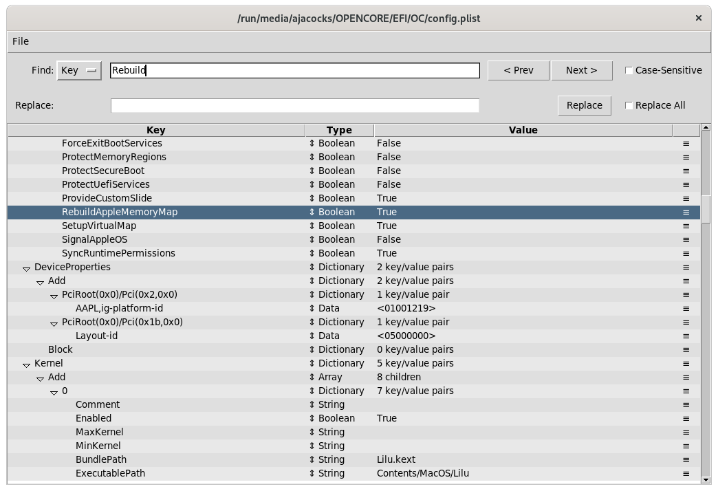

ajacocks Posted May 25, 2020 Share Posted May 25, 2020 6 hours ago, SavageAUS said: Try setting RebuildAppleMemoryMap to False SetupVirtualMap to True This is what worked for me. Sent from my iPhone using Tapatalk Unfortunately, both of those are already set. Do you have any other suggestions? Thanks! - Alex Link to comment https://www.insanelymac.com/forum/topic/350754-opencore-general-discussion/page/200/#findComment-2723738 Share on other sites More sharing options...
apianti Posted May 25, 2020 Share Posted May 25, 2020 1 hour ago, ajacocks said: Unfortunately, both of those are already set. Do you have any other suggestions? Thanks! - Alex Think he meant to disable RebuildAppleMemoryMap. Link to comment https://www.insanelymac.com/forum/topic/350754-opencore-general-discussion/page/200/#findComment-2723744 Share on other sites More sharing options...

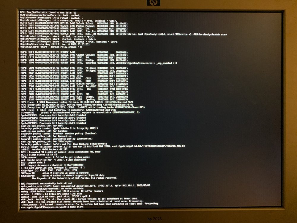

ajacocks Posted May 26, 2020 Share Posted May 26, 2020 (edited) 8 hours ago, apianti said: Think he meant to disable RebuildAppleMemoryMap. Ah, thanks for the catch! With that change, I get quite a bit further, to the point shown in the included image. I believe that mpo_policy_init is from Lilu. I'm re-attaching my config.plist, as well. If I move the thumb drive to a USB2.0 port, remove the R5-340X Dell GPU, and add the config for the iGPU (Skylake 530), I get to apfs_module_start. I don't have an AWAC clock, as this is Skylake, so that's not the issue. I'm assuming that these are iGPU problems. I've tried the onboard HDMI and DisplayPort ports (DisplayPort with an HDMI adapter), and the HDMI gets me the furthest: Thanks! - Alex config.plist Edited May 26, 2020 by ajacocks More progress Link to comment https://www.insanelymac.com/forum/topic/350754-opencore-general-discussion/page/200/#findComment-2723779 Share on other sites More sharing options...
apianti Posted May 26, 2020 Share Posted May 26, 2020 1 hour ago, ajacocks said: Ah, thanks for the catch! With that change, I get quite a bit further, to the point shown in the included image. I believe that mpo_policy_init is from Lilu. I'm re-attaching my config.plist, as well. If I move the thumb drive to a USB2.0 port, remove the R5-340X Dell GPU, and add the config for the iGPU (Skylake 530), I get to apfs_module_start. I don't have an AWAC clock, as this is Skylake, so that's not the issue. I'm assuming that these are iGPU problems. I've tried the onboard HDMI and DisplayPort ports (DisplayPort with an HDMI adapter), and the HDMI gets me the furthest: Thanks! - Alex Probably EC patch but maybe one of these others (yeah - not AWAC on skylake unless you somehow frankensteined something like a very mad man), check here, https://github.com/dortania/OpenCore-Desktop-Guide/blob/master/troubleshooting/troubleshooting.md#stuck-on-rtc-pci-configuration-begins-previous-shutdown-hpet-hid-legacy. Link to comment https://www.insanelymac.com/forum/topic/350754-opencore-general-discussion/page/200/#findComment-2723781 Share on other sites More sharing options...

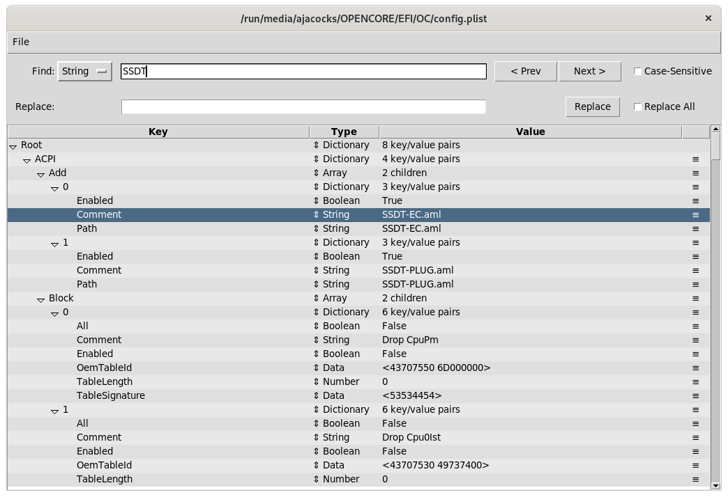

ajacocks Posted May 26, 2020 Share Posted May 26, 2020 (edited) 14 minutes ago, apianti said: Probably EC patch but maybe one of these others (yeah - not AWAC on skylake unless you somehow frankensteined something like a very mad man), check here, https://github.com/dortania/OpenCore-Desktop-Guide/blob/master/troubleshooting/troubleshooting.md#stuck-on-rtc-pci-configuration-begins-previous-shutdown-hpet-hid-legacy. Unfortunately, I already have the EC patch enabled (as added by TopLevel): I'm going through the other fixes. Already tried the "Above 4G" boot arg, which made things worse. Trying the HPET stuff next. Thanks! - Alex Edited May 26, 2020 by ajacocks Link to comment https://www.insanelymac.com/forum/topic/350754-opencore-general-discussion/page/200/#findComment-2723783 Share on other sites More sharing options...
apianti Posted May 26, 2020 Share Posted May 26, 2020 (edited) 6 minutes ago, ajacocks said: Unfortunately, I already have the EC patch enabled (as added by TopLevel): Not sure that is the correct patch. https://dortania.github.io/Getting-Started-With-ACPI/ssdt-platform.html#laptop EDIT: Probably more helpful, https://dortania.github.io/Getting-Started-With-ACPI/Universal/ec-fix.html Edited May 26, 2020 by apianti Link to comment https://www.insanelymac.com/forum/topic/350754-opencore-general-discussion/page/200/#findComment-2723784 Share on other sites More sharing options...

ajacocks Posted May 26, 2020 Share Posted May 26, 2020 9 minutes ago, markl18 said: Alex you actually have to edit a DSDT.dsl file after it is dissembled and abridged from its size of 483 kb to about 34kbthe rest is going to become sssdt1 ssd 2 ssdt3 and so on I think I must be failing to understand something obvious, here. I followed the guide, and it just told me (I think) to add the SSDT-PLUG.aml and the SSDT-EC-USBX.aml, to the ACPI directory. I then did a clean snapshot, in TopLevel, to make sure that my config.plist was correct. I did attempt to do my own editing, and create my own SSDT-EC-USBX.aml (rather than to use the generic Skylake one) but I got a duplicate entry on the ED device. Here's the results of my edit (attached .dsl file). I also attached the error I get (AE_ALREADY_EXISTS): I assume that's because the existing ACPI Tables already have an entry for the H_EC? Thanks! - Alex SSDT-EC-USBX.dsl Link to comment https://www.insanelymac.com/forum/topic/350754-opencore-general-discussion/page/200/#findComment-2723787 Share on other sites More sharing options...
apianti Posted May 26, 2020 Share Posted May 26, 2020 (edited) 34 minutes ago, ajacocks said: I think I must be failing to understand something obvious, here. I followed the guide, and it just told me (I think) to add the SSDT-PLUG.aml and the SSDT-EC-USBX.aml, to the ACPI directory. I then did a clean snapshot, in TopLevel, to make sure that my config.plist was correct. I did attempt to do my own editing, and create my own SSDT-EC-USBX.aml (rather than to use the generic Skylake one) but I got a duplicate entry on the ED device. Here's the results of my edit (attached .dsl file). I also attached the error I get (AE_ALREADY_EXISTS): I assume that's because the existing ACPI Tables already have an entry for the H_EC? Thanks! - Alex Did you read those guides? You don't always need that for a laptop, it may already exist correctly. You just have to apply only some of the patch in that case, you have to determine this from your original table dump though. Edited May 26, 2020 by apianti Link to comment https://www.insanelymac.com/forum/topic/350754-opencore-general-discussion/page/200/#findComment-2723792 Share on other sites More sharing options...

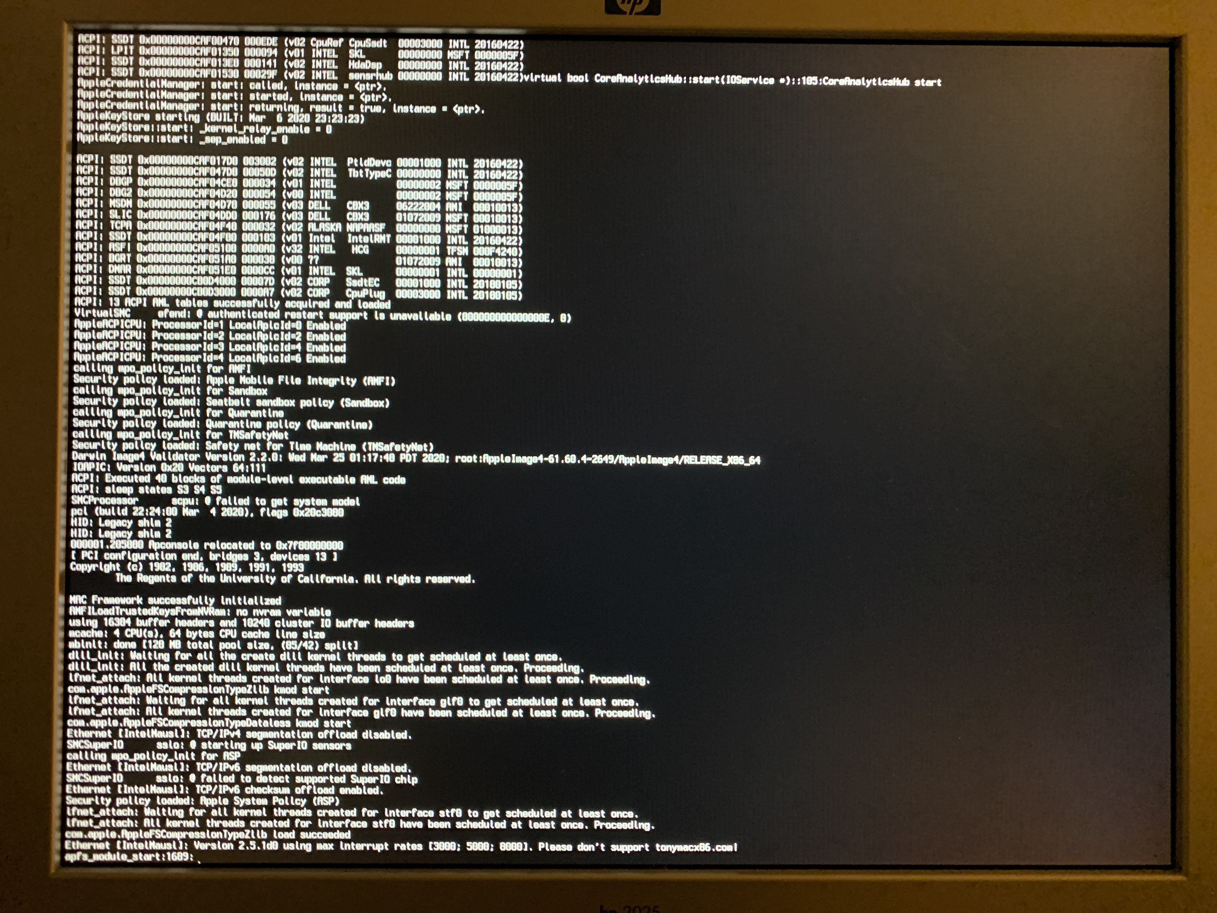

ajacocks Posted May 26, 2020 Share Posted May 26, 2020 4 hours ago, markl18 said: I get about 12 of those for all kinds of reasons anyway in order to the gpu device to work correctly you have to have those changes to coincide with ssdt-gpu.aml file that has to be present in order for things to happen Thanks, I did indeed follow the procedures to the best of my knowledge. 1) This is a desktop, a Dell Optiplex 7050 2) There is no “EC” device, in the DSDT.dsl, it’s called “H_EC” 3) I did the editing to rename it, but I’m not sure that I did it correctly, as I get that duplication error that I mentioned Would someone be willing to check over my edits, if I post my DSDT.dsl and my SSDT-EC-USBX.dsl, that I already linked? Here’s the definition of “H_EC” from the DSDT.dsl: Scope (_SB.PCI0.LPCB) { Device (H_EC) { Name (_HID, EisaId ("PNP0C09") /* Embedded Controller Device */) // _HID: Hardware ID Name (_UID, One) // _UID: Unique ID Method (_STA, 0, NotSerialized) // _STA: Status { ^^^GFX0.CLID = 0x03 Return (Zero) } I uncommented and modified this section, in SSDT-EC-USBX.dsl: External (_SB_.PCI0.LPCB.H_EC, DeviceObj) Scope (\_SB.PCI0.LPCB.H_EC) { Method (_STA, 0, NotSerialized) // _STA: Status { If (_OSI ("Darwin")) { Return (0) } Else { Return (0x0F) } } } Does that look right? Thanks! - Alex DSDT.dsl Link to comment https://www.insanelymac.com/forum/topic/350754-opencore-general-discussion/page/200/#findComment-2723822 Share on other sites More sharing options...
