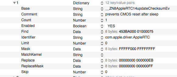

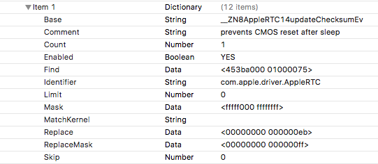

3 block AppleRTC writes to bytes 0x58, 0x59 (CMOS checksum) by patch
or kext
https://github.com/acidanthera/RTCMemoryFixup

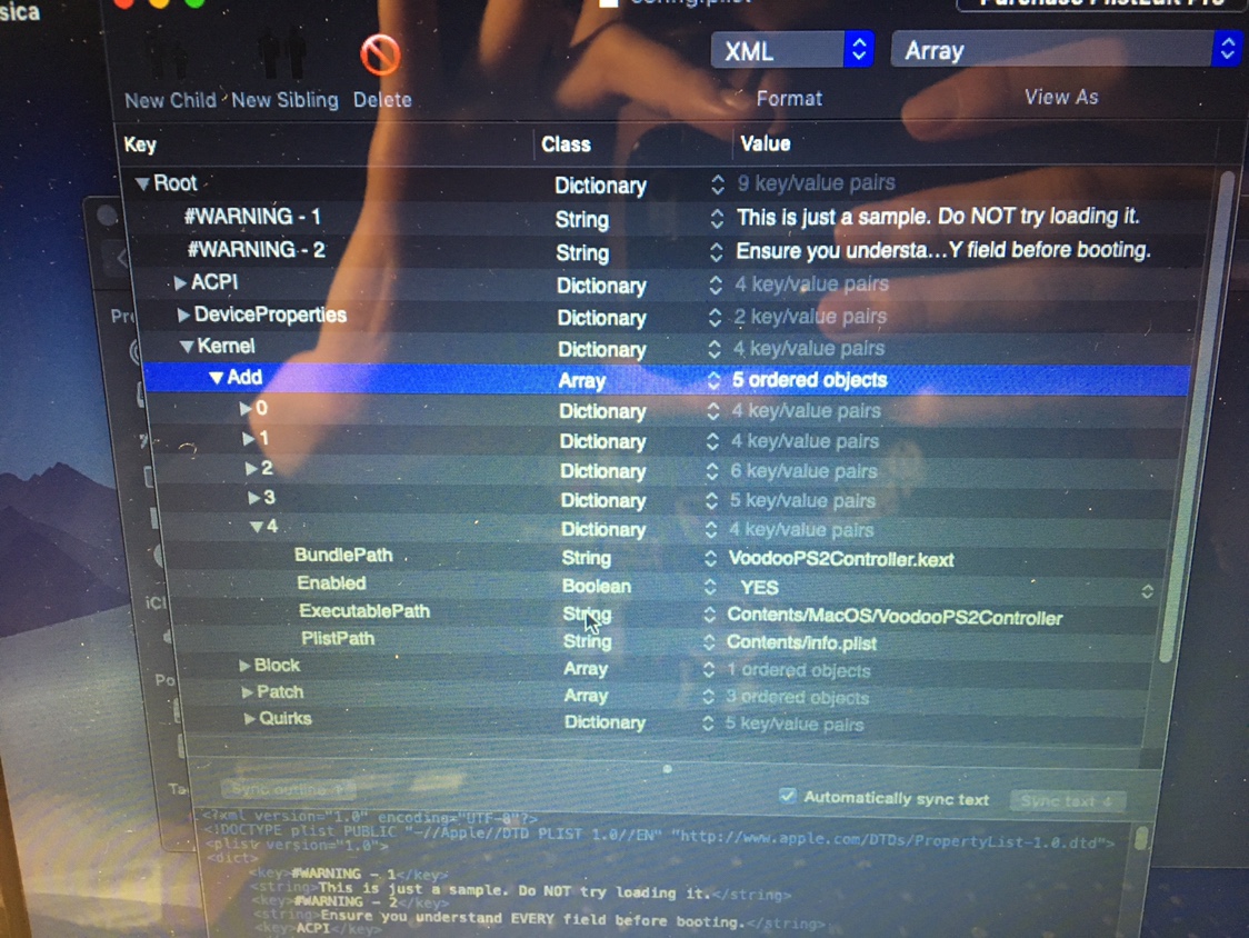

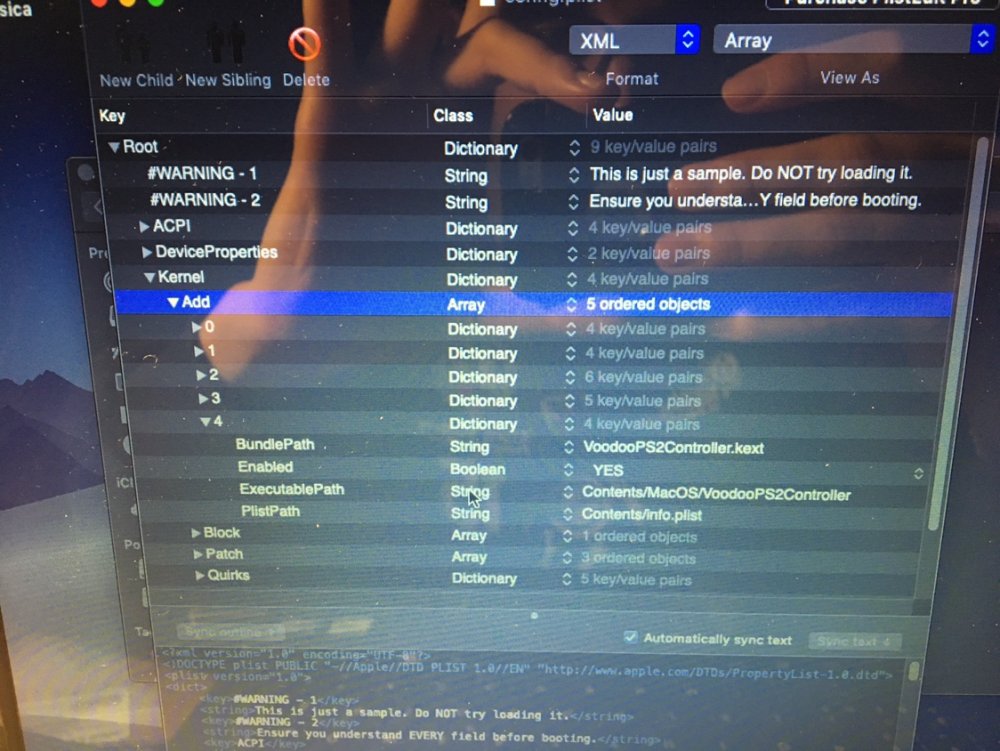

Hi, I placed voodoops2controller at level 4 but it doesn't work, will it be wrong positioning?IMG_0033.jpg
Inviato dal mio iPhone utilizzando Tapatalk

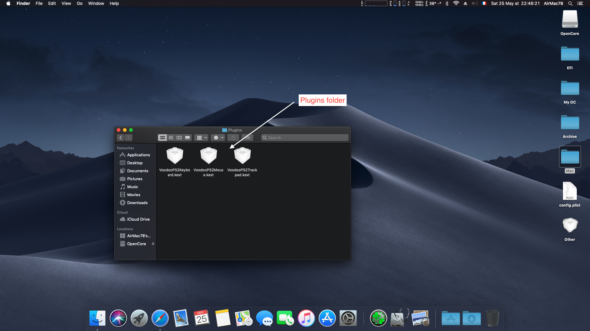

But maybe you don't have to forget the kexts inside it's plugins folder, you may have to add them one by one!

Then? Bundlepath VodooPS2Mouse.kext and executablepath Contents/MacOS/VodooPS2Mouse - PLIST PATH contents/info.plist ? and delete voodoops2controller in this config and put these 2 in plugin folder ?

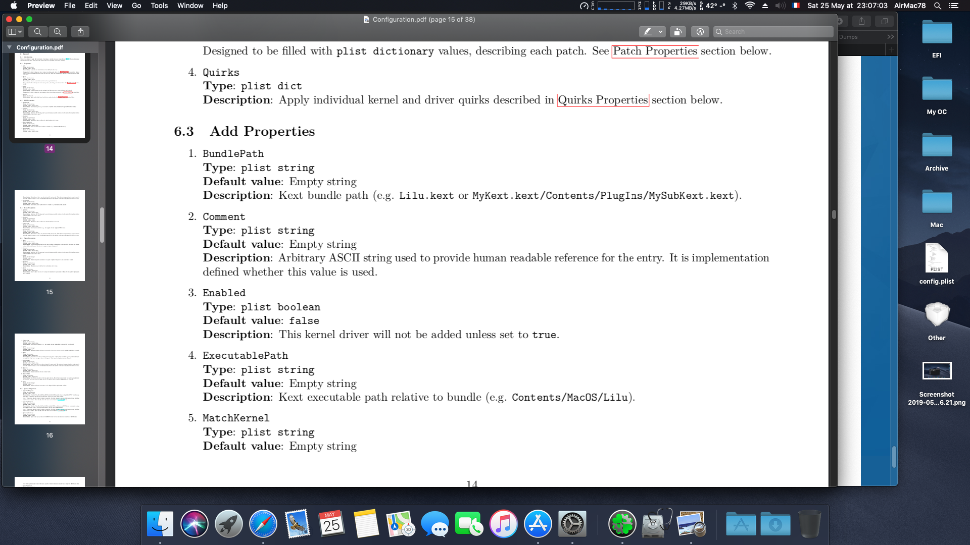

As described in the configuration note, you need to inject the master kext and it's plugins, so in our case laptops, need both VoodooPS2Controller, then VoodooPS2Keyboard, then VoodooPS2Mouse and Voodoops2Trackpad each one of them separately with it's path and enabled and it's own executable, for the plugins path it will be the: VoodooPS2Controller.kext/Contents/Plugins/VoodooPS2Keyboard, and so on for the two other like in the screenshot configuration note

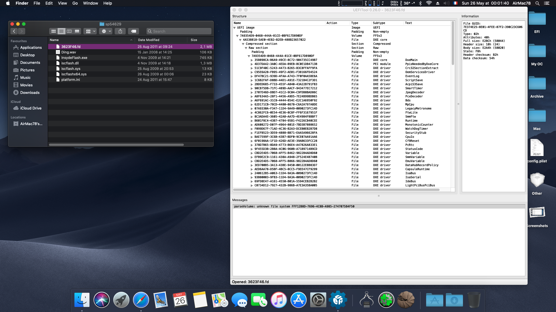

@Andrey1970 , is there any patch to add in the config for the APIC and Kernel LAPIC like clover config patch. My laptop now is able to boot but i know that without these two patch, it will always  have these two kernel-panics: LAPIC & APIC.
It's an old laptop, but because it's the only one that i have actually, and it runs High Sierra better than windows 7 or 10, quiet and smooth using Clover. It have an UEFI bios from insydeH2O, but i don't know why windows 10 is unable to be installed on UEFI mod, anyway, if there's these two fixes, i'll really appreciate it.
Its UEFI image screenshot:
Quote
401763825_Screenshot2019-05-26at00_01_40.thumb.png.49dd4e09ef3991fef935a2bf0b7c2681.png
[mention=1202492]Andrey1970[/mention] , is there any patch to add in the config for the APIC and Kernel LAPIC like clover config patch. My laptop now is able to boot but i know that without these two patch, it will always  have these two kernel-panics: LAPIC & APIC. It's an old laptop, but because it's the only one that i have actually, and it runs High Sierra better than windows 7 or 10, quiet and smooth using Clover. It have an UEFI bios from insydeH2O, but i don't know why windows 10 is unable to be installed on UEFI mod, anyway, if there's these two fixes, i'll really appreciate it.
UNLOCKED BIOS ?
Finally done, booted fine to High Sierra desktop with it, however, the ATI Mobility Radeon HD 4650 graphics doesn't show up in About This Mac, but it's injected, i only need to find the trick.
