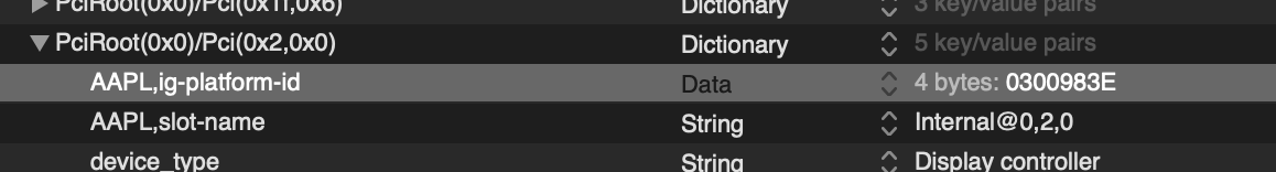

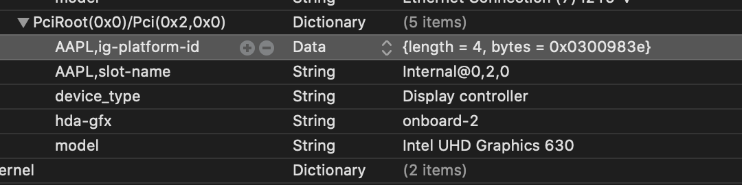

Slice Posted February 19, 2020 Share Posted February 19, 2020 12 hours ago, Tiem said: They are talking about the way Xcode handles some fields (like the data field). Xcode: Plist Editor Pro: Pretty trivial to change the value on PED. Not so much in Xcode. So yeah, for the majority of people, PED is a much better way to handle Hack plists. Not like they are anything special (binary plists). Just a basic text file. Notepad works just as well and you can use Hackintool to convert between Hex, Binary, etc. Data 0300983E is not the same as 0x0300983E because of endianness. It is 0x3E980003. Sure you use right value. 1 1 Link to comment https://www.insanelymac.com/forum/topic/350754-opencore-general-discussion/page/128/#findComment-2708958 Share on other sites More sharing options...
Tiem Posted February 19, 2020 Share Posted February 19, 2020 (edited) 1 hour ago, Slice said: Data 0300983E is not the same as 0x0300983E because of endianness. It is 0x3E980003. Sure you use right value. Same plist friend Edited February 19, 2020 by Tiem Link to comment https://www.insanelymac.com/forum/topic/350754-opencore-general-discussion/page/128/#findComment-2708974 Share on other sites More sharing options...
hardcorehenry Posted February 19, 2020 Share Posted February 19, 2020 (edited) 35 minutes ago, Tiem said: Same plist friend AAPL,ig-platform-id Data <3E980003> EDIT: Sorry, should be: AAPL,ig-platform-id Data <0300983E> Edited February 19, 2020 by hardcorehenry 1 Link to comment https://www.insanelymac.com/forum/topic/350754-opencore-general-discussion/page/128/#findComment-2708975 Share on other sites More sharing options...

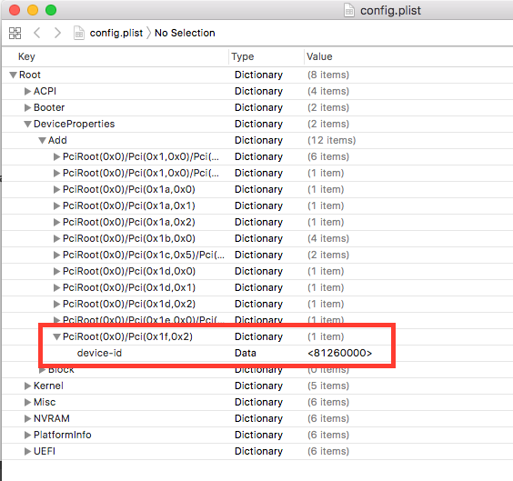

Icaro82 Posted February 20, 2020 Share Posted February 20, 2020 (edited) On 5/25/2019 at 2:53 PM, Rodion2010 said: for ICH7/8/9/10 and some other we need to patch AppleAHCIPort 40600200 to 00000000 or change SATA device-id to ICH6 8126 Helpful is reading about "the things you need", not using my EFI folder, because DSDT, SSDT, network , graphics and audio codec are completely different - if you do not use exactly the same configuration Hello,My HDDs don’t work in Catalina, only SSDs. I have a Westmere system (Xeon x5675) and Intel IHC10. That hardware gives problems with AppleAHCIPort.kext in new OSX versions. I’ve tried the patch (40600200 -> 00000000) on Clover and Opencore and no luck. My Hdds disks don’t initialize. My other option was to install the AppleAHCIPort.kext v.328 in the Library/Extensions folder but the result was a Catalina dead with boot error (Clover and Opencore).How can I change the SATA device-id? I will lost performance because of the change? Other solutions are welcome! Thanks all!!! Edited February 20, 2020 by Icaro82 Link to comment https://www.insanelymac.com/forum/topic/350754-opencore-general-discussion/page/128/#findComment-2709217 Share on other sites More sharing options...
Rodion2010 Posted February 20, 2020 Share Posted February 20, 2020 3 hours ago, Icaro82 said: How can I change the SATA device-id? I will lost performance because of the change? Other solutions are welcome! Thanks all!!! I use this for a very long time and it works OK with any Mac OS from Leopard to Catalina Link to comment https://www.insanelymac.com/forum/topic/350754-opencore-general-discussion/page/128/#findComment-2709237 Share on other sites More sharing options...

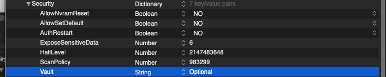

vandroiy2012 Posted February 21, 2020 Share Posted February 21, 2020 5 minutes ago, nmano said: 0.5.6 oc configuration requires vault but no vault provided Can you check my config Thanks. config.plist Read manual: VaultType: plist stringFailsafe: SecureDescription: Enables vaulting mechanism in OpenCore. Valid values: Optional — require nothing, no vault is enforced, insecure. Basic — require vault.plist file present in OC directory. This provides basic filesystem integrity verification and may protect from unintentional filesystem corruption. Secure — require vault.sig signature file for vault.plist in OC directory. This includes Basic integrity checking but also attempts to build a trusted bootchain. 2 Link to comment https://www.insanelymac.com/forum/topic/350754-opencore-general-discussion/page/128/#findComment-2709270 Share on other sites More sharing options...
nmano Posted February 21, 2020 Share Posted February 21, 2020 25 minutes ago, vandroiy2012 said: Read manual: VaultType: plist stringFailsafe: SecureDescription: Enables vaulting mechanism in OpenCore. Valid values: Optional — require nothing, no vault is enforced, insecure. Basic — require vault.plist file present in OC directory. This provides basic filesystem integrity verification and may protect from unintentional filesystem corruption. Secure — require vault.sig signature file for vault.plist in OC directory. This includes Basic integrity checking but also attempts to build a trusted bootchain. Thanks @vandroiy2012 Secure to Optional - Pass Link to comment https://www.insanelymac.com/forum/topic/350754-opencore-general-discussion/page/128/#findComment-2709272 Share on other sites More sharing options...
