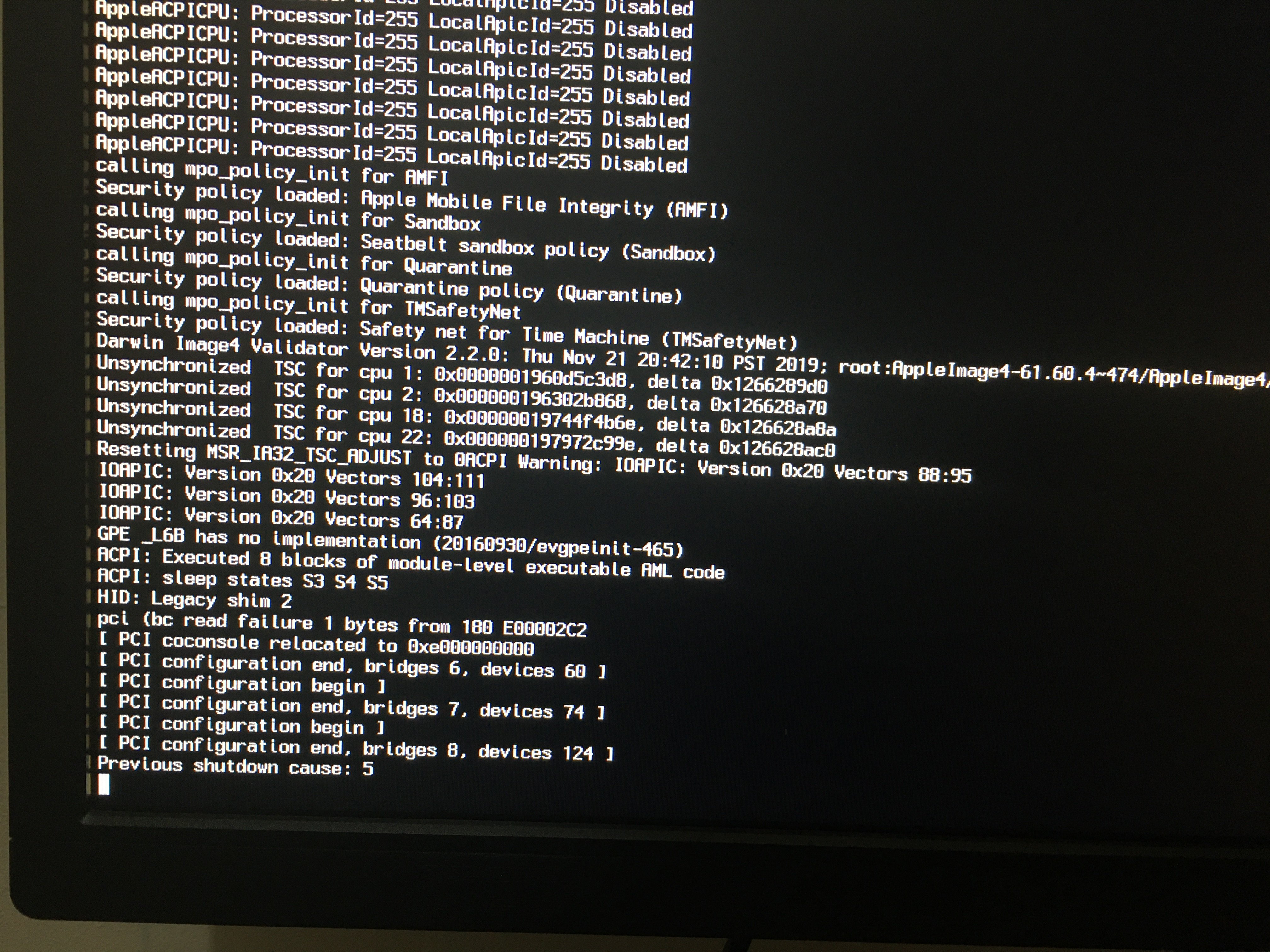

Booting stuck on PCI configuration end and apfs_module_Start:1683....
My configuration is i9 10940X + X299 Asus Prime deluxe II motherboard + Radeon VII graphics. I am able to boot with clover but on open core booting is stuck on PCI configuration end + apfs_module_Start:1683....
I have tested  OC on my other i9 9900K +z390 motherboard system and it works well
Do I need to add any quirks or any tweaks for X299? I have TSC sync kext for 14core is already added.

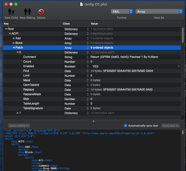

@Matgen84 any verbose screen?
I checked your config.plist. First, of all, you don't need these ACPI patches you are already using WEG. Remove all. Also, add AWAC.aml and checksum RTC patch. No need to set ProtectSecureBoot quirks YES. Make this NO.

Thanks. I can boot but with Black Screen instead of macOS Desktop! :wacko: How to find verbose screen?
Add boot-argument -v
I checked again you already have it. But remove those boot arg;
slide=255 agdpmod=pikera darkwake=8
Edited by telepati

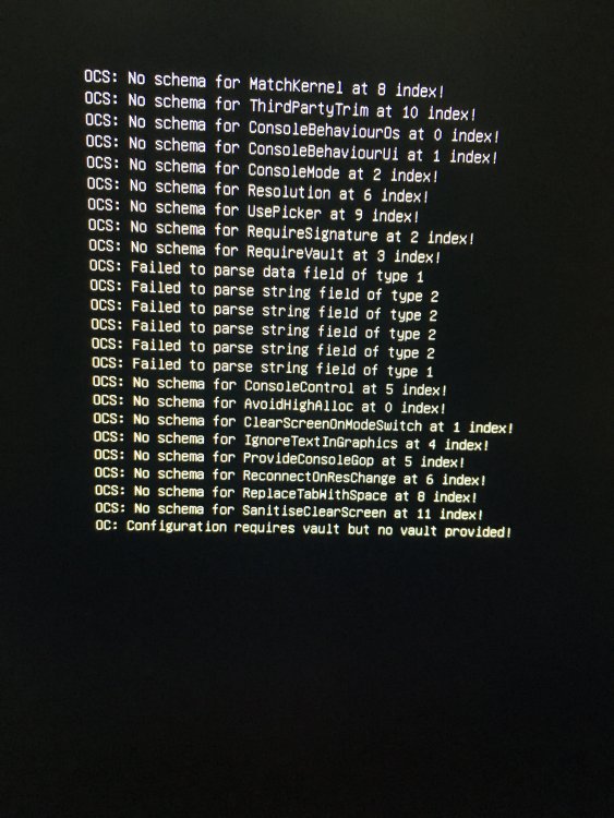

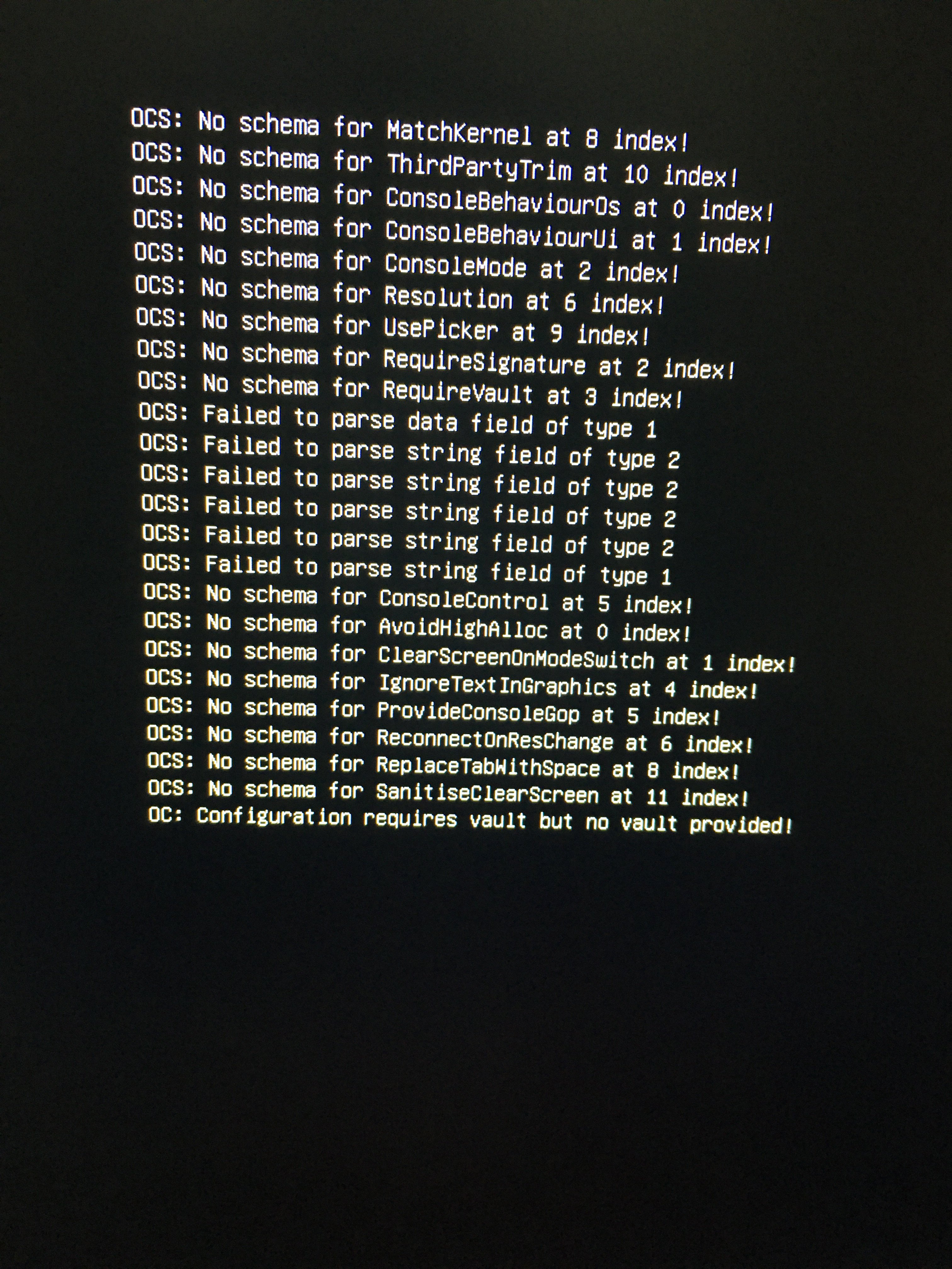

39 minutes ago, mathew2019 said:
Why I am getting these errors when I use latest OC V5.5, the booting is stuck on this screen. OC 5.4 is working fine.
Looks like you missed quite of few updates to the config, compare yours to the newer Sample.plist
