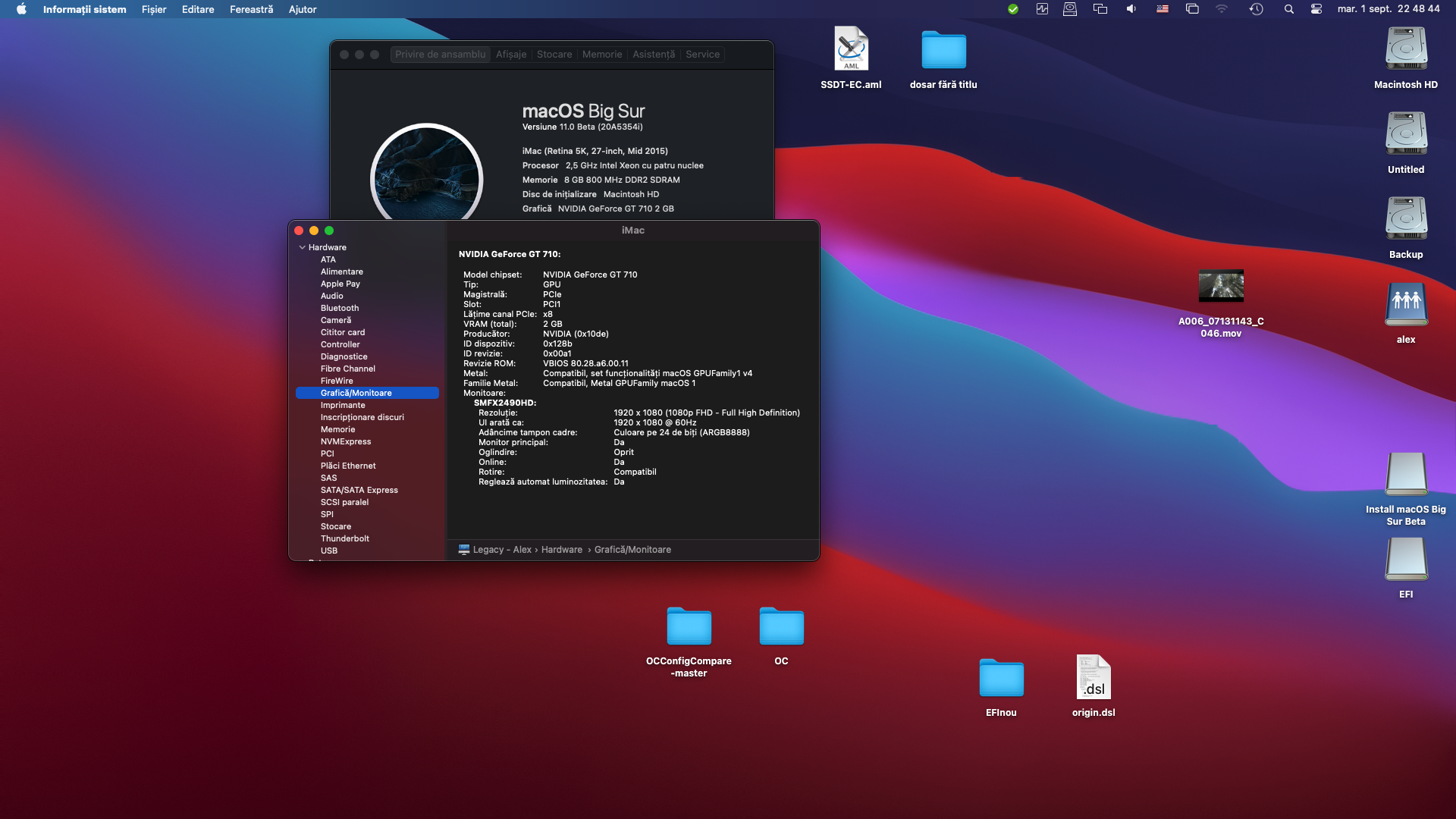

Hi! It is already installed. I will post EFI when it is fully functional (sound and usb issues). Until then tell me what problems do you have. If it is about booting, for USB I need to make a mbr USB booter, OS installer on another USB. After that you can use normal legacy method (Dortania) for ur HDD or SSD. Good luck!
Spoiler
HP xw4600 workstation, Core™2 Quad Processor Q9300, Nvidia GT 710, iMac 15.1, Big Sur beta 5
Hi, I downloaded a beta5 image and "dd" to a free internal SSD. I can't pass the early stage of boot "LOG:EXIT:BS:START" line.
Any clue is welcome, thanks!
3 minutes ago, analise said:
I have the DSDT from Catalina, that it's working in this same machine.
I really don't know what to patch!
Can you help?
Thanks
In this case make sure you use the latest OC and kext. And read carefully Dortania guide.

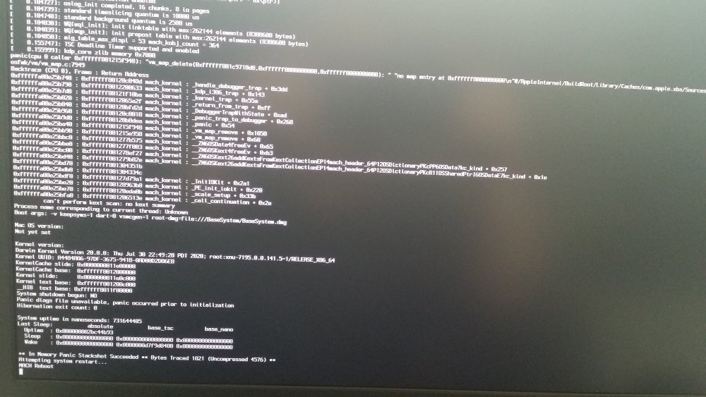

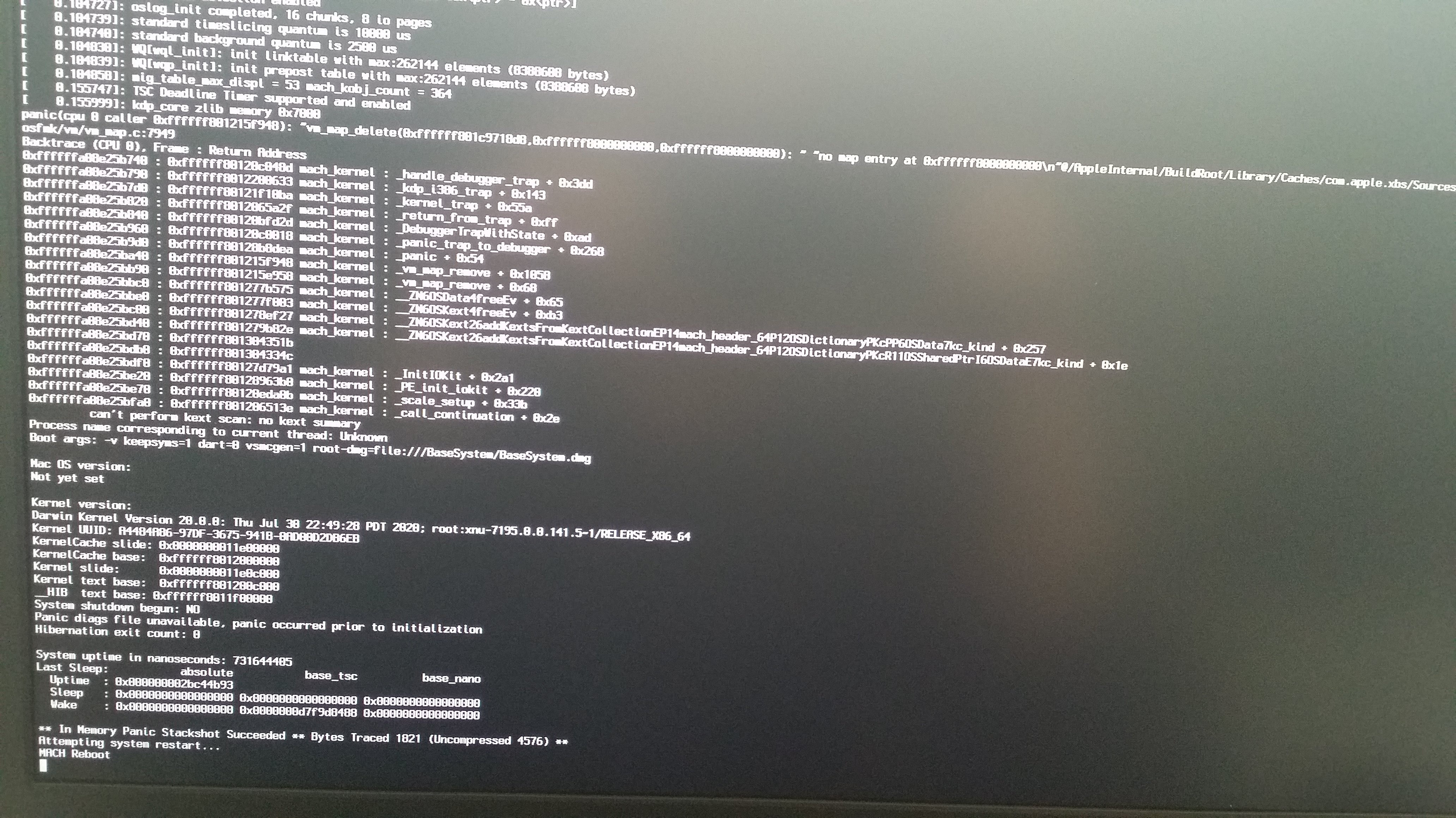

On 8/8/2020 at 8:01 PM, LIMITANT said:
Please Help :wallbash:
Panic cpu caller 0
vm_map_delete ......
no map entry at 0xfffff888888 ...
OC 0.6 boots Catalina 10.15.6 without problem , also It can install High Sierra without problems..
But with Big Sur Beta installer It stuck always with this panic " vm_map_delete .... as shown below in photo
  Reveal hidden contents
I'm getting the same panic, did you ever find a solution?
4 minutes ago, LIMITANT said:
I have fixed that , i don't know what was the issue .. i built OC from the beginning, i followed dortania laptop installation, reset bios , removed any attached disks, changed USB , ....
I don't know really where was the fix ..
I'm sure you will solve your issue but be patient and revise everything carefully in your plist , ACPI files , Kexts , tools , Drivers .... try and try again ... in the end you will succeess
What is your laptop spec.?
Good luck
I just now got the installer to boot up, I probably should've tried a bit more before posting for help. It was just VoodooInput.kext that caused it
