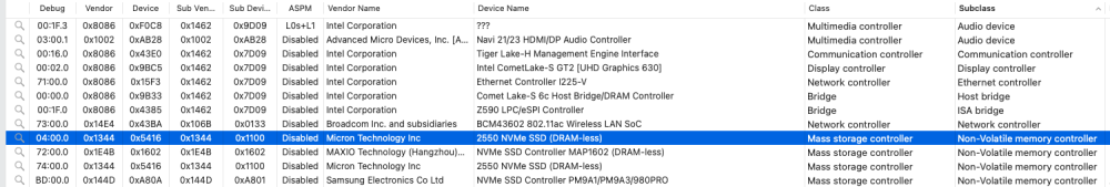

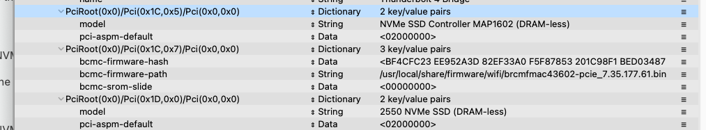

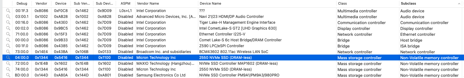

deeveedee Posted December 8, 2025 Author Share Posted December 8, 2025 I am experimenting with some minor changes to my posted EFI based on things I learned while hacking my HP Elitebook 850 G7. The changes with which I'm experimenting are: Remove boot-arg darkwake=2 (which may impact sleep) Add DeviceProperty "pci-aspm-default = <02000000>" to each NVMe m.2 SSD device for NVMe power management as explained by MaLd0N here. In my macOS Tahoe testing, I find that NVMe ASPM is disabled without the addition of the pci-aspm-default DeviceProperties. A sample plist is attached with my changes for those who may want to experiment. After adding the pci-aspm-default DeviceProperties, Hackintool shows NVMe ASPM enabled in Tahoe: Spoiler config.plist.zip 2 Link to comment https://www.insanelymac.com/forum/topic/343937-guide-catalina-big-sur-monterey-ventura-sonoma-sequoia-tahoe-on-hp-elitedesk-800-g4g5-mini-the-perfect-macmini81-hackintosh/page/44/#findComment-2844736 Share on other sites More sharing options...
MacKonsti Posted December 8, 2025 Share Posted December 8, 2025 Ηι @deeveedee why didn't you ask me, I'd tell you sooner LOL I have had this aspm parameter for some time, and indeed it still shows in Hackintool as L1, you are right! However I don't use 4 bytes but 1, to achieve the same result--I think I saw it someplace in some other native IOReg, so you could very well use only 2 bytes: <key>PciRoot(0x0)/Pci(0x1d,0x0)/Pci(0x0,0x0)</key> <dict> <key>pci-aspm-enable</key> <data>AQ==</data> <key>model</key> <string>WD Black SN750 NVMe Controller</string> </dict> However, I am not sure how this can be truly measured if it has any (positive) impact, except the L1 mention in Hackintool... didn't bother to dig further. I have had my eyes on an HP EliteDesk G5 Mini but they are hard to find in Europe and very expensive, to join your great thread here (still have my Intel NUCs) so allow me to keep reading your findings and post from time to time! Take care 2 Link to comment https://www.insanelymac.com/forum/topic/343937-guide-catalina-big-sur-monterey-ventura-sonoma-sequoia-tahoe-on-hp-elitedesk-800-g4g5-mini-the-perfect-macmini81-hackintosh/page/44/#findComment-2844739 Share on other sites More sharing options...
deeveedee Posted December 8, 2025 Author Share Posted December 8, 2025 (edited) @MacKonsti I should have asked you! Are you adding the pci-aspm-default property to any other PCIe devices on your NUC? On my HP Elitebook 850 G7 (laptop), I have added the property to NVMe m.2 SSD and to Wi-Fi. I am not sure "pci-aspm-default = 2" will make any difference on this HP EliteDesk desktop platform. I only started experimenting with the power management properties to maximize battery life on my laptop. EDIT: @MacKonsti we are using different ASPM properties. I did a quick search and found this: In macOS, pci-aspm-enable (or force) forcibly turns on PCIe Active-State Power Management for power saving, while pci-aspm-default (or auto/off) lets the system use its firmware's default, often turning it off or to a safe state, especially for non-Apple SSDs where enabling it can fix power drain but disabling it (via default/off) prevents hangs. pci-aspm-enable (or force) is for power savings but risks instability, whereas pci-aspm-default prioritizes stability but might use more power. Edited December 9, 2025 by deeveedee Link to comment https://www.insanelymac.com/forum/topic/343937-guide-catalina-big-sur-monterey-ventura-sonoma-sequoia-tahoe-on-hp-elitedesk-800-g4g5-mini-the-perfect-macmini81-hackintosh/page/44/#findComment-2844742 Share on other sites More sharing options...

MacKonsti Posted December 12, 2025 Share Posted December 12, 2025 On 12/8/2025 at 11:27 PM, deeveedee said: @MacKonsti I should have asked you! Are you adding the pci-aspm-default property to any other PCIe devices on your NUC? On my HP Elitebook 850 G7 (laptop), I have added the property to NVMe m.2 SSD and to Wi-Fi. I am not sure "pci-aspm-default = 2" will make any difference on this HP EliteDesk desktop platform. I only started experimenting with the power management properties to maximize battery life on my laptop. EDIT: @MacKonsti we are using different ASPM properties. I did a quick search and found this: In macOS, pci-aspm-enable (or force) forcibly turns on PCIe Active-State Power Management for power saving, while pci-aspm-default (or auto/off) lets the system use its firmware's default, often turning it off or to a safe state, especially for non-Apple SSDs where enabling it can fix power drain but disabling it (via default/off) prevents hangs. pci-aspm-enable (or force) is for power savings but risks instability, whereas pci-aspm-default prioritizes stability but might use more power. Hello mate, interesting find, I will change my key from default to enable, and see if L1 remains. Again, not sure how this is measurable beyond just being reported... Thank you very much for your advance research! 1 Link to comment https://www.insanelymac.com/forum/topic/343937-guide-catalina-big-sur-monterey-ventura-sonoma-sequoia-tahoe-on-hp-elitedesk-800-g4g5-mini-the-perfect-macmini81-hackintosh/page/44/#findComment-2844879 Share on other sites More sharing options...

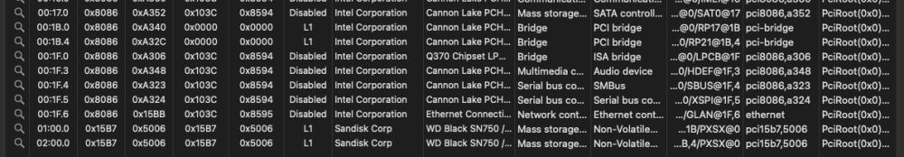

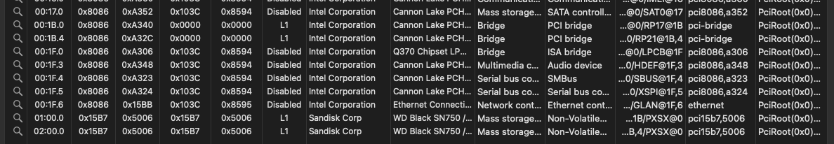

MacKonsti Posted December 13, 2025 Share Posted December 13, 2025 OK @deeveedee so I did a check on my Sonoma installation and did find that other PCI devices use "pci-aspm-default" so switched to that one, too. A simple Terminal line showed the following values (tried to improve it via ChatGPT but failed to show attached devices): % ioreg -lw0 | grep pci-aspm | | | | "pci-aspm-default" = 0 | | | | "pci-aspm-default" = <02> | | | | "pci-aspm-default" = 2 | | | | "pci-aspm-default" = 258 | | | | | "pci-aspm-default" = 2 | | | | | "pci-aspm-default" = 258 | | | | | "pci-aspm-default" = 2 | | | | "pci-aspm-default" = 2 | | | | "pci-aspm-default" = 258 | | | | "pci-aspm-default" = 2 | | | | "pci-aspm-default" = <02> | | | | "pci-aspm-default" = 0 | | | | "pci-aspm-default" = 256 I also found that whether you inject <integer>2</integer> or <data>Ag==</data> in config.plist text, the result is the same L1 in Hackintool. I added this flag to both my WD NVMe as well as my (embedded) Intel Wireless PCIe adapter (hence why you see twice <02>). As all other (native?) values in IORegistryExplorer.app are shown as "number" type, I am not sure if this is a bug in OpenCore, because when either <integer> or <data> is used, it results to "data" type being shown in IORegistryExplorer -- and it is strange, as I would have expected this to differ. I had found about this problem some time ago, when injecting the alc-layout-id as "integer" (24) which also showed as "data". Despite this, both cases/types seem to work, eventually. Just "integer" not treated/seen as "Number" in IORegistryExplorer... any ideas? In any case, L1 is shown for both devices in Hackintool so I can assume the injection of "2" or "0x02" works. Thank you for your tip. 1 Link to comment https://www.insanelymac.com/forum/topic/343937-guide-catalina-big-sur-monterey-ventura-sonoma-sequoia-tahoe-on-hp-elitedesk-800-g4g5-mini-the-perfect-macmini81-hackintosh/page/44/#findComment-2844931 Share on other sites More sharing options...
deeveedee Posted December 13, 2025 Author Share Posted December 13, 2025 (edited) @MacKonsti great report! I, too, have seen discrepancies between the OC injected data type and the type reported in IOReg. I experimented with different OC-injected types, but they remained stubbornly persistent in IOReg. So I decided that "if it ain't broke ..." Nice work! EDIT: Thank MaLd0N for the tip - I'm just the messenger. Edited December 13, 2025 by deeveedee 2 Link to comment https://www.insanelymac.com/forum/topic/343937-guide-catalina-big-sur-monterey-ventura-sonoma-sequoia-tahoe-on-hp-elitedesk-800-g4g5-mini-the-perfect-macmini81-hackintosh/page/44/#findComment-2844959 Share on other sites More sharing options...
MacKonsti Posted December 13, 2025 Share Posted December 13, 2025 (edited) Finally nailed it... For those of you that want to show which devices contain "pci-aspm" values (and any variants of the key) here's the final command in Terminal: % ioreg -lw0 | grep -E '@.*IOPCIDevice' -A40 | grep -E '@.*IOPCIDevice|pci-aspm' | | +-o MCHC@0 <class IOPCIDevice, id 0x100000325, registered, matched, active, busy 0 (0 ms), retain 9> | | +-o IGPU@2 <class IOPCIDevice, id 0x100000326, registered, matched, active, busy 0 (867 ms), retain 35> | | | | "pci-aspm-default" = 0 | | +-o PGMM@8 <class IOPCIDevice, id 0x100000327, registered, matched, active, busy 0 (12 ms), retain 9> | | +-o THRM@12 <class IOPCIDevice, id 0x100000328, registered, matched, active, busy 0 (11 ms), retain 9> | | +-o XHC@14 <class IOPCIDevice, id 0x100000329, registered, matched, active, busy 0 (437 ms), retain 14> | | +-o SRAM@14,2 <class IOPCIDevice, id 0x10000032a, registered, matched, active, busy 0 (13 ms), retain 9> | | +-o CNVW@14,3 <class IOPCIDevice, id 0x10000032b, registered, matched, active, busy 0 (414 ms), retain 12> | | | | "pci-aspm-default" = <02> | | +-o I2C0@15 <class IOPCIDevice, id 0x10000032c, registered, matched, active, busy 0 (9 ms), retain 9> | | +-o I2C2@15,2 <class IOPCIDevice, id 0x10000032d, registered, matched, active, busy 0 (11 ms), retain 10> | | +-o IMEI@16 <class IOPCIDevice, id 0x10000032e, registered, matched, active, busy 0 (95 ms), retain 11> | | +-o SATA@17 <class IOPCIDevice, id 0x10000032f, registered, matched, active, busy 0 (121 ms), retain 24> | | +-o RP05@1C <class IOPCIDevice, id 0x100000330, registered, matched, active, busy 0 (446 ms), retain 12> | | | | "pci-aspm-default" = 2 | | | +-o UPSB@0 <class IOPCIDevice, id 0x100000338, registered, matched, active, busy 0 (434 ms), retain 17> | | | | "pci-aspm-default" = 258 | | | +-o DSB0@0 <class IOPCIDevice, id 0x100000339, registered, matched, active, busy 0 (428 ms), retain 13> | | | | | "pci-aspm-default" = 2 | | | | +-o NHI0@0 <class IOPCIDevice, id 0x10000033c, registered, matched, active, busy 0 (425 ms), retain 12> | | | | | "pci-aspm-default" = 258 | | | +-o DSB1@1 <class IOPCIDevice, id 0x10000033a, registered, matched, active, busy 0 (4 ms), retain 13> | | | | | "pci-aspm-default" = 2 | | | +-o DSB2@2 <class IOPCIDevice, id 0x10000033b, registered, matched, active, busy 0 (35 ms), retain 13> | | | | "pci-aspm-default" = 2 | | | +-o XHC2@0 <class IOPCIDevice, id 0x10000033d, registered, matched, active, busy 0 (32 ms), retain 15> | | | | "pci-aspm-default" = 258 | | +-o RP09@1D <class IOPCIDevice, id 0x100000331, registered, matched, active, busy 0 (70 ms), retain 12> | | | | "pci-aspm-default" = 2 | | | +-o PXSX@0 <class IOPCIDevice, id 0x10000033e, registered, matched, active, busy 0 (59 ms), retain 13> | | | | "pci-aspm-default" = <02> | | +-o RP14@1D,5 <class IOPCIDevice, id 0x100000332, registered, matched, active, busy 0 (264 ms), retain 12> | | | | "pci-aspm-default" = 0 | | | +-o PXSX@0 <class IOPCIDevice, id 0x10000033f, registered, matched, active, busy 0 (258 ms), retain 12> | | | | "pci-aspm-default" = 256 | | +-o LPCB@1F <class IOPCIDevice, id 0x100000333, registered, matched, active, busy 0 (6 ms), retain 20> | | +-o HDEF@1F,3 <class IOPCIDevice, id 0x100000334, registered, matched, active, busy 0 (1579 ms), retain 12> | | +-o SBUS@1F,4 <class IOPCIDevice, id 0x100000335, registered, matched, active, busy 0 (215 ms), retain 13> | | +-o XSPI@1F,5 <class IOPCIDevice, id 0x100000336, registered, matched, active, busy 0 (6 ms), retain 9> | | +-o GLAN@1F,6 <class IOPCIDevice, id 0x100000337, registered, matched, active, busy 0 (568 ms), retain 12> This way you can see which devices have it natively, or set (i.e. value <02> that I mentioned before). In my case, as I mentioned, I set it in config.plist for CNVW (Intel PCIe embedded wireless) and PXSX (WD-Sandisk NVMe) Good night from Europe. (yes indeed, thanks MaLd0N for the original tip and you for opening my eyes as I had the other pci-aspm variant) UPDATE: For visual simplicity we can add an extra layer and remove contents between <class... and > in the devices list: % ioreg -lw0 | grep -E '@.*IOPCIDevice' -A40 | grep -E '@.*IOPCIDevice|pci-aspm' | sed 's/<class[^>]*>//g' | | +-o MCHC@0 | | +-o IGPU@2 | | | | "pci-aspm-default" = 0 | | +-o PGMM@8 | | +-o THRM@12 | | +-o XHC@14 | | +-o SRAM@14,2 | | +-o CNVW@14,3 | | | | "pci-aspm-default" = <02> | | +-o I2C0@15 | | +-o I2C2@15,2 | | +-o IMEI@16 | | +-o SATA@17 | | +-o RP05@1C | | | | "pci-aspm-default" = 2 | | | +-o UPSB@0 | | | | "pci-aspm-default" = 258 | | | +-o DSB0@0 | | | | | "pci-aspm-default" = 2 | | | | +-o NHI0@0 | | | | | "pci-aspm-default" = 258 | | | +-o DSB1@1 | | | | | "pci-aspm-default" = 2 | | | +-o DSB2@2 | | | | "pci-aspm-default" = 2 | | | +-o XHC2@0 | | | | "pci-aspm-default" = 258 | | +-o RP09@1D | | | | "pci-aspm-default" = 2 | | | +-o PXSX@0 | | | | "pci-aspm-default" = <02> | | +-o RP14@1D,5 | | | | "pci-aspm-default" = 0 | | | +-o PXSX@0 | | | | "pci-aspm-default" = 256 | | +-o LPCB@1F | | +-o HDEF@1F,3 | | +-o SBUS@1F,4 | | +-o XSPI@1F,5 | | +-o GLAN@1F,6 This way we see which IOReg devices contain a value. Note: Some names are injected by me in SSDT, like MCHC, PGMM, THRM etc. which are otherwise mentioned as their Device Path. Edited December 13, 2025 by MacKonsti 1 Link to comment https://www.insanelymac.com/forum/topic/343937-guide-catalina-big-sur-monterey-ventura-sonoma-sequoia-tahoe-on-hp-elitedesk-800-g4g5-mini-the-perfect-macmini81-hackintosh/page/44/#findComment-2844961 Share on other sites More sharing options...

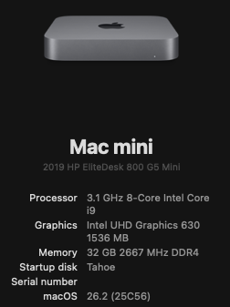

deeveedee Posted January 14 Author Share Posted January 14 (edited) Easy upgrade from Tahoe 26.1 -> 26.2 using the OC 1.0.6 EFI attached to Post #1 with the following changes: Removed boot-arg darkwake=2 Add pci-aspm-default DeviceProperties for NVMe m.2 SSDs, Ethernet, Audio, SATA My hack sleeps/wakes perfectly without issues. I will incorporate these changes into my OC 1.0.7 EFI after OC 1.0.7 is available. For improved UHD630 graphics performance in Tahoe, I continue to enable the following System Settings: Accessibility > Display > Reduce Transparency Accessibility > Motion > Reduce Motion EDIT: for improved overall responsiveness in Tahoe, upgrade RAM to at least 16GB with 2 equally-sized memory modules (e.g., for 16GB, use 2 x 8GB memory modules) Edited January 14 by deeveedee 3 Link to comment https://www.insanelymac.com/forum/topic/343937-guide-catalina-big-sur-monterey-ventura-sonoma-sequoia-tahoe-on-hp-elitedesk-800-g4g5-mini-the-perfect-macmini81-hackintosh/page/44/#findComment-2846429 Share on other sites More sharing options...

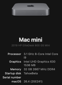

deeveedee Posted March 23 Author Share Posted March 23 (edited) I have uploaded a new EFI to Post #1. This new EFI is based on Open Core 1.0.7 and has changes previously discussed in this thread as listed below. When using this EFI, note the following: csr-active-config = <01000000>. Change this as follows based on your use case: csr-active-config = <01000000> for using and updating VoodooHDA.kext for audio csr-active-config = <03000000> for installing VoodooHDA.kext for the first time csr-active-config = <03080000> for using OCLP csr-active-config = <00000000> for SIP fully enabled This EFI does not enable Bluetooth. If you use Bluetooth, you will need to enable Bluetooth in BIOS, modify USB Map to add Bluetooth USB port (HS14), add NVRAM properties for Bluetooth and add required kexts. BrcmPatchRAM 2.7.2 is available from Acidanthera. I am currently using VoodooHDA.kext 3.1.2 available here for Audio in macOS Tahoe. I have SIP csr-active-config = <01000000> to allow VoodooHDA.kext in /Library/Extensions. This version of VoodooHDA.kext is working very well for me with outstanding audio quality and no root patches. Since I am not using Wi-Fi on this hack, I don't need to re-apply any root patches after updating macOS Tahoe. If you are using BluetoolFixup.kext (not included in my posted EFI), you will need to temporarily disable BluetoolFixup.kext to permit incremental macOS updates and then re-enable BluetoolFixup.kext after applying the incremental macOS update. Changes to the new EFI are as follows OC 1.0.7 EFI R01 Upgrade OC 1.0.6 -> 1.0.7 BOOT/BOOTx64.efi OC/OpenCore.efi OC/Drivers/*.* (except HfsPlus.efi) OC/Tools/*.* OC/Kexts Upgrade AppleALC.kext 1.9.6 -> 1.9.7 Upgrade Lilu.kext 1.7.1 -> 1.7.2 OC/ACPI Add SSDT-FWHD Remove unnecessary Else conditions in SSDTs OC/config.plist Add ACPI > Add > SSDT-FWHD OC 1.0.6 EFI R02 (Not posted) OC/config.plist Changed csr-active-config to <01000000> for VoodooHDA.kext Add pci-aspm-default DeviceProperties for NVMe m.2 SSDs, Ethernet, Audio, SATA Remove boot-arg darkwake=2 Add ACPI > Add > SSDT-MATH Add ACPI > Patch > Rename MATH._STA -> MATH._XSTA (paired with SSDT-MATH) OC/ACPI Add SSDT-MATH OC / Kexts Upgrade IntelMausiEthernet.kext 2.5.5d0 -> 3.0.0 Build 3.0.3 EDIT: Easy upgrade to macOS Tahoe 26.4 RC with this EFI. This hack is still working perfectly. Spoiler Edited March 23 by deeveedee 1 Link to comment https://www.insanelymac.com/forum/topic/343937-guide-catalina-big-sur-monterey-ventura-sonoma-sequoia-tahoe-on-hp-elitedesk-800-g4g5-mini-the-perfect-macmini81-hackintosh/page/44/#findComment-2848373 Share on other sites More sharing options...
deeveedee Posted March 25 Author Share Posted March 25 I have noticed that, since removing boot-arg darkwake=2, I sometimes need an extra mouse button click to wake displays after waking the hack from sleep. I believe that is why I had initially added the boot-arg. I don't plan to re-add boot-arg darkwake=2, so if you experience this issue and it bothers you, experiment with the darkwake boot-args. 1 Link to comment https://www.insanelymac.com/forum/topic/343937-guide-catalina-big-sur-monterey-ventura-sonoma-sequoia-tahoe-on-hp-elitedesk-800-g4g5-mini-the-perfect-macmini81-hackintosh/page/44/#findComment-2848410 Share on other sites More sharing options...
