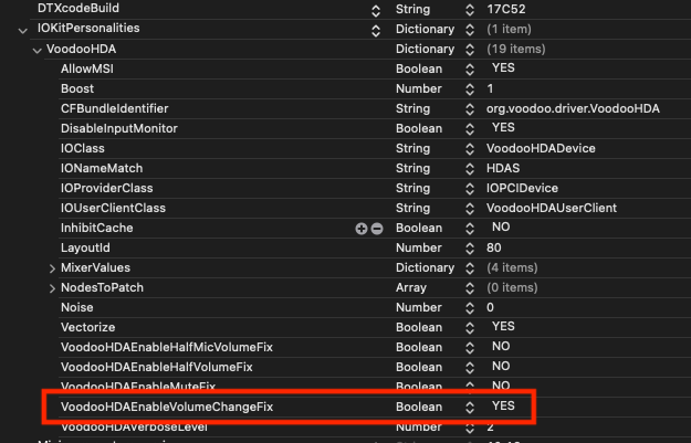

deeveedee Posted April 8 Author Share Posted April 8 (edited) Starting with VoodooHDA.kext 3.1.2, VoodooHDA's Info.plist must be customized for proper operation of the master volume slider on this HP EliteDesk 800 G4/G5 Mini. Before installing VoodooHDA.kext 3.1.2+ in /Library/Extensions, make the following change in Info.plist: Without this configuration change, the master Volume slider does not work properly. The VoodooHDA Info.plist is located in VoodooHDA.kext/Contents. Edited April 8 by deeveedee 3 Link to comment https://www.insanelymac.com/forum/topic/343937-guide-catalina-big-sur-monterey-ventura-sonoma-sequoia-tahoe-on-hp-elitedesk-800-g4g5-mini-the-perfect-macmini81-hackintosh/page/45/#findComment-2848857 Share on other sites More sharing options...

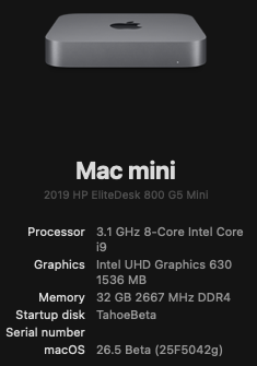

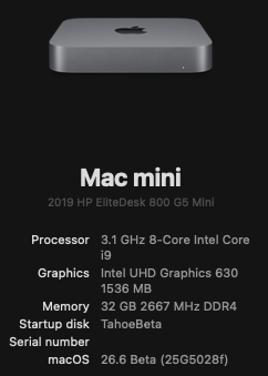

deeveedee Posted May 29 Author Share Posted May 29 Very fast and easy upgrade to Tahoe 26.6 Beta 1 in my test volume. For audio, I am now using VoodooHDA.kext 4.0 from MaLd0n here with VoodooHDAEnableVolumeChangeFix=True for working Volume slider. 2 Link to comment https://www.insanelymac.com/forum/topic/343937-guide-catalina-big-sur-monterey-ventura-sonoma-sequoia-tahoe-on-hp-elitedesk-800-g4g5-mini-the-perfect-macmini81-hackintosh/page/45/#findComment-2850744 Share on other sites More sharing options...

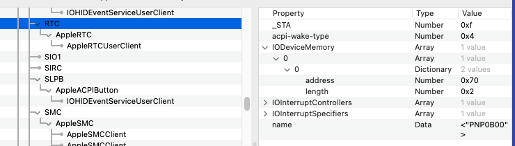

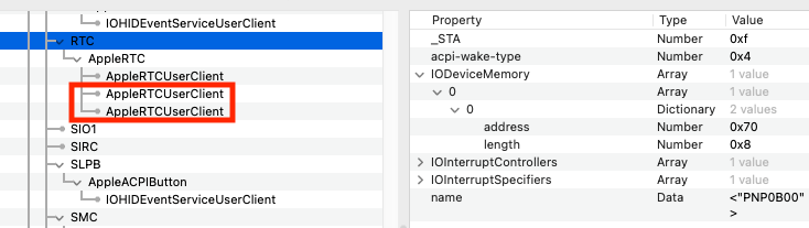

deeveedee Posted May 29 Author Share Posted May 29 Just making an observation about the RTC Fix that I'm using for this hack (SSDT-AWAC-HPET-RTC.aml) which changes RTC resource length from 8 to 2. When RTC resource length = 2 (required by HP EliteDesk 800 G4 Mini), IORegistry looks like this: When RTC resource length is unchanged at 8 (HP EliteDesk 800 G5 Mini does not need the RTC Fix), IORegistry looks like this: Note that the RTC Fix that I'm using is copied from CLOVER's RTC Fix. The RTC Fix (changing RTC resource length from 8 to 2) avoids access to problematic CMOS offsets on motherboards where CMOS compatibility is an issue. Again, this fix is not required for HP EliteDesk 800 G5 Minis. The fix is included in my EFI, since the EFI is for both G4 and G5 Minis. 1 2 Link to comment https://www.insanelymac.com/forum/topic/343937-guide-catalina-big-sur-monterey-ventura-sonoma-sequoia-tahoe-on-hp-elitedesk-800-g4g5-mini-the-perfect-macmini81-hackintosh/page/45/#findComment-2850746 Share on other sites More sharing options...

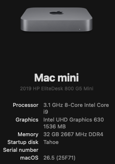

deeveedee Posted Tuesday at 04:31 PM Author Share Posted Tuesday at 04:31 PM (edited) I was pleasantly surprised to find that while the 65W EliteDesk 800 G5 Mini is intended for 9th Gen Intel CPUs, it also supports the 8th Generation i5-8600 CPU. I had a barebones G5 mini and an extra i5-8600 that needed a home. Together they make a perfect, low-cost hack for Tahoe. GeekBench 6 CPU Spoiler About This Hack Spoiler Edited Tuesday at 05:37 PM by deeveedee 2 Link to comment https://www.insanelymac.com/forum/topic/343937-guide-catalina-big-sur-monterey-ventura-sonoma-sequoia-tahoe-on-hp-elitedesk-800-g4g5-mini-the-perfect-macmini81-hackintosh/page/45/#findComment-2851153 Share on other sites More sharing options...
ird Posted 8 hours ago Share Posted 8 hours ago On 6/16/2026 at 9:31 AM, deeveedee said: I was pleasantly surprised to find that while the 65W EliteDesk 800 G5 Mini is intended for 9th Gen Intel CPUs, it also supports the 8th Generation i5-8600 CPU. I had a barebones G5 mini and an extra i5-8600 that needed a home. Together they make a perfect, low-cost hack for Tahoe. GeekBench 6 CPU Reveal hidden contents About This Hack Reveal hidden contents Thanks for sharing this @deeveedee. Is the G5 "unlocked" for boost power like G4 if an 8th gen CPU is dropped into it? I remember you mentioned with i5-9600 you observed there were limitations on how high the CPU could boost even with a 250W power brick. 1 Link to comment https://www.insanelymac.com/forum/topic/343937-guide-catalina-big-sur-monterey-ventura-sonoma-sequoia-tahoe-on-hp-elitedesk-800-g4g5-mini-the-perfect-macmini81-hackintosh/page/45/#findComment-2851208 Share on other sites More sharing options...
deeveedee Posted 8 hours ago Author Share Posted 8 hours ago @ird good question. I will need to run a few performance comparisons of G4 and G5 to determine whether they are treating PL1/PL2 the same for 8th Gen CPUs. Link to comment https://www.insanelymac.com/forum/topic/343937-guide-catalina-big-sur-monterey-ventura-sonoma-sequoia-tahoe-on-hp-elitedesk-800-g4g5-mini-the-perfect-macmini81-hackintosh/page/45/#findComment-2851209 Share on other sites More sharing options...
