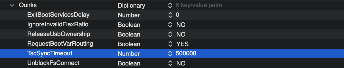

pitrysha Posted January 15, 2021 Share Posted January 15, 2021 Has anyone tried to enable Quirks -> TscSyncTimeout instead of CpuTscSync.kext 1 Link to comment https://www.insanelymac.com/forum/topic/341477-open-core-kernel-kext-patch-for-x99x299-motherboard/page/16/#findComment-2748870 Share on other sites More sharing options...
pitrysha Posted January 16, 2021 Share Posted January 16, 2021 On 1/15/2021 at 1:14 PM, pitrysha said: Has anyone tried to enable Quirks -> TscSyncTimeout instead of CpuTscSync.kext If the "sleep" function is not necessary for you, then you can delete CpuTscSync.kext, and use Quirks instead -> TscSyncTimeout = 500000 2 Link to comment https://www.insanelymac.com/forum/topic/341477-open-core-kernel-kext-patch-for-x99x299-motherboard/page/16/#findComment-2748934 Share on other sites More sharing options...
AslashA Posted January 17, 2021 Share Posted January 17, 2021 On 1/16/2021 at 2:57 PM, pitrysha said: If the "sleep" function is not necessary for you, then you can delete CpuTscSync.kext, and use Quirks instead -> TscSyncTimeout = 500000 Does the X99 sleep function work fine?)) I'm not at all sure if this kext is necessary for X99 hardware. I tried it with and without it, I didn't notice the difference. In the logs, there were also no messages about out-of-sync cores. Link to comment https://www.insanelymac.com/forum/topic/341477-open-core-kernel-kext-patch-for-x99x299-motherboard/page/16/#findComment-2748991 Share on other sites More sharing options...

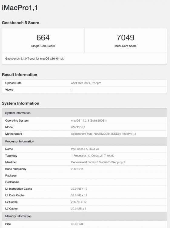

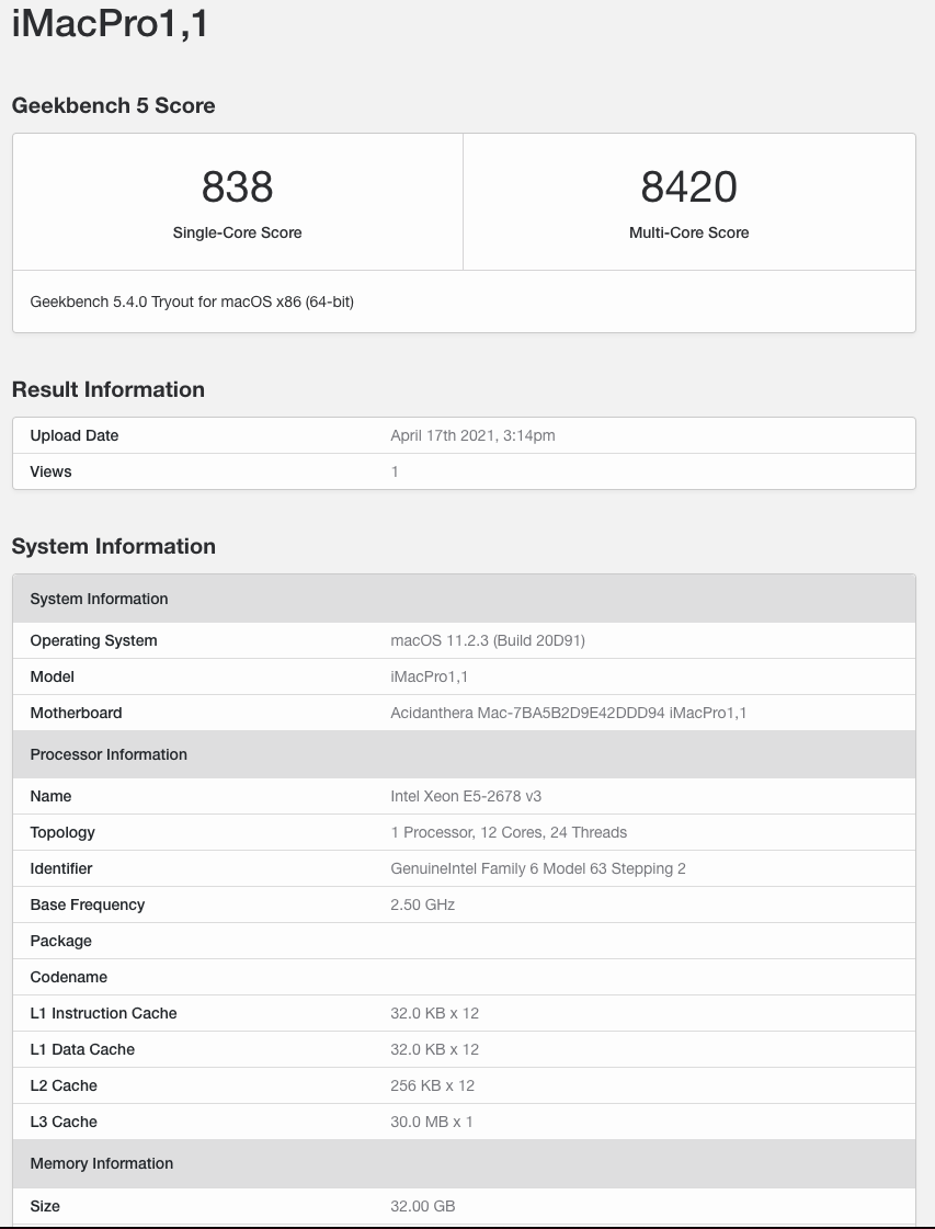

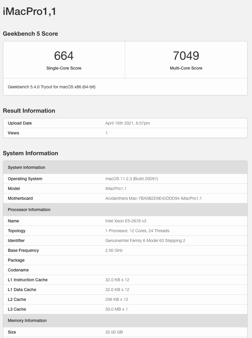

Dyckyj Posted April 17, 2021 Share Posted April 17, 2021 (edited) Got this working on a Dell T7810 Desktop with an E5-2678 V3. I was able to unlock MSR 0xE2 register hidden in the BIOS with RU.efi (labelled as MSR Lock not CFG Lock) and XCPM enabled through the SSDT-PLUG ACPI patch so I don't think most of these patches are necessary for me. All I needed was the 2nd SMT Scope patch for booting and the P-state patch to get the entire range of P-states. Without it my all core turbo was ~2.65Ghz, with it I get the full 2.90GHz. I can use 'AppleXcpmExtraMsrs' instead of the SMT Scope patch but this seems like a better, more targeted approach. Would any of the other patches be of use to me? I found this overview for some of them but I'm not sure what the rest do. I've attached my Geekbench5 score before and after the pstate patch. Huge improvement. Should have very solid performance when I add a 2nd CPU. Thanks nmano! Edited April 17, 2021 by Dyckyj Forgot a detail: use of SSDT-PLUG Link to comment https://www.insanelymac.com/forum/topic/341477-open-core-kernel-kext-patch-for-x99x299-motherboard/page/16/#findComment-2755853 Share on other sites More sharing options...
