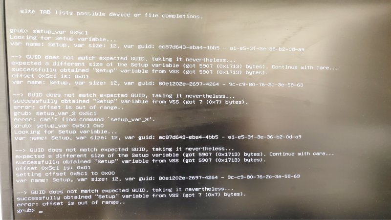

Unfortunately I cannot get CFG unlocked.. :( (Aorus Pro WiFi)
Although this is something easy to do, I still cannot get it to work after hours of trying.
I get this GUID error (image below) when I do the setup_var_3 with the modified grub shell.
First I was thinking this was normal, but when I check the file it still says:
CFG Lock, VarStoreInfo (VarOffset/VarName): 0x5C1, VarStore: 0x1
I dit this checkup this way:
-Save BIOS
-UEFITool --> IFR Extractor
-Look for CFG lock in text file: VarStore still says 0x1
--> I don't know if this is the correct method?
What am I doing wrong?
Thanks in advance!
*Another question:
When I try the N-D-K OpenCore EFI it won't boot. (circle with slash)
Has this something to do with no CFG unlock?
I can boot the Clover EFI perfectly fine.
The error is common. Just ignore it.

Hi Preatorianus,
sorry I wasn't sure if I had unlocked CFG, so I was making sure. Then i was thinking to replace my motherboard because maybe Gigabyte is is not perfectly compatible with hackintosh, but i don't know.
So for CFG i think that is unlocked, but in grub shell i get this (attach file). There is an error (offset is out of range). Do you had the same error?
6 minutes ago, alboz83 said:
Hi Preatorianus,
That’s correct, your unlocked pal :thumbsup_anim:

So "error: offset is out of range" is not important?
Yes after some research i understand that on each motherboard we need to patch something, understand which kext to use, ecc.. So i keep my GB mobo ;)

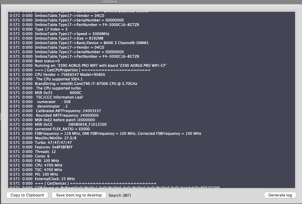

F12c Report for Pro-WiFi.
1.Flashed 12c Bios ->Rebooted
2.Loaded MSR Unlocked bios (thanks Praetorianus)
3.Rebooted->Adjusted my Overclock settings and stuff ->Rebooted
4.Boot to windows once to enable thunderbolt drivers -> Reboot to bios
5.Adjusted Thunderbolt Options->Shutdown
6.Loaded Osx Everything is ok
Here is Clover log Not Showing now the MSR is locked entry i had before so i assume everything is ok.

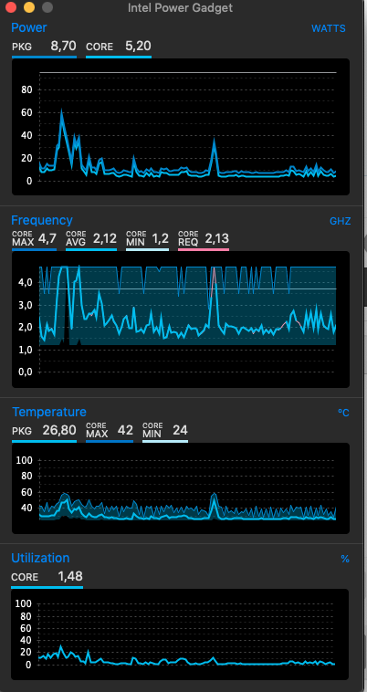

A question if anyone knows: i have the CPU locked on 4.7Ghz with all power savings-Speedstep etc off on bios.
On windows the frequency stays locked at 4.7 as it should. On osx it fluctuates though it reaches 4.7 when needed. Any way to lock it on 4.7? Is it a Clover thing?
Thanks Again guys!!!
On windows the frequency stays locked at 4.7 as it should. On osx it fluctuates thoug it reaches 4.7 when needed. Any way to lock it on 4.7? Is it a Clover thing?

Have you turned off all the c and p states in the bios?

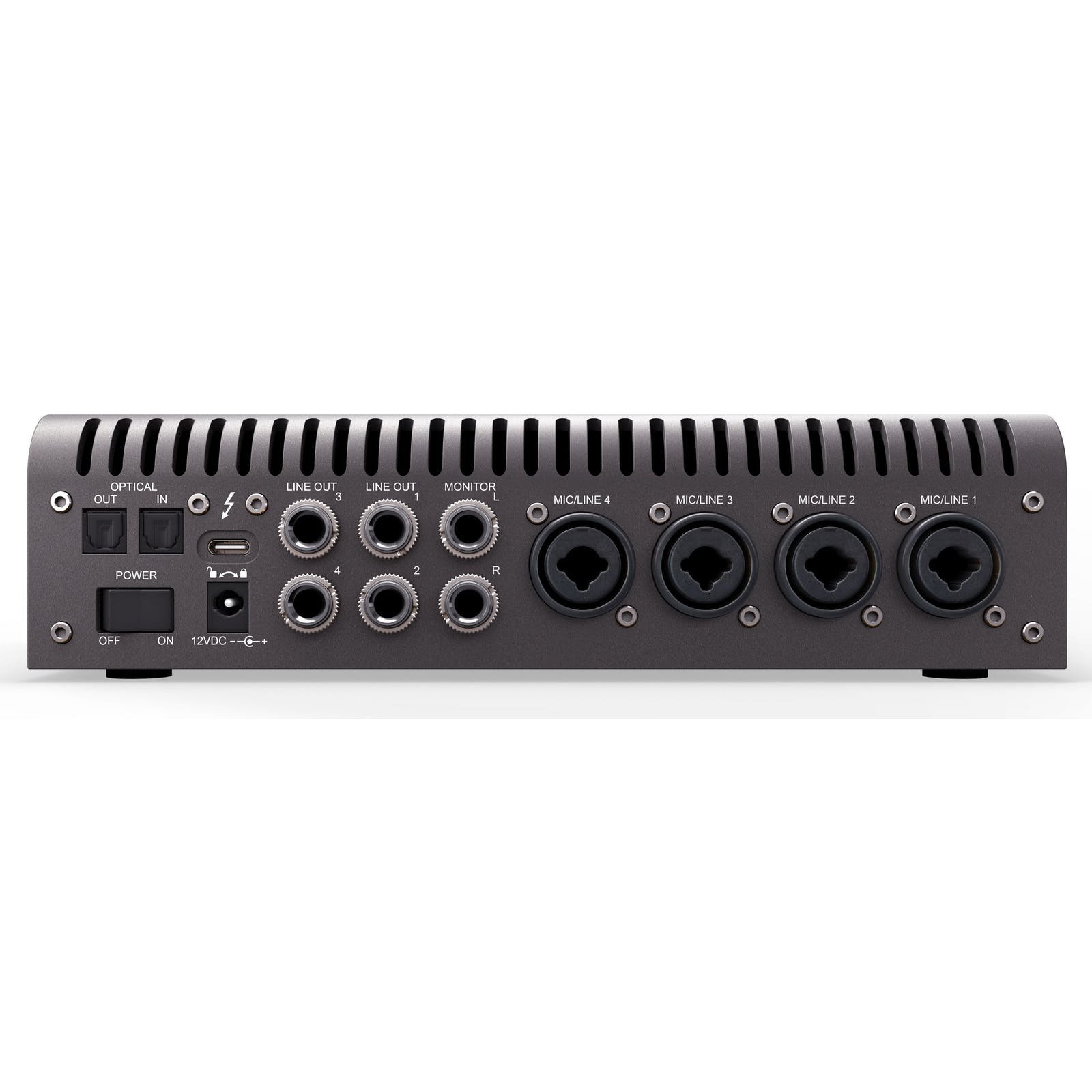

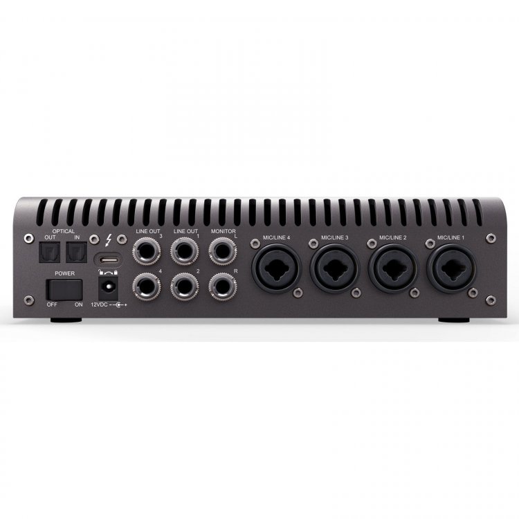

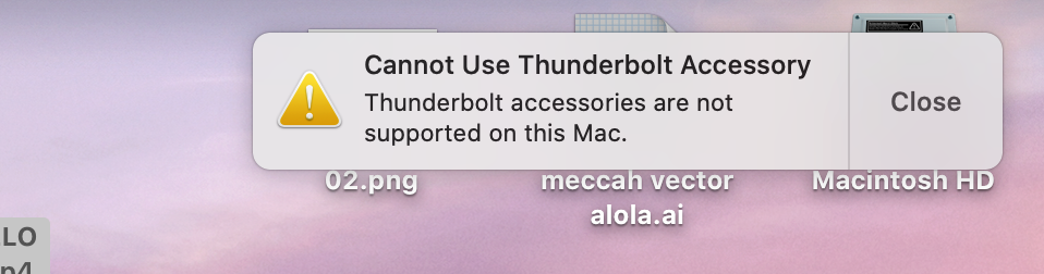

Hello dear
my EFI not work thunderbolt 3 for UAD Apollo X4
please help me for full EFI for MY PC Gigabyte Aorus Z390 Pro WiFi (F12c) | CPU: i9-9900K (@3.60 GHz) | GPU: Sapphire RX 580 8GB | RAM: Kingston HyperX RGB (64 GB) | SSD: Samsung SSD 970 Pro (1TB), OS: OSX 10.15.4, Win10 (1909)

What thunderbolt card are you using?
looking at your spec I don’t see one listed so it would probably help if you had a thunderbolt 3 pcie card to start with.
the ports on the Z390 Pro are NOT TB3, They are USB Type C :hysterical:
Edited by AudioGod
2 minutes ago, Olas said:
USB3.1 TYPE-C in my image is Thunderbolt 3
yes they use the same port but its not thunderbolt its usb type c and they are not the same thing sorry. this is why it says there are no thunderbolt devices. its because you don't have one. cmon mate its not rocket science :hysterical:
3 minutes ago, Olas said:
this my Apollo X4 thunderbolt 3 fix to gigabyte Aorus z390 pro wifi by Apple cable but not work
omg how many times do I have to tell you?
usb type c is not thunderbolt 3, they use the same port but they are not the same thing and usb type c in not compatible to use as a thunderbolt port.
why do you think it says usb type c on the port on the motherboard and doesn't say it on the Apollo and only has a thunderbolt sign?????
dude!!!! lol
Edited by AudioGod
What is the solution, my brother
