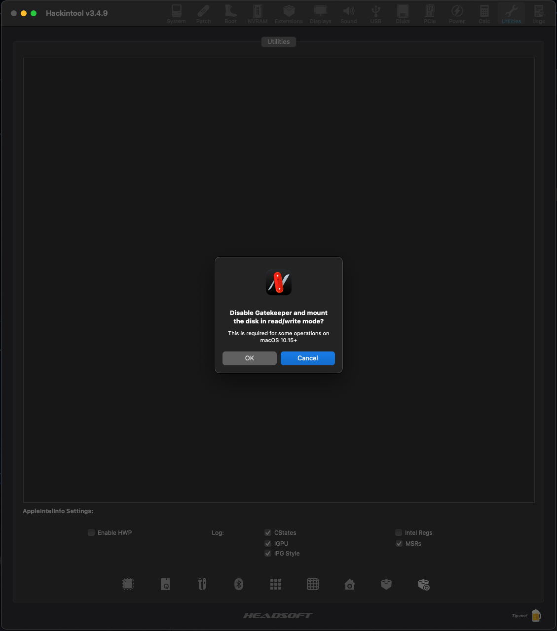

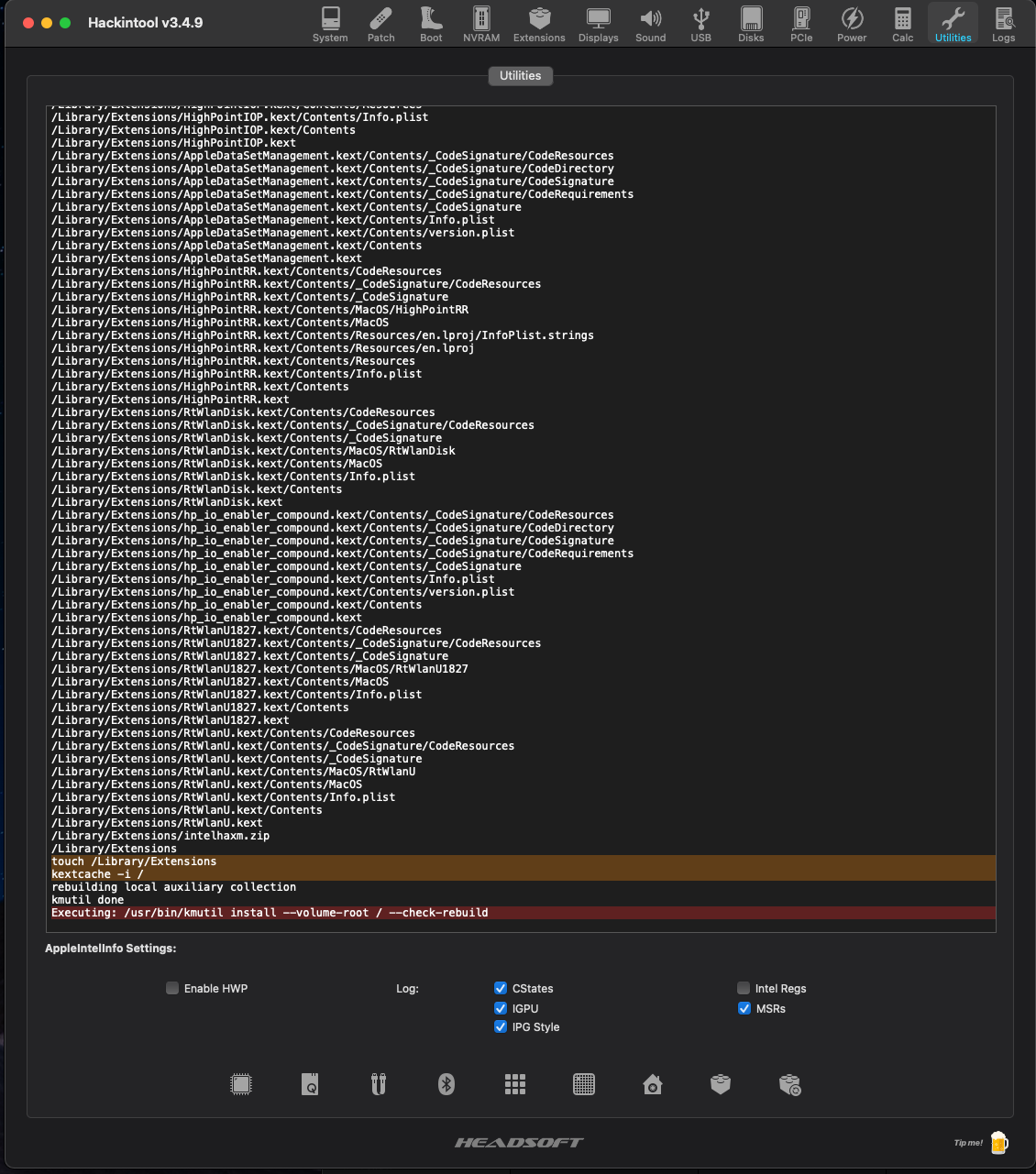

@eSaF I re-run it:
1927359803_Screenshot2021-01-05at19_04_02.thumb.png.cf82d125d869cf5ac4443b05edabf093.png
Finder closes and opens again, then:
1300072221_Screenshot2021-01-05at19_04_17.thumb.png.7fcf9da5d1e53c4d17d42ddc795bba66.png
Sleep now seems to be working again :)

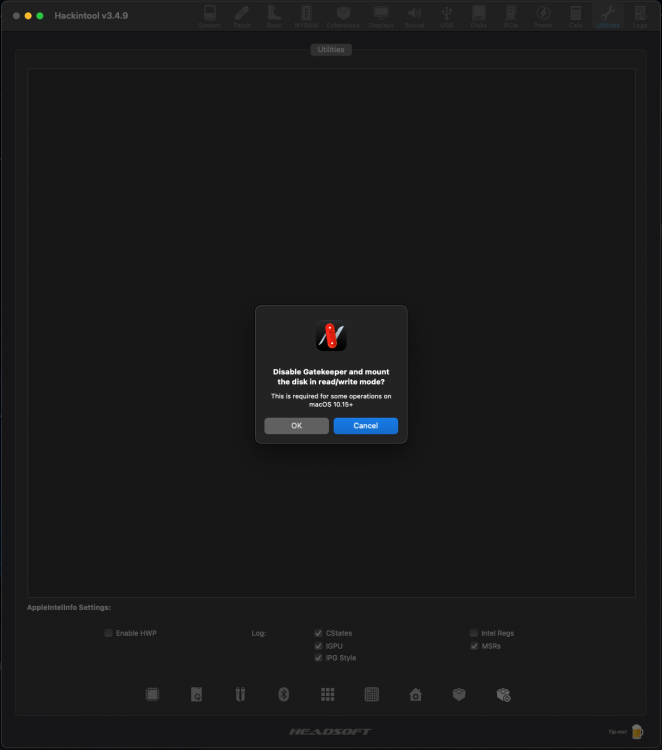

@panosru I got the same result as you (see pic) by disabling SIP and cleaning NVRAM but I still maintain Hackintool is not working like before but I am willing to be proven wrong. Do this test in Hackintool/Utilities/GetAppleIntelinfo (see pic) and prove me wrong if any info comes up, if it does, it means you've removed/unsealed BS data volume.
  Hide contents
847921325_ScreenShot2021-01-05at17_40_58.thumb.png.bab0fe0e69e2db7eabdefe18f39aafa3.png965701378_ScreenShot2021-01-05at17_44_06.thumb.png.29cf874c0d02eaafdec2ee8f9f74fb01.png
Test is opened to anyone else.
@eSaF Works for me buddy with SIP fully enabled. You sure your using the latest version of hackintool over there my friend?
Edited by AudioGod
Actually AppleIntelInfo also not working for me. It asks me to restart to enable the extension, I restart, but then after I restarted it tries to re-install it again and asks for restart again.. strange. SIP for me is disabled.

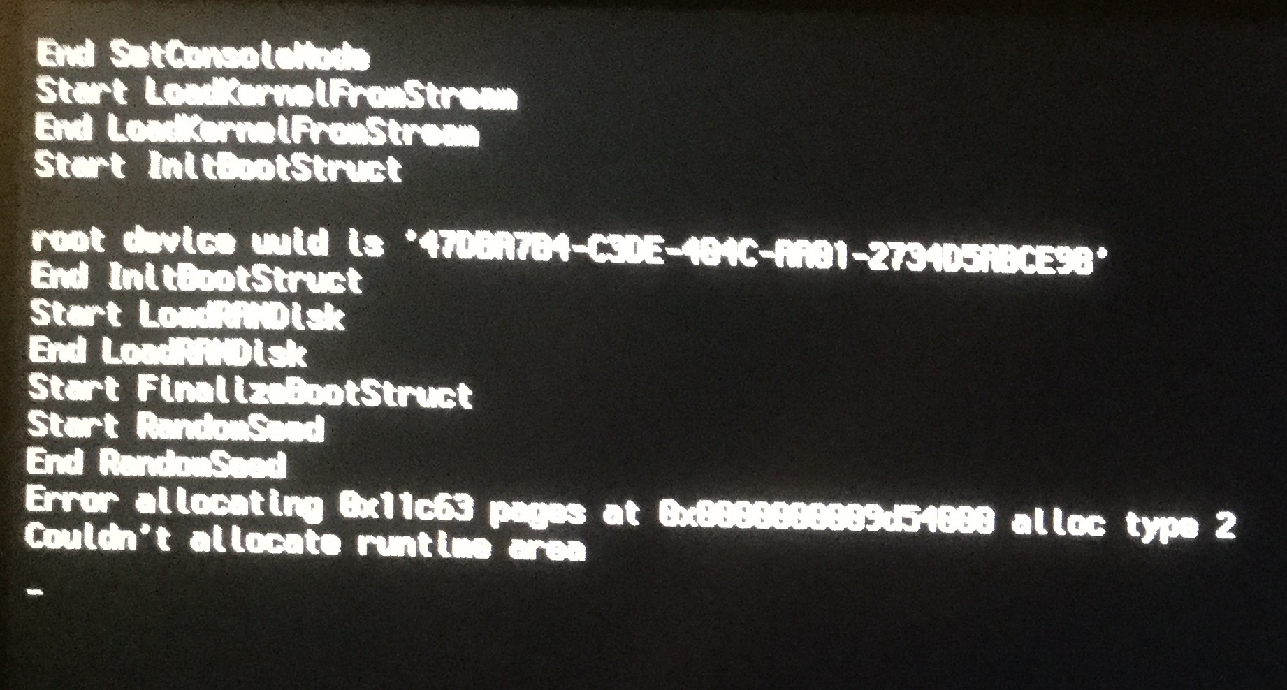

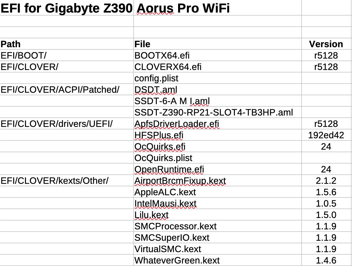

I decided to update my Clover EFI to r5128 along with the latest verions of the KEXTs and EFI drivers; not quite ready to move to OC, so I figured I should learn to maintain my EFI for the time being. I tested the EFI on USB flash drive to be safe and got the dreaded "Couldn't allocate runtime area" error. I reused the unmodified OcQuirks.plist from @AudioGod's Clover EFI 040820 (Polaris; 19,1)... perhaps the old settings don't work with Clover r5128 + Mojave?
Here is a snapshot of the error message and a listing of my EFI contents. Any advice will be greatly appreciated.

Quick update if anybody is out there... I reverted back to Clover r5120 but kept all the updated drivers, and it booted just fine. Not sure where to go from here, but if Clover is a dead end, I guess trying OC won't hurt.

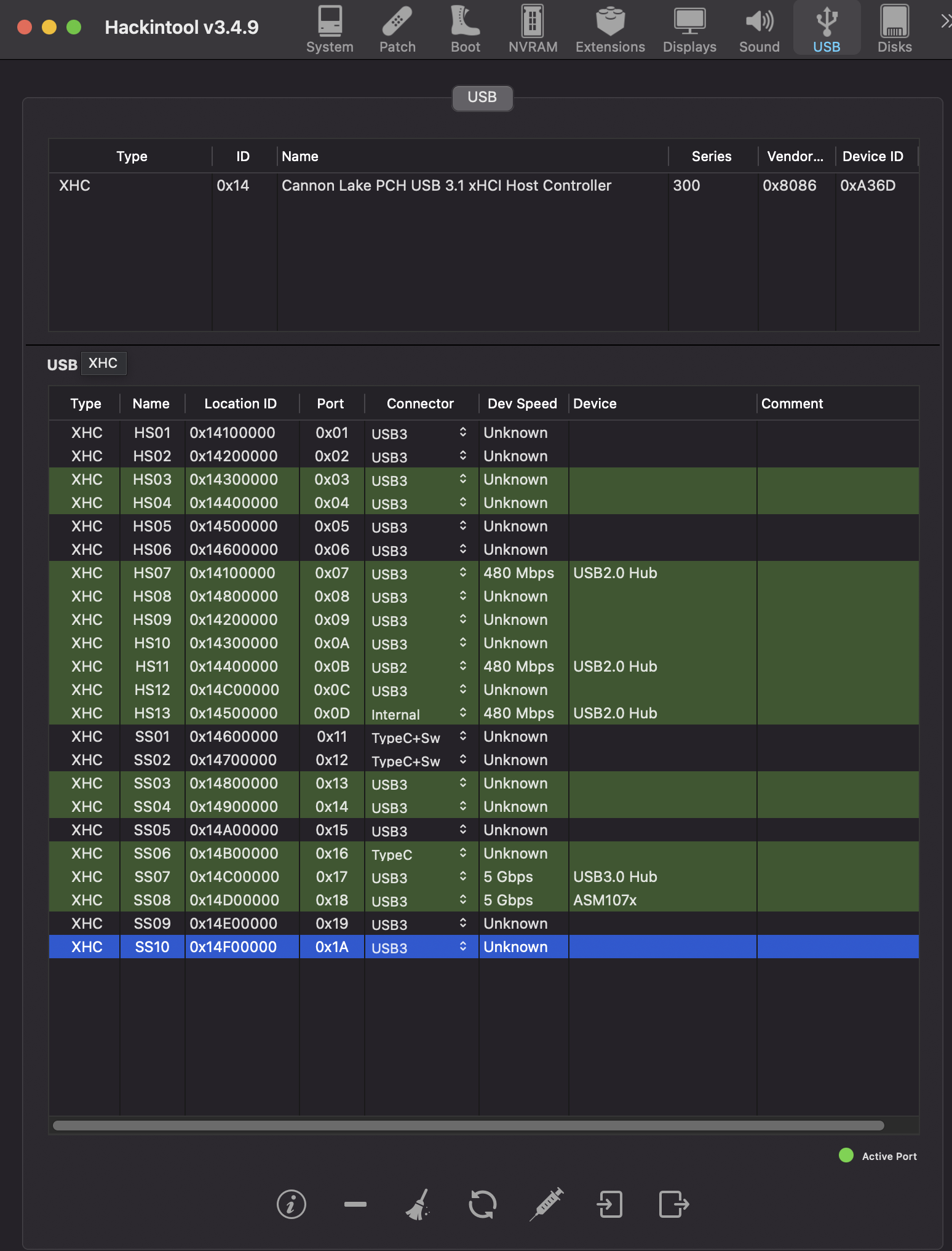

Everything works fine on my build. I was just wondering if the 15 port limit is still a thing with Big Sur because I checked with hacking tool and I realised that 23 ports a detected in my build with your EFI and the USB port map.
Only problem I still have (not a Hackintosh problem) is that my computer crashes after less then 5 min when I enable XMP. I tried the 3rd kit of RAM already and always the same. I doesn't crash with 2 sticks but as soon as I take 4 sticks it crashes. Meanwhile I think it's the motherboard. Without XMP it runs perfectly smooth.

26 minutes ago, benjiolino said:
Hello AudioGod,
Best
Ben
What’s going on there then?
15 port is in effect. Check to see the quirk to bypass the limit is disabled on the plist bud.
I just checked the EFI here and it’s all correct plus it’s the first I’m hearing about this one.
If your using your own personal USB kext instead of mine you need to make sure it’s name is USBMap.kext
