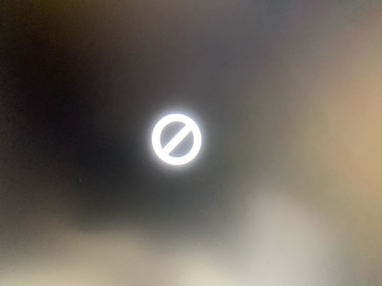

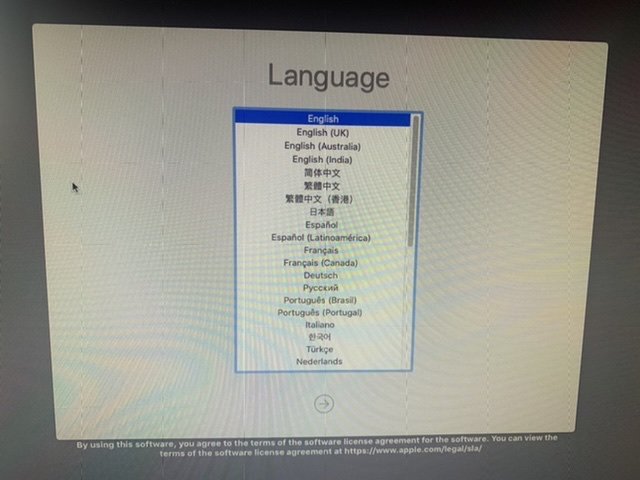

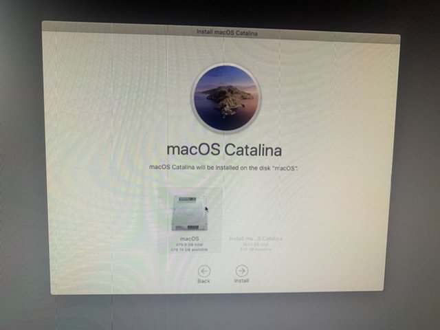

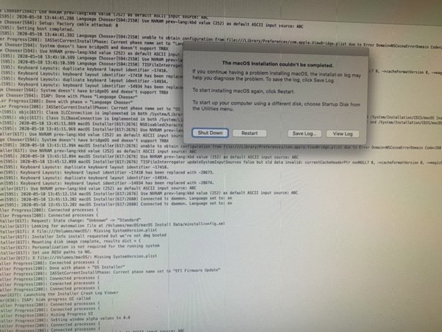

in the second usb stick, Clover showed me the language during the installation. unfortunately it ended the same way as before. We'll see if this reset helps.
ok, I take out the batteries, I'll wait a while, then I'll upload your bios profile and try again. also now i will try with clover after bios reset
No, before i had i7 6700k, Asus z270a, it worked without a problem. I installed windows 10 and everything worked. I still have Samsung m2 500gb, but I had the same problem during installation. I think it's not a disk
I did everything as you wrote, again there is the same problem.  I can upload photos from the whole installation, but there were some. I don't want to make a trash here

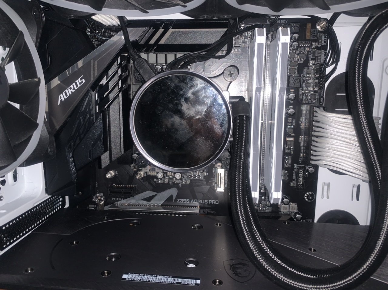

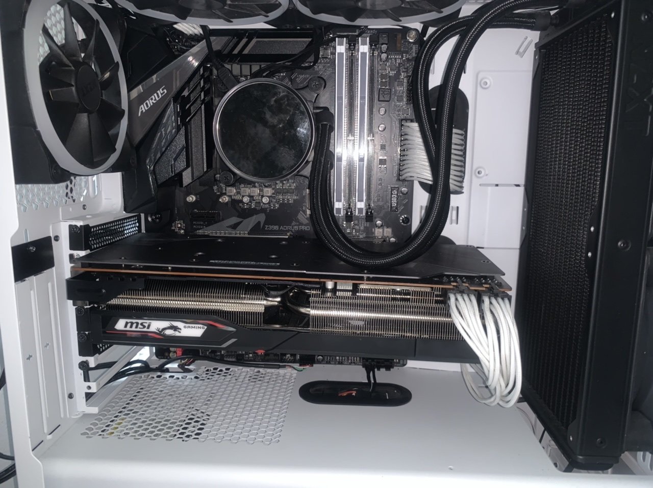

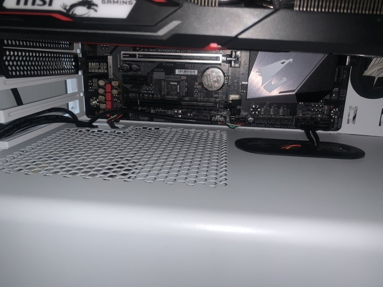

What’s your full spec including everything inside the system down to the cooler please?
and what slots are in use on the board and are you using a vertical mount. Include everything basically including makes and models?
Edited by AudioGod
I have:
I7 9700k
Gigabyte Z390
Msi Rx 5700xt
Corsair Vengeance RGB PRO DDR4-3200 DIMM CL16-18-18-36 2x 8gb
Corsair RMX 750x 80+Gold
NZXT Kraken X62 V2
I also have a network and sound card but I don't have them connected right now.

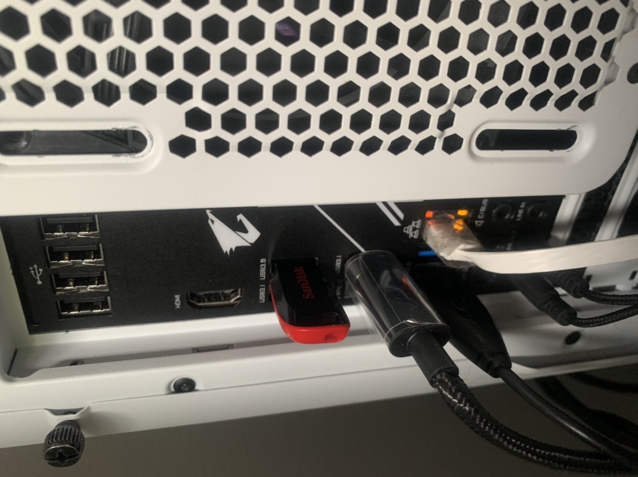

Move your keyboard and mouse to the usb2 hub At the top of the io plate (the black row of four usb2 hub) and remove any other usb devices for now. (Excluding the usb install key)
also while you have no WiFi bluetooth card in there disable airportbrcmfixup.fixup in the config.plist in OpenCore
or in clover remove the kext from the kext folder temperately.

I have MSI MPG Gaming Edge Z390 in my company with 5700xt have same problem. I switched to vega64 and install succesfully, after that I put 5700xt back. Worked!

Are you sure MSR (CFG Lock) is disabled on your motherboard? @AudioGod’s OC EFIs are set up for motherboards with disabled CFG Lock by default.
If it’s not unlocked check the first page of the topic there are two values that need to be enabled on OC config.plist
8 minutes ago, RDZ said:
I use @AudioGod cfg bios.  How can I check if it is disabled?
while on OpenCore Boot Picker, press space and select “Modified GRUB Shell”
then type:
setup_var_3 0x5C1
and press enter.
If it returns 0x00 then it is indeed unlocked.
you can shut down the computer pressing the power button after that.
PS Do not type anything else on the grub shell, I have no responsibility whatsoever if your motherboard flies to Mars
Edited by WizeMan
Or use Hackintool>Utilities>Click Get AppleIntelInfo button at bottom left and look for:
MSR_PMG_CST_CONFIG_CONTROL........(0xE2) : 0x7E000008
 - I/O MWAIT Redirection Enable......... : 0 (not enabled)
 - CFG Lock............................. : 0 (MSR not locked)

Yes I think so. Maybe you can try to use igpu only, just to installation. After that you can boot with 5700XT and remember add agdpmod=pikera to bootarg

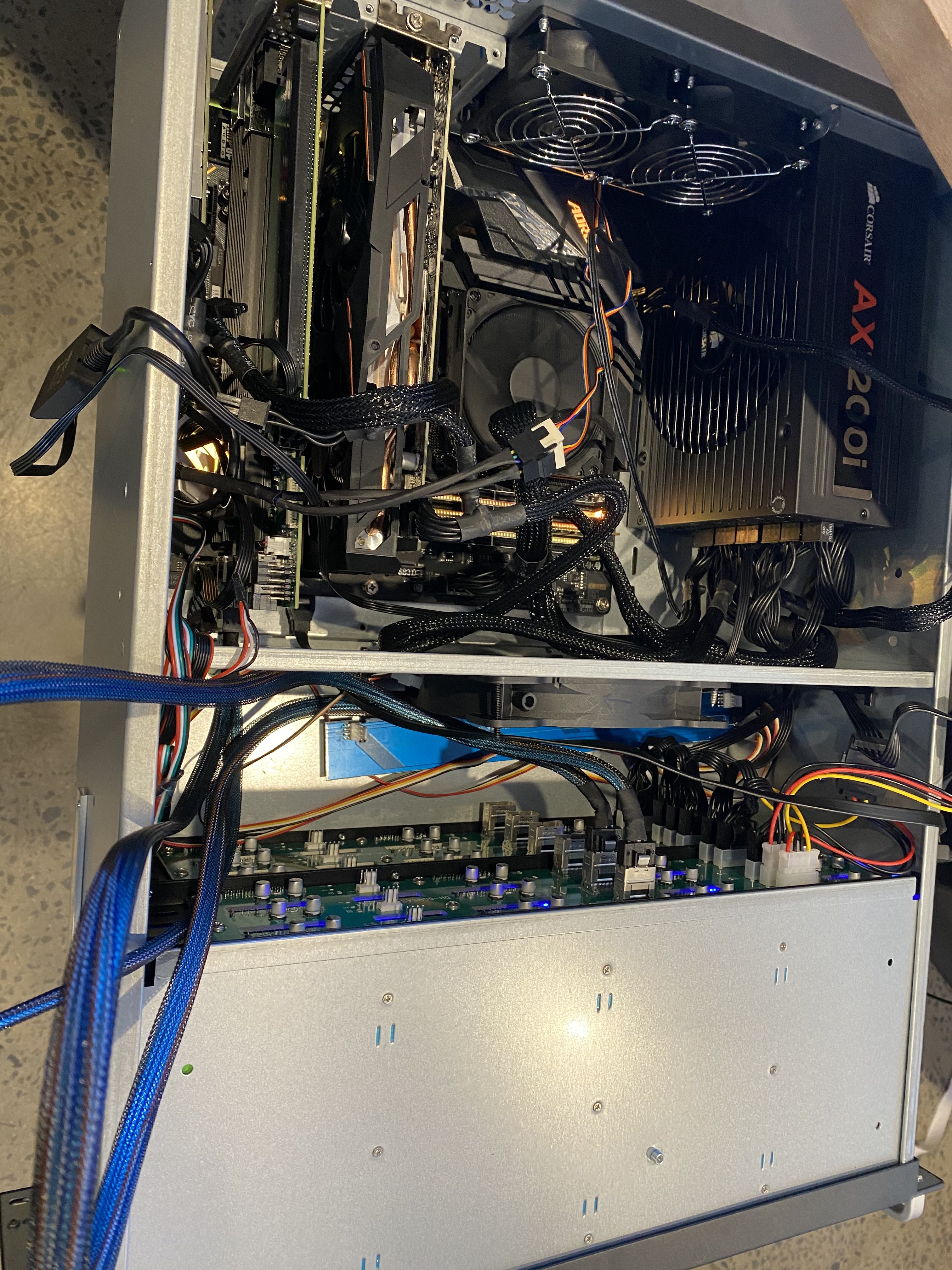

Just a quick update, once i installed the same series graphics card as your original build its been completely stable and dual boots windows and mac..
I've actually set it up in a configuration that it runs mac os server and can house and control 32 x HDD's using an internal ARECA PCI Card with SAS. I've set it as JBOD but it will do raid also. You can access this card from windows or mac. The drives show up as usable volumes in whatever format you choose.
Only issue im having is the graphics card isn't stable in windows and i'd rather remove it entirely and use the IGPU (server so don't need acceleration) but it won't boot if i remove the card at all...
Also got a StarTech ST10000SPEX 10gbe ethernet PCI card for it but can't get that to work at all, 1gb is ok for now.
