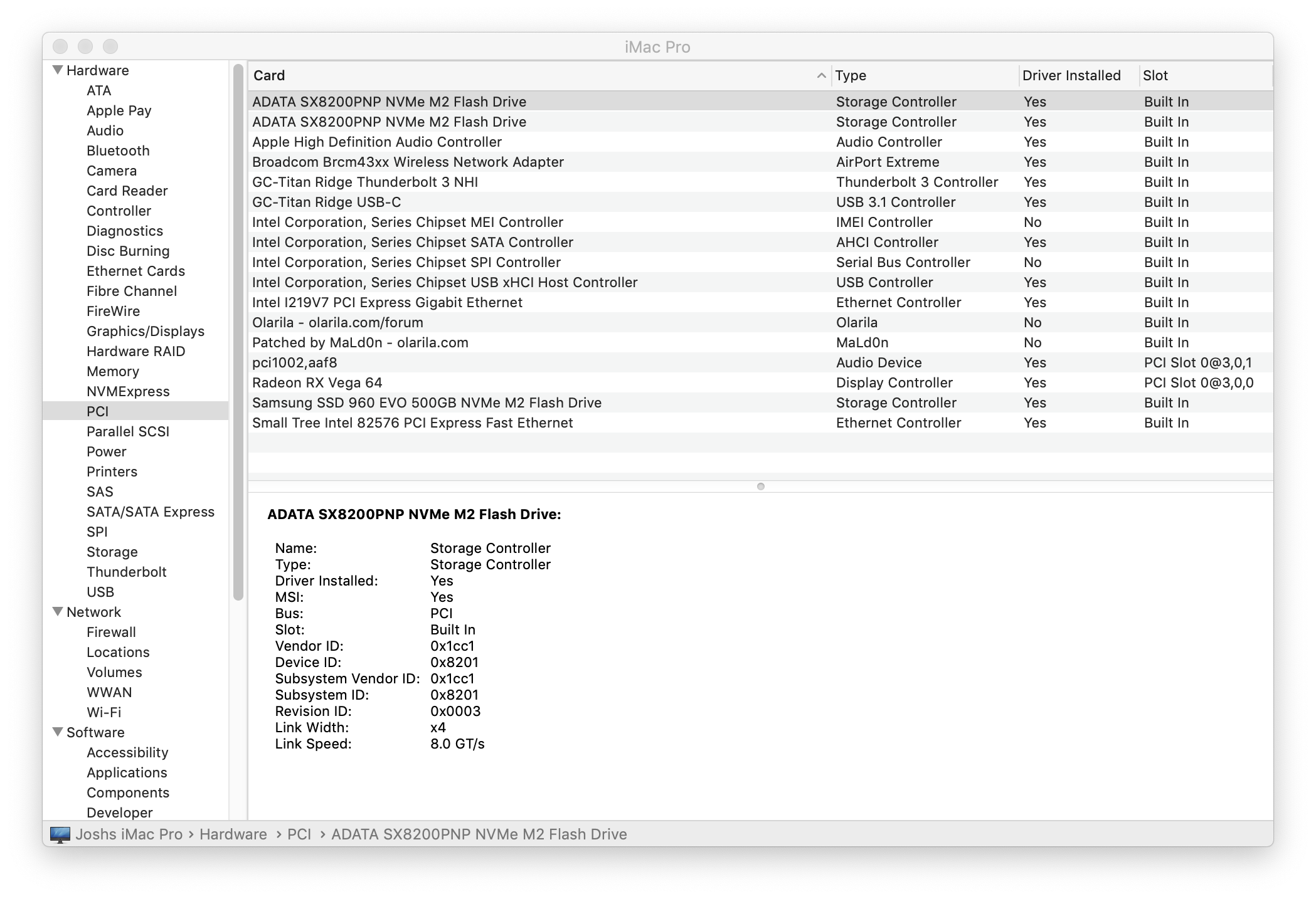

joshx Posted August 28, 2019 Share Posted August 28, 2019 Thank you very much! I am testing it right now and noticed some small differences to your screenshots in post#1: System report shows that drivers for IMEI- and SPI-Controller are not loaded and Realtek ALC1220 is not showing up properly. Link to comment https://www.insanelymac.com/forum/topic/339900-insanely-hackbeast-ga-z390-designare-thunderbolt-full-dsdt-patches-clover-opencore/page/2/#findComment-2687617 Share on other sites More sharing options...
MaLd0n Posted August 28, 2019 Author Share Posted August 28, 2019 3 hours ago, joshx said: Thank you very much! I am testing it right now and noticed some small differences to your screenshots in post#1: System report shows that drivers for IMEI- and SPI-Controller are not loaded and Realtek ALC1220 is not showing up properly. DSDT.aml.zip imei load only if u use inter graphics enable for intel quick sync Link to comment https://www.insanelymac.com/forum/topic/339900-insanely-hackbeast-ga-z390-designare-thunderbolt-full-dsdt-patches-clover-opencore/page/2/#findComment-2687645 Share on other sites More sharing options...

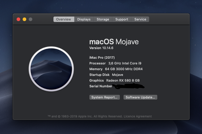

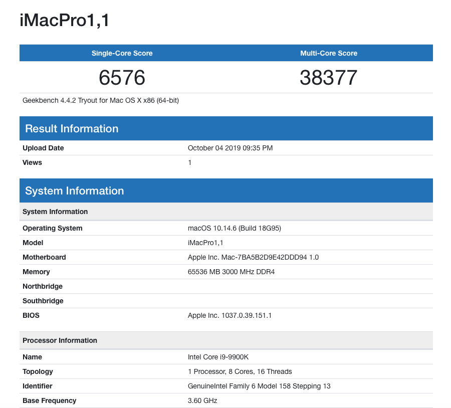

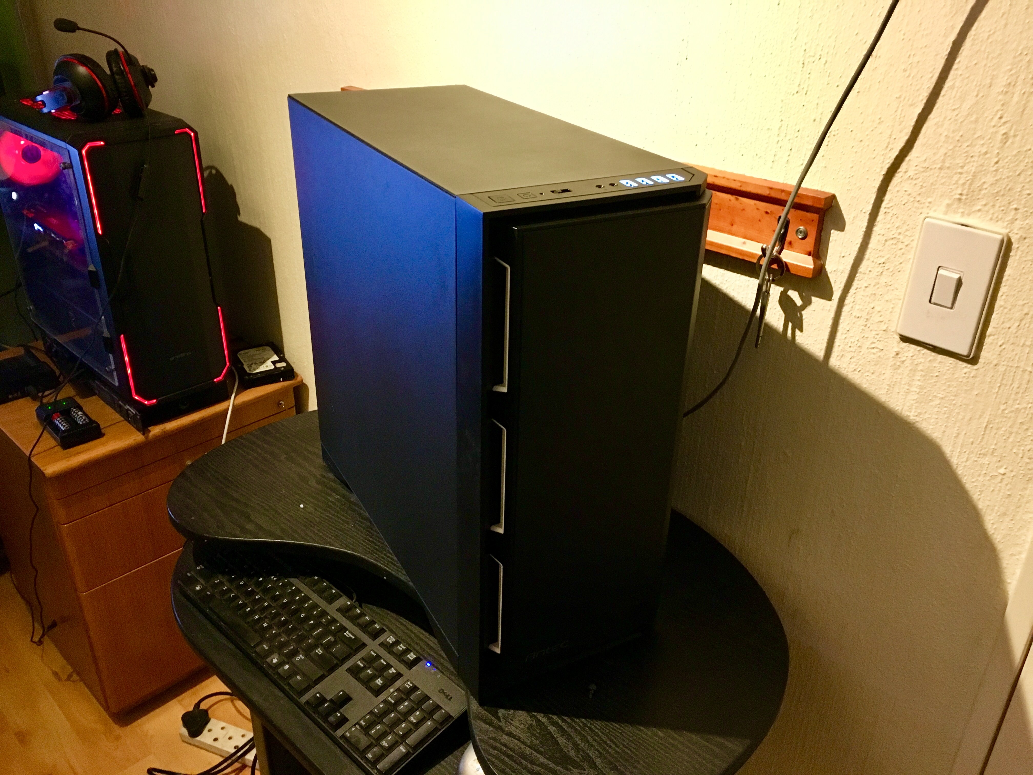

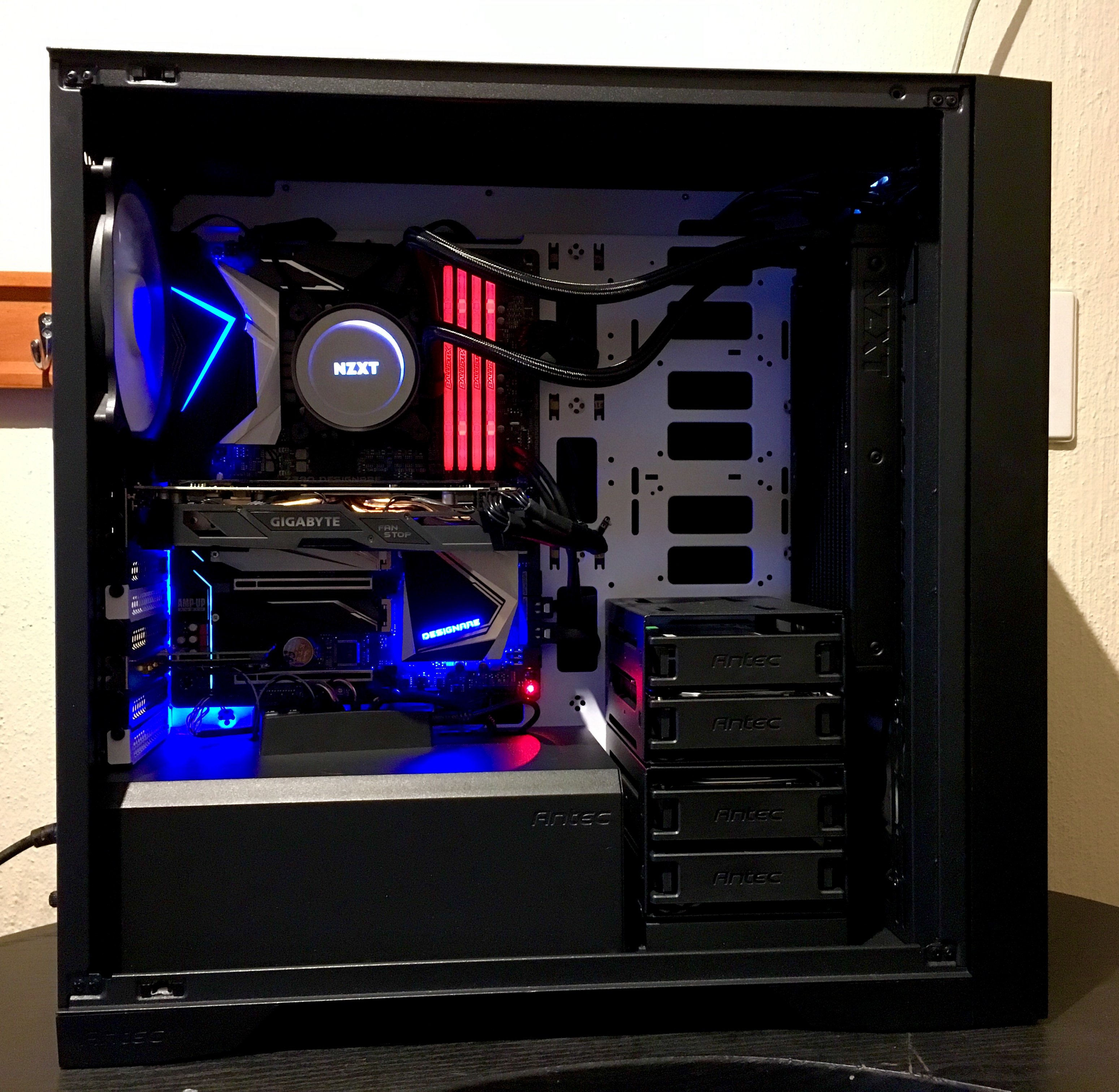

Mo Facta Posted October 4, 2019 Share Posted October 4, 2019 @MaLd0n thank you so much for this. I built almost the same machine (actually two of them) and your EFI worked 100%! My specs: i9-9900K Gigabyte Z390 Designare 64 GB Crucial Ballistix DDR4-3000 Gigabyte RX 580 8GB 1TB HP EX 950 M.2 NVMe 1 x 1TB Seagate Firecuda HDD 2 x 2TB Seagate Firecuda HDD (Apple RAID 0 4TB) Corsair RM1000x PSU NZXT Kraken X52 OSXWiFi PC/Hackintosh - Handoff and Continuity - Broadcom BCM94360CD NZXT USB2.0 internal hub Antec P101 Silent case Mojave 10.14.6 Notes: Had to manually choose DDR4-3000 memory frequency otherwise it defaulted to 2666 with XMP profile 1. I made the 2x2TB Firecuda HDDs an Apple RAID 0 for double throughput and one volume. This will be a sample/virtual instrument library volume for audio production. This board only has one USB2.0 header. The cooler, Broadcom WiFi/Bluetooth card (from OSXWiFi) and the front USB ports needed their own ports. So I used the NZXT USB2.0 internal hub. Worked like a charm. Another thing is, you need to remove the on-board Intel WiFi/Bluetooth card for the add-on card bluetooth to work. This is very easy as the module is mounted right under the first x16 PCIe slot on the mobo surface as opposed to under the rear IO cover. Once that came out, all worked great OOB. This Hackbeast is now perfect. 100% working no issues. Included Geekbench 4 benchmark cuz I'm not used to GB5 yet. Thanks to @MaLd0n! Cheers :) Link to comment https://www.insanelymac.com/forum/topic/339900-insanely-hackbeast-ga-z390-designare-thunderbolt-full-dsdt-patches-clover-opencore/page/2/#findComment-2692244 Share on other sites More sharing options...
