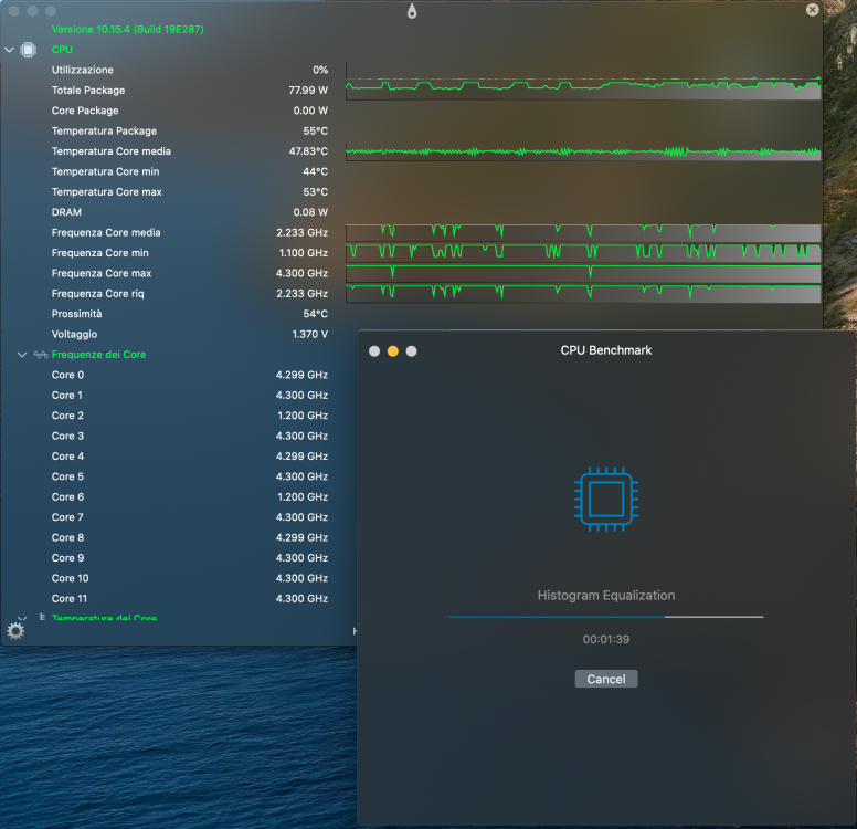

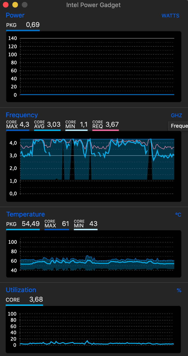

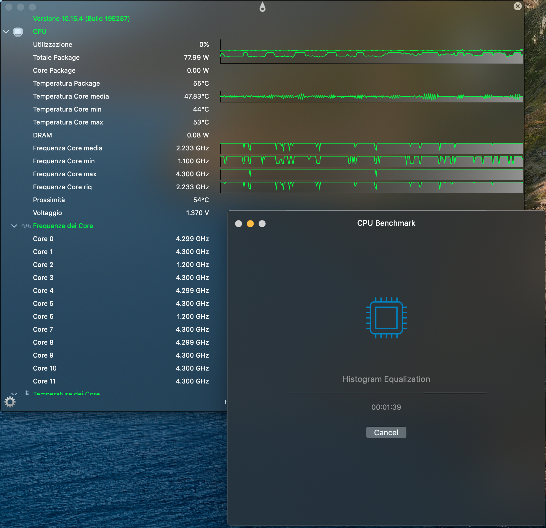

lucke Posted May 1, 2020 Share Posted May 1, 2020 28 minutes ago, jlcdgd said: They work together perfectly with xcpm and really smooth in my case... Thanks vector @jlcdgd, @vector sigma: There is a real increase in performance, however with PmDrvr, the readings of HWMonitor seem strange... especially in the instant use of the CPU load. I don't know why, and I don't know if the use of this kext is actually an advantage, apart from the performances ... Here I trust vector sigma that certainly knows more than me! At the moment I preferred to eliminate it, also due to an increase in core temperature ... Link to comment https://www.insanelymac.com/forum/topic/335650-kernelandkextpatches-1013x1014x1015x-x99x299/page/7/#findComment-2720407 Share on other sites More sharing options...
jlcdgd Posted May 1, 2020 Share Posted May 1, 2020 6 minutes ago, vector sigma said: yes, Clover enables xcpm (for unsupported CPUs) only if you set KernelAndKextPatches->KernelXCPM = true. For supported CPUs it just will work. If your is an unsupported one, KernelAndKextPatches->KernelXCPM = false (or just remove the key) will work as well, I guess. Otherwise you will have two programs that will interefere each other. P.S. you can disable it also in Clover GUI at boot (binaries patching menu). Ok... With KernelXCPM off (Not ticked) I get better scores in Mojave But some "periodic peaks" in performance that create some playback errors in protools ("related to buffer sizes" which has no sense). Also higher temperatures. You can see peaks here: With KernelXCPM off (Not ticked) I get slightly better scores in Catalina but some "periodic peaks" in performance too. Protools uses more CPU resources but is more stable than Mojave... Also higher temperatures. Geekbench in Catalina: So in my conclusion the combination is better in both systems. No other patches applied... Link to comment https://www.insanelymac.com/forum/topic/335650-kernelandkextpatches-1013x1014x1015x-x99x299/page/7/#findComment-2720409 Share on other sites More sharing options...
jlcdgd Posted May 1, 2020 Share Posted May 1, 2020 12 minutes ago, lucke said: @jlcdgd, @vector sigma: There is a real increase in performance, however with PmDrvr, the readings of HWMonitor seem strange... especially in the instant use of the CPU load. I don't know why, and I don't know if the use of this kext is actually an advantage, apart from the performances ... Here I trust vector sigma that certainly knows more than me! At the moment I preferred to eliminate it, also due to an increase in core temperature ... Of Course vector sigma knows a lot off more than me... I was a "coder" a hundred years ago so... In my case 5960X Asus X99 EWS temperature is lower and my system is way more stable with protools (in fact much better than a MacPro with 8 cores) if I use a combination of two. Just trying to help if I can do something. Brumbauer (the gentelman who did the kext) is a master too. Best wishes and thanks for reporting... 1 Link to comment https://www.insanelymac.com/forum/topic/335650-kernelandkextpatches-1013x1014x1015x-x99x299/page/7/#findComment-2720411 Share on other sites More sharing options...

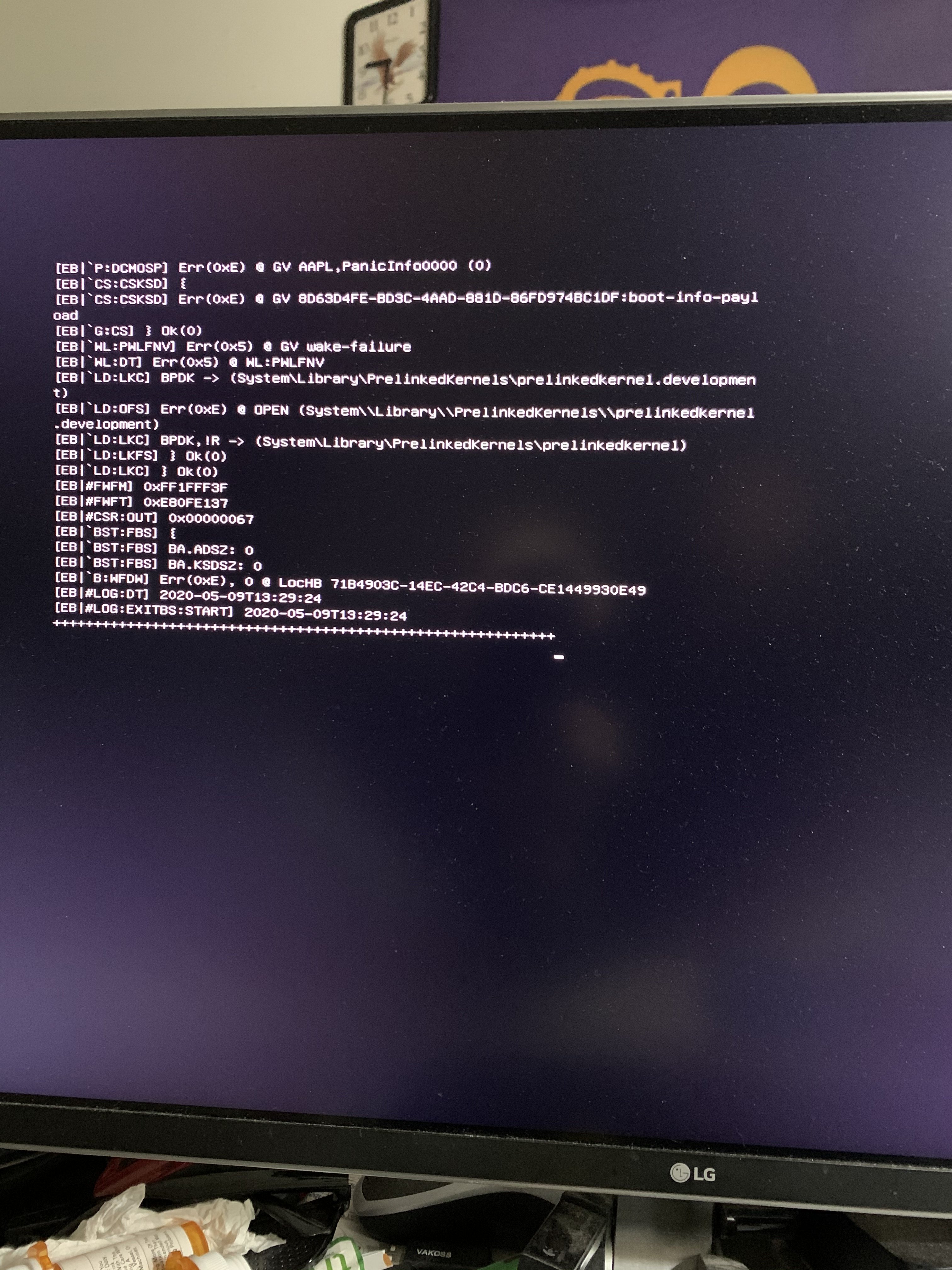

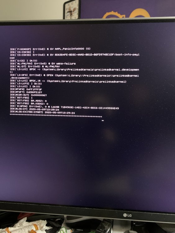

jmacie Posted May 9, 2020 Share Posted May 9, 2020 (edited) I have waited over a month to update to 10.15.4. I failed a month ago and am continuing to fail now. I have been web searching this last month, but this problem is persistent. I know this isn't a kernal and kext patch, but I've depended on your guys X99 patches for a couple of years. The error I get is : Stuck at [EB]#LOG:EXITBS:START]. I'm on Clover 5116, but I've tried 5112 etc and no go. I tried a fresh 10.15.4 usb install too. I appreciate any possible help. Sincerely johnm Edited May 9, 2020 by jmacie Link to comment https://www.insanelymac.com/forum/topic/335650-kernelandkextpatches-1013x1014x1015x-x99x299/page/7/#findComment-2721609 Share on other sites More sharing options...
vector sigma Posted May 9, 2020 Share Posted May 9, 2020 (edited) 20 hours ago, jmacie said: I have waited over a month to update to 10.15.4. I failed a month ago and am continuing to fail now. I have been web searching this last month, but this problem is persistent. I know this isn't a kernal and kext patch, but I've depended on your guys X99 patches for a couple of years. The error I get is : Stuck at [EB]#LOG:EXITBS:START]. I'm on Clover 5116, but I've tried 5112 etc and no go. I tried a fresh 10.15.4 usb install too. I appreciate any possible help. Sincerely johnm You have the kernel debugging turned on. Check nvram arguments (or ones in the config.plist?) and clean anything related to debugging like "debug=0x44 kcsuffix=development” if any, in short: sudo nvram -d boot-args and readd any needed bootArgs (but I guess you already have them in the config.plist?) then try with: sudo rm -f /System/Library/PrelinkedKernels/prelinkedkernel.de* then sudo kextcache -invalidate / then sudo touch /System/Library/Extensions && sudo kextcache -u / reboot and see if something changed. Edited May 10, 2020 by vector sigma 2 Link to comment https://www.insanelymac.com/forum/topic/335650-kernelandkextpatches-1013x1014x1015x-x99x299/page/7/#findComment-2721633 Share on other sites More sharing options...
jmacie Posted May 9, 2020 Share Posted May 9, 2020 (edited) Bless vector sigma, i appreciate everything, will get on this asap, johnm @vector sigma , I tried these commands and rebooted not working, but I'll try again later. I do appreciate you helping, johnm Edited May 9, 2020 by jmacie Link to comment https://www.insanelymac.com/forum/topic/335650-kernelandkextpatches-1013x1014x1015x-x99x299/page/7/#findComment-2721641 Share on other sites More sharing options...

latze Posted May 12, 2020 Share Posted May 12, 2020 In the quest for achieving good CPU performance with XCPM while maintaining the power saving to a good level I played a little with the frequency vectors in the past days. I managed to achieve similar results with the one I was getting when I was using the performance patch but still hitting low frequency. So right now I am currently running with the new clover that @vector sigma provided with just the kernelXCPM option enabled and the CPUFriend kext with the generated CPUFriendDataProvider kext attached for whom wants to try it. Tested with iMacPro1,1 SMBIOS on i7 5820K . CPUFriend.kext.zip CPUFriendDataProvider.kext.zip Link to comment https://www.insanelymac.com/forum/topic/335650-kernelandkextpatches-1013x1014x1015x-x99x299/page/7/#findComment-2722189 Share on other sites More sharing options...
