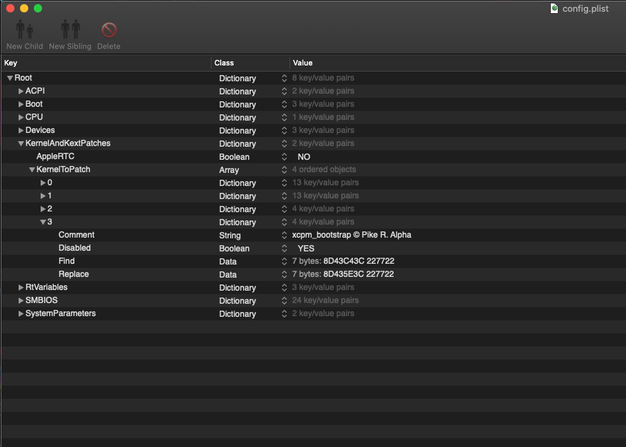

nmano Posted December 20, 2019 Author Share Posted December 20, 2019 (edited) Test This for 10.15.3 Beta1 xcpm_bootstrap © Pike RAlpha By N.Mano 10.15.X Find 8D43C43C 227722 Replace 8D43C13C 227722 xcpm_core_scope_msrs © Pike R. Alpha By N.Mano Find 31D2E8B4 5DFDFF Replace 31D29090 909090 xcpm_pkg_scope_msrs (c) Pike R. Alpha By N.Mano Find 31D2E848 FDFFFF Replace 31D29090 909090 _xcpm_SMT_scope_msrs #1 (c) Pike R. Alpha By N.Mano Find BE060000 005DE908 000000 Replace BE060000 005DC390 909090 _xcpm_SMT_scope_msrs #2 (c) Pike R. Alpha By N.Mano Find 31D2E825 FDFFFF Replace 31D29090 909090 Edited December 20, 2019 by nmano 2 Link to comment https://www.insanelymac.com/forum/topic/335650-kernelandkextpatches-1013x1014x1015x-x99x299/page/3/#findComment-2701250 Share on other sites More sharing options...

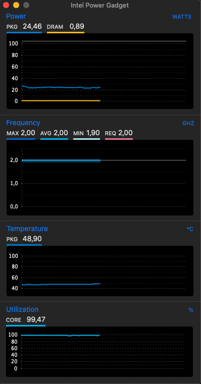

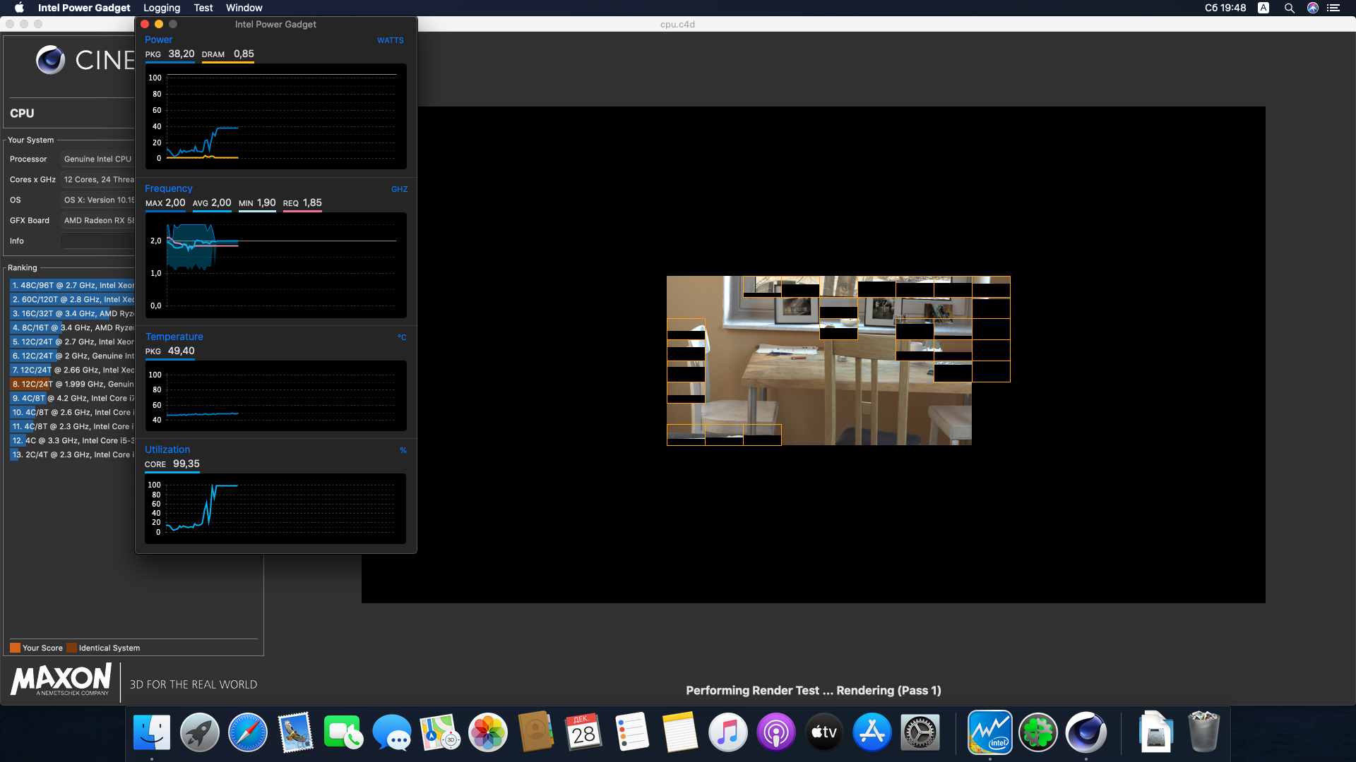

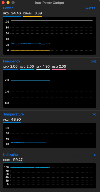

goxaniguana Posted December 28, 2019 Share Posted December 28, 2019 Hi, I have a small problem... Very strange xcpm working On first screenshot freq stuck at 2 ghz on second (KernelPM, KernelXCPM enabled in clover) freq max 2ghz too, but where my turbo boost in both options sleep working perfectly Specs: Asrock x99 extreme 4 xeon e5 2658v3 es Aorus rx 580 CLOVER 2.zip Link to comment https://www.insanelymac.com/forum/topic/335650-kernelandkextpatches-1013x1014x1015x-x99x299/page/3/#findComment-2702011 Share on other sites More sharing options...

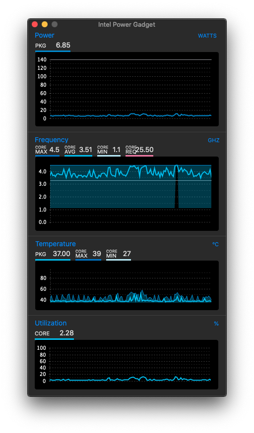

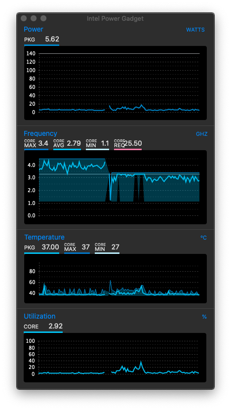

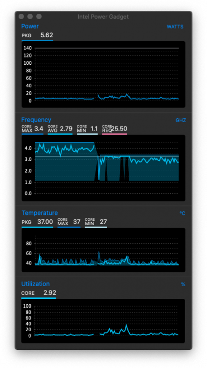

Jasper Levi Posted January 23, 2020 Share Posted January 23, 2020 I am using the patches for 10.15.2 but I am facing this really weird problem, that my CPU reverts to its regular frequency after sleep-wake. So, my i7 5820K, which I have overclocked to 4.5 GHz at a 100MHz BCLK (see fresh-boot.png), comes back to its top speed of 3.3GHZ (see attached sleepwake.png showing CPU frequencies, before and after a sleep-wake). Any idea what could be causing this? Am attaching my EFI folder for inspection. My config is: CPU Intel i7 5820K Motherboard: Gigabyte X99 UD4 Graphics: Sapphire Radeon RX5700 XT 8GB RAM: 32GB 2400 Corsair Vengence LPX DDR4 SSD: Samsung EVO 256GB Power Supply: Corsair RM750 CPU Cooler: CoolerMaster MasterLiquid ML240L RGB Thanks jasperlevi-EFI.zip Link to comment https://www.insanelymac.com/forum/topic/335650-kernelandkextpatches-1013x1014x1015x-x99x299/page/3/#findComment-2705460 Share on other sites More sharing options...
lucke Posted January 27, 2020 Share Posted January 27, 2020 On 1/23/2020 at 7:39 PM, Jasper Levi said: I am using the patches for 10.15.2 but I am facing this really weird problem, that my CPU reverts to its regular frequency after sleep-wake. So, my i7 5820K, which I have overclocked to 4.5 GHz at a 100MHz BCLK (see fresh-boot.png), comes back to its top speed of 3.3GHZ (see attached sleepwake.png showing CPU frequencies, before and after a sleep-wake). Any idea what could be causing this? Am attaching my EFI folder for inspection. My config is: CPU Intel i7 5820K Motherboard: Gigabyte X99 UD4 Graphics: Sapphire Radeon RX5700 XT 8GB RAM: 32GB 2400 Corsair Vengence LPX DDR4 SSD: Samsung EVO 256GB Power Supply: Corsair RM750 CPU Cooler: CoolerMaster MasterLiquid ML240L RGB Thanks jasperlevi-EFI.zip Try this: https://www.google.it/amp/s/pikeralpha.wordpress.com/2017/01/12/debugging-sleep-issues/amp/ 1 Link to comment https://www.insanelymac.com/forum/topic/335650-kernelandkextpatches-1013x1014x1015x-x99x299/page/3/#findComment-2706030 Share on other sites More sharing options...
Jasper Levi Posted February 1, 2020 Share Posted February 1, 2020 On 1/28/2020 at 12:25 AM, lucke said: Try this: https://www.google.it/amp/s/pikeralpha.wordpress.com/2017/01/12/debugging-sleep-issues/amp/ Thanks. It wasn't this, though. I had this kext called 'RTCMemoryFixup.kext' in my EFI/Clover/kexts folder. Once I deleted that one, I am getting consistent performance before and after sleep. 1 Link to comment https://www.insanelymac.com/forum/topic/335650-kernelandkextpatches-1013x1014x1015x-x99x299/page/3/#findComment-2706607 Share on other sites More sharing options...
lucke Posted February 1, 2020 Share Posted February 1, 2020 4 hours ago, Jasper Levi said: Thanks. It wasn't this, though. I had this kext called 'RTCMemoryFixup.kext' in my EFI/Clover/kexts folder. Once I deleted that one, I am getting consistent performance before and after sleep. Perfect! 1 Link to comment https://www.insanelymac.com/forum/topic/335650-kernelandkextpatches-1013x1014x1015x-x99x299/page/3/#findComment-2706625 Share on other sites More sharing options...
