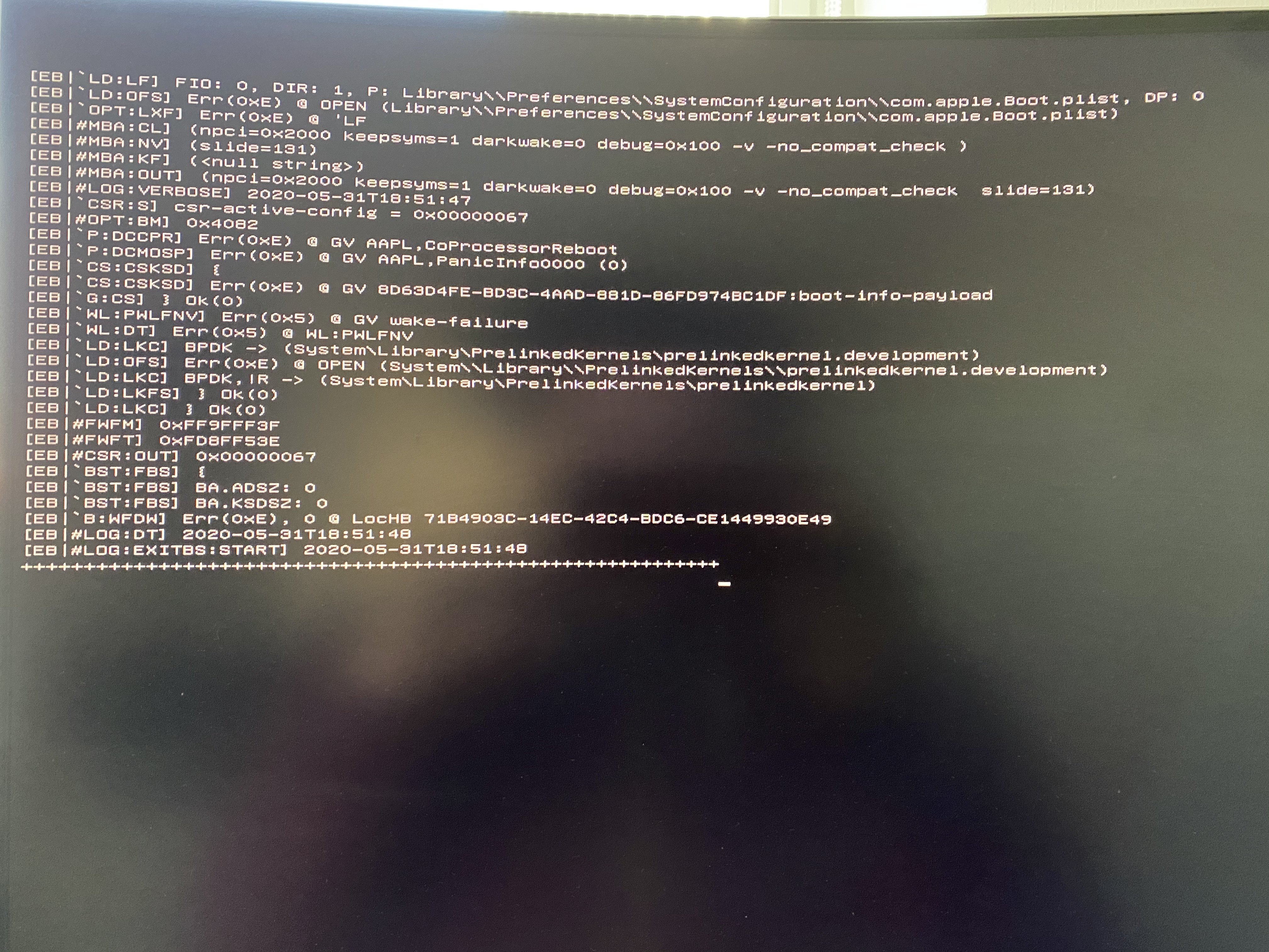

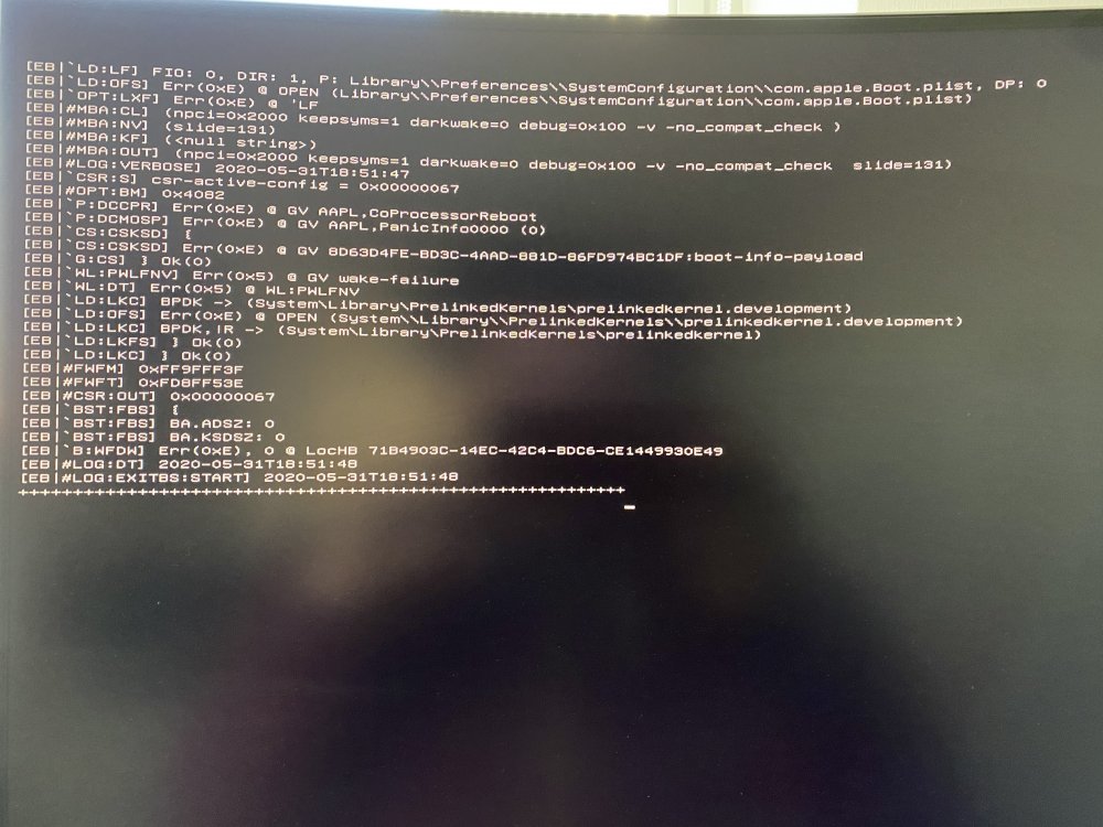

vanvasten Posted May 31, 2020 Share Posted May 31, 2020 Hi guys, im getting some wired thing implementing de bootstrap patch, after updating to 10.15.5, if I use the Original CPUID (0x0406F1) for my Broadwell-E Core i7 6950x it won't even get to boot process. I get stuck here (see image). But if I just change to FakeID it will boot, but of course without the proper power management. any ideas? the only error I can get from there is some boot-info-payload thanks Link to comment https://www.insanelymac.com/forum/topic/335650-kernelandkextpatches-1013x1014x1015x-x99x299/page/9/#findComment-2724457 Share on other sites More sharing options...

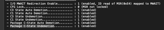

latze Posted June 18, 2020 Share Posted June 18, 2020 @olmirror I saw you still have the C6/C7_If=E2-Enabled=0x7E000403 BY N.Mano/Pike R. Alpha patch in OpenCore, with OpenCore I don't have any other patches for X99 xcpm. Do you have any idea what is this for, I cannot find a relevant reference. C6/C7 are for idle not for performance anyway. Also I saw you have a lot of replaces for SSDT, I don't use those anymore either, everything is in SSDT this way you don't affect Windows or other OS with those changes. Btw, did you try my OC config? Link to comment https://www.insanelymac.com/forum/topic/335650-kernelandkextpatches-1013x1014x1015x-x99x299/page/9/#findComment-2726029 Share on other sites More sharing options...
olmirror Posted June 19, 2020 Share Posted June 19, 2020 (edited) 18 hours ago, latze said: @olmirror I saw you still have the C6/C7_If=E2-Enabled=0x7E000403 BY N.Mano/Pike R. Alpha patch in OpenCore, with OpenCore I don't have any other patches for X99 xcpm. Do you have any idea what is this for, I cannot find a relevant reference. C6/C7 are for idle not for performance anyway. Also I saw you have a lot of replaces for SSDT, I don't use those anymore either, everything is in SSDT this way you don't affect Windows or other OS with those changes. Btw, did you try my OC config? I have this patch in my config in order to enable I/O MWAIT Redirection Enable, Package C-State Auto Demotion and Package C-State Undemotion. Without this patched these are not checked. Don't ask me how or why. Without the patch they are disabled. I did try your OC config, but it bricked the system, had to reset the CMOS. The ssdt's are obviously not for my system. But was curious nevertheless. I don't use OC to boot into windows, so these replacements for SSDT don't affect other OS's and are only used for OSX. 19 hours ago, latze said: Great, glad it was useful for you! I posted that before on this thread, btw . It is a custom vector made by me. You can edit the vectors using 010 editor and the frequencyVectors.bt included in the CPUFriend. I think for that one the trick is that it has the entry for lowest frequency maxed out but from what I remember the power consumption was still okay on idle, you can check it on IPG. I am not using it anymore as for me it works okay now with OpenCore and EIST disabled, I was using it when I was on Clover as for some reasons disabling EIST on Clover didn't have the same effect. You're right, frequency is high but power consumption not that high. Temperature is a hell of a lot mores stable than with PMDrvr. Just hard to understand what is keeping XCPM from functioning normally on my mb. The only thing I can come up with is that it is usb related. Once I forgot to enable my USB and with screensharing through my macbook, ran a benchmark. All scores were where they should be. With USB back on, 10-15% lower. Edited June 19, 2020 by olmirror Link to comment https://www.insanelymac.com/forum/topic/335650-kernelandkextpatches-1013x1014x1015x-x99x299/page/9/#findComment-2726070 Share on other sites More sharing options...
latze Posted June 22, 2020 Share Posted June 22, 2020 On 6/19/2020 at 1:46 PM, olmirror said: I have this patch in my config in order to enable I/O MWAIT Redirection Enable, Package C-State Auto Demotion and Package C-State Undemotion. Without this patched these are not checked. Don't ask me how or why. Without the patch they are disabled. I did try your OC config, but it bricked the system, had to reset the CMOS. The ssdt's are obviously not for my system. But was curious nevertheless. I don't use OC to boot into windows, so these replacements for SSDT don't affect other OS's and are only used for OSX. You're right, frequency is high but power consumption not that high. Temperature is a hell of a lot mores stable than with PMDrvr. Just hard to understand what is keeping XCPM from functioning normally on my mb. The only thing I can come up with is that it is usb related. Once I forgot to enable my USB and with screensharing through my macbook, ran a benchmark. All scores were where they should be. With USB back on, 10-15% lower. @olmirror Did you try/manage to reproduce the situation in which xcpm was working ( start without USB ). It is really strange for USB to have such effect. What do you mean my OC config bricked the system? Boot might freeze/panic but it should have a permanent impact. What happened more exactly? Link to comment https://www.insanelymac.com/forum/topic/335650-kernelandkextpatches-1013x1014x1015x-x99x299/page/9/#findComment-2726225 Share on other sites More sharing options...

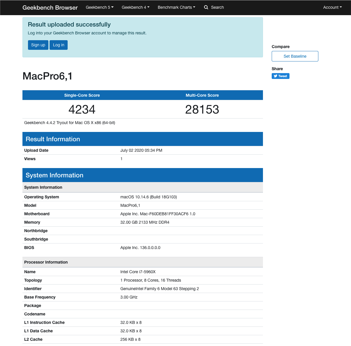

rkelleyrtp1 Posted July 1, 2020 Share Posted July 1, 2020 (edited) Hoping someone can help me out. I also have a gigabyte X99-UD4 board with the 5960x CPU (no overclock) running Mojave 10.14.6 with Clover 5119. All is working well except the performance. I have read through the pages in this topic and am still struggling to get a system with proper idle speed with high-end performance. When I enable the xcpm patches per the first post, the Geekbench 4 scores are as expected when compared to Linux (4163/28000), however, the system idles at 3GHz. Without the xcpm patches, my Geekbench 4 scores are low (4059/21628), but the system idles around 2.2GHz. I must have overlooked something in the config.plist file, but I can't find it. Can someone please review my EFI zip file and let me know where I am going wrong? The BIOS power management stuff is set to all defaults (enable EIST, C-States, P-states, Hyperthreading, etc). My goal is to get the system idling around 1.7GHz but still be able to get higher Geekbench 4 scores. I have spent the last three days working through all the variables, and I am still having issues. Thanks for any help you can provide! rkelleyrtp_clover_x99.zip Edited July 2, 2020 by rkelleyrtp1 Link to comment https://www.insanelymac.com/forum/topic/335650-kernelandkextpatches-1013x1014x1015x-x99x299/page/9/#findComment-2728255 Share on other sites More sharing options...
olmirror Posted July 2, 2020 Share Posted July 2, 2020 17 hours ago, rkelleyrtp1 said: Hoping someone can help me out. I also have a gigabyte X99-UD4 board with the 5960x CPU (no overclock) running Mojave 10.14.6 with Clover 5119. All is working well except the performance. I have read through the pages in this topic and am still struggling to get a system with proper idle speed with high-end performance. When I enable the xcpm patches per the first post, the Geekbench 4 scores are as expected when compared to Linux (4163/28000), however, the system idles at 3GHz. Without the xcpm patches, my Geekbench 4 scores are low (4059/21628), but the system idles around 2.2GHz. I must have overlooked something in the config.plist file, but I can't find it. Can someone please review my EFI zip file and let me know where I am going wrong? The BIOS power management stuff is set to all defaults (enable EIST, C-States, P-states, Hyperthreading, etc). My goal is to get the system idling around 1.7GHz but still be able to get higher Geekbench 4 scores. I have spent the last three days working through all the variables, and I am still having issues. Thanks for any help you can provide! rkelleyrtp_clover_x99.zip Try this. You need to insert your info again into the SMBIOS page and set up your gpu. I don't know which one is in your system. Try with and without PMDrvr.kext. My system runs faster with it. Seems like it's something related to our system. Anyway, this clover setup worked for me before I switched to opencore. Hope it helps you on your way somewhat. Good luck. CLOVER.zip Link to comment https://www.insanelymac.com/forum/topic/335650-kernelandkextpatches-1013x1014x1015x-x99x299/page/9/#findComment-2728340 Share on other sites More sharing options...
rkelleyrtp1 Posted July 2, 2020 Share Posted July 2, 2020 2 hours ago, olmirror said: Try this. You need to insert your info again into the SMBIOS page and set up your gpu. I don't know which one is in your system. Try with and without PMDrvr.kext. My system runs faster with it. Seems like it's something related to our system. Anyway, this clover setup worked for me before I switched to opencore. Hope it helps you on your way somewhat. Good luck. CLOVER.zip Thanks so much! I tried your configuration - both with the PMDrv.kext and without, and here are my results: With the driver loaded, I was getting max performance from GeekBench and the CPU frequencies (via Intel Power Gadget) were averaging 1.2GHz. Fantastic! The only issue was the CPU Power was averaging about 18Watts (should have been around 7-8Watts). Without the driver loaded, I was getting max performance, but the CPUs were always running 100% (again, via the Intel Power Gadget). As a quick test, I used my previous clover config (per the attachment in my first post) together with the PMDrv.kext. BAM! Perfect system! GeekBench was showing ~4200/28000. Plus all existing functionality (sleep, audio, network, etc) still work. For now, I am very happy. Thanks Again!!! As an aside, have you switched to OpenCore? If so, is your system running well? I am curious to see if OpenCore will provide any benefits over Clover. Link to comment https://www.insanelymac.com/forum/topic/335650-kernelandkextpatches-1013x1014x1015x-x99x299/page/9/#findComment-2728364 Share on other sites More sharing options...
