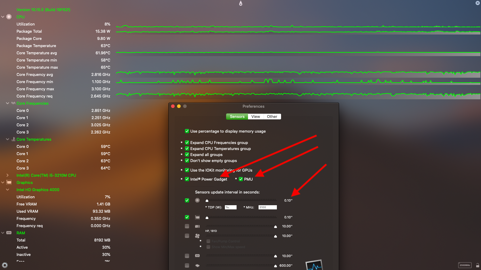

vector sigma Posted April 30, 2020 Share Posted April 30, 2020 (edited) 4 hours ago, latze said: It doesn't work optimal though, if you check some videos with benchmark running on mac pro with intel power gadget running you'll see that under load the req stays at maximum. For us it doesn't happen so there must be something missing that affects that. please make a screenshot with HWMonitorSMC2.app in full screen with these settings: to enable charts right click on each cpu sensor and press on . launch a benchmark and make the screen shot. P.S. after enabling intel power gadget and pmu the app needs a restart. Edited April 30, 2020 by vector sigma 1 Link to comment https://www.insanelymac.com/forum/topic/335650-kernelandkextpatches-1013x1014x1015x-x99x299/page/6/#findComment-2720166 Share on other sites More sharing options...

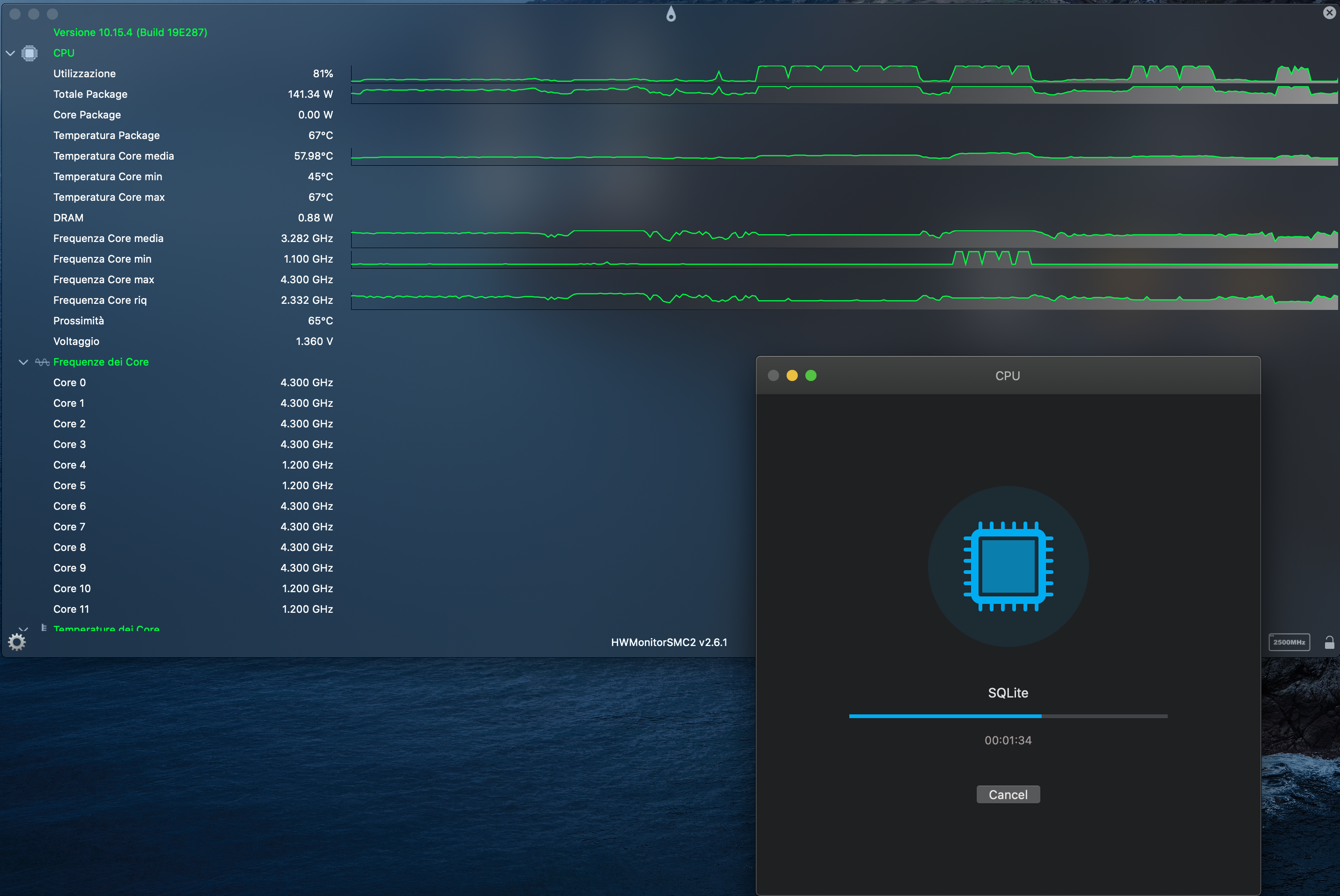

lucke Posted April 30, 2020 Share Posted April 30, 2020 8 hours ago, vector sigma said: please make a screenshot with HWMonitorSMC2.app in full screen with these settings: to enable charts right click on each cpu sensor and press on . launch a benchmark and make the screen shot. P.S. after enabling intel power gadget and pmu the app needs a restart. I have decided to give my help... Link to comment https://www.insanelymac.com/forum/topic/335650-kernelandkextpatches-1013x1014x1015x-x99x299/page/6/#findComment-2720275 Share on other sites More sharing options...
vector sigma Posted April 30, 2020 Share Posted April 30, 2020 Thanks @lucke, I realized only now you are Italinan, ciao ! If you look at the "Frequency core avg" (media) and requested one by OS, Frequency core req ("riq" as requested in Intalian) both charts are very similar indicating that the CPU really follow the request of the OS. Also I see cores do their job reaching 4.3 GHz from 1.1 GHz. What is wrong? 1 Link to comment https://www.insanelymac.com/forum/topic/335650-kernelandkextpatches-1013x1014x1015x-x99x299/page/6/#findComment-2720281 Share on other sites More sharing options...

lucke Posted April 30, 2020 Share Posted April 30, 2020 (edited) 3 hours ago, vector sigma said: Thanks @lucke, I realized only now you are Italinan, ciao ! If you look at the "Frequency core avg" (media) and requested one by OS, Frequency core req ("riq" as requested in Intalian) both charts are very similar indicating that the CPU really follow the request of the OS. Also I see cores do their job reaching 4.3 GHz from 1.1 GHz. What is wrong? @vector sigma Ciao! I think there is nothing wrong, at least in the management of the frequencies and therefore of the processor load, now the visualization and the work of the single cores as the frequencies is correctly indicated at least in my case ... But I believe that "wrong" there is a loss of performance: the first image is with all the patches active before the update to "Clover xcpm": and this after (now) with or without pstate performance patch: It is clear that there is a loss of about 35% of the performances... Edited April 30, 2020 by lucke Link to comment https://www.insanelymac.com/forum/topic/335650-kernelandkextpatches-1013x1014x1015x-x99x299/page/6/#findComment-2720320 Share on other sites More sharing options...
