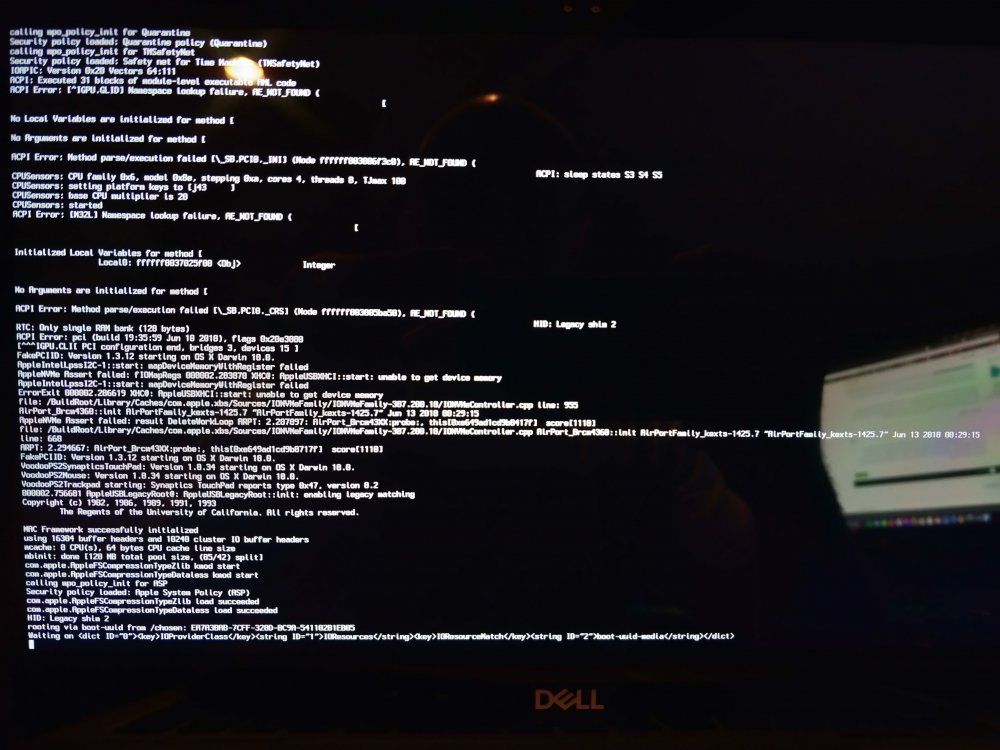

This is what i get when i boot with the attached DSDT-VID.aml. Then i get the famous stop sign lol. This thing is really being a pain...
Yeah, that's a step in the wrong direction.  ACPI error.  Never got to the video drivers.

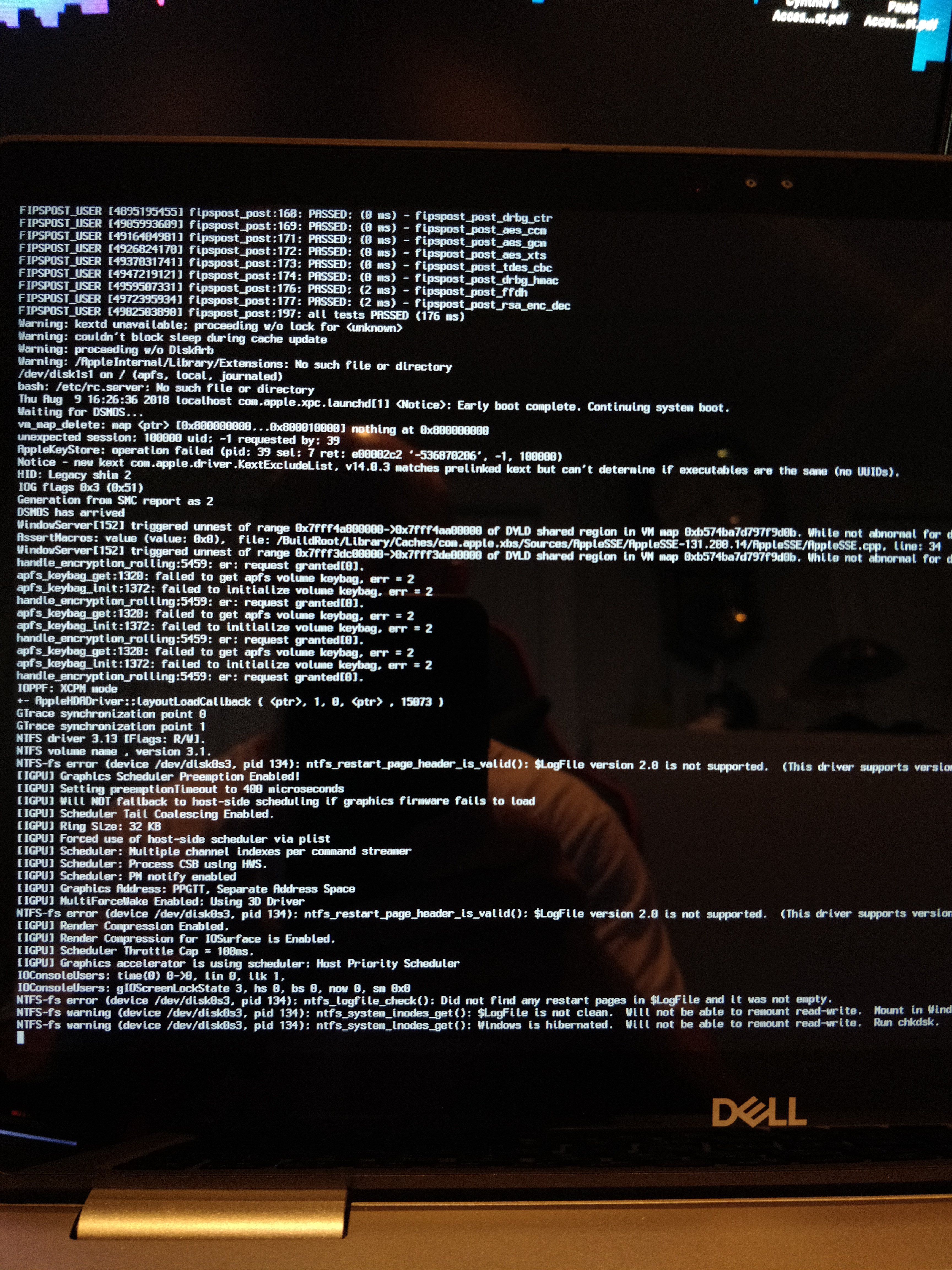

Thanks man. I appreciate the help. But, its still locking at the same spot. Replaced EFI. Cleared all caches and prelinked kernel. Attached is where it locks at..

Yes in previous attempts. Its a single 512GB NVMe drive. It dual partitioned currently with Windows 10 and Mojave DP5. But in other attempts ive wiped the entire drive and formatted for only mac. And installed only mac. I still always get locked at the same place. IOScreenLockState. I was using the new WhateverGreen and Lilu Kext and Modifications to Clover/Devices/Properties process. It allowed for a "smoother" experience WITHOUT QE/CI when booted. But i have never been able to get Acceleration with my internal monitor. Only with an external monitor hooked up via the hdmi port using 0x59120000 PlatfromID.. Laptop monitor goes black.

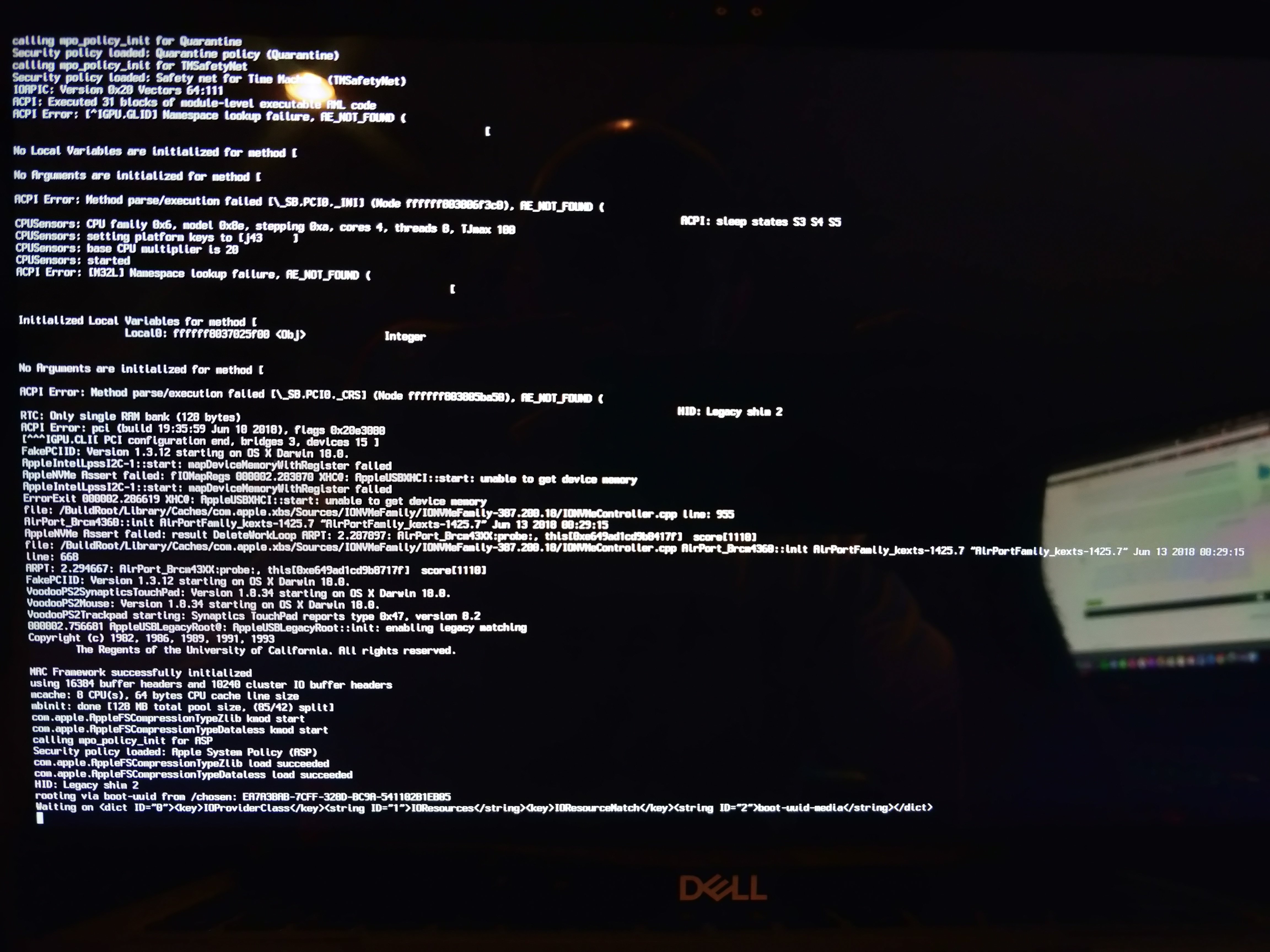

Tried attached EFI. Just getting the stop sign when trying to boot. Loads for about 20 seconds then stop sign.
