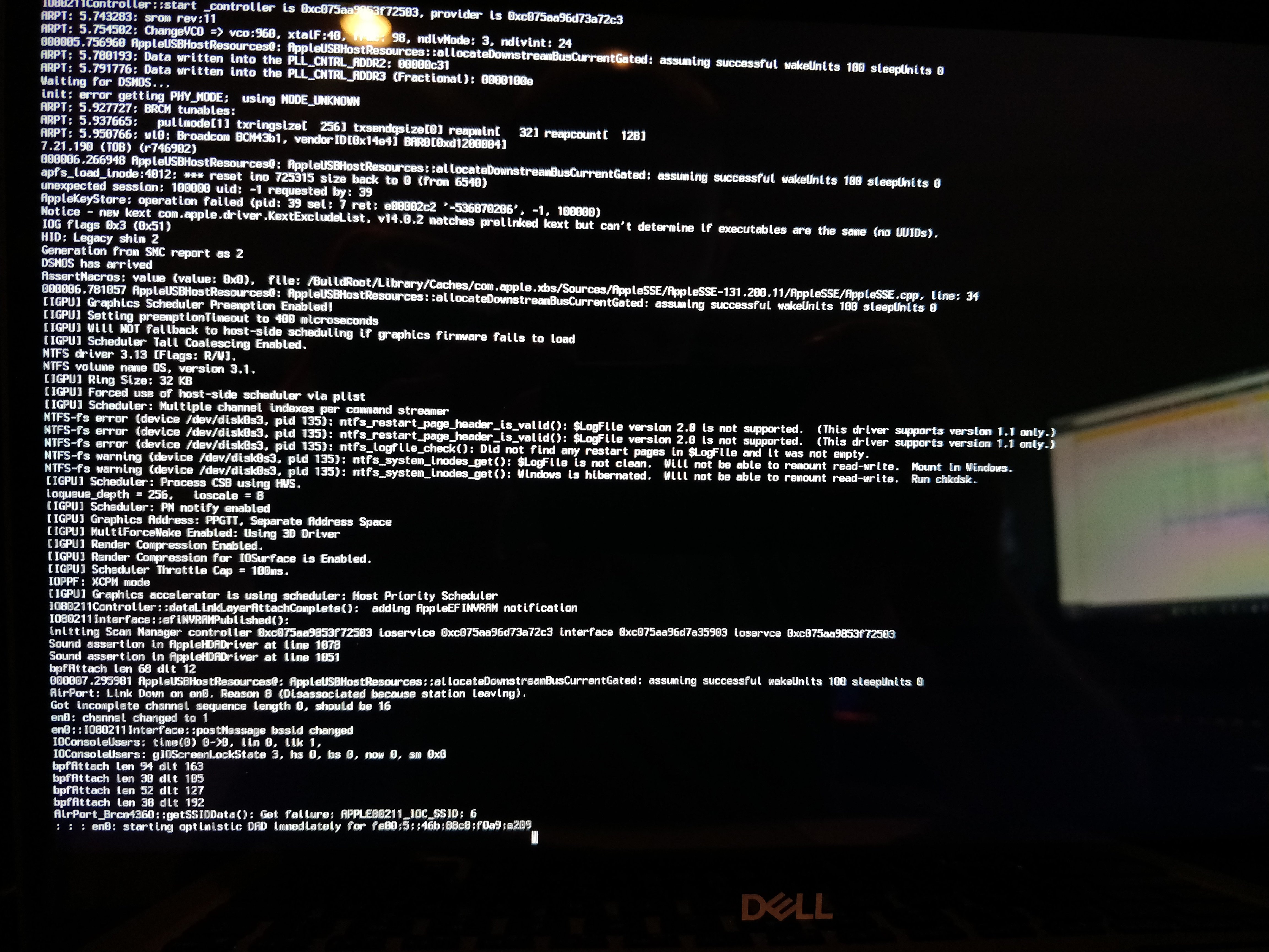

Sniki Posted July 8, 2018 Share Posted July 8, 2018 4 minutes ago, tikizondo94 said: This is with or without "MinStolenSize" Patch enabled/disabled. Still that same "NTFS" error.. You have an error with your NTFS Partition or vice versa Link to comment Share on other sites More sharing options...
tikizondo94 Posted July 8, 2018 Author Share Posted July 8, 2018 Just now, "Sniki" said: You have an error with your NTFS Partition or vice versa Im using GUID partition table. Partitioned for NTFS for windows on the first partition and MacOS Extended Journaled/APFS for the second for Mac. Single 512GB Samsung NVMe drive. Any ideas? Link to comment Share on other sites More sharing options...

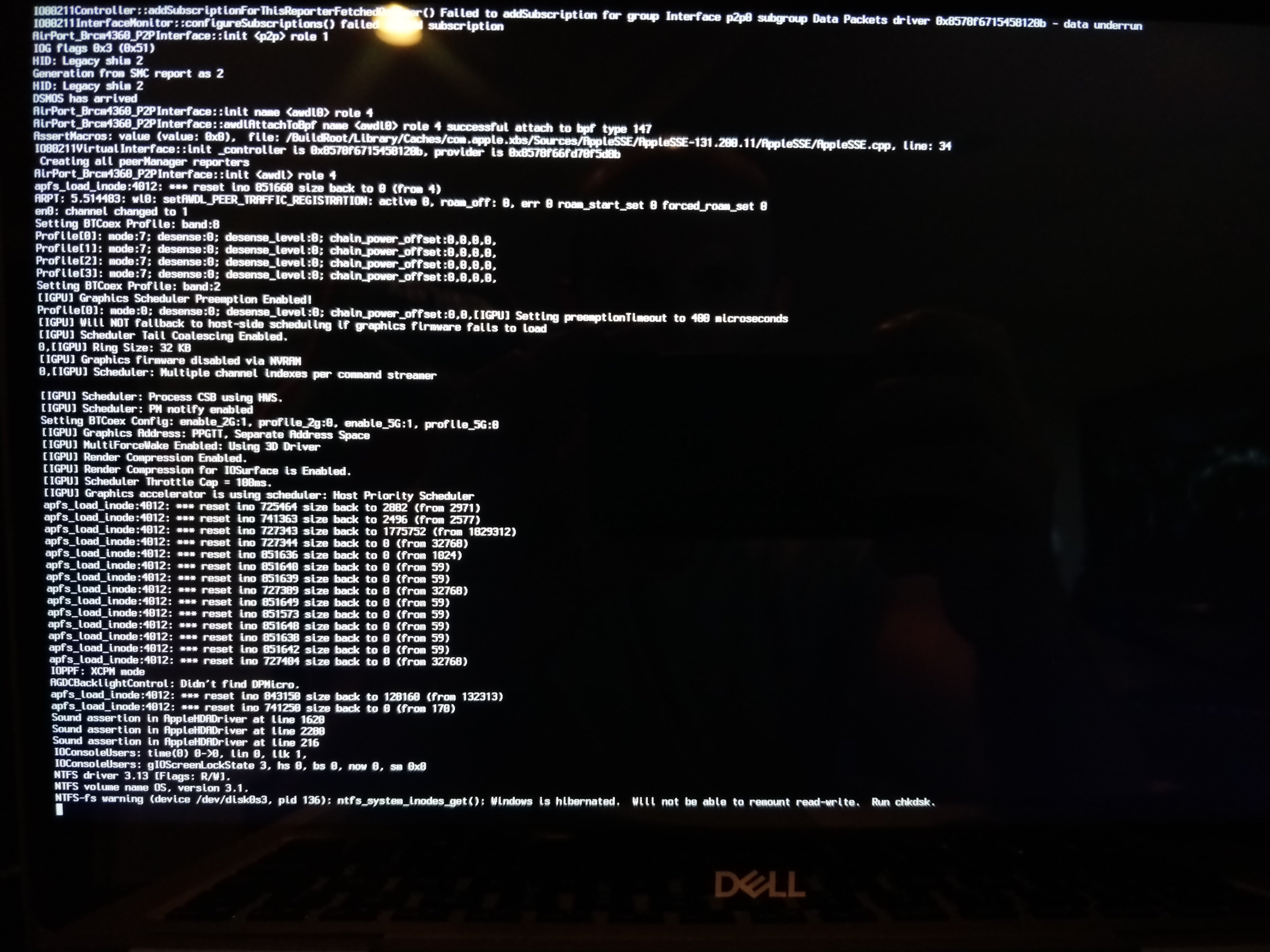

tikizondo94 Posted July 8, 2018 Author Share Posted July 8, 2018 1 hour ago, "Sniki" said: You have an error with your NTFS Partition or vice versa Heres my latest debug report if it helps at all. Still I've made no progress lol. debug_19882.zip Link to comment Share on other sites More sharing options...
mnfesq Posted July 8, 2018 Share Posted July 8, 2018 30 minutes ago, tikizondo94 said: Heres my latest debug report if it helps at all. Still I've made no progress lol. debug_19882.zip First of all, you DON'T have an NTFS problem. The problem is a few lines up on your boot log - Your video driver is not loading. It's been the exact same problem no matter what you have tried. You have done everything you can do based on the concept that you have only one GPU. I have checked your laptop's specs and, indeed, you do only have one GPU. However, your DSDT does not look like it. It has 2 GPU devices: GFX0, which you have renamed IGPU; and PEG0, which doesn't seem like it would belong in a computer with only 1 GPU. Normally, you would want to disable your PEG0 device (in my case an Nvidia GPU) but I don't know if you can do that since you don't actually have a 2nd physical GPU. Therefore, I'm thinking that maybe we should try removing the PEG0 device from your DSDT. However, there is also a PEG1 and PEG2 device and I don't really know what those do. For testing purposes, I have taken your DSDT and removed all of the PEG devices. Try it out and see if you can get your video driver to load. DSDT-NoPEG.aml.zip Link to comment Share on other sites More sharing options...
tikizondo94 Posted July 9, 2018 Author Share Posted July 9, 2018 22 hours ago, mnfesq said: First of all, you DON'T have an NTFS problem. The problem is a few lines up on your boot log - Your video driver is not loading. It's been the exact same problem no matter what you have tried. You have done everything you can do based on the concept that you have only one GPU. I have checked your laptop's specs and, indeed, you do only have one GPU. However, your DSDT does not look like it. It has 2 GPU devices: GFX0, which you have renamed IGPU; and PEG0, which doesn't seem like it would belong in a computer with only 1 GPU. Normally, you would want to disable your PEG0 device (in my case an Nvidia GPU) but I don't know if you can do that since you don't actually have a 2nd physical GPU. Therefore, I'm thinking that maybe we should try removing the PEG0 device from your DSDT. However, there is also a PEG1 and PEG2 device and I don't really know what those do. For testing purposes, I have taken your DSDT and removed all of the PEG devices. Try it out and see if you can get your video driver to load. DSDT-NoPEG.aml.zip Ive installed your latest DSDT-NoPEG in ACPI/Patched folder. Still seem to be getting stuck in a similar area. Ive attached my latest debug and verbose log. debug_15173.zip Link to comment Share on other sites More sharing options...

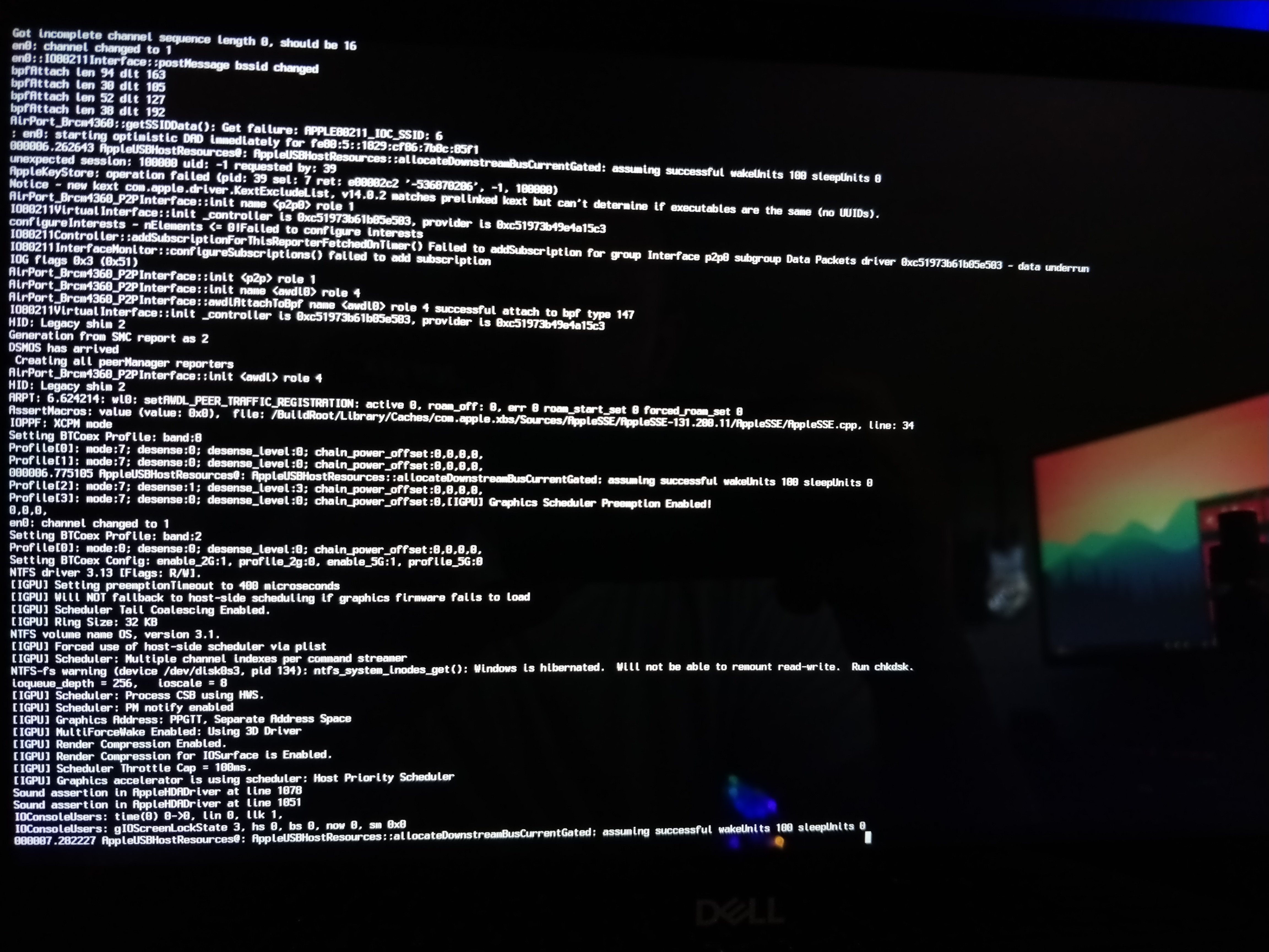

mnfesq Posted July 9, 2018 Share Posted July 9, 2018 3 minutes ago, tikizondo94 said: Ive installed your latest DSDT-NoPEG in ACPI/Patched folder. Still seem to be getting stuck in a similar area. Ive attached my latest debug and verbose log. debug_15173.zip Yeah, once you see those IOConsoleUsers entries, you know that the problem is a failure of the video drivers to load. Just to be sure, did you use the SSDT I made a while back with this DSDT? You still need that SSDT because it renames your GFX0 device in the SSDT to IGPU. If that wasn't the issue, I'm pretty sure that this is either a DSDT problem or a problem caused by a difference between what is really inside your laptop and what Dell tells you is inside it (including shared video memory.). I'm thinking that you may be better served by making a post in the DSDT section of the forum and seeking MaLd0n's help with your DSDT. Link to comment Share on other sites More sharing options...
tikizondo94 Posted July 9, 2018 Author Share Posted July 9, 2018 3 minutes ago, mnfesq said: Yeah, once you see those IOConsoleUsers entries, you know that the problem is a failure of the video drivers to load. Just to be sure, did you use the SSDT I made a while back with this DSDT? You still need that SSDT because it renames your GFX0 device in the SSDT to IGPU. If that wasn't the issue, I'm pretty sure that this is either a DSDT problem or a problem caused by a difference between what is really inside your laptop and what Dell tells you is inside it (including shared video memory.). I'm thinking that you may be better served by making a post in the DSDT section of the forum and seeking MaLd0n's help with your DSDT. Yeah i still used your SSDT you attached earlier. Originally maldon helped me with a custom DSDT for this machine. But it always ended up with the same error during boot. Attached is a DSDT edit he did for me. DSDT.aml.zip Link to comment Share on other sites More sharing options...

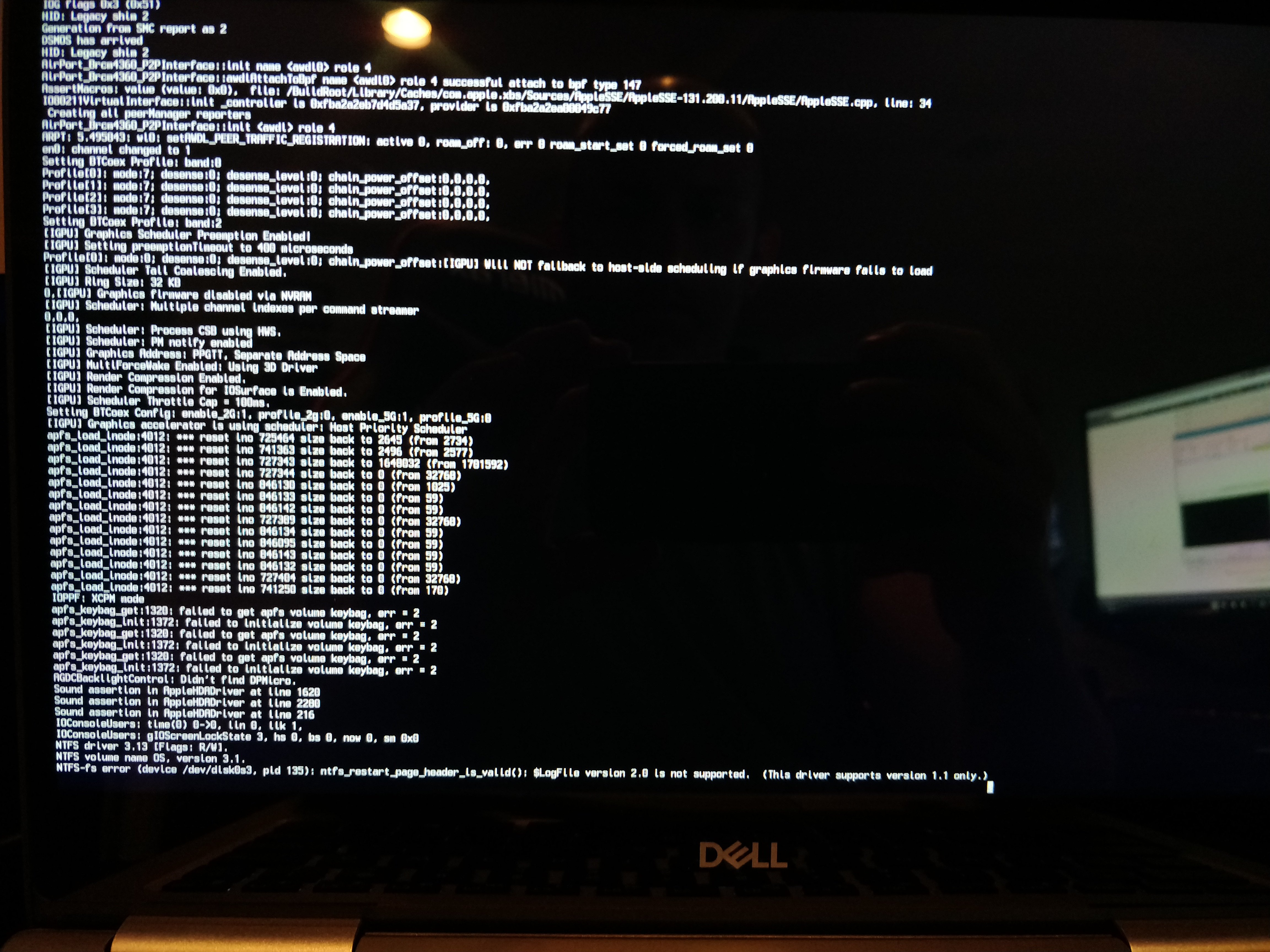

tikizondo94 Posted July 10, 2018 Author Share Posted July 10, 2018 10 hours ago, "Sniki" said: btw you should give a try to newer clover bootloaders as they fixed an issue with UHD 620 graphics https://github.com/Dids/clover-builder/releases v2.4k_r4587 Dids released this 7 days ago Assets 800 KB CLOVERX64.efi 12.8 MB Clover_v2.4k_r4587.pkg 68 Bytes Clover_v2.4k_r4587.pkg.md5 Source code (zip) Source code (tar.gz) fix that causes a hang on boot in 10.14 beta when using Kaby Lake-R UHD Graphics - sherlocks Just tried the new clover revision, "r4587". And im still hanging at the same place on boot. IOConsoleUsers: gIOScreenLockState 3, hs 0, bs 0, now 0, sm 0x0. rrrrrr.!! Link to comment Share on other sites More sharing options...
mnfesq Posted July 10, 2018 Share Posted July 10, 2018 6 hours ago, tikizondo94 said: Just tried the new clover revision, "r4587". And im still hanging at the same place on boot. IOConsoleUsers: gIOScreenLockState 3, hs 0, bs 0, now 0, sm 0x0. rrrrrr.!! Yeah, you already posted that you had the exact same issue with Mojave and High Sierra. I try to take a look at MaLd0n's DSDT later today. I doubt I can improve upon it but maybe something obvious will stick out. BTW, did you ever use his DSDT with the SSDT that renames your GFX0 to IGPU in that SSDT? Link to comment Share on other sites More sharing options...

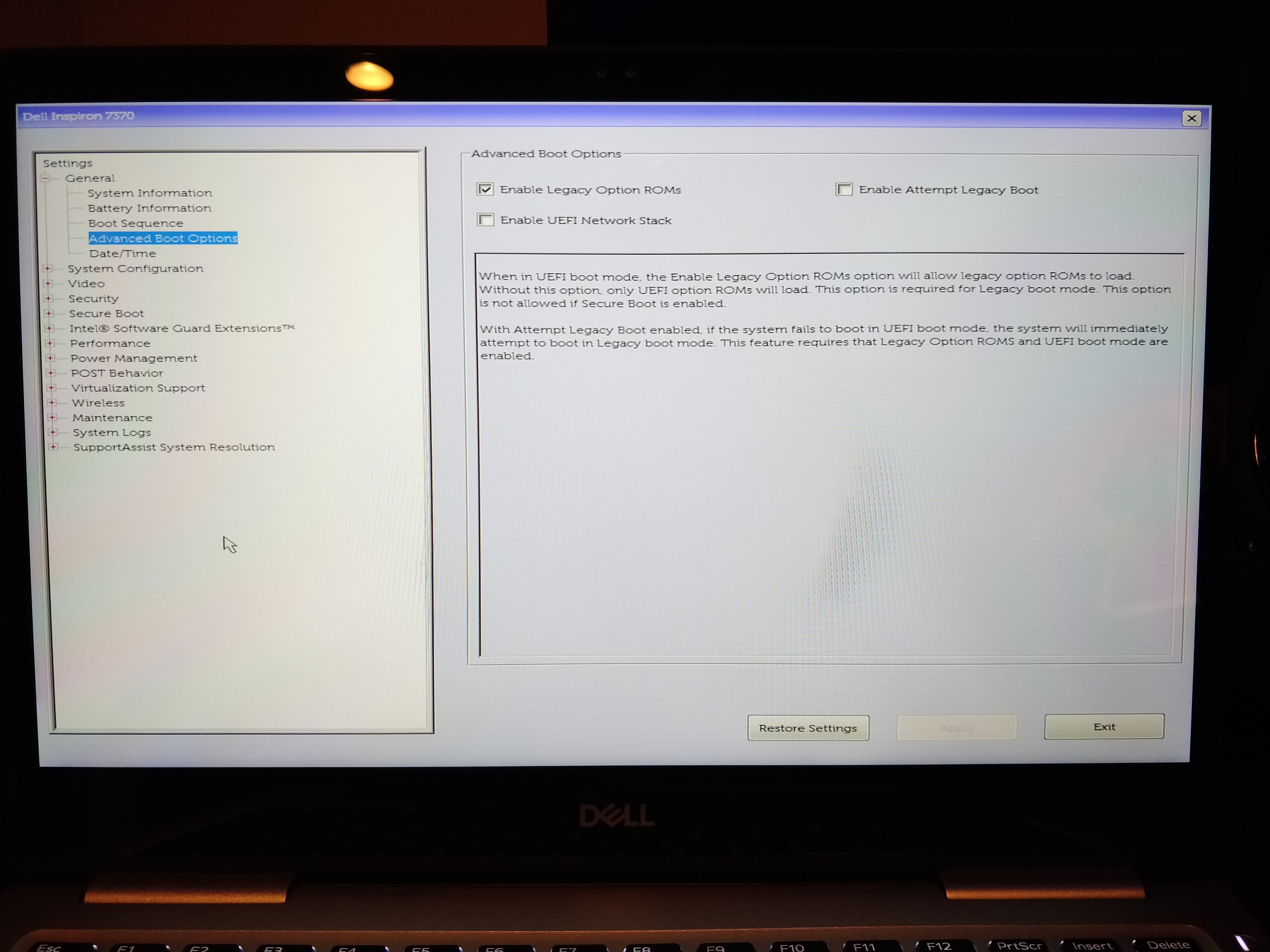

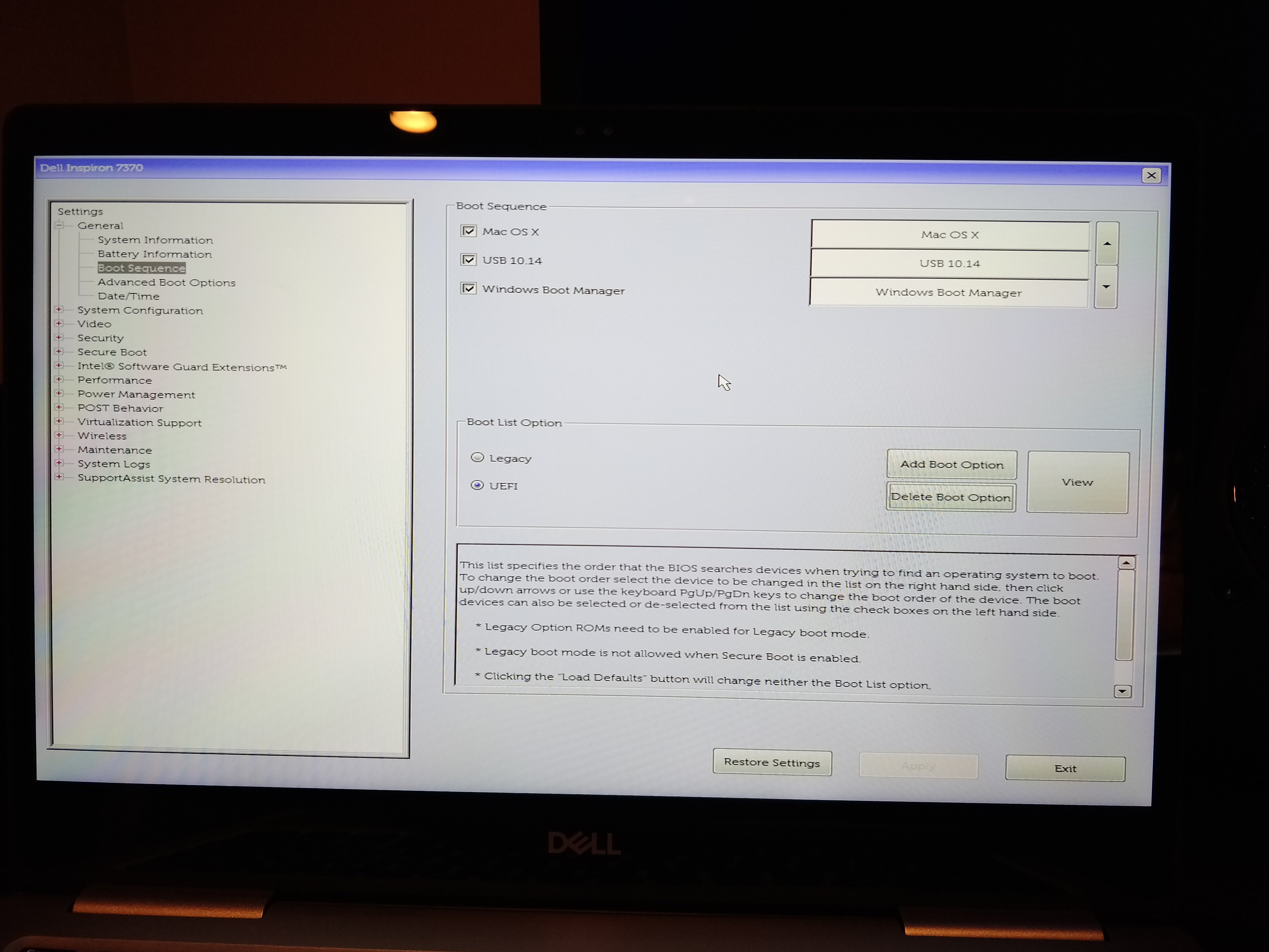

Sniki Posted July 10, 2018 Share Posted July 10, 2018 15 minutes ago, tikizondo94 said: Well i just tried Maldons DSDT and the SSDT you added for me in my Clover/ACPI/Patched. Still locking at the same point. Im completely lost now. I mean, what approach can i even take to find out whats causing the IGPU not to load? Try to take pictures of your bios pages (especially on the graphics sections) just to have a better understanding on what do you have there. Link to comment Share on other sites More sharing options...
tikizondo94 Posted July 10, 2018 Author Share Posted July 10, 2018 55 minutes ago, "Sniki" said: Try to take pictures of your bios pages (especially on the graphics sections) just to have a better understanding on what do you have there. Heres some pics of what im working with. https://drive.google.com/open?id=1liTLZWEzMQ5TykZmu9X7x_nCl1SoJfTu Link to comment Share on other sites More sharing options...
mnfesq Posted July 11, 2018 Share Posted July 11, 2018 (edited) 4 hours ago, tikizondo94 said: Heres some pics of what im working with. https://drive.google.com/open?id=1liTLZWEzMQ5TykZmu9X7x_nCl1SoJfTu OK, because we are running low on ideas, let me suggest this. The possibility still exists that, because you are booting to Clover and Windows from the same EFI directory, your custom DSDT and SSDT are not loading. Can you disable UEFI boot for testing purposes? Otherwise, try some of the changes you have been trying on a USB EFI partition and boot from the USB drive. When I first set up my laptop, I had problems with getting Clover to boot right until I made changes to my EFI settings using an app in Windows. (I'd have to boot into Windows to figure out what the app was that helped me boot to Clover instead of Windows Boot Manager). Also, what are your boot settings in BIOS? Edited July 11, 2018 by mnfesq Link to comment Share on other sites More sharing options...
tikizondo94 Posted July 11, 2018 Author Share Posted July 11, 2018 (edited) Here are my boot settings. Do you think i should try using clover in legacy mode? Or just try making changes on my USB installer and using it to boot? Edited July 11, 2018 by tikizondo94 Link to comment Share on other sites More sharing options...
mnfesq Posted July 11, 2018 Share Posted July 11, 2018 (edited) 8 hours ago, tikizondo94 said: Here are my boot settings. Do you think i should try using clover in legacy mode? Or just try making changes on my USB installer and using it to boot? I would try the USB first but whatever you choose to do, the goal here is to avoid the Windows Boot Manager so that you know for sure that your Clover Boot64.efi is what is booting for you. The DSDT, including the patched DSDT in ACPI/patched loads very early in the boot process. Also, try unchecking the Windows Boot Manager in your BIOS. If you are daring enough, you might even consider removing the Microsoft folder from your EFI partition (temporarily) to make it impossible to boot from anything but Clover. Again, these are sorta desperation moves but I'm really running out of ideas to figure out why your video drivers refuse to load. BTW, your Dell BIOS beats the hell out of my HP BIOS. I wish HP would make its laptop BIOS more configurable. Edited July 11, 2018 by mnfesq Link to comment Share on other sites More sharing options...

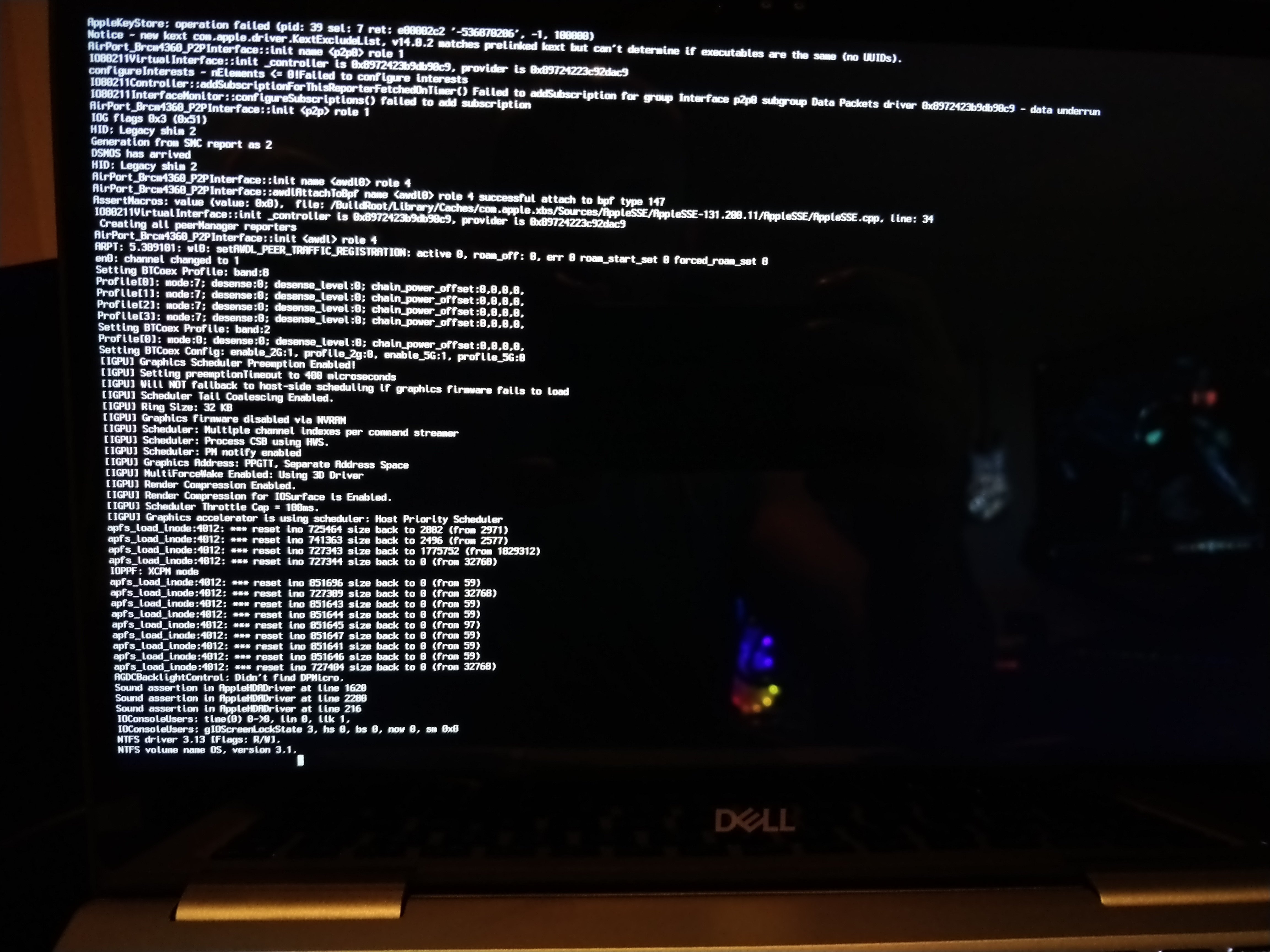

tikizondo94 Posted July 11, 2018 Author Share Posted July 11, 2018 2 hours ago, mnfesq said: I would try the USB first but whatever you choose to do, the goal here is to avoid the Windows Boot Manager so that you know for sure that your Clover Boot64.efi is what is booting for you. The DSDT, including the patched DSDT in ACPI/patched loads very early in the boot process. Also, try unchecking the Windows Boot Manager in your BIOS. If you are daring enough, you might even consider removing the Microsoft folder from your EFI partition (temporarily) to make it impossible to boot from anything but Clover. Again, these are sorta desperation moves but I'm really running out of ideas to figure out why your video drivers refuse to load. I BTW, your Dell BIOS beats the hell out of my HP BIOS. I wish HP would make its laptop BIOS more configurable. Well Ive started using my USB installer to boot from. Ive added Maldons DSDT and your SSDT to my ACPI/Patched folder. Using all the values from the Clover settings you sent earlier. And Still Im locking up in the same place. The GPU just won't load for some reason. Ive tried the MinStolen Patch disabled or enabled. It makes no difference. Im attaching a debug of my clover on my ESP and also a debug and bootlog from my USB installers EFI. Man I know Im wearing you out. lol. Im sorry about this. I really appreciate all your help. Send me Pauls-MacBook-Pro.zip USB Installer Bootlog.zip Link to comment Share on other sites More sharing options...
mnfesq Posted July 11, 2018 Share Posted July 11, 2018 2 hours ago, tikizondo94 said: Well Ive started using my USB installer to boot from. Ive added Maldons DSDT and your SSDT to my ACPI/Patched folder. Using all the values from the Clover settings you sent earlier. And Still Im locking up in the same place. The GPU just won't load for some reason. Ive tried the MinStolen Patch disabled or enabled. It makes no difference. Im attaching a debug of my clover on my ESP and also a debug and bootlog from my USB installers EFI. Man I know Im wearing you out. lol. Im sorry about this. I really appreciate all your help. Send me Pauls-MacBook-Pro.zip USB Installer Bootlog.zip I'll take a look at what you've uploaded as soon as time permits. In the meantime, if you have room to make a 40GB partition for OSX on your NVMe drive, I am wondering if you can get graphics acceleration with Yosemite. It was the last version that did not require me to disable my discrete GPU and did not have the IOConsoleUser entries when it booted. This might be too much work for a simple test but I'm wondering if it is only Apple's newer graphics kexts that are the culprit. Link to comment Share on other sites More sharing options...
