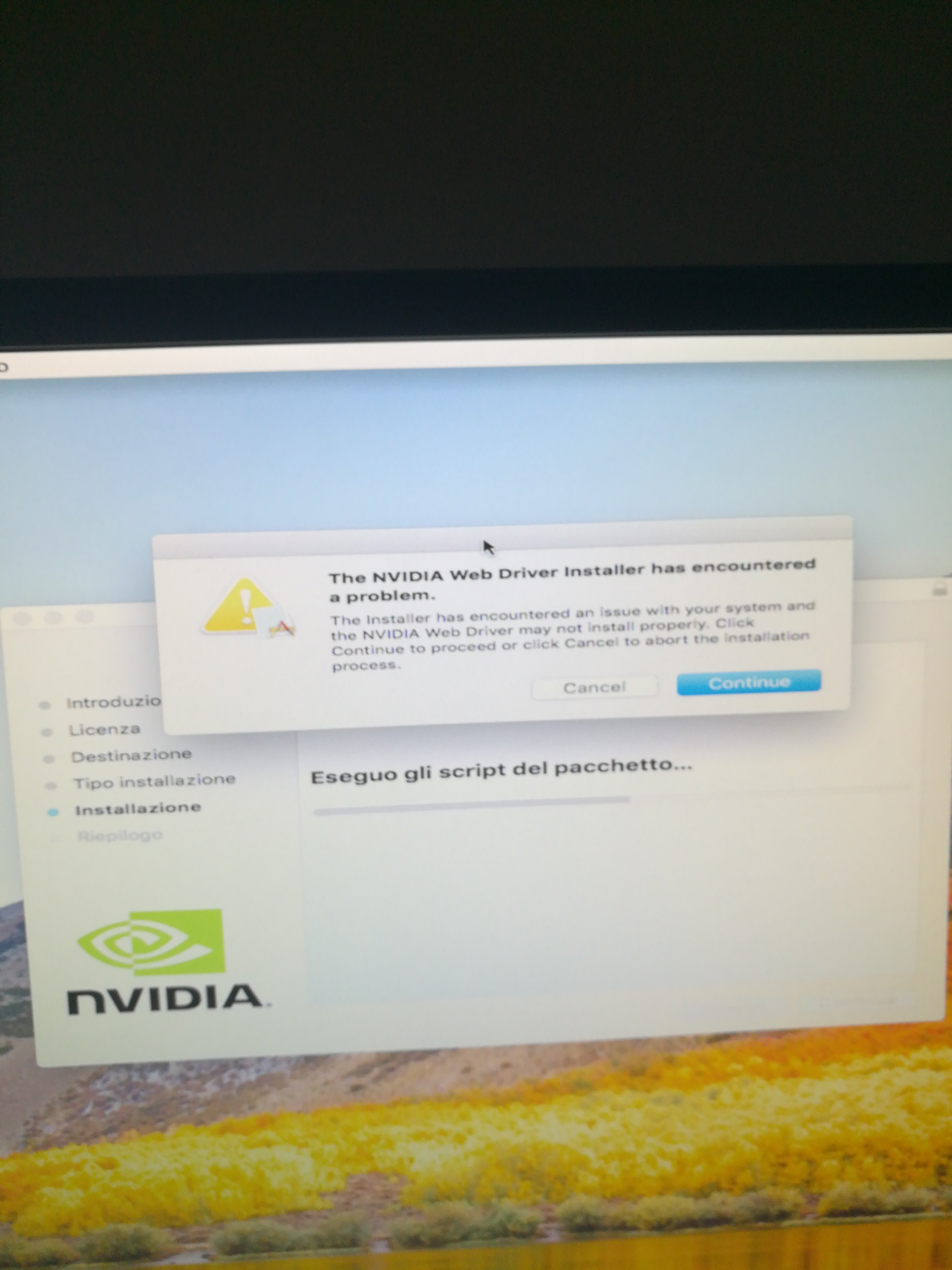

DangerNemesis Posted June 19, 2018 Author Share Posted June 19, 2018 Quando installo i driver nvidia mi da questo errore Link to comment https://www.insanelymac.com/forum/topic/334559-problema-installazione-mojave/page/5/#findComment-2620809 Share on other sites More sharing options...

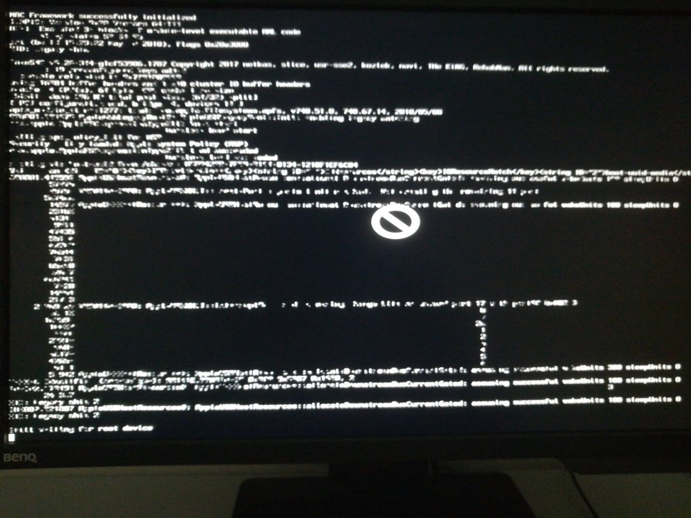

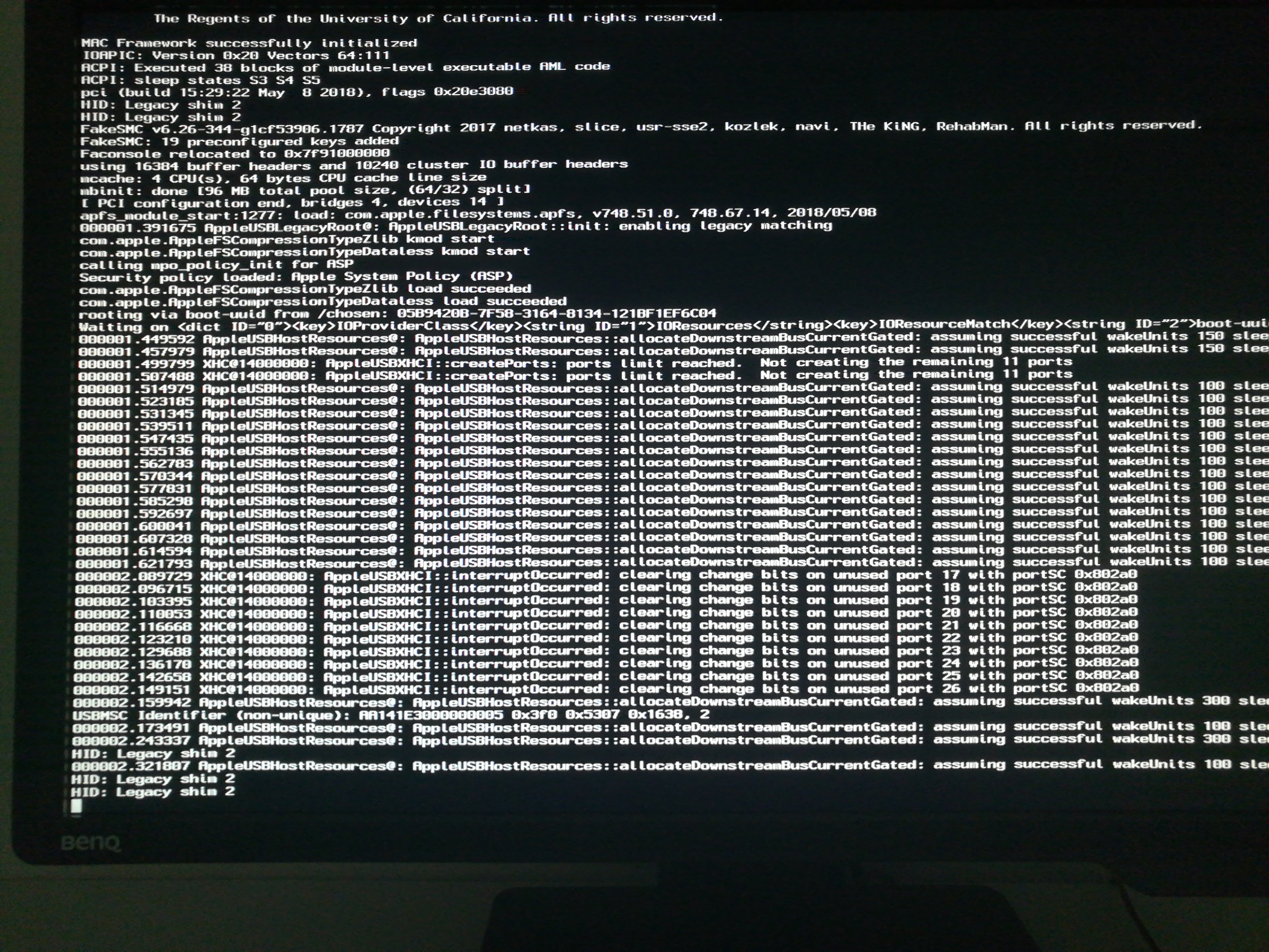

DangerNemesis Posted June 19, 2018 Author Share Posted June 19, 2018 (edited) Ho un problema con l'installazione.. appena arrivo alla scritta della lettura delle periferiche si blocca e dopo 3 minuti mi esce il segnale di blocco sullo schermo @gengik84 @iCanaro Edited June 19, 2018 by DangerNemesis Link to comment https://www.insanelymac.com/forum/topic/334559-problema-installazione-mojave/page/5/#findComment-2620846 Share on other sites More sharing options...
gengik84 Posted June 19, 2018 Share Posted June 19, 2018 fai foto al verbose Link to comment https://www.insanelymac.com/forum/topic/334559-problema-installazione-mojave/page/5/#findComment-2620848 Share on other sites More sharing options...

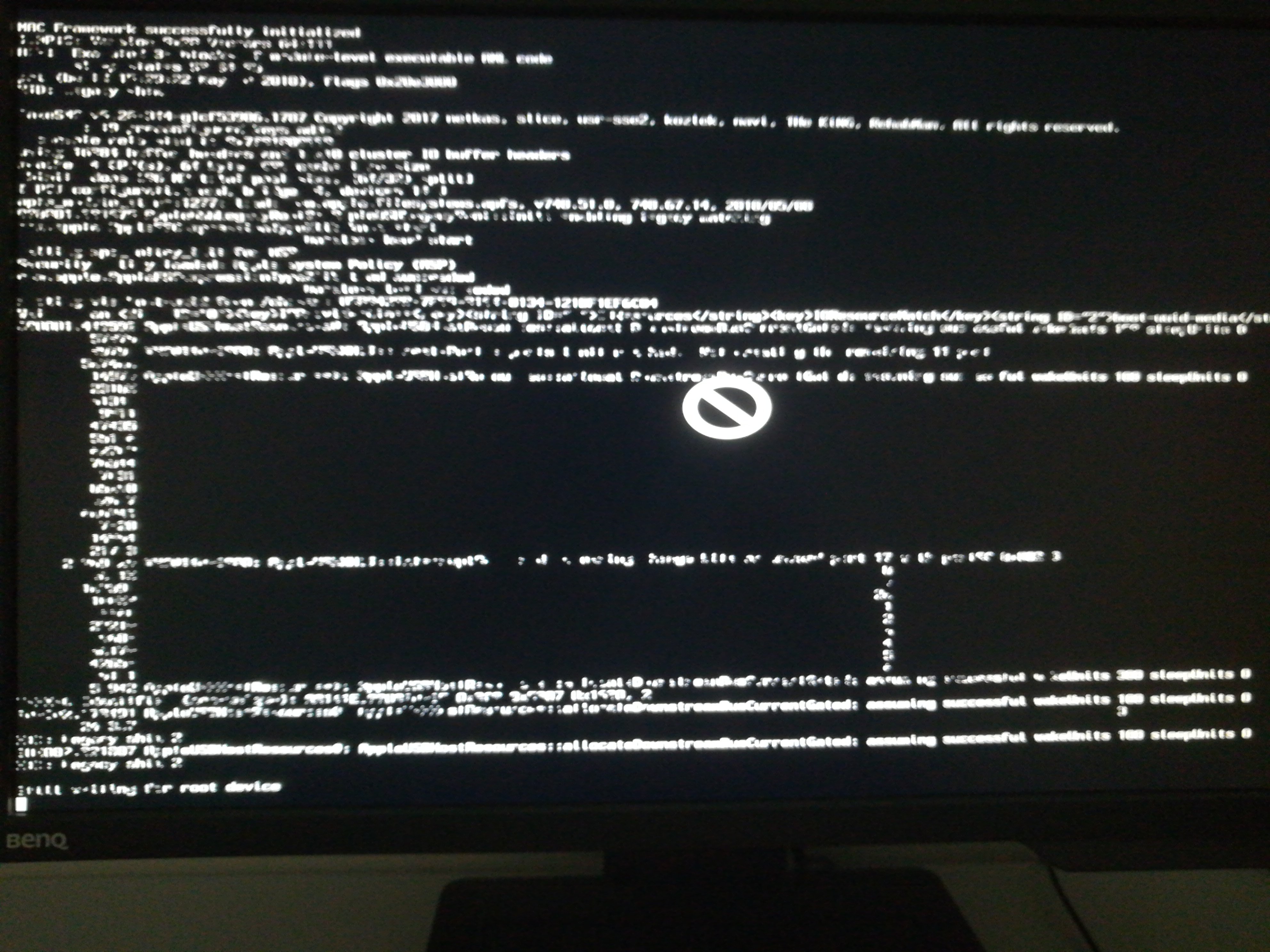

DangerNemesis Posted June 19, 2018 Author Share Posted June 19, 2018 (edited) Eccola..ti ricordo che ho usato la tua efi @gengik84 Edited June 19, 2018 by DangerNemesis Link to comment https://www.insanelymac.com/forum/topic/334559-problema-installazione-mojave/page/5/#findComment-2620850 Share on other sites More sharing options...
gengik84 Posted June 19, 2018 Share Posted June 19, 2018 Prova su altre porte USB.. Se non va.. Allega la efi Link to comment https://www.insanelymac.com/forum/topic/334559-problema-installazione-mojave/page/5/#findComment-2620855 Share on other sites More sharing options...
ITzTravelInTime Posted June 19, 2018 Share Posted June 19, 2018 (edited) 42 minutes ago, DangerNemesis said: Eccola..ti ricordo che ho usato la tua efi @gengik84 uno still waiting for root device, se stai avviando dalla chiavetta mettila in una porta usb 2 ed assicurati che vadano tutte le porte usb , questo errore vuol dire che mac os non riesce ad inizializzare o collegarsi correttamente al dispositivo da cui sta avviando Edited June 19, 2018 by ITzTravelInTime Link to comment https://www.insanelymac.com/forum/topic/334559-problema-installazione-mojave/page/5/#findComment-2620856 Share on other sites More sharing options...
