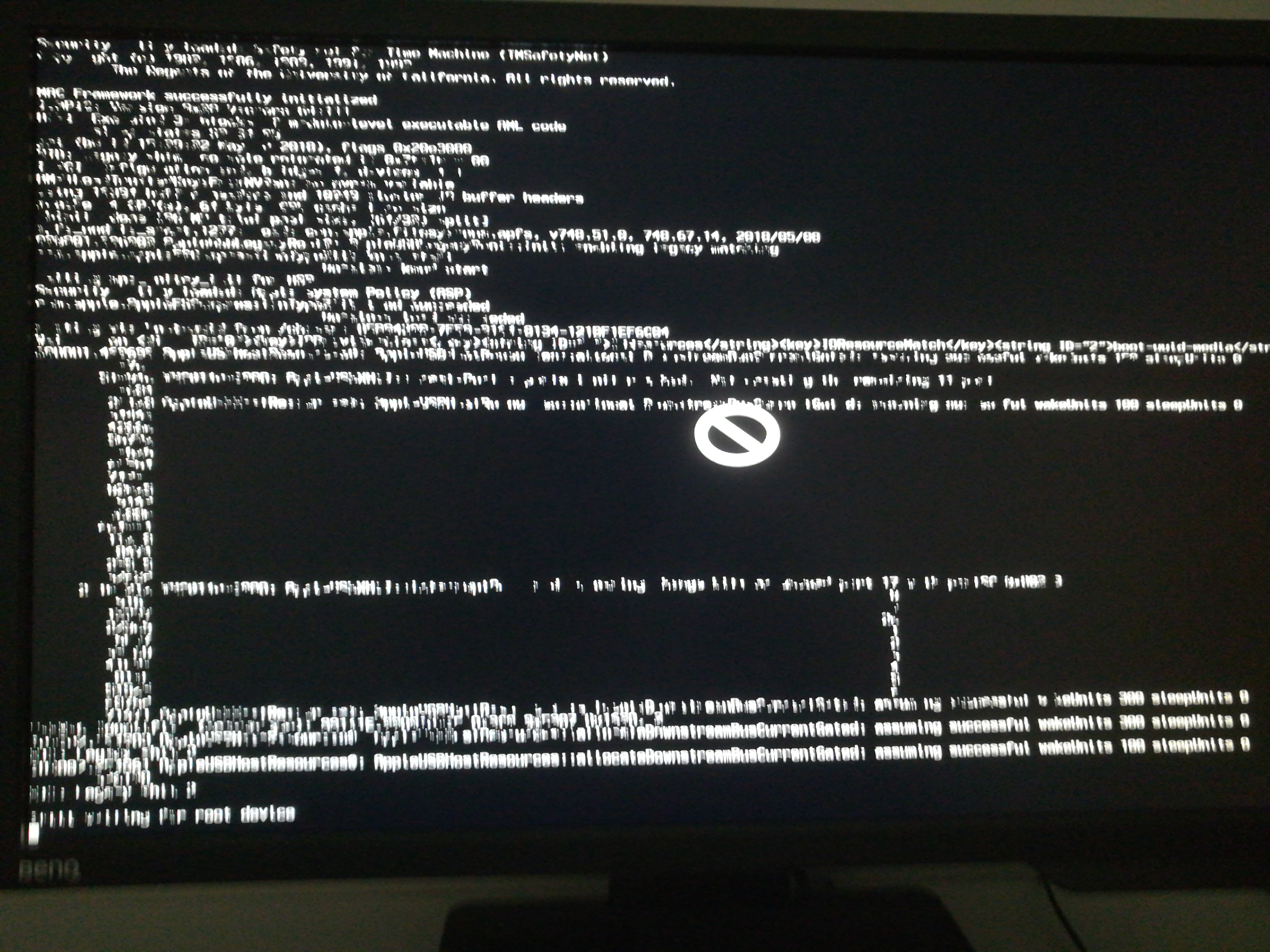

gengik84 Posted June 19, 2018 Share Posted June 19, 2018 si ma hai un problema di restrizione di porte.... Link to comment https://www.insanelymac.com/forum/topic/334559-problema-installazione-mojave/page/6/#findComment-2620858 Share on other sites More sharing options...
DangerNemesis Posted June 19, 2018 Author Share Posted June 19, 2018 3 minutes ago, gengik84 said: Prova su altre porte USB.. Se non va.. Allega la efi Cmq ecco la efEFI.zipi..Sarebbe quella che mi hai passato tu.. Link to comment https://www.insanelymac.com/forum/topic/334559-problema-installazione-mojave/page/6/#findComment-2620859 Share on other sites More sharing options...
gengik84 Posted June 19, 2018 Share Posted June 19, 2018 si ok... dimmi però che versione di high sierra hai nell'installer... devo aggiungerti una patch Link to comment https://www.insanelymac.com/forum/topic/334559-problema-installazione-mojave/page/6/#findComment-2620860 Share on other sites More sharing options...
ITzTravelInTime Posted June 19, 2018 Share Posted June 19, 2018 di solito basta usare una porta usb 2.0 e si riesce ad avviare la chiavetta, ma per usare bene tutte le porte usb, bisogna fare come dice gengeek e applicare la port limit patch che è specifica per ogni versione di mac os (grossomodo) 1 Link to comment https://www.insanelymac.com/forum/topic/334559-problema-installazione-mojave/page/6/#findComment-2620862 Share on other sites More sharing options...
DangerNemesis Posted June 19, 2018 Author Share Posted June 19, 2018 Ho 10.13.5 Niente non va Link to comment https://www.insanelymac.com/forum/topic/334559-problema-installazione-mojave/page/6/#findComment-2620864 Share on other sites More sharing options...

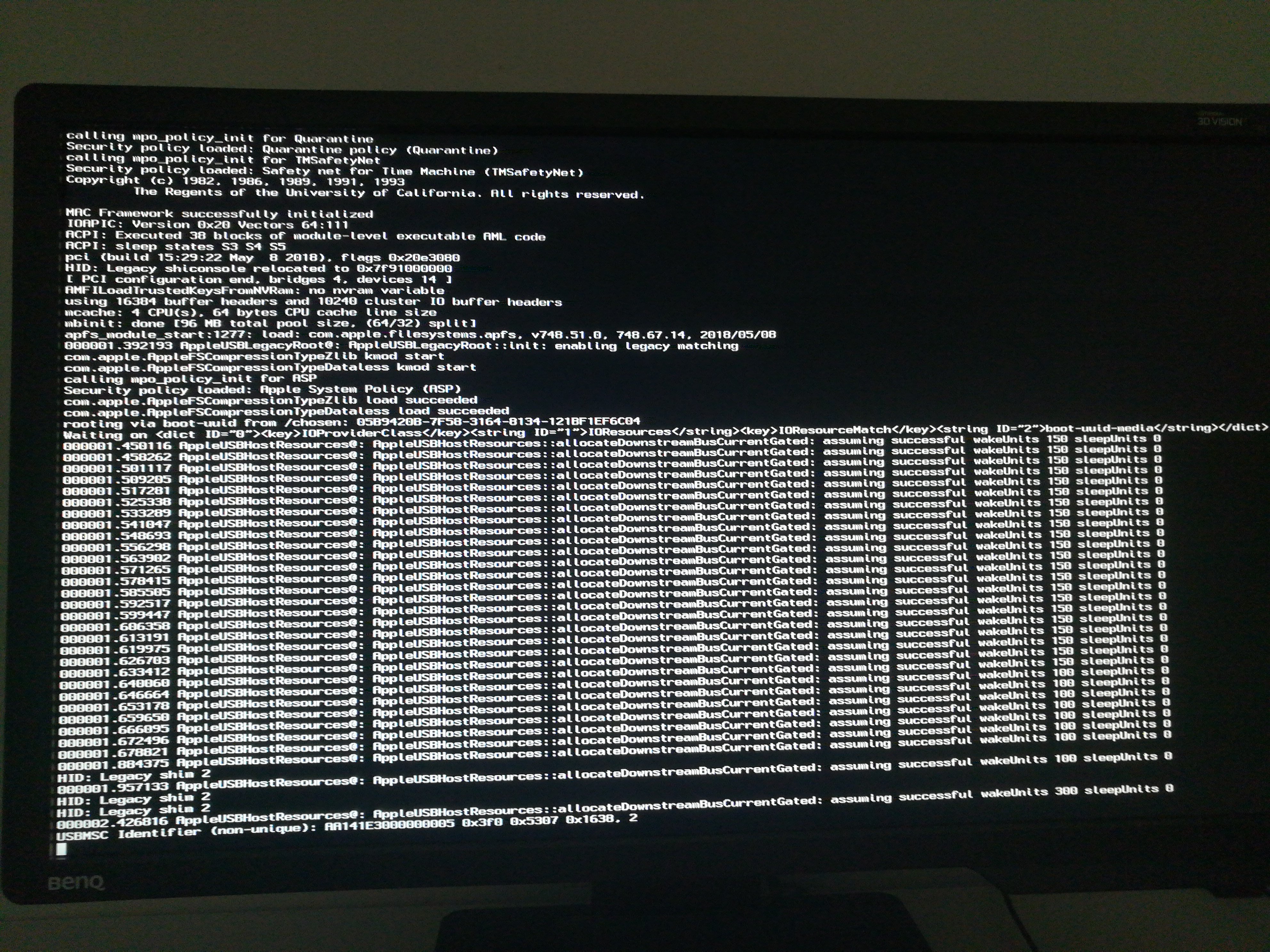

DangerNemesis Posted June 19, 2018 Author Share Posted June 19, 2018 Niente.. Link to comment https://www.insanelymac.com/forum/topic/334559-problema-installazione-mojave/page/6/#findComment-2620872 Share on other sites More sharing options...

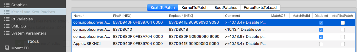

gengik84 Posted June 19, 2018 Share Posted June 19, 2018 ok bug... apri il config clover configurator vai in kernel and kext patches/kext to patch disabilità la prima e abilita l'ultima patch Salva la modifica e riavvia 1 Link to comment https://www.insanelymac.com/forum/topic/334559-problema-installazione-mojave/page/6/#findComment-2620873 Share on other sites More sharing options...
ITzTravelInTime Posted June 19, 2018 Share Posted June 19, 2018 1 minute ago, gengik84 said: ultimamente il binario cambia quasi a ogni nuova versione inizialmente è andato con la stessa fino alla prima beta 10.13.4, poi cambiata la patch su AppleUSBXHCI invece che AppleUSBXHCIPCI e su 10.13.6 nuovamente binario cambiato si lo so, apple a quanto pare non sa prendere una decisione con la funzione del port limit Link to comment https://www.insanelymac.com/forum/topic/334559-problema-installazione-mojave/page/6/#findComment-2620874 Share on other sites More sharing options...
gengik84 Posted June 19, 2018 Share Posted June 19, 2018 Praticamente così Link to comment https://www.insanelymac.com/forum/topic/334559-problema-installazione-mojave/page/6/#findComment-2620875 Share on other sites More sharing options...

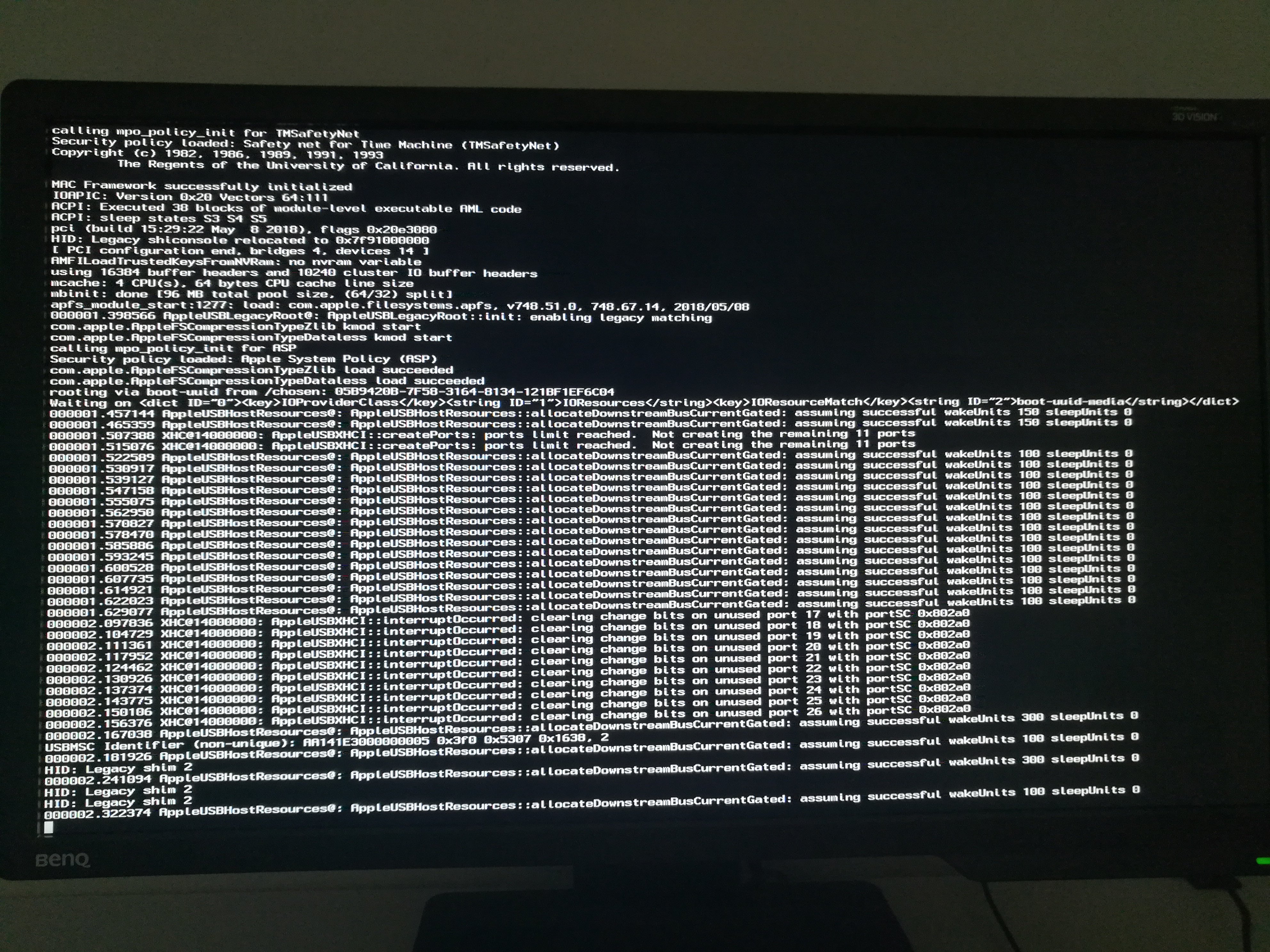

DangerNemesis Posted June 19, 2018 Author Share Posted June 19, 2018 (edited) 4 minutes ago, gengik84 said: ok mea culpa... config.plist 3.zip Tranquillo testo subito Allora si blocca come prima però sono cambiate le scritte.. @gengik84 Edited June 19, 2018 by DangerNemesis Link to comment https://www.insanelymac.com/forum/topic/334559-problema-installazione-mojave/page/6/#findComment-2620883 Share on other sites More sharing options...
gengik84 Posted June 19, 2018 Share Posted June 19, 2018 strano.. la usb la colleghi diretta alla mobo? nel caso prova così Link to comment https://www.insanelymac.com/forum/topic/334559-problema-installazione-mojave/page/6/#findComment-2620886 Share on other sites More sharing options...
DangerNemesis Posted June 19, 2018 Author Share Posted June 19, 2018 Si.. la attacco dietro al pc alla porta 2.0 Link to comment https://www.insanelymac.com/forum/topic/334559-problema-installazione-mojave/page/6/#findComment-2620887 Share on other sites More sharing options...
