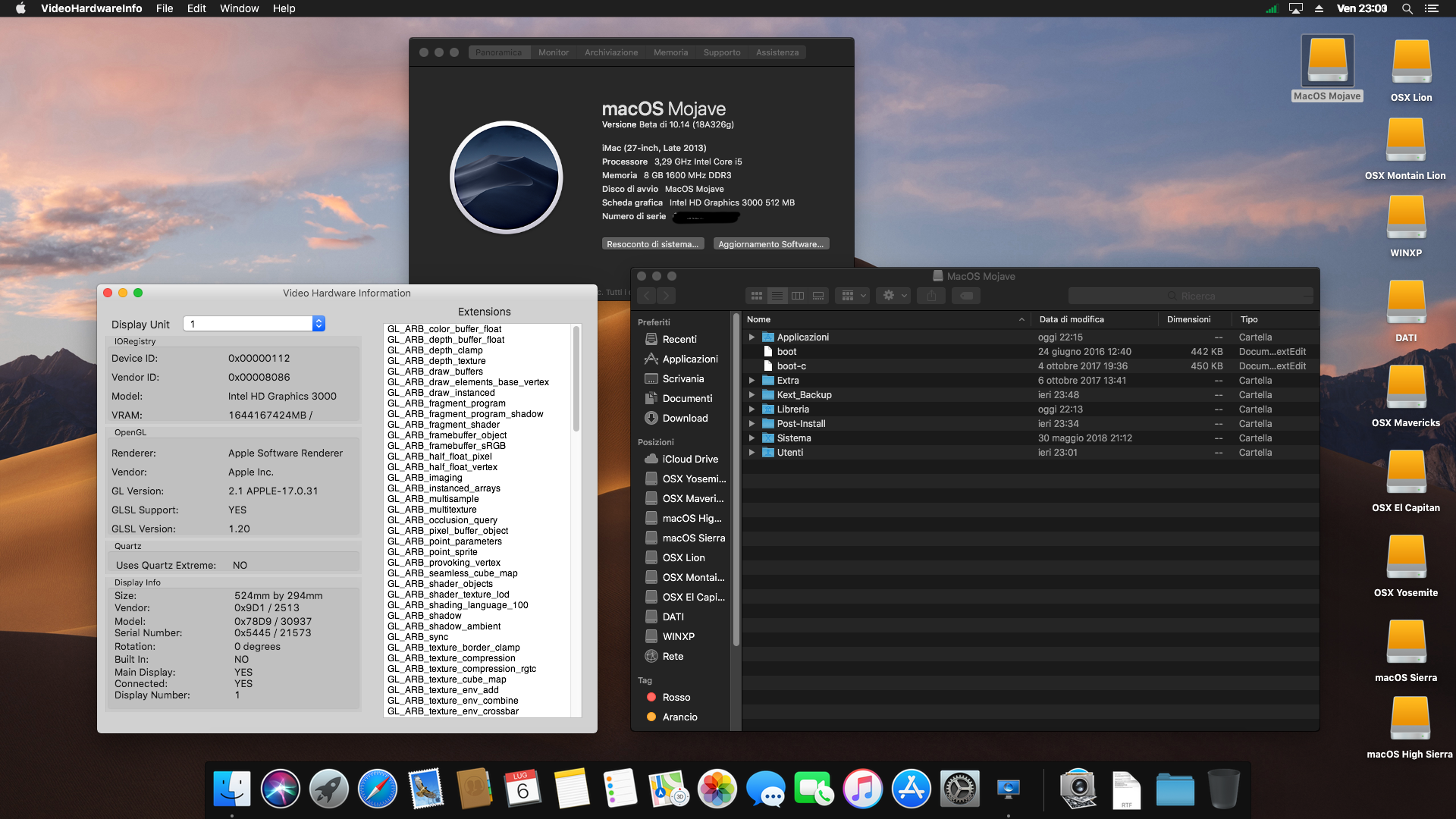

you are right, after I have cloned/Installed  macOS Mojave on MBR/HFS+ partition , now  I am able to boot it with Enoch Bootloader .
I have installed only FakeSMC.kext and nulCPUPowerManagement.kext in S/L/E and copied /Extra folder from HSierra
I'm using Enoch vers. 2725 and it boots from Lion to Mojave very well :thumbsup_anim:
I'm using my H67N-USB3-B3 mobo with Intel HD3000 ( Kexts from Sierra 10.12.6)
but I have verified that I have no QE  enabled ( I'm think only some kind of openGL acceleration)
Cheers
PippoX0
Edited by PippoX0

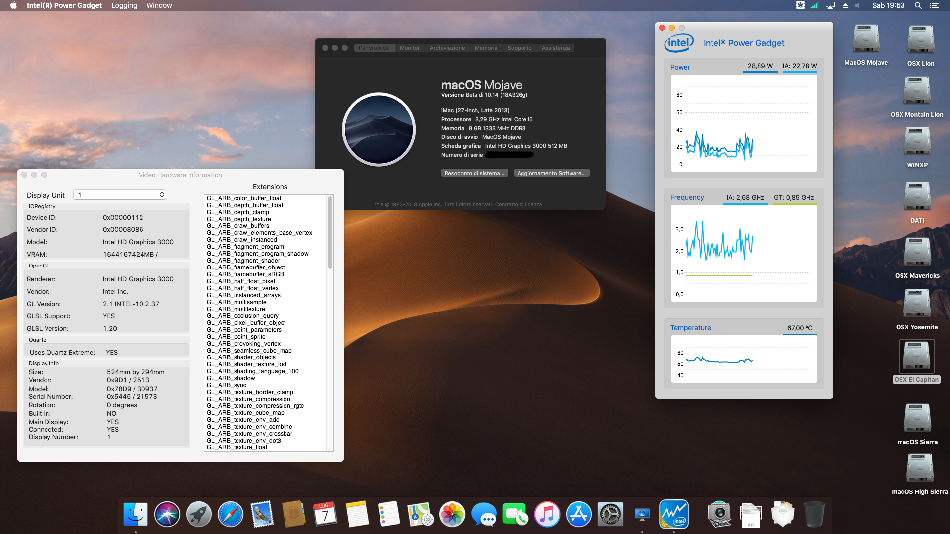

My Intel HD3000 works with QE enabled on Mojave.
My mistake , I have not installed all the HD3000.bundles required and re-created prelinkedkernel cache.
When I realized it , I got QE
See Ya

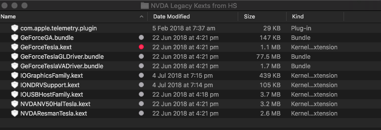

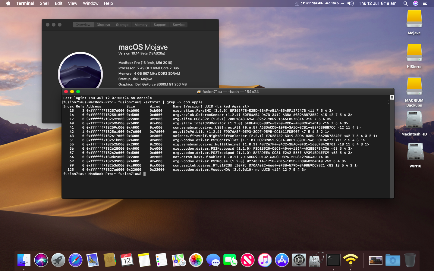

I was able to get dock/menu bar translucency with Mojave Beta 3 on my legacy XPS M1530 laptop (system no 3 in sig, Core2Duo Penryn with NVidia 8600M GT) after following @AsentientBot's instructions in post#2082 and using his patched GeforceTesla.kext from post#2125.  This stopped the kps after login when using HS Nvidia legacy kexts :thumbsup_anim:.
Note:  I also replaced /System/Library/UserEventPlugins/com.apple.telemetry.plugin
with the one from HS to prevent Mojave kp for Core2Duos.
Screenshot below shows the High Sierra kexts I used...
Legacy HS NVidia Kexts for QE:CI.png
Edited by fusion71au
